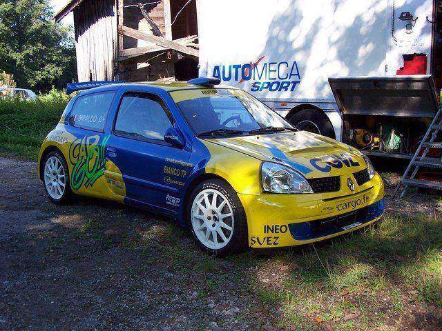

Have a look at this:
Super 1600 Clio - possibly the fastest Clio on bumpy tarmac B roads. Note the ride height. You need compliance and travel to maintain effective tyre contact patch loading over bumpy roads - run out of travel and you run out of grip on that corner as the load on the contact patch reduces over the crest of the bump.
On road car clios you are also limited by the amount of angle you can induce/reduce in the steering arms. Running excessively low ride height just results in bump steer which is not what you want at all. Okay you can shim the rack up and the track rod ends down on the upright to induce the correct angle back into the arms but why go to all that work and still be limited by travel?
