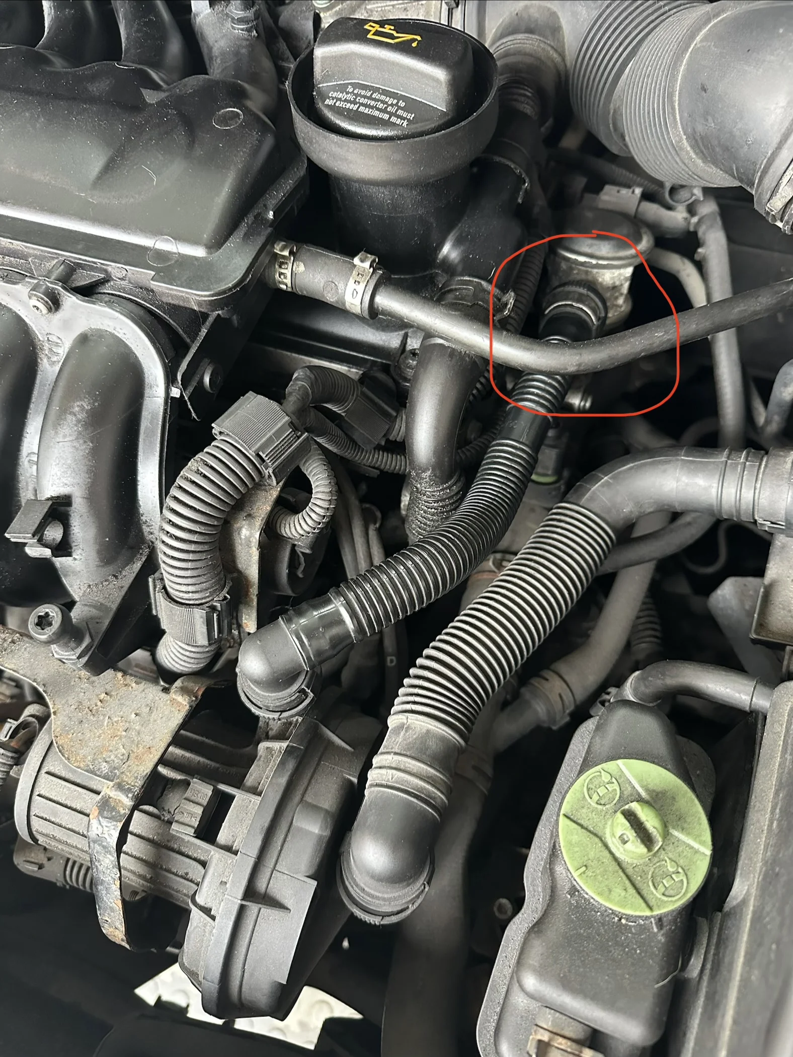

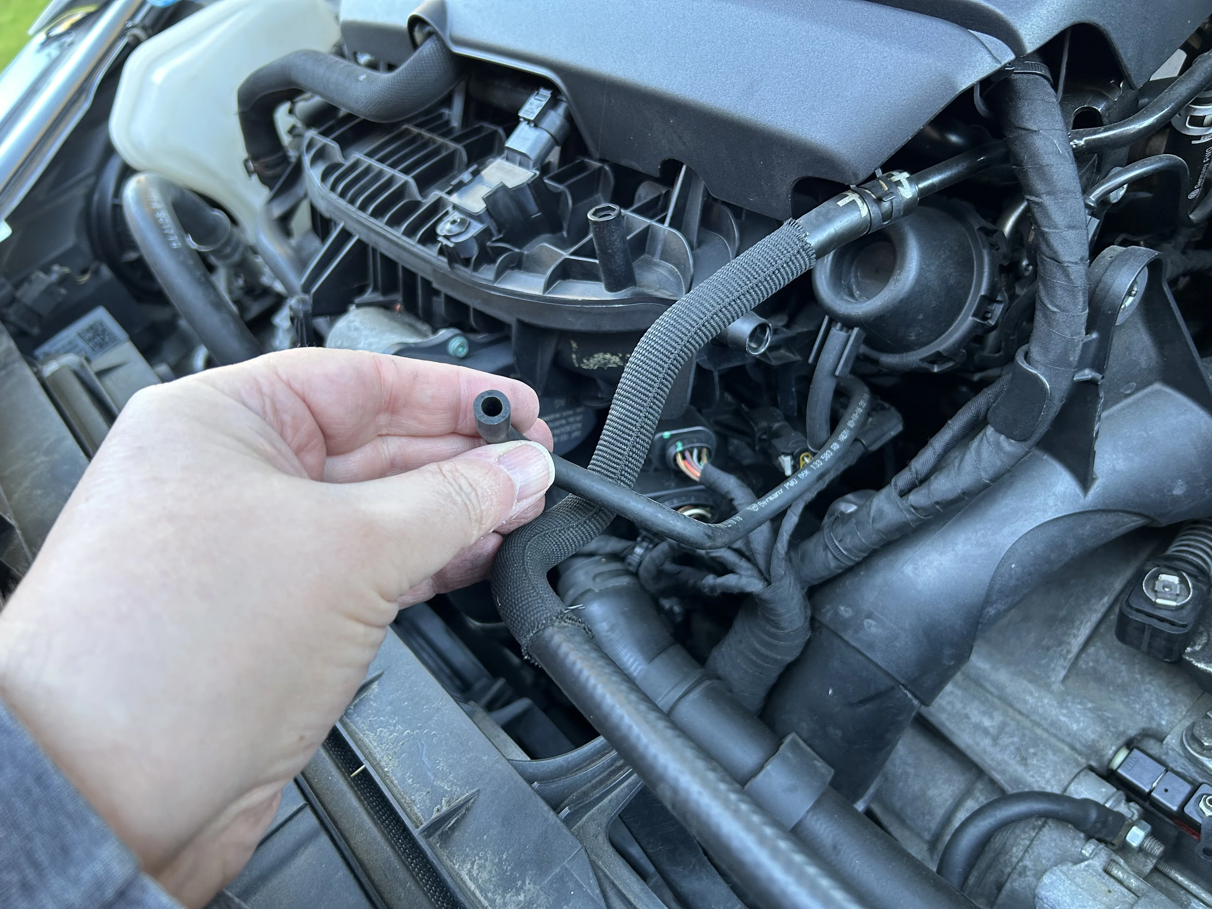

I swear her beetle knows we want to sell it so it just keeps coming up with little issues for me to sort.
We’ve had it six years and never had any problems, then last week it threw up an engine check light. My cheap code reader says there’s no issue so I’m going take it to a local garage.
The only thing I can see wrong is that the secondary air pump pipe has come loose at the end circled (the clip thingy has broken).
Would this be enough for the check light to say hello

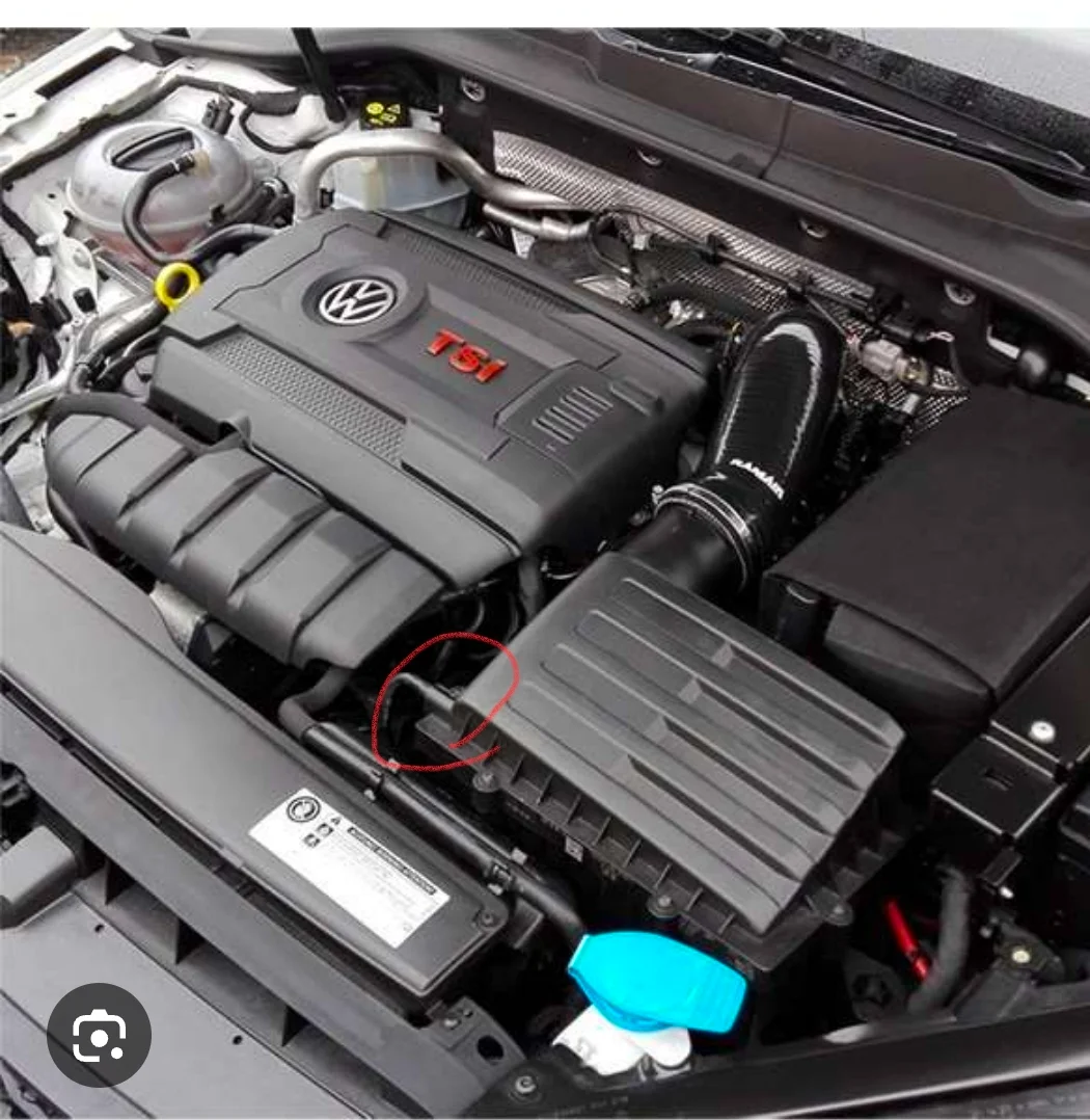

To the EA888 brethren, I took the air box out of my golf to bleed the clutch and found this pipe not connected to anything. Any ideas? Car is spot on, no error codes, runs fine. It’s the Golf R version of the engine if that makes a difference.
If that goes into the intake manifold, the other end should connect to the airbox itself. It should have a small thing on the side
Spot on. Reconnected, thanks.
I was watching out for anything like that, but I think when the previous owner took the R600 intake off the car that never got reconnected.
No worries.
Surprised you didn't get an engine light for that.
Mine thrown an EML because of that wasn't properly put in at some point, and was getting errors for the manifold flaps being stuck.
