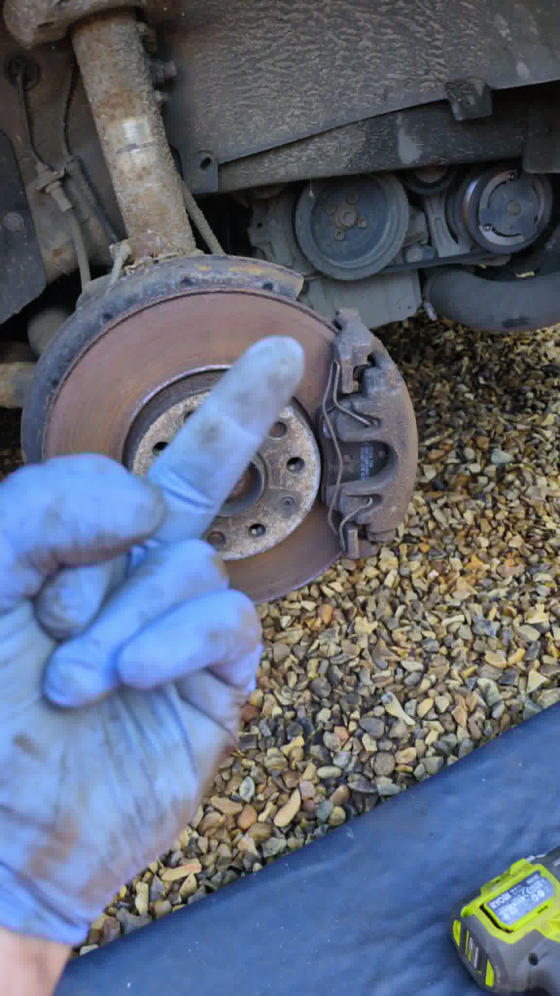

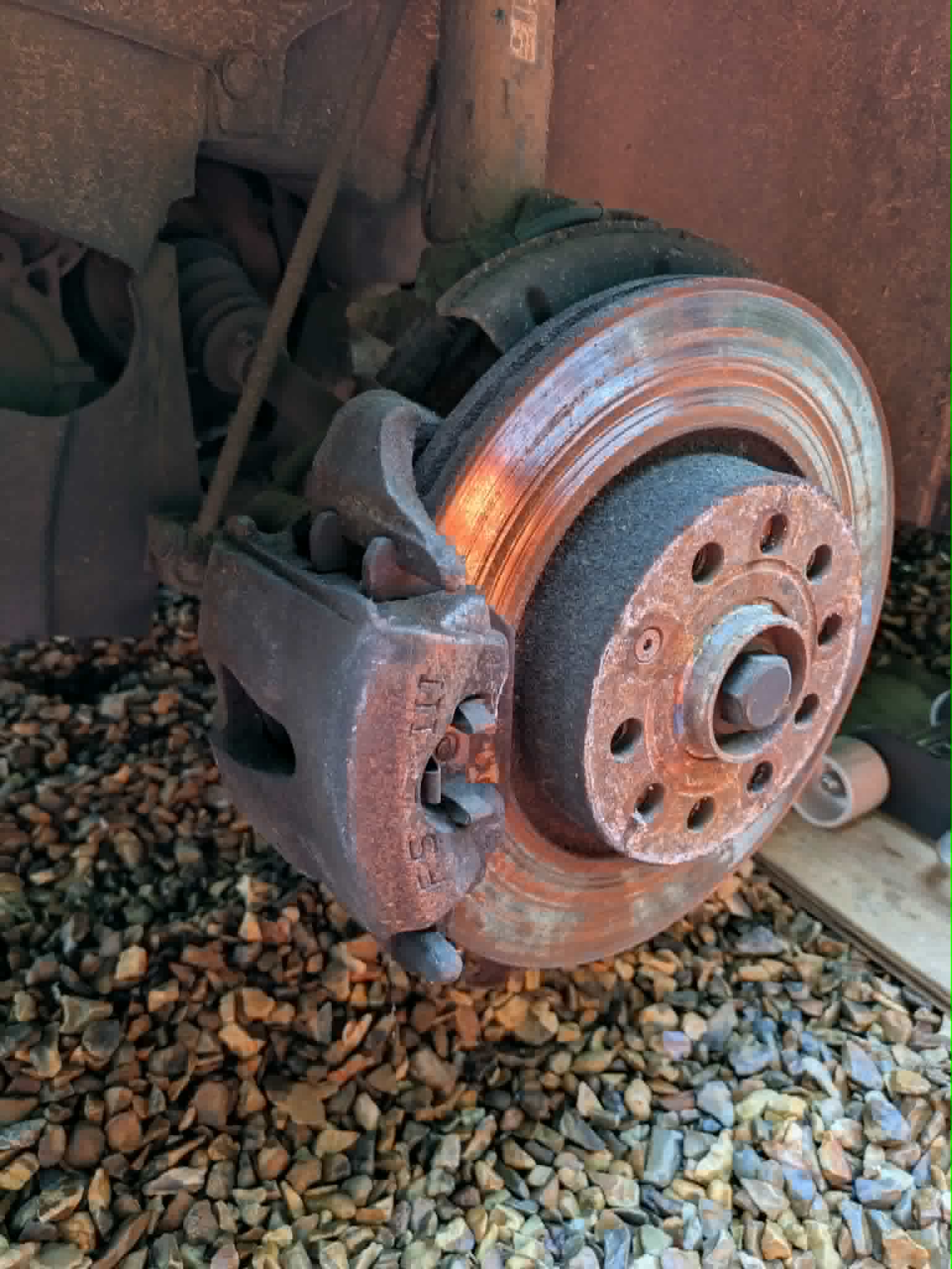

Newest find of bodgery on the £400 A3... Noticed the brake pads were very low when I put new tyres on, I didn't twig the main issue though...
OSF. As it should be. Typical VAG caliper with a 282mm disc.
NSF. Off an early A3/Fabia with a smaller (262mm?) disc...
WTAF? 😂
