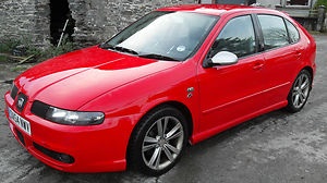

Seriously considering one, red, 80k, fsh, 2 owners from new, not keen on the interior or ride height as standard but cracking mpg and comfort over the 182, and i can insure the bird on it, £3495 asking price on it aswell, thoughts?
Looks a little like that, cheers.

Almost bought one of these so did quite a bit of research at the time :) What year are you looking at? Looking at the picture it looks like a MK1 which IMO is the one to go for, mostly due to the lack of the DPF, if you do a lot of short trips this can cause an issue, IIRC this was introduced with the MK2 and not on the 150's anyway (i'd double check this, i'm running from memory here)

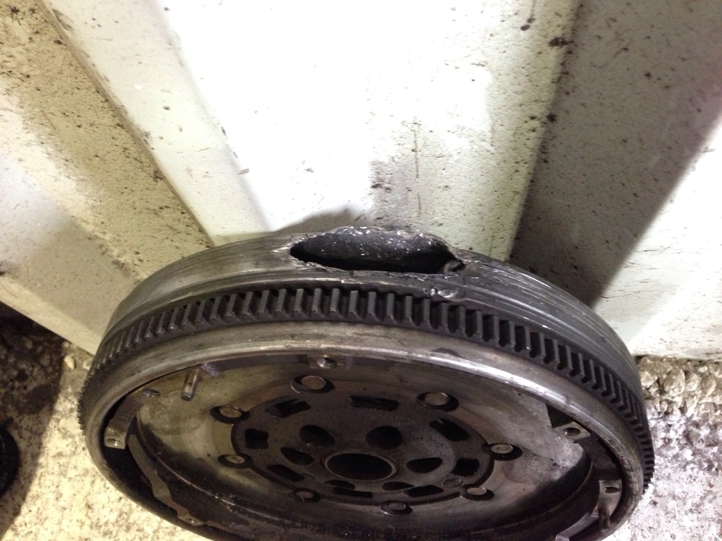

Wow Dan, that makes the DMF removed from mine look like it was in good condition!
