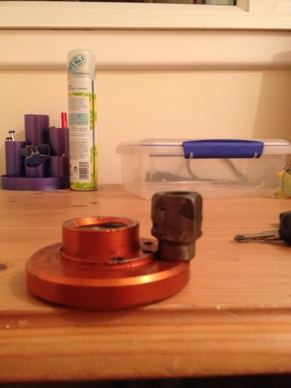

Tried to sort the forever unwinding top mount - going to see if can get some tab locking washers as physical locking is going to be the only way to stop this unwinding I think.

I had a top mount nut the same last season, i've not worked out what i'm going to do to stop it yet!

I'll let you know if i can find a tab washer (or similar) big enough....may see if I can get another thinner nut to tighten onto it.
I presume you've tried threadlock and it's not working? It didn't on mine :( I might try superglue LOL
No - as you told me yours didn't work - I know you can get different strengths but I feel mechanical\ physical would be more lasting. My top mount nuts are slowly getting rounded off, due to the crap (old) AST design (shoulder that covers half the nut) and I will have to get some new ones If I don't sort soon.

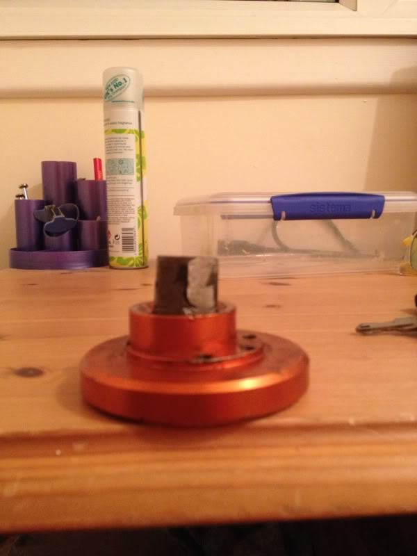

Weld a nut on top of the nut. Djw Dave had the same problem as its so tricky to get enough access to torque them. Ill see if I have a pic, if not then pm him for one.
Might look a bit ropey but it works, well!
Great idea plus be able to drill holes for locking wire...thanks!!
Think I'll be able to remove the nut and get it back inside the top mount with out taking the strut off and top mount? Just had it all aligned etc and don't want to take it all apart again unless I really have too...
I was nearly going to Dremel the shoulder away today too....
Negated by every other idea of the year.
Yeah you should be able to just remove that without shifting anything else, no need to remove the top mount or adjust the 3 bolts on them so can't see why it would change alignment.
