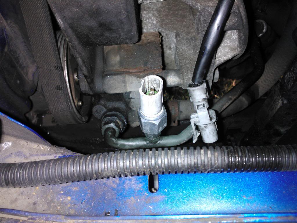

Done a fair bit today, saw fresh fluid seeping from this PAS connector (from the middle of the plug??), cleaned it up and none has re appeared, though there is plenty of old oil further down the pipe..so must seep when engine on etc. Can I replace just this or will I need the whole pipe affair?

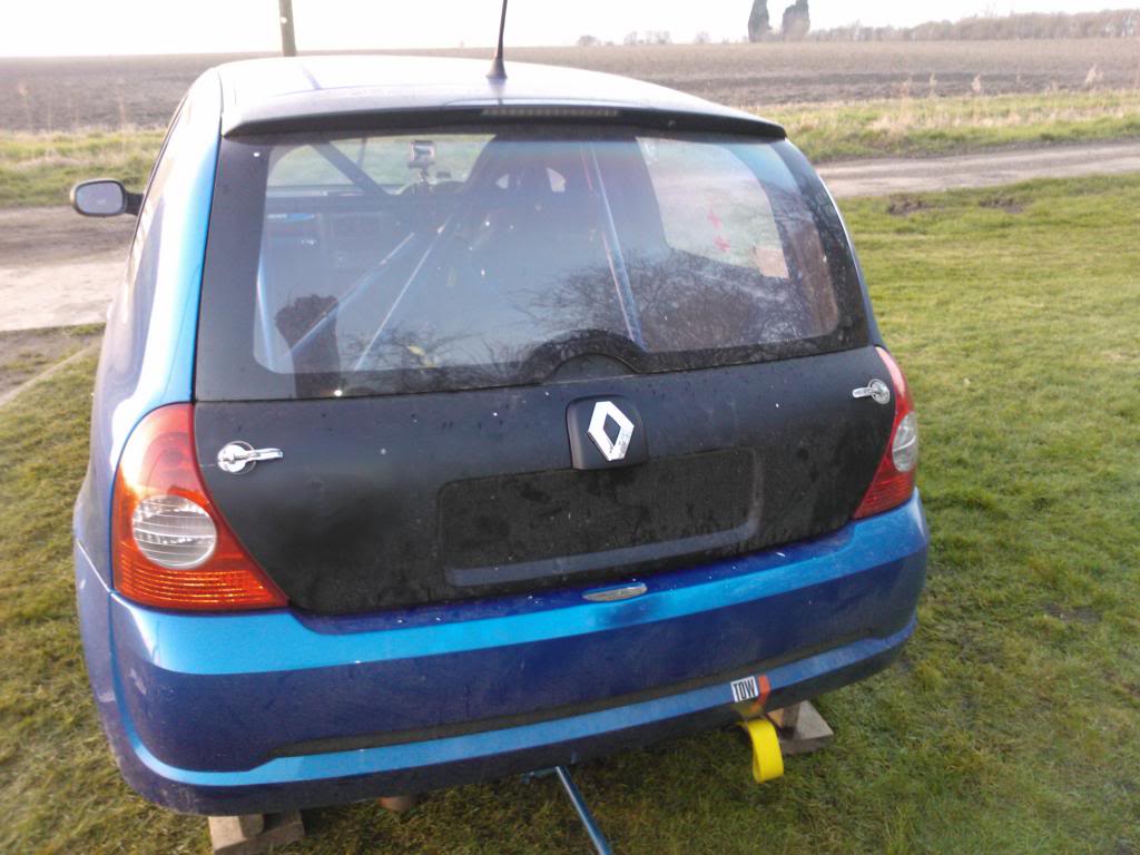

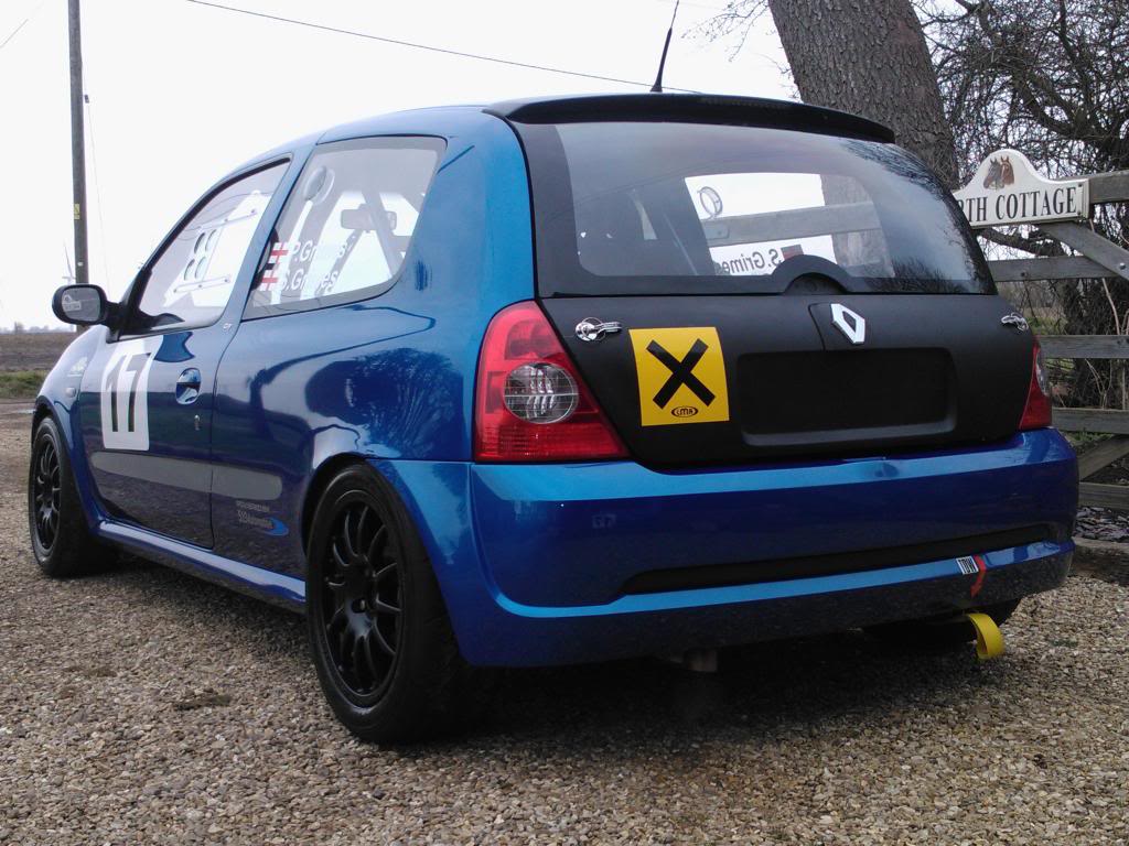

Copied James and put on my rear diamond.
Looks good, used locking wire to secure the diamond and boot button, sprayed the filler that I put in the hole last year ready for the novice X to go back on.

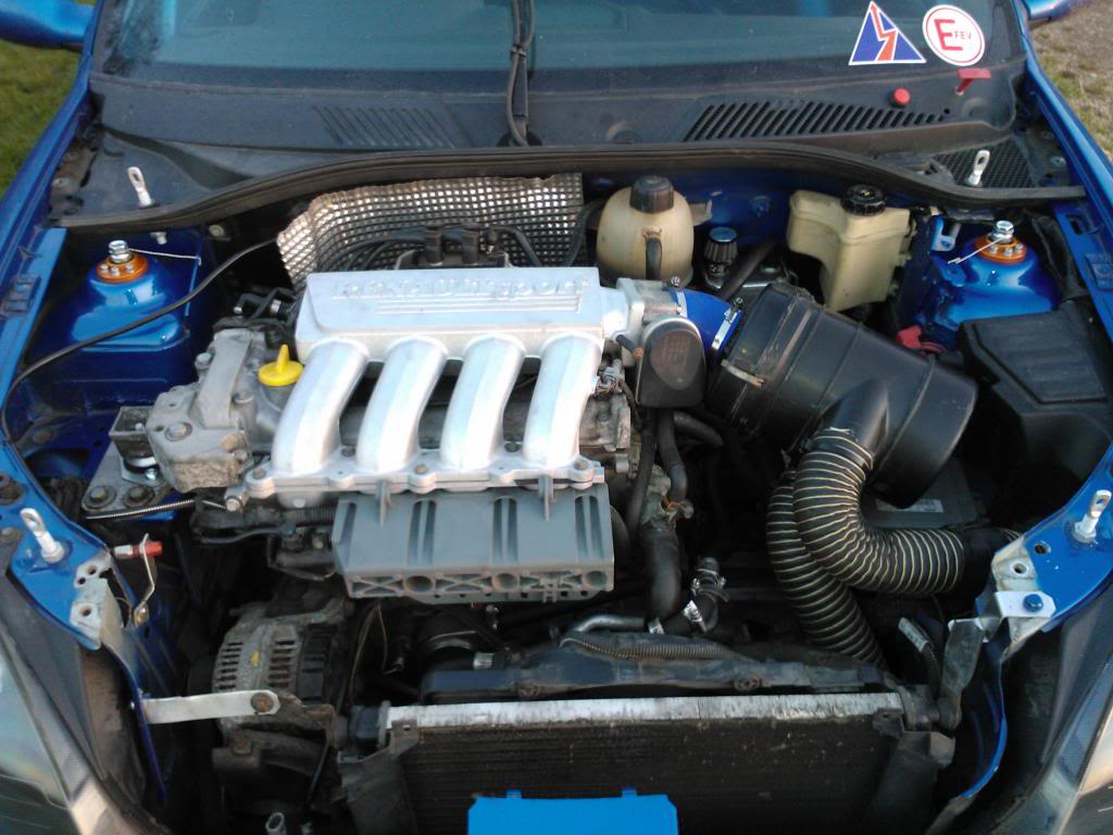

Gave the bay a once over - lock wired my "new" top mount securing nuts, going to have to nip the oil filter up as got a seep there, looking and sounding good.

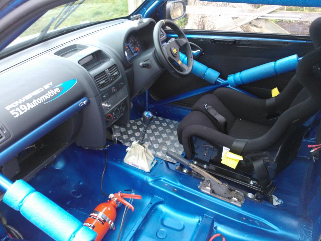

Secured the false drivers floor with bolts rather than the self tappers put in last year, now doesn't move\flex. Tided up some cables in the cab - though not all.

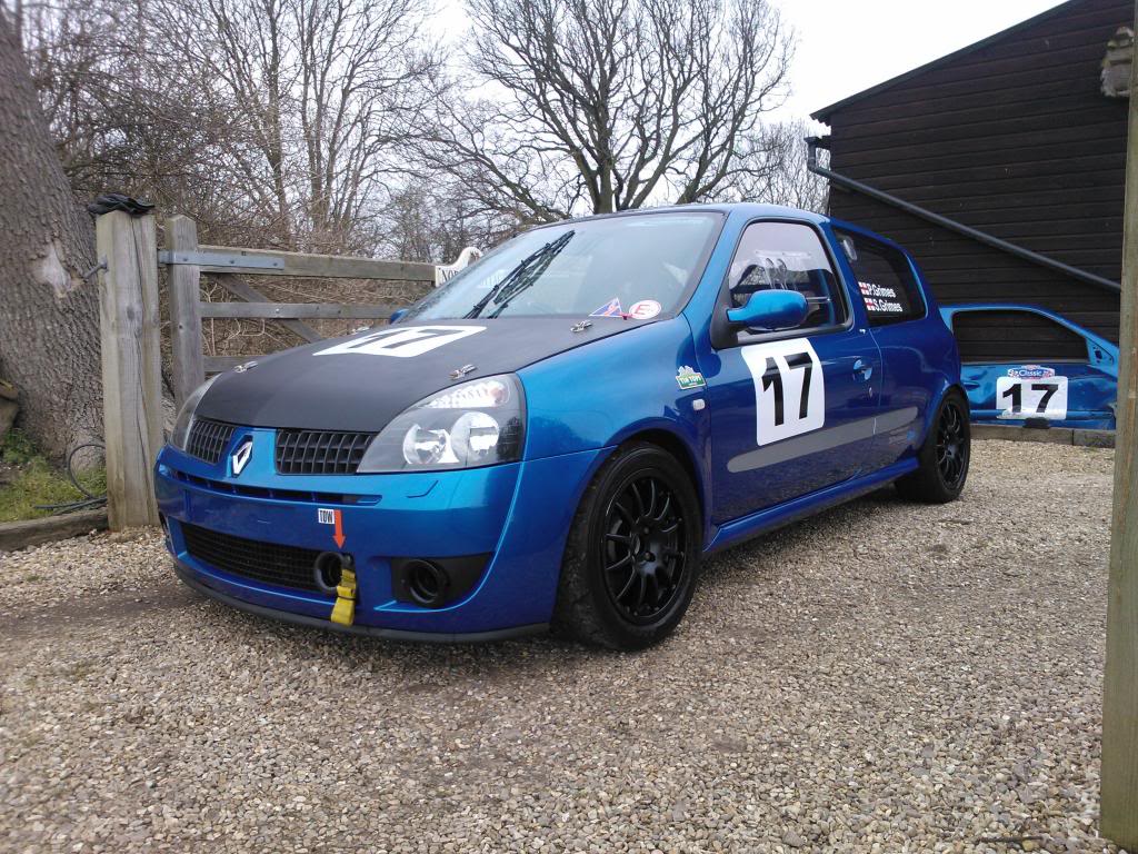

Ha, can just see my crystal headlights....not 100% though. Wished I'd bought the 1200, 1500 & scratch X now. The One step stuff needs a 1st more abrasive cut\step, making it a two step process - anyway race car innit.

That PAS pipe that you thinks leaking is usually the sensor, replacing it usually resolves the leak. I priced that short pipes n your pic during the week with Adam and it retails at £232 or something stupid for that tiny little section, the other hose that goes round the back isn't even that much FFS.

I'll price up a PAS sensor - didn't appear to be leaking today,strange.

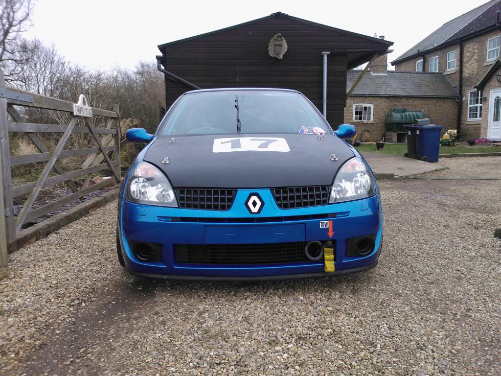

I do believe race car number 17 is ready for the 2013 season......
Can see some errant wires that I've not sorted in this pic, for the power to the camera and driver - pax comms.
Can't wait for this Thursday and Rockingham's shake down.
Good luck on Thursday Pete, do you still need your yellow/black cross novice sticker?
We had a good day on Friday at Oulton, so #4 is ready to rock & roll.
Thanks Tony,
Yes - still need a couple of sigs to make 6...or do you only show the cross for the first year?

Thanks! I'll be getting the PAS sensor replaced after the March 7th I should think. Maybe the rear brake bias valve too.....depending on how it performs on the 7th also.
