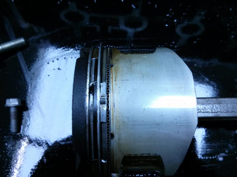

So, the engine has been checked by Dan at 519, one piston is down, which means it has to come apart for further checks. Bit of a :( . Now getting prices of bits and pieces, forged, one piece valves too as now it's coming apart I'm not keen on having to do it again (or replace with standard) when and if something else wears, breaks etc.
Shall know more, the direction the engine is going in a day or too when the costs has been worked out.
Cause of the piston failure Pete? Mapping I'd expect?
Sorry to hear about this anyway, not an ideal start to the new racing season. Unless you're going bigger power with the engine I wouldn't bother to pistons, Burpspeed engine does just fine without.

Well, until Dan's stripped the engine we won't know for sure at the moment. I'd rather replace bits now than have it go again part way through the year and maybe have to do it all again off season to add forged bits, if the price is right won't hurt to go forged ready for further improvements for 2014......
  182/RS2/ Turbo/Mk1
As already mentioned before it came apart it was always going to be the bottom end so hopefully that isn't too much of a nasty surprise.
These pistons aren't very good so the slightest mapping issue and they just fall apart, and even sometimes when mapped fairly well they still do if the imperfections are in the wrong place ( they are poor quality casting and full of air bubbles) like on the ring lands.

Its a lottery with the standard pistons as they are so variable in terms of imperfections, so just cause one person gets lucky doesn't mean another will. For the price of a forged set its very cheap piece of mind IMHO. 400 quid gets you a forged set with rings and its about a third of that just for new genuine rings anyway.
If its a daily then forged aren't ideal but for a competition car its a very logical choice.

Cub, good decision, the only time non forged makes sense is for a daily where forged dont last or if you are on a mega tight budget and don't mind the fact you might have to do a fair bit of labour yourself quite often chucking new pistons in while its in situ with a rehone or remove it and fit a new bottom end etc
No, no surprise as it was going to be either top or bottom so a hefty bill in either case, what I add (improvements) to make the bill larger is the catch 22.

Thanks Cub, the more I think about it, if I hadn't got cams I'd look for a 2nd hand engine - which would be more than enough to see me right. But at the moment having to pay for the eng swap\fluids etc I may as well get it sorted from the start, as don't like to do a job twice or having to re visit stuff that could've been completed properly first time round. Bit more of an expense now but will save in the long run not having to again take out and strip over the winter. Well, that's the way I'm looking at it.
