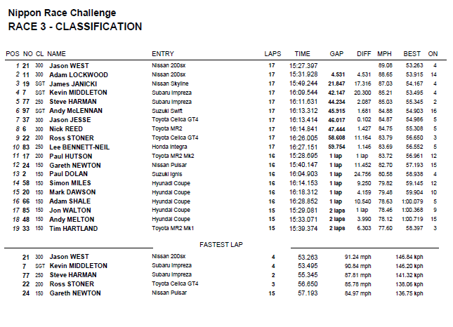

Been checking out the competition in the class we'll be running with at first until the european numbers get high enough to run on our own - think they'll be in for a shock. There's a fair bit of pi33 taking going on, on the TARC forum now they have some new European friends.
Looking at their Brands 2012 results - 300-400BHP in most of the top runners looking at the build threads too.
At Brand s last year we were 57 sec's we've got another year's experience and can better that no problem. Tony and Jay were 55 -54 sec.

Must be wet looking at those times, especially if you're saying some of the cars were running 400bhp and they are no quicker than Tony and Jay in the Clio. Either that or you have joined the Sunday Drivers racing league.

I was a bit nervous at first running with the nippons and all their HP - not now if these times are dry....

Just looked at their Silverston National times and they don't appear to be all that special - not done the track myself but sure Tony and Jay were quicker??

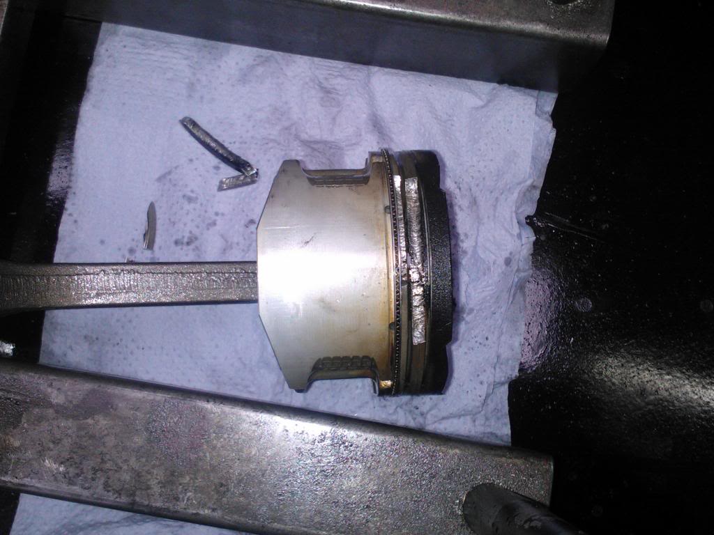

Head was in the oven at about 4pm so the new guides can be pressed in. Exhaust side was SLOPPPYYYYYYY! First thing engineer said when I took it in was "I don't know how these don't knock the heads off the valves with play like that" My reply: "They DO!!"

Started half way through the Rockingahm test day (march 7th) then used 300-500ml of oil in 45 mins
Swallowing oil then......quickly!!!

Just as well from the pics for sure, good luck with the build and getting it to Rockingham on time. At least its not up to you I guess for the work to be done in time.
