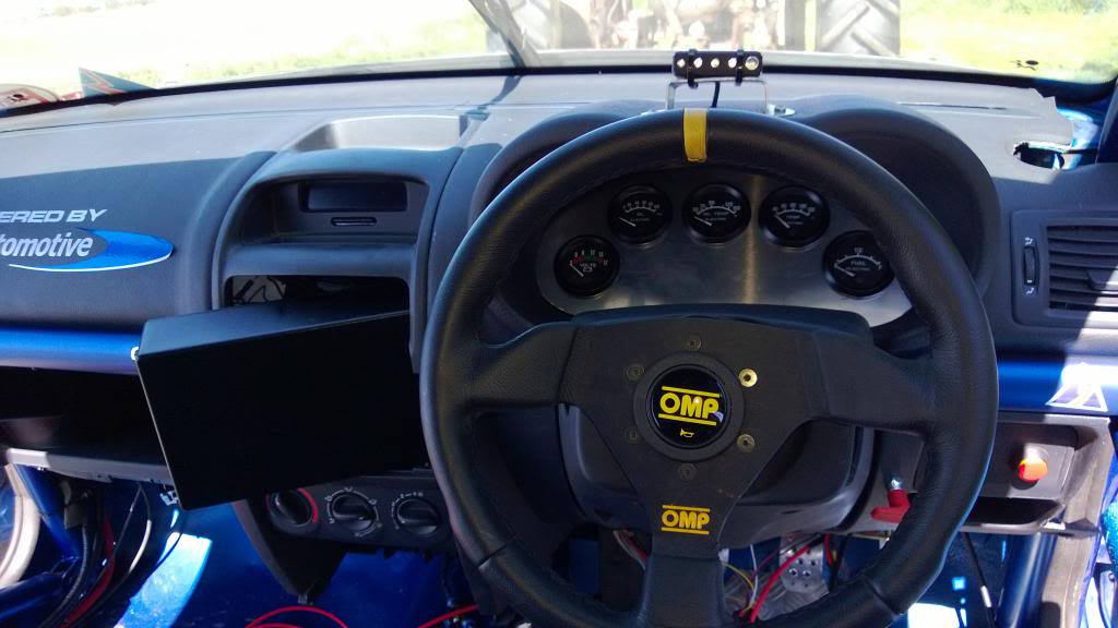

Here's the new dash;

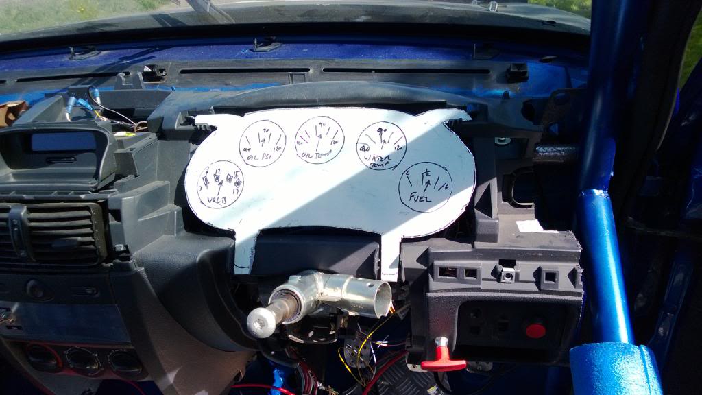

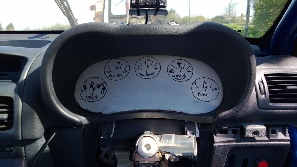

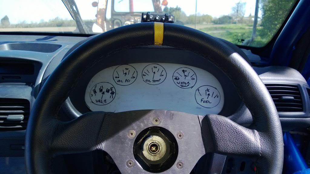

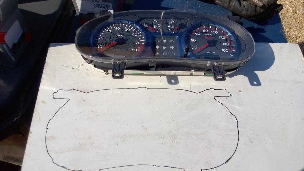

Planning stage - drew on original clocks to see if they would all fit. they did
Cut out and trial fit - looks ok.

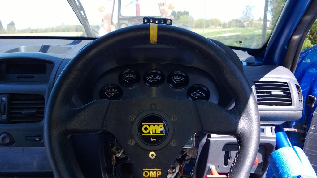

Dash top on -
Can even see the clocks with the wheel on too, result.

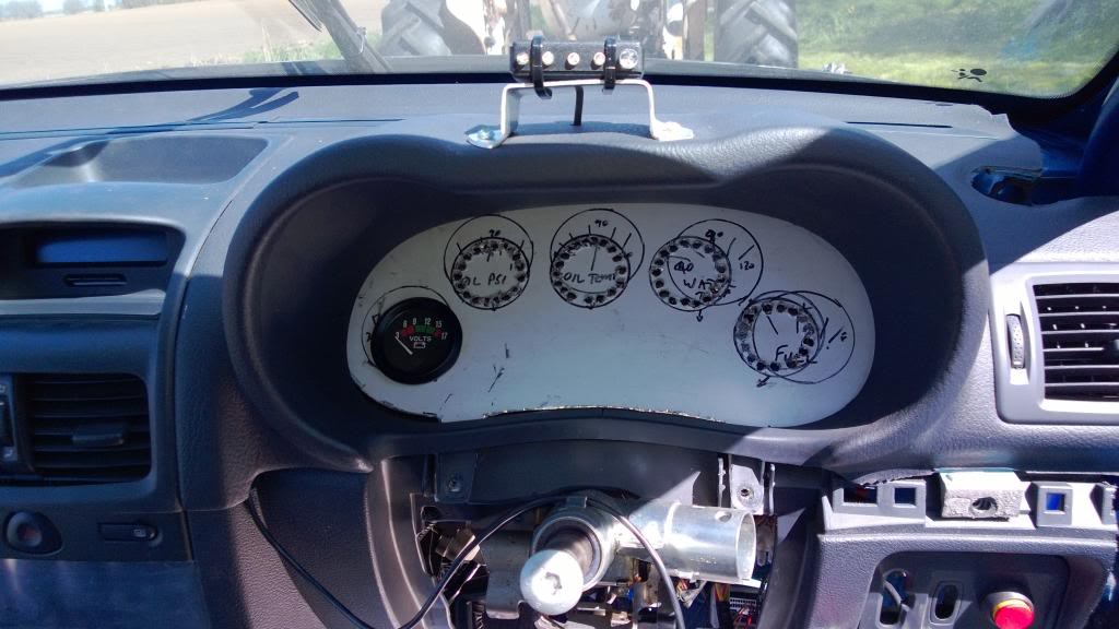

Volt's in, decided to them all move down a bit, other cut out holes drilled-

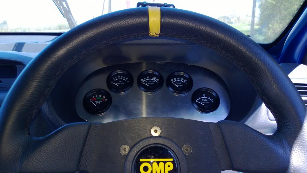

The finished article,

Looking good Pete :) personally I agree with Jay, no fuel gauge, no oil pressure gauge just run the standard sensor with a light, no volt gauge as you can just run a light to come on if the alternator isn't charging and job done :) does your ECU have pit lane speed limiter as I notice no speedo?
Still dont think you need all that
Fair comment, some information is better than just a light - and I've always wanted to know what's going on at times - even now I never look at the dash during a race and didn't really need to fit any. Also it gives people poking there heads in the car walking through the pits\track days something to look at.
I don't think the ECU I have bought has a pit limiter - will GPS the car in 2nd and 3rd and note the revs at 60kph\40mph. Though nearly always have driven under to be safe, works out quicker than getting a drive through if wrong.
Why do you need to see fuel gauge whist racing? Stick it in the side window next to the filler IMO
I did think to put it there but then thought (be more trouble) as I'd have to turn the cut off switch on and may be the ignition too just to read the fuel gauge, it's in the same place as any car now and will just check and fill as we do now.
