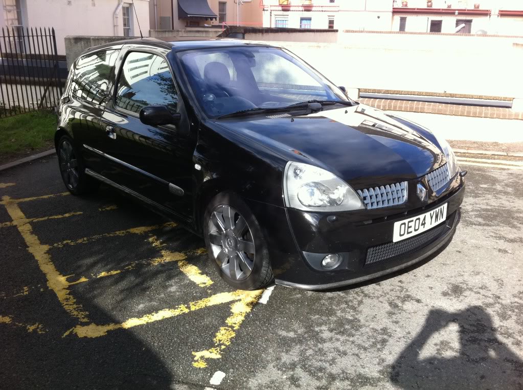

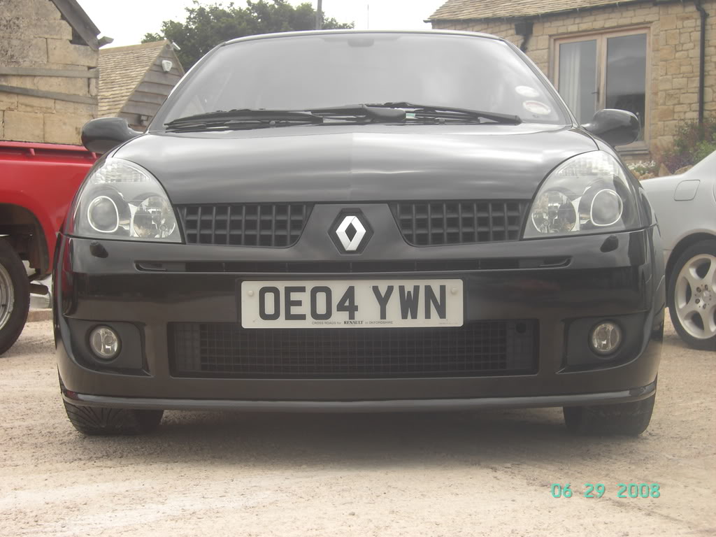

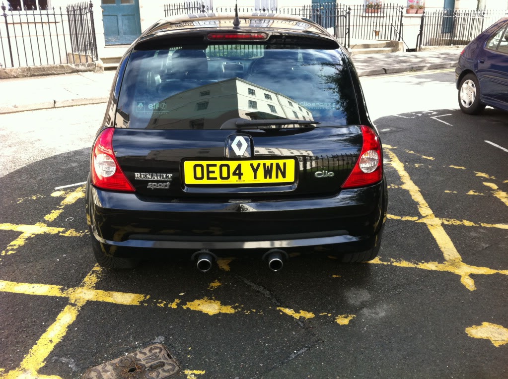

Picked up my new 182 at the weekend so thought I'd start a new project thread. She's covered 105k and still drives like a car with half the mileage. Only things I can really fault so far are, the front brakes seem imbalanced (will try cleaning up), and a very slight whine from the PAS on full lock from cold. Picked her up for £2100 so it seems I got a bargain.
My aim with this car is to make it as light as possible without making it unbearable to drive (like my old ph1!!) and hopefully increasing the power to become a B road weapon suitable for the odd track day too.
Here are a few pics from the advert

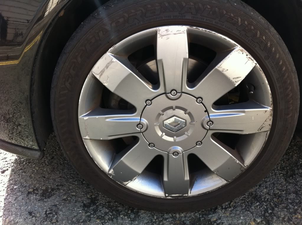

Wheels scuffed

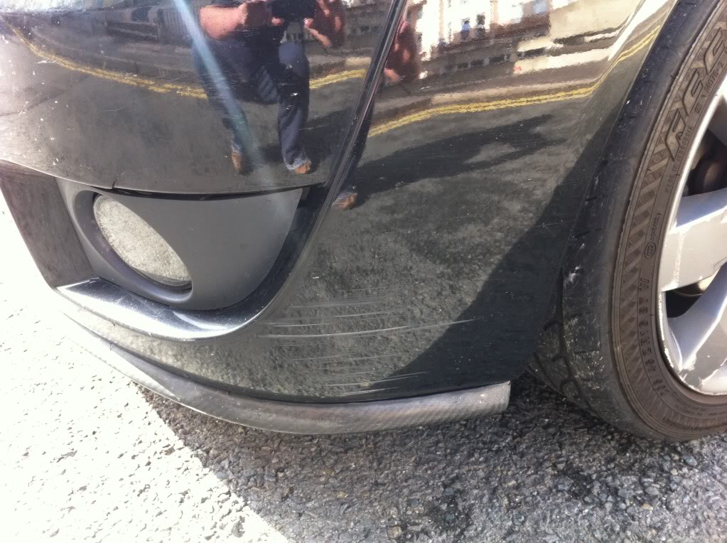

Scuff on front bumper

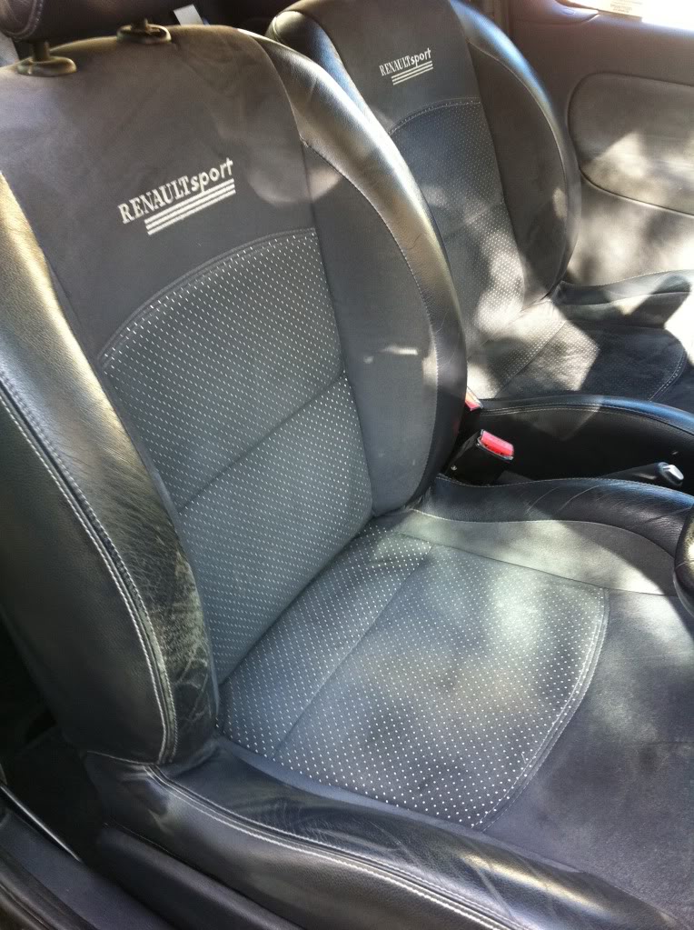

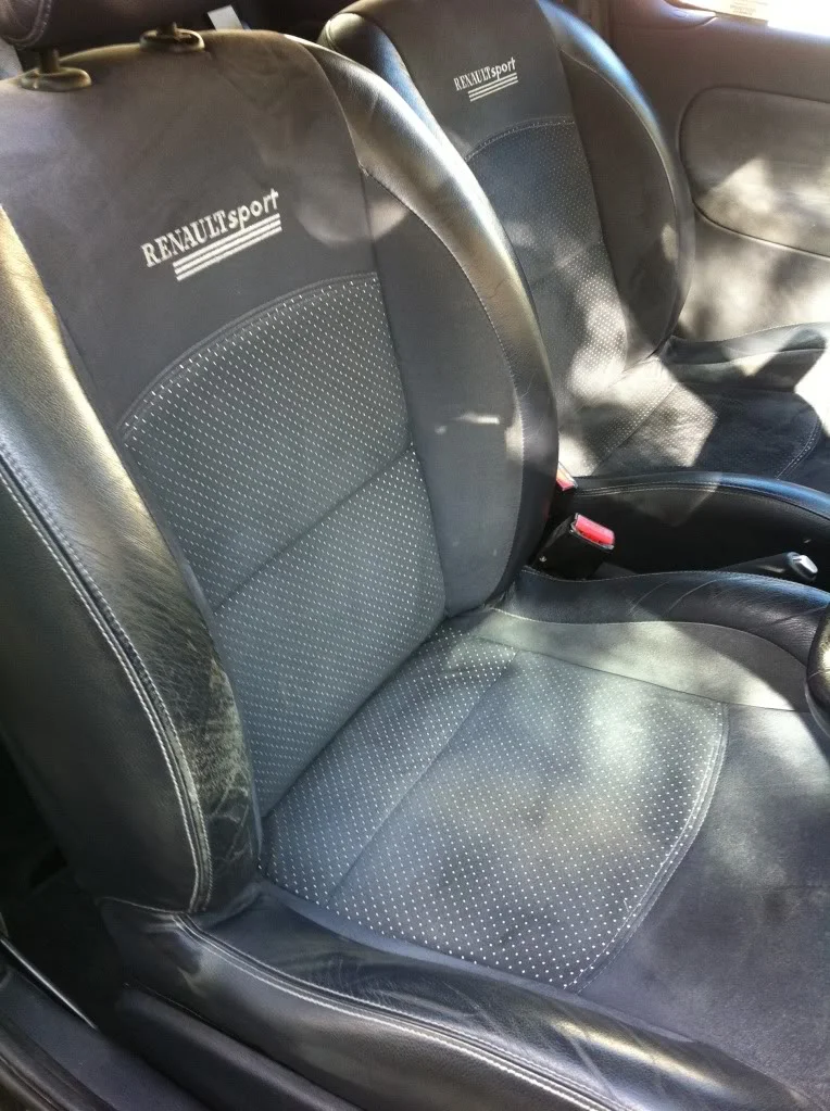

Wear on seat bolster
Only mods so far are a carbon front splitter and silvervision bulbs (front)
Will update with my plans soon............

Good base to start from in your situation but those tyres make me wince.

seat bolster isnt bad at all and nice to see the thumb grips are still in good nick!

Lol they're getting replaced with the TD's on the DCI - will soon to be wrapped in decent rubber too (888's or RS2's)

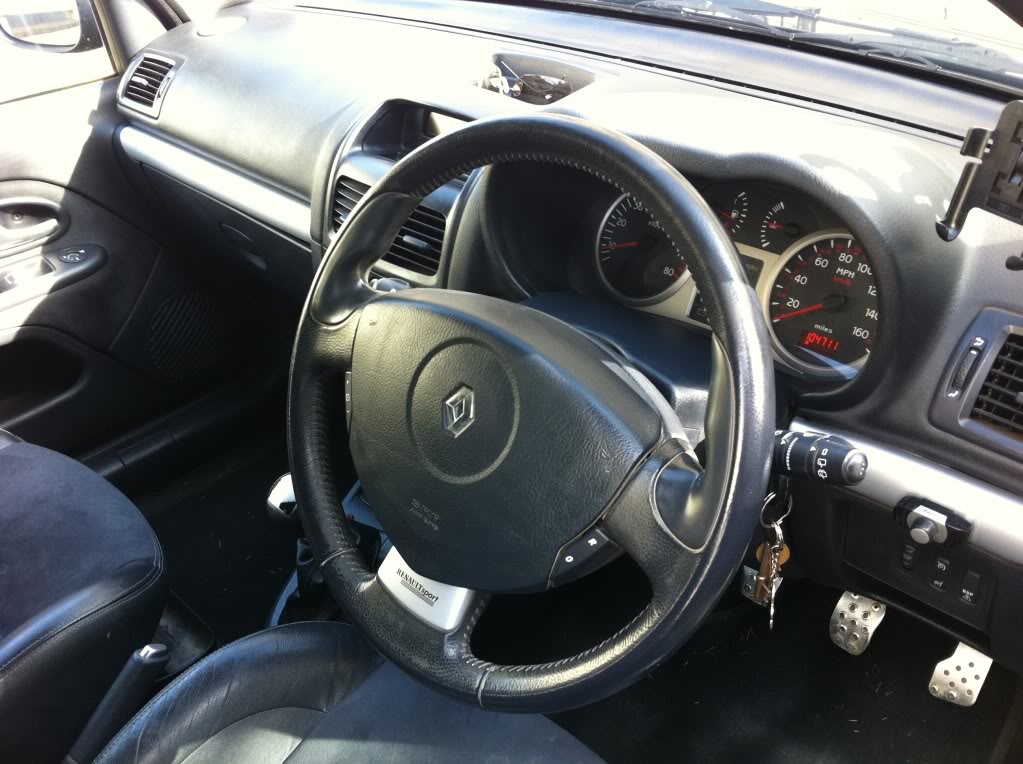

Steering wheel is getting replaced with a sabelt one and this will end up in the DCI :)

Looks a tidy car for the money. Your seats look very black in the picture. mine look more dark blue than that, is it just the camera or do they actually come in different colours?
  Discounted 1*2 parts
Think the ph1 seats were more blue and all the ph2 seats were black? Then the 182 seats had the white dots on iirc?
