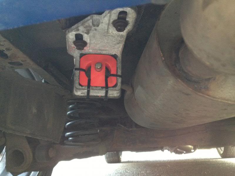

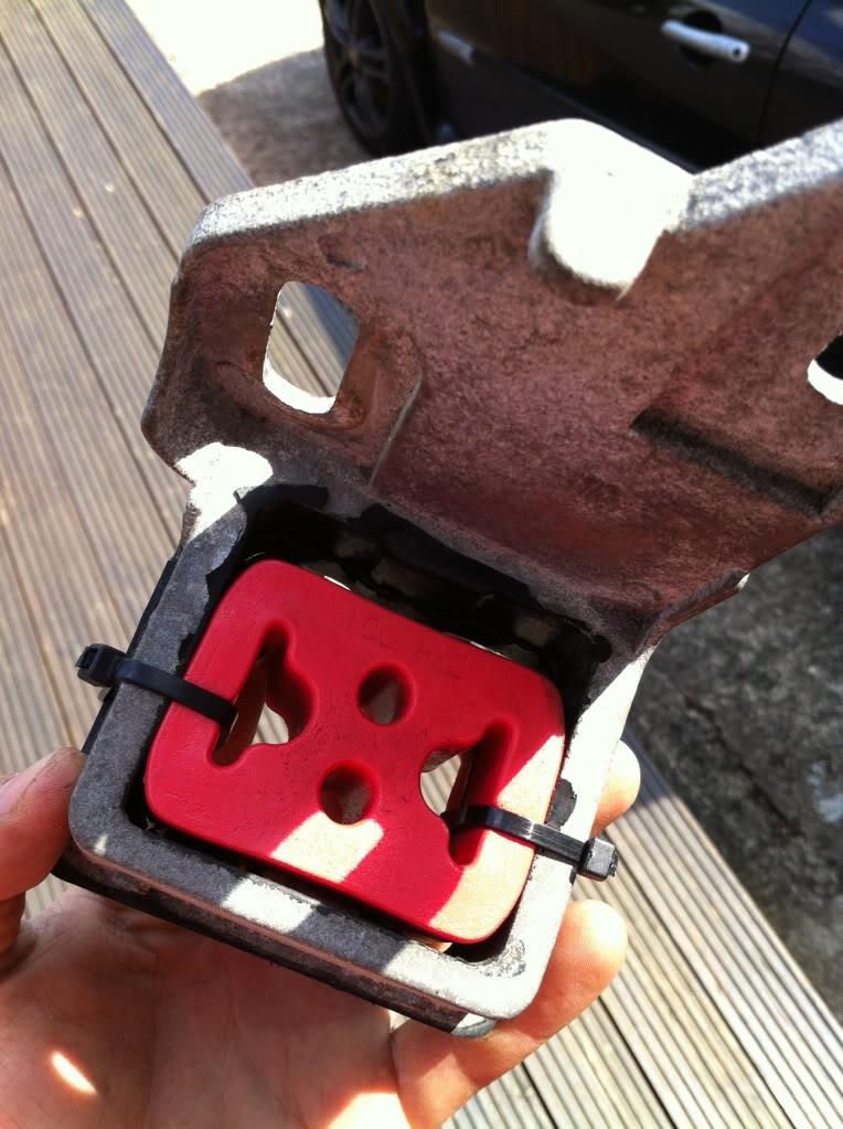

If you cut and fit in a way that is secure enough then no need for any additional cable ties or sealants.
All depends on bow much, if any, you trim off the powerflex mount

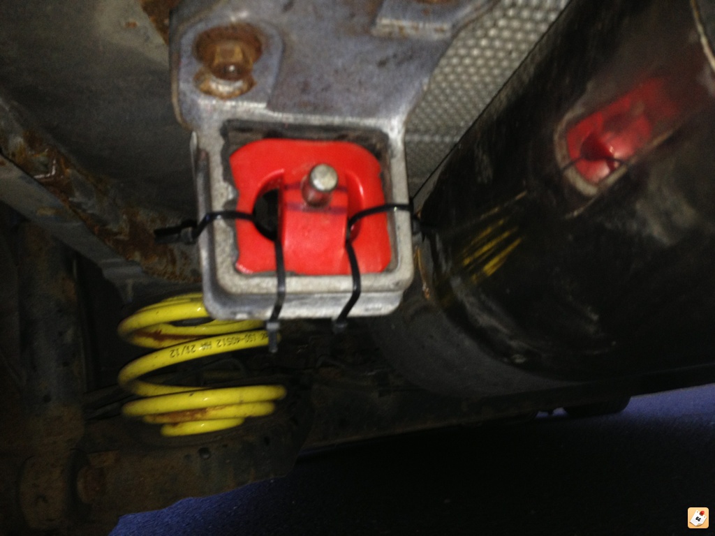

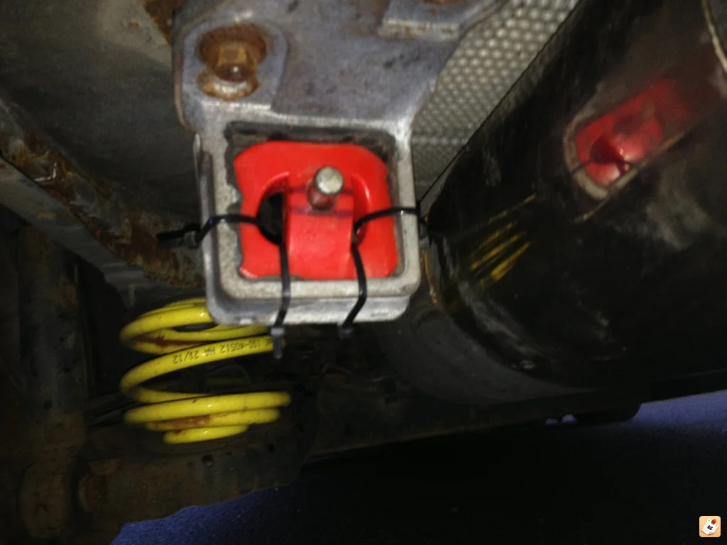

Here's what I did to mine.

Craig I had a different style to yours, 006 ones I think mine were? Yours looks far better!
Yeah it's a tight fit in the hole, don't really need the cable ties to hold it in place really. Exhaust isn't solid, still a bit of movement, but much less than the standard one and obviously gonna last longer. It's been holding my KTEC Super-sport on 3 different ph1's now

The rubber mount will only tear if it has been damaged or weakened during the cutting / drilling of the hole. Otherwise everyone else that has done this mount would suffer the same results as Saul.
