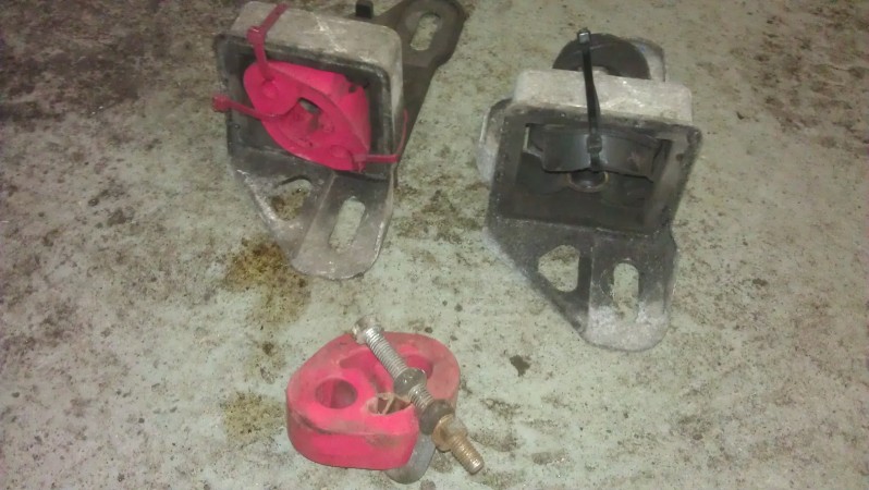

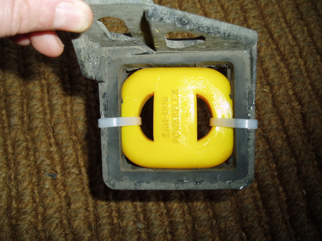

SO..... I bought 2x Powerflex universal exhaust mounts EXH 008, about £6 / £7 each. Pic in this link
http://www.powerflex.co.uk/i/product_images/2-Exhaust Mount Cat Page.pdf
I cut the useless rubber mount flush from within the metal frame so it left a nice opening to fit. They're not a direct fit into the standard metal mount and required approx 3 - 5mm taken of each side so I still had to compress it to get it in place. cabled tied in place to ensure it can't fall out (unlikely but just incase). All I have to do now is find a 12mm drill bit and make the hole for the hangar arm.
New exhaust arrives in a couple of days so I'll make final measurements then and get them fitted.
No more sagging :rasp:

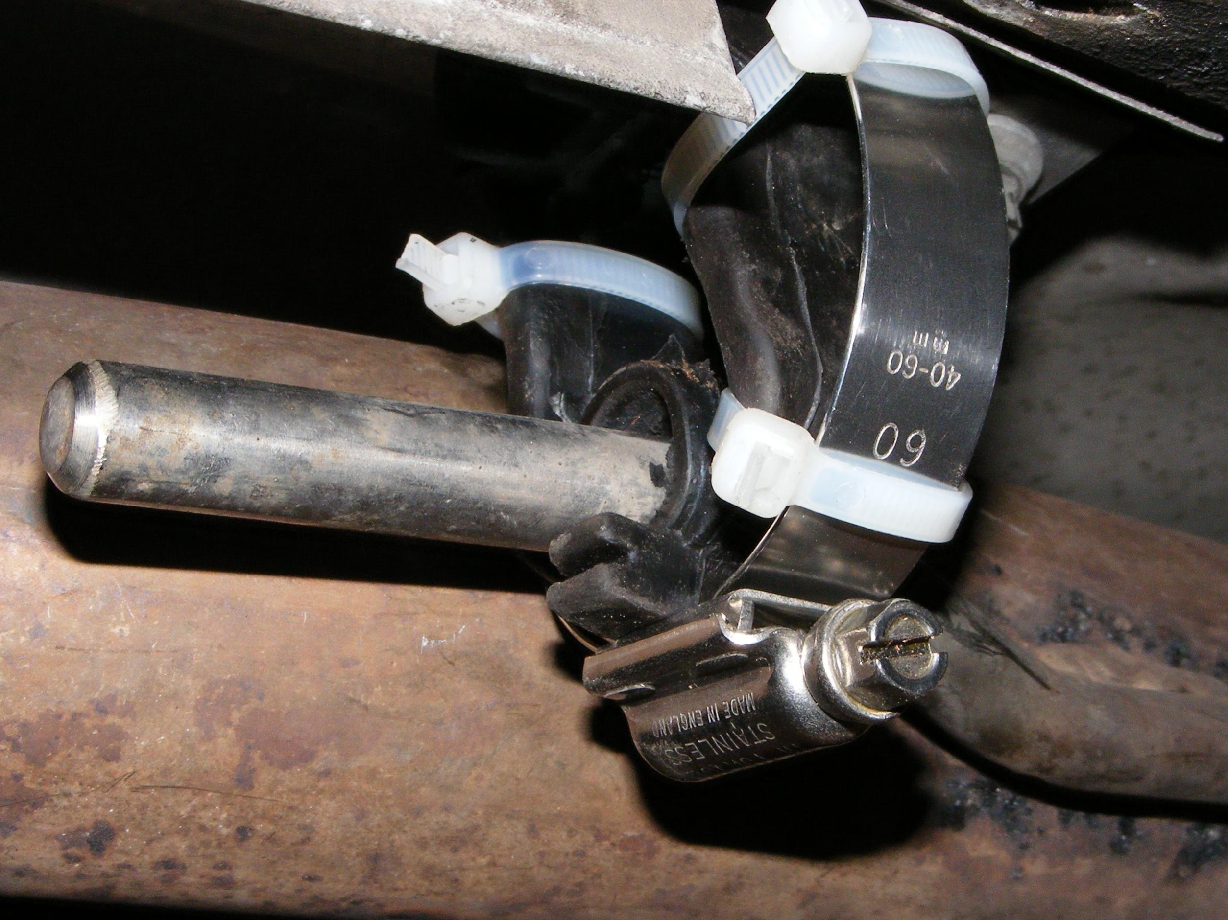

After wading through various threads to try and find a solution to the center exhaust hanger, I managed to get hold of a perfect sized jubilee clamp to surround the rubber on a standard mount. A few cable ties to keep it in place.. can make minor adjustments by clamping up again if needed... Let's see if the Magnex is knocking in the morning..
I'll have to take a pic of my center mount mod.....stainless jubilee clamp (same as pic) and a self tapper with a large head sitting slighlty proud screwed in the flat bit of the mount, this stops the jubilee clamp sliding off...period. Since doing this no more centre mount issues. Before, without the self tapper the clamp kept coming off.
Awaiting a pic as mine is fooked
Same here, the jubilee clip one works for me but ive had two snap, i think I need higher quality clips.

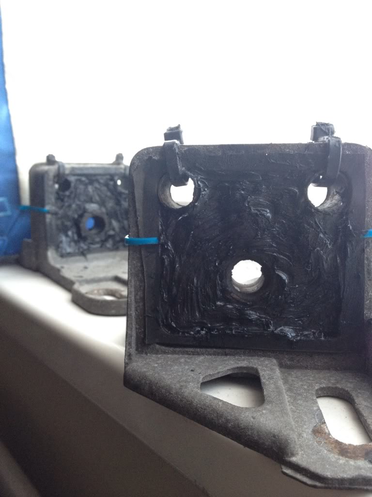

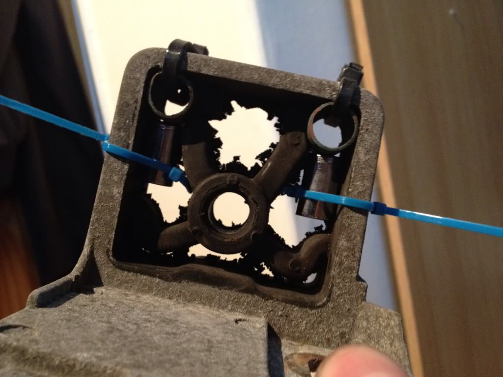

Over the last week i have been modifying a secondhand pair of mounts I got for £5.
This is how my piper was sitting on the old mounts:
The mounts already had some copper pipe in them, so I put some old sockets in the side and cable tied them in place. It looked like this:
After I done both mounts I got a tube of "stikaflex" silicone from screw-fix and filled in all the holes and gaps then left to dry for 4 days.
The finished product:

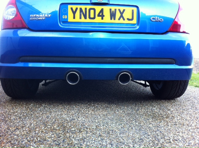

I had them fitted on Sunday night by a friend and the exhaust is sitting so much better. I haven't got any pictures of how it's sitting yet but I'll post one at a later date.
Just thought I'd share what I done :)

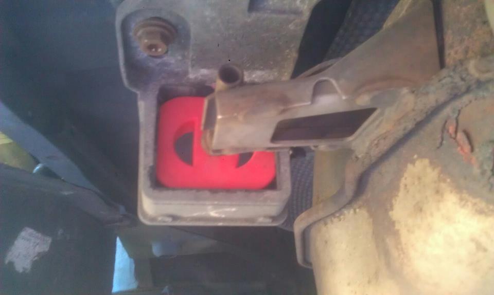

I did this exhaust mount mod this weekend and I am very impressed with how well it works. As mentioned above I turned the Powerflex EXH008 bushes 90 degrees so the holes provided were top and bottom. Cut 3-5mm off top and bottom to make a nice snug fit and used the top hole for the hangers. Then added a couple of tie-straps for good measure.
Exhaust is sitting perfect now (RS192), so for £10 I would say this mod is brilliant! Cheers

What have you ordered? I mounted my square powerflex ones in the hanger "flat" and just drilled a hole dead centre
