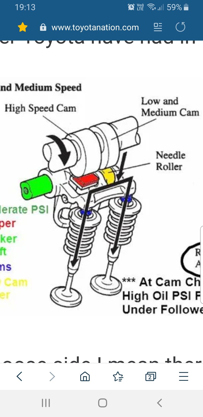

You measure the clearance between the smaller, low/medium speed cam lobe and needle roller on the rocker on the 2zz.
