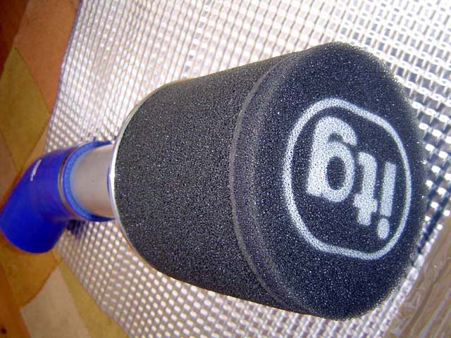

Viper is ok, not great and not the best.
Problems are:
- Tiny filter area, i can just get my fist inside. Sure its not paper so doesnt need as large a surface area, but compared to the maxogen, its about 40% less. If you look further, filter area on the 'sides' isnt utilised that much, so your left with the tiny tiny face on area where all the dirt gets trapped.
-If left dirty and dry, it WILL tear....and you cant replace the filter...major flaw.
-Lead into the filter housing when running ducting is...well, poor...no thought to flow stabilisation. The maxogen has thought into equal distribution and not inducing turbulance around the filter media.
-Long trunking required to feed it is convoluted and plays havoc with harmonics.
Its nets a gain when brand new, no trunking and bonnet open.
Maxogen is the best, imo on the market. Doesnt mean its THE best, but the best that is off the shelf available. And its not custom designed for the car, they have an airbox design that works well and they choose the applicable one to suit the flow requirement. Only flaw really is that its still warm where it draws its air in from.

When I changed from a viper to a maxogen the car was running leaner, checked on AFR meter. This meant fueling could be increased throughout the rev range. So maxogen is better then a viper.
IMO increases/decreases are small either way and you wouldnt notice them. If you want more noise though they are worth it.

When a car is on the RR with its bonnet open and a fan blasting straight into the un fed viper its obvious that its going to get colder air and better results than with the feed to the wheel arch, but your hardly gonna drive down the street with no bonnet on... are you ??? As far as I can make out, other than feeding the filter to the fog light/front grill, the wheel arch is the best place on the 1*2 to get a good feed. If you just point the feed to the filter its still going to be sucking in all the warm air trapped in the engine bay.
  Megane Trophy
A friend of mine works at pipercross and i asked him a few questions regardingn the fitting of my viper.
he says that on a RR they cannot replicate the wind speed that a car has while on the road.
he said sometimes when a cold air feed and the standard OE one are still connected then you get a problem with the air slowing down.
So has advised me to try leaving the standard feed there but try and get the viper as close to that as possible leaving the end open.
Then add another cold air feed to the bumper at a later date if need be to see if that helps/makes worse.
From my uni stuff, i can see there being a problem with turulant air flow, coming from a CAF and the OE feed. Air will be travelling at different speeds from each feed and when they meet a turbulent air flow is created right in front of the viper.
