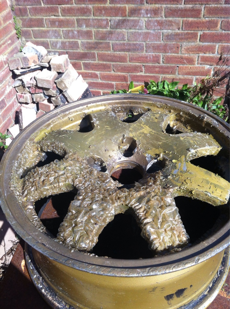

Use nitromors it will strip them
It won't! I bought some last month and they've watered it down now.
Bloke in the shop said the old formula (the GOOD formula) couldn't pass health and safety.

I have that starchem sysnstrip stuff, and its ok, still not great at removing factory paint. I placed it on some 172 rims that had been painted white. Admittedly, the white literally fell off, but it left the original paint below and even with 2 more application it only softened it.

you need an immersion stripper for wheels really, the one i use is nasty to say the least but it will strip a clio wheel to bare metal in about 5 minutes at the most, good quality epoxy primer can take an hour or so to remove though!!
