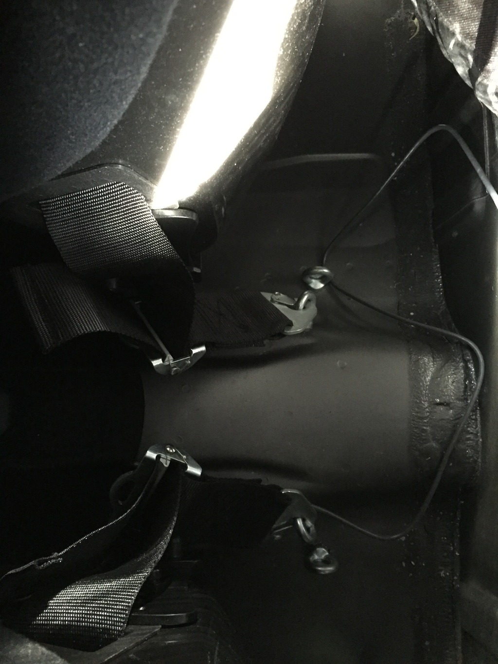

@M.C.. where abouts did you place the holes in the floor for the lap strap eyebolts? how far back from the seat?
They are about 150mm back from the slots in the seat, the inside one is going through the exhaust tunnel and the outside one is as far out as it can go.
Not the best picture but hope it helps

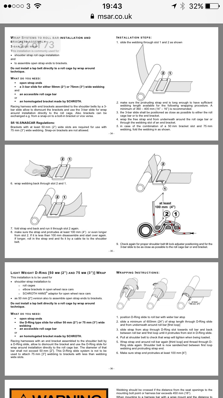

Now I read that they can cause "compression of spine" if an accident occurs, so what I do.... unravel the latch, undo the wrapping and then try wrap it round the cage bars?
Anyone local who knows how to wrap belts round bars? or is there an easier way (Not gonna weld eyelets on. or drill the bar)
Stuiemc
  Audi RS3, Clio 172
Dead easy mate! There's a sticky in the guide section on how to fit harnesses.
chris blue
  clio Sport 197
Yes- looks fair complicated to me, thats why i prefer people showing me, then i remember for life
Looks like the bleeding Krypton factor, but reckon you lot will suggest Generation game!
Good game, good game (RIP Brucie)
Ed: Actually, having read it a couple times, dont look too bad. just need a 3 bar slide then?
