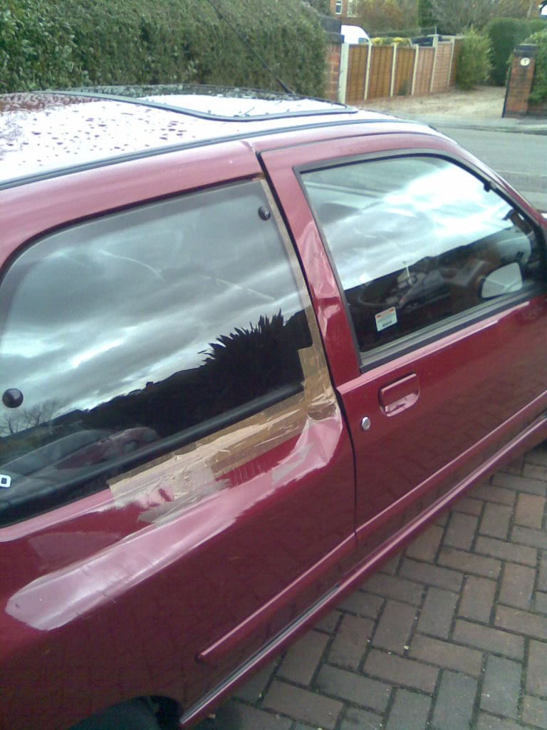

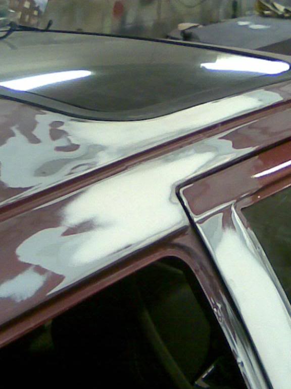

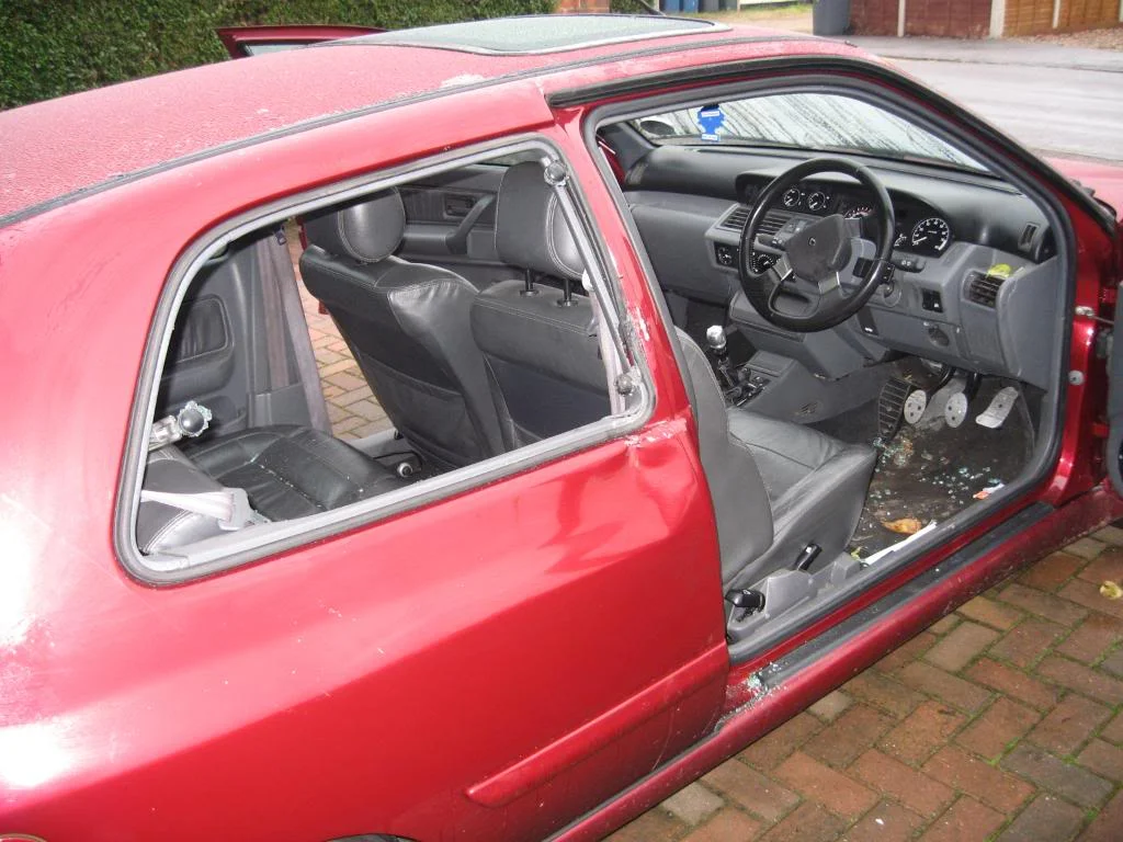

As you all know I was involved in a bit of a nasty smash on 5th Nov 08 :cry: and my valver got a busted rear quarter, B-pillar & creased roof :evil: only 2 months after achieving mintness :mad:
But this is what happens when chavved up corsas have a go at a Naples :nono::rasp:
But the naples is getting fixed :D Here's the latest pics in her current state of bodged repair befor she goes off to the garage to get the brakes fixed then the bodywork sorted and back to mintyness

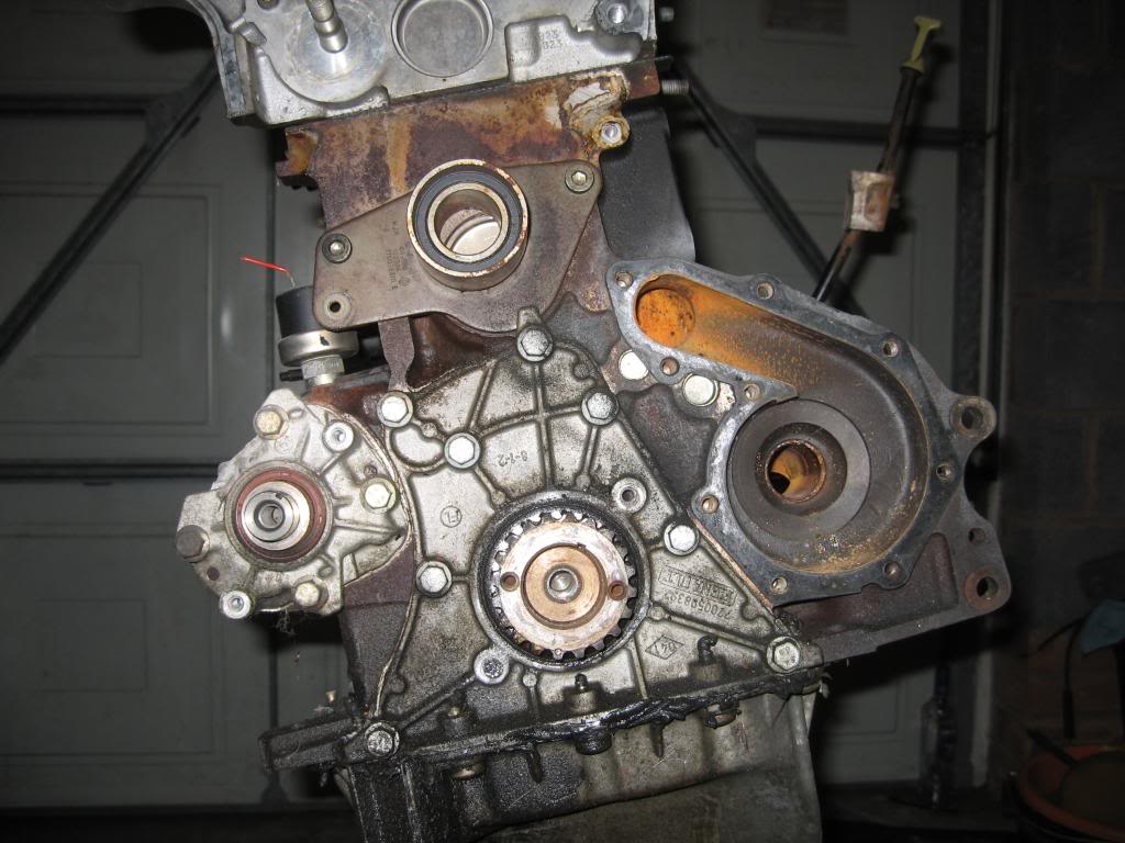

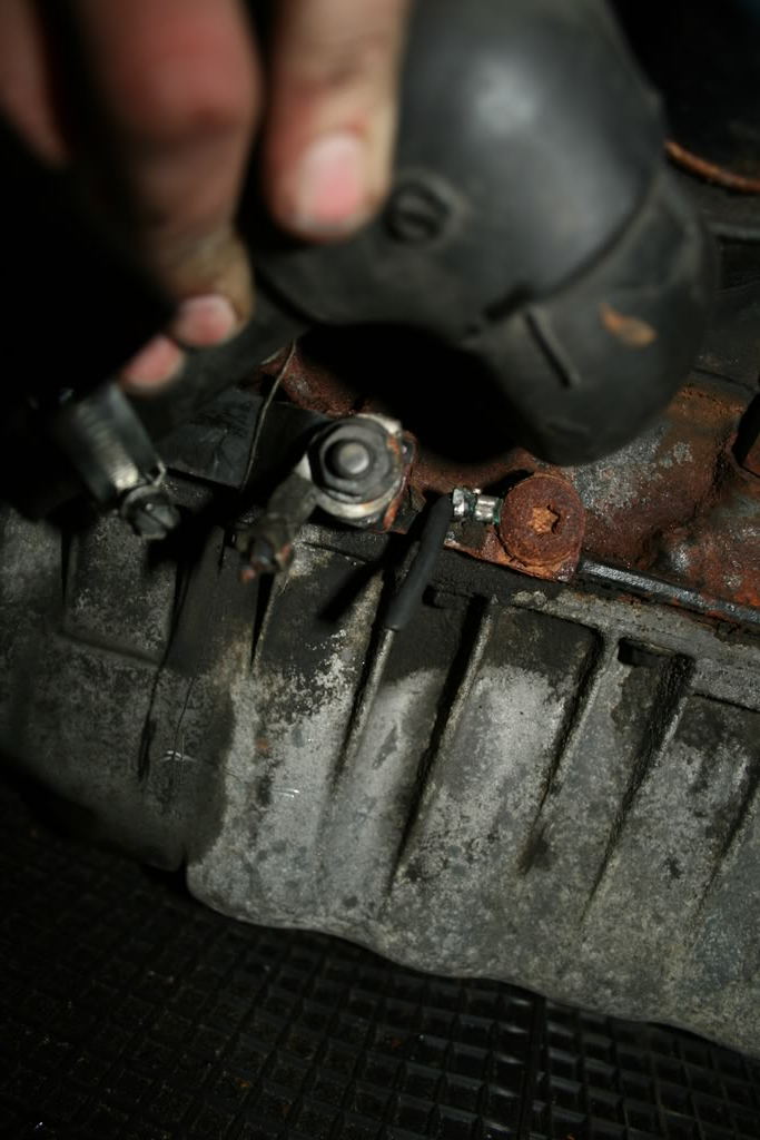

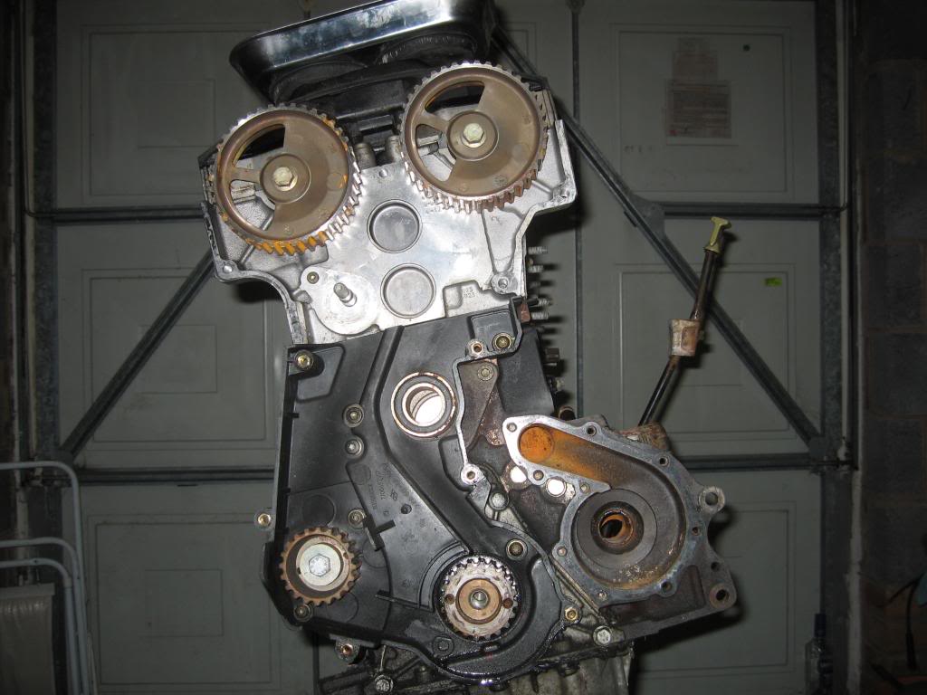

I've got a few questions, can anybody tell me what sensors these plugs are for?
I'm assuming this 1 is the oil level sender :S
And what are these 2 for?

oil pressure switch i believe just has the one wire coming off of it and the piccy below will be the oil level sensor

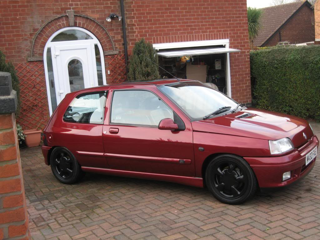

Get some full pictures of your car up mate. Looked mint when I came and got that rad.

As said first is a knock sensor, second the oil pressure switch and the third are just engine earths.

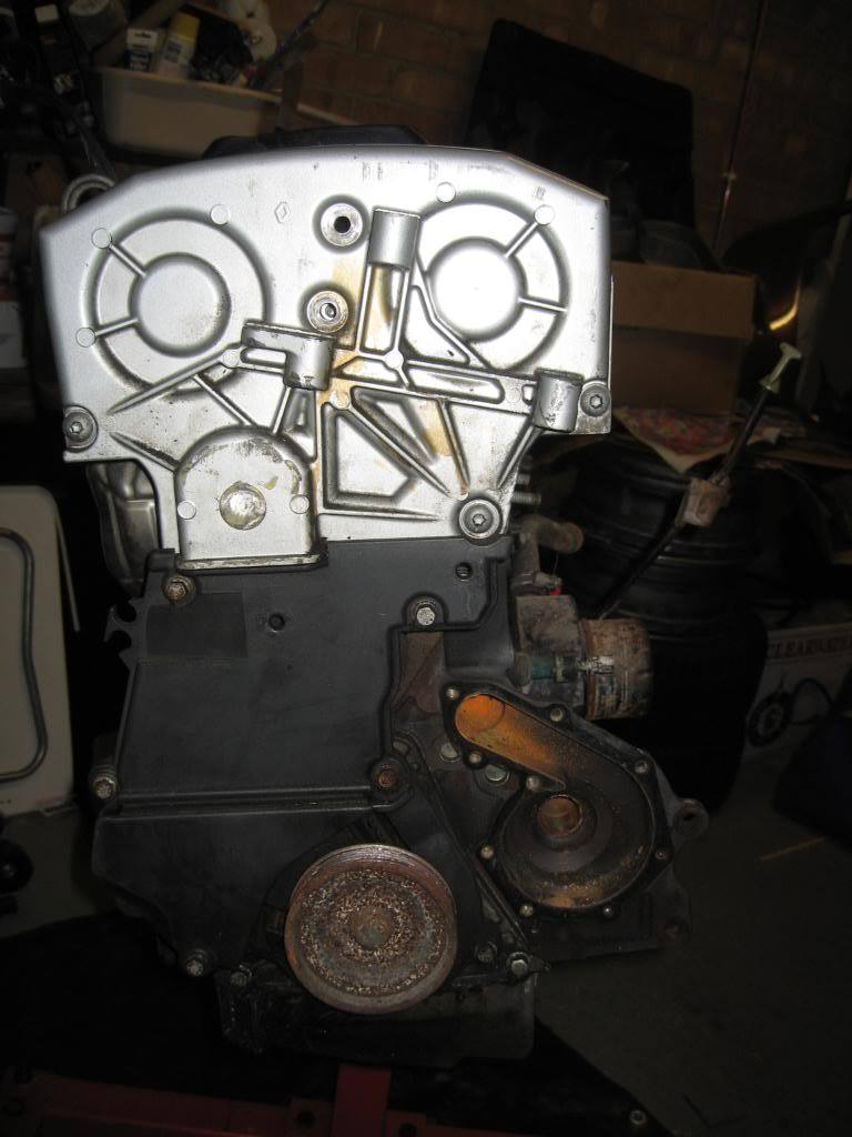

Engine in order of strippage

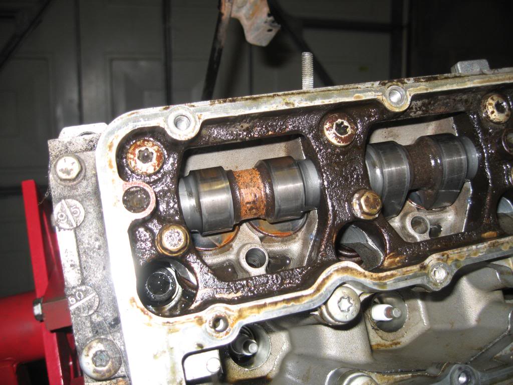

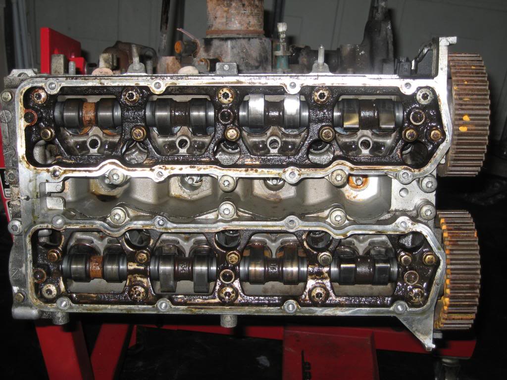

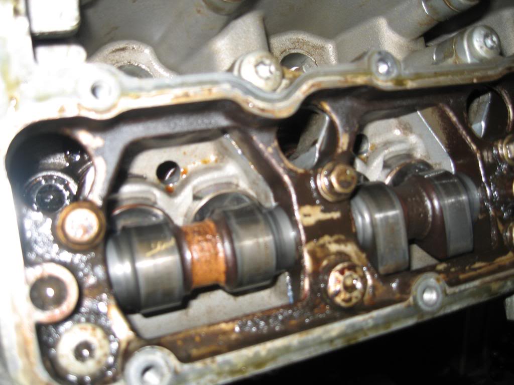

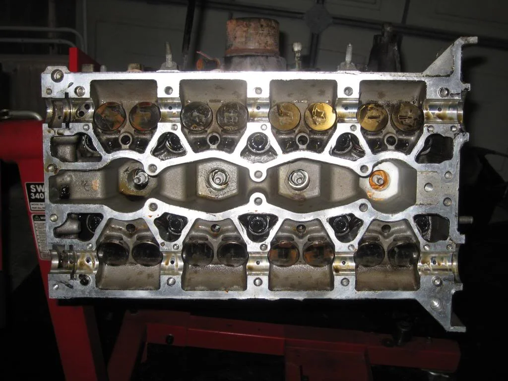

Can anyone tell me if I should be bothered about this rust on the cams, or whats caused it? :S
Cams out

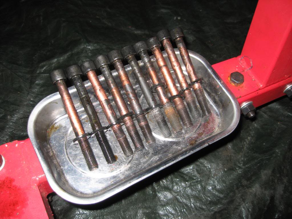

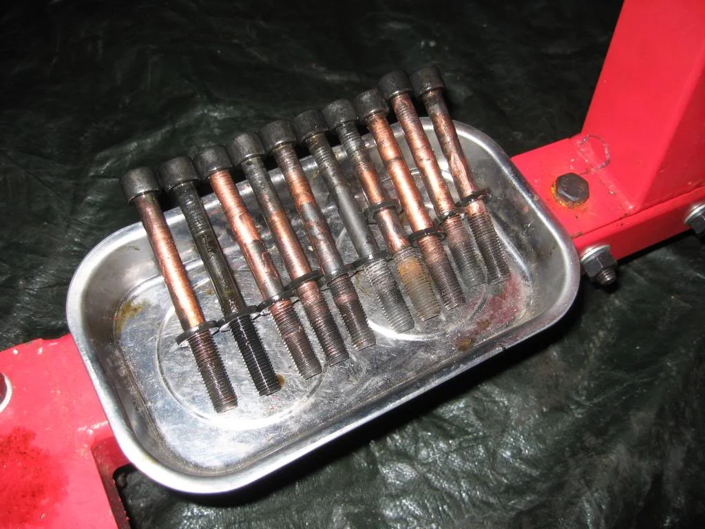

The state of the head bolts, swimming in copper grease :eek:

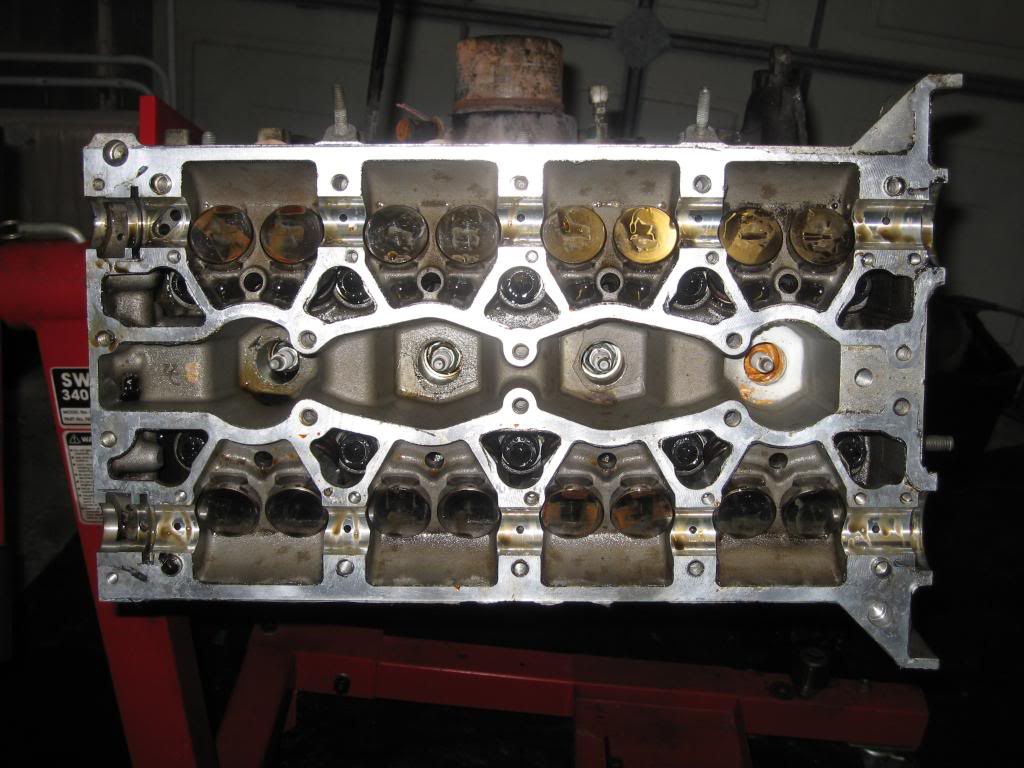

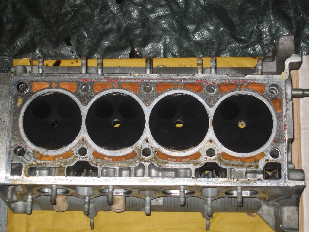

Head off

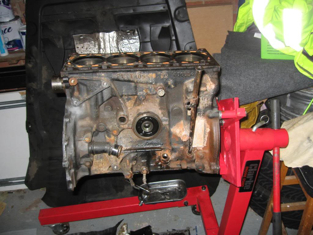

The block in all its glory

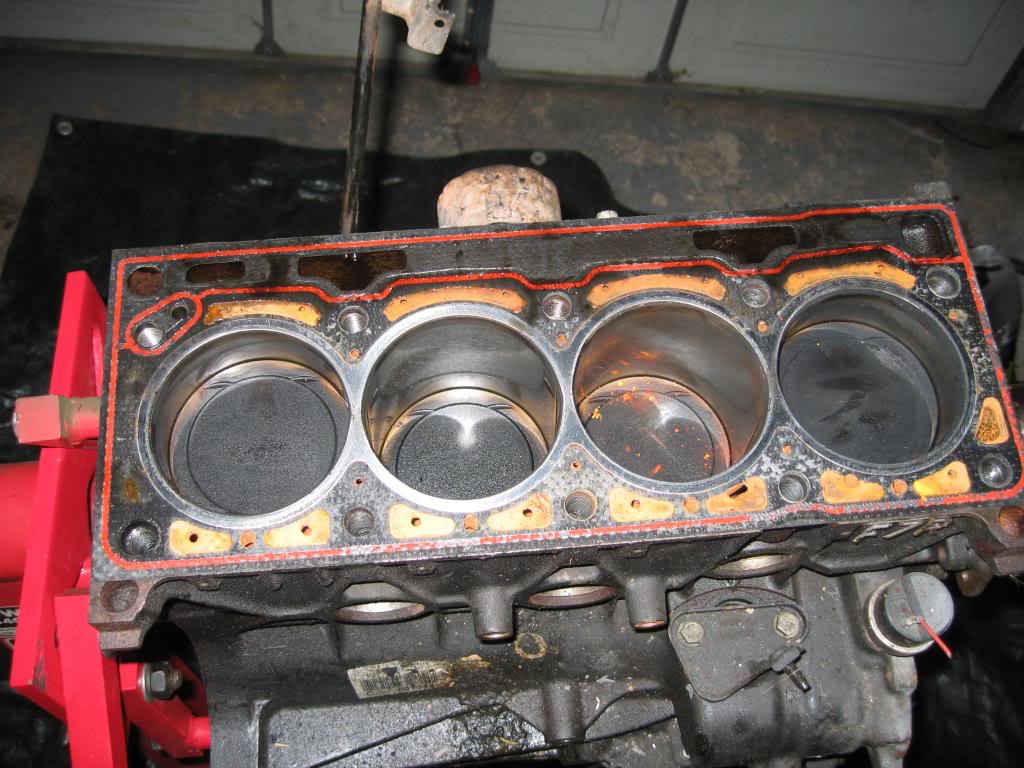

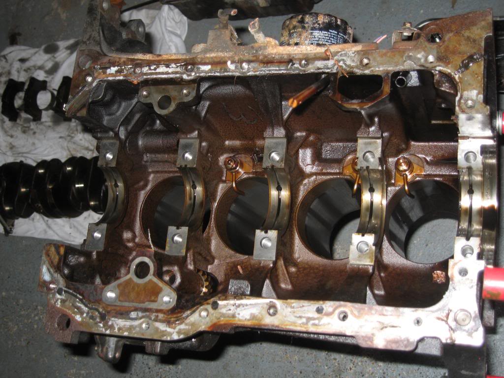

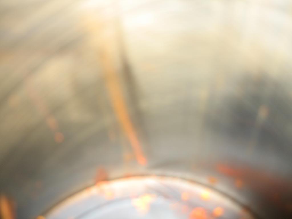

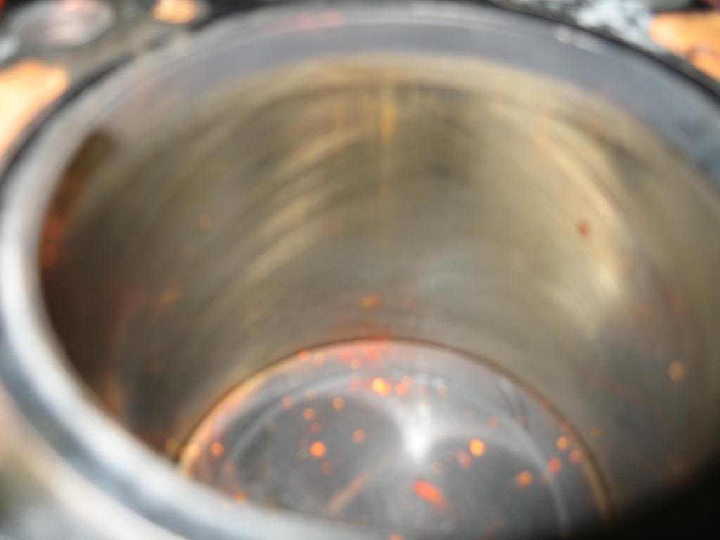

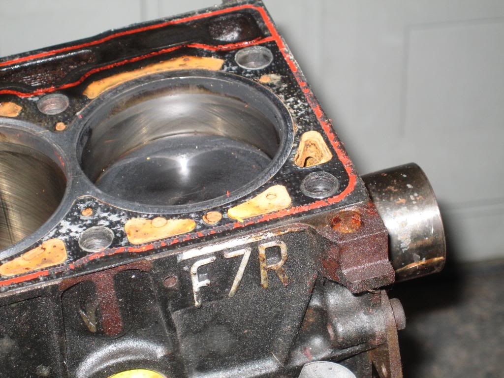

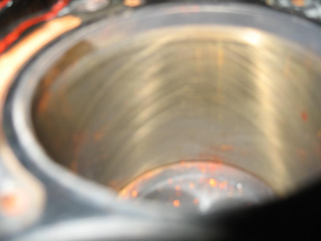

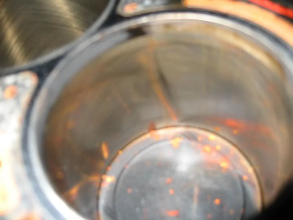

Some not so good photos of the cylinders (piss poor photography skills to blame) :eek:
Any educated opinions of the state of the engine would be appreciated :D

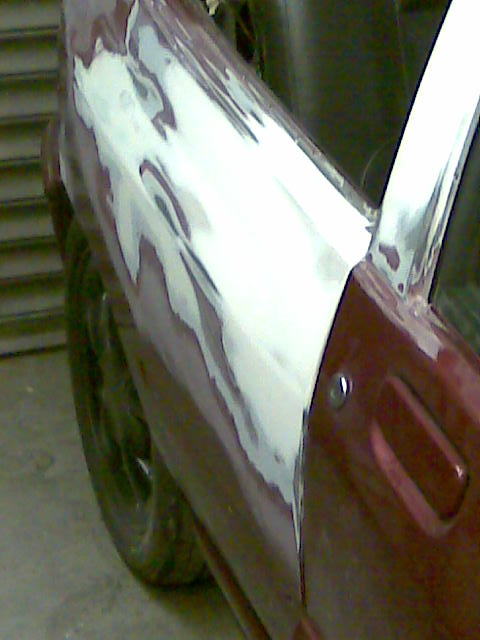

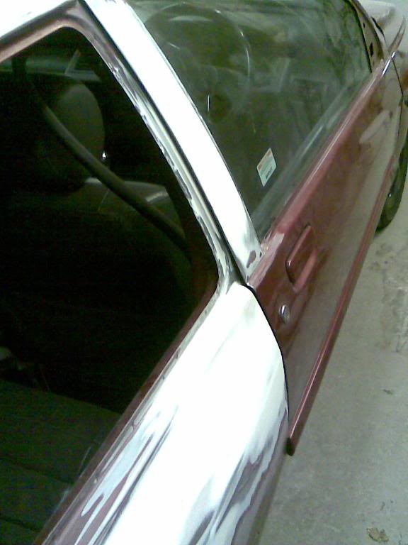

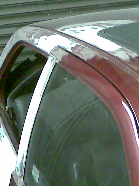

Now the important part of the project so far, the unbending & respray. Just a few pics of the work in progress :cool:
  f**ked ph1 172
tbh you cant really tell from the pics. the bores *look* ok, have a feel around the edge where you can see where the rings have gone up to, and have a feel all around it to see if there is any lipping.
the hone marks look ok, but obviously get it rehoned!

The bowls on the head look very coked up, nothing a good clean wont sort but I'd check the AFR if you keep the standard flash on the ecu!
  f**ked ph1 172
tbh, i did think that, but as he was going to turbo it i decided to leave it out as he'll be running a remap.

I did notice how coked up the head was & was quite surprised but not too bothered as the whole thing is being rebuilt with new parts & obviously a proper map
I'll be getting a rebore as well, I just need to measure the cylinders to see which pistons I need to get as I don't want to go too far with it unless it's necessary
Haven't got a clue of the history of the engine, hence I got it cheap, but the plan has always been a total rebuild/learning experience instead of just dropping it in straight away
  f**ked ph1 172
what i'd do mate is get the pistons then give the block and pistons to a machine shop and ask them to bore and hone it to suit them.

I've had the bores measured today and the good news is that the block hasn't had a re-bore, it is a bit worn but not excessively, so I'll be ordering some 83mm pistons & getting the block re-bored to fit them :D
thats not rust on the cams, its a band of yellow pant used to indicate that they are indeed 2ltr cams.

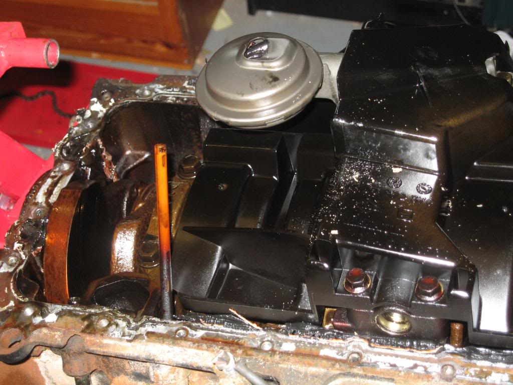

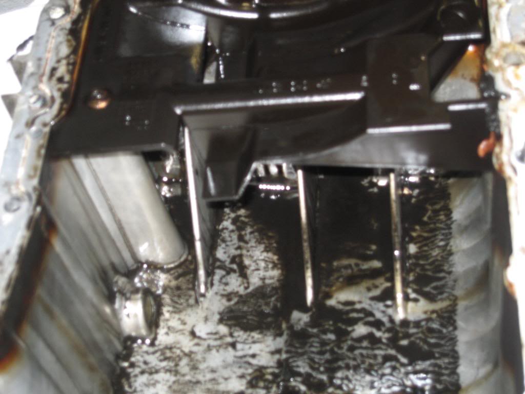

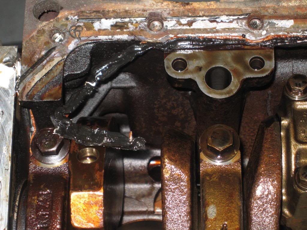

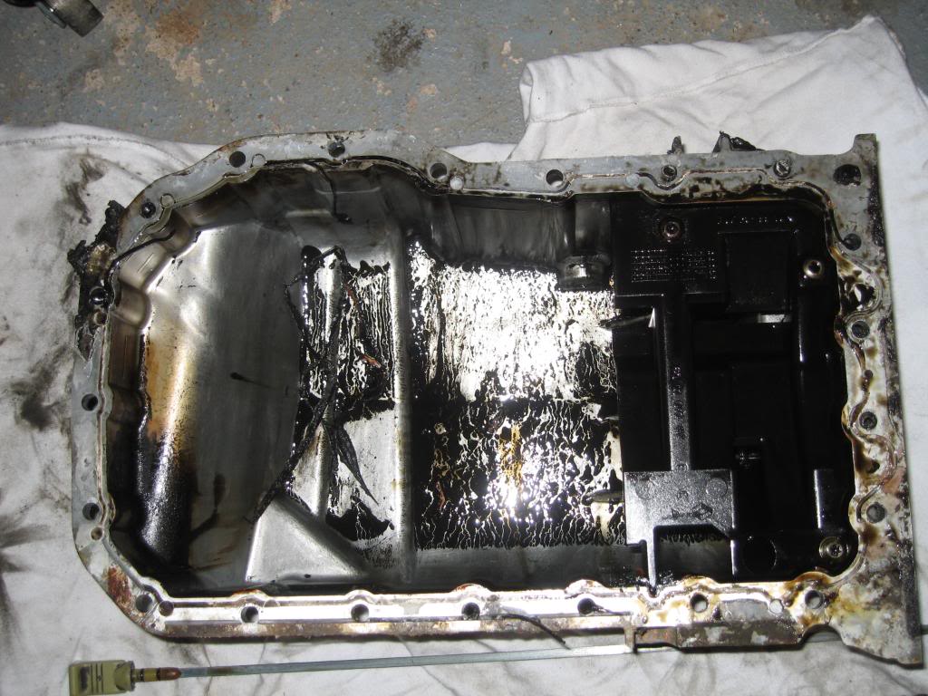

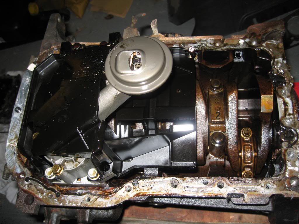

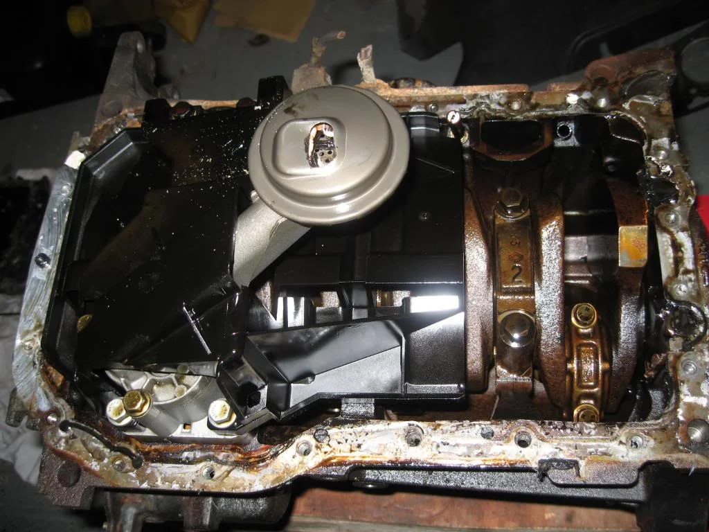

Took a bit of persuading with a T50 bit, blowtorch, icecube and a hammer :mad: and got the sump off

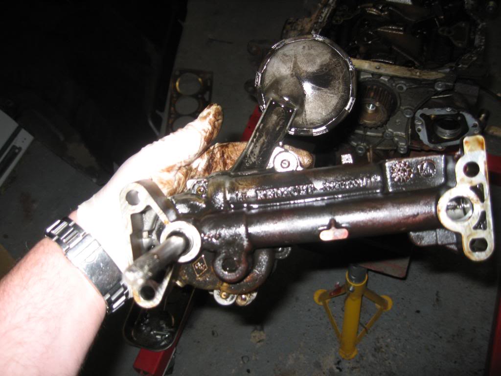

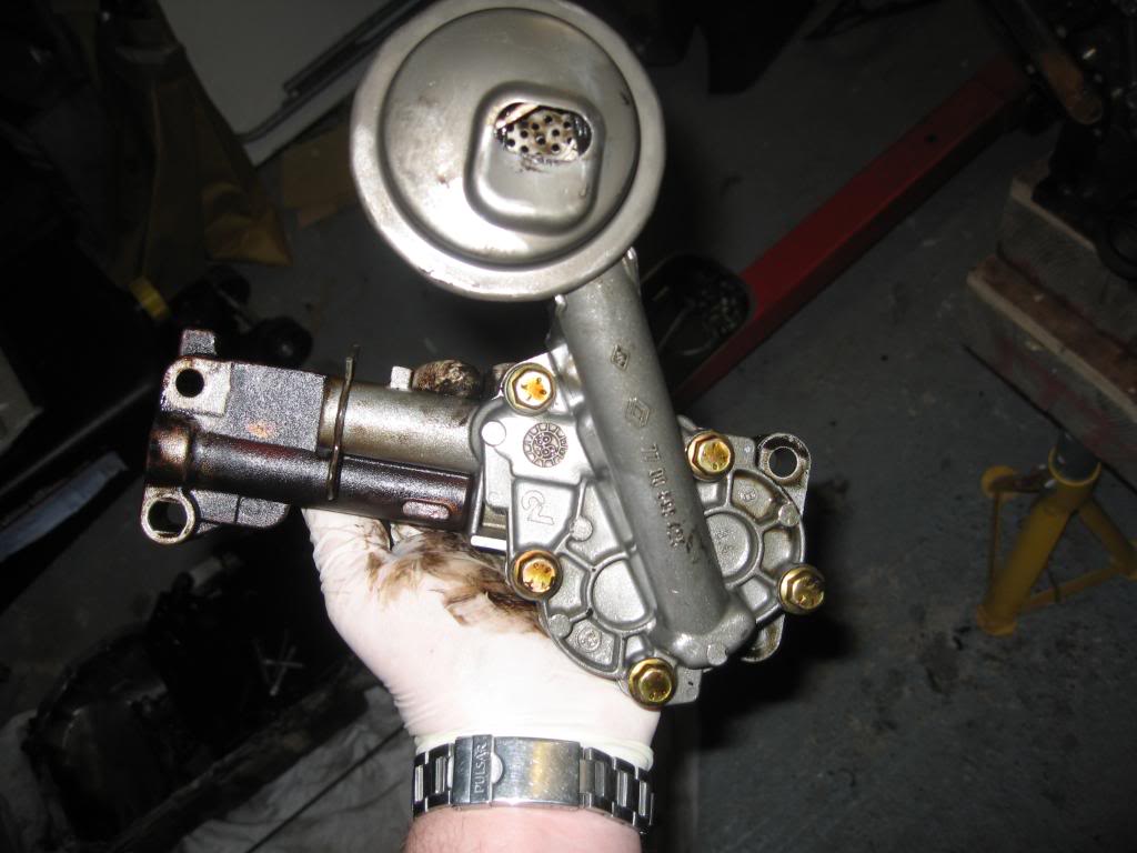

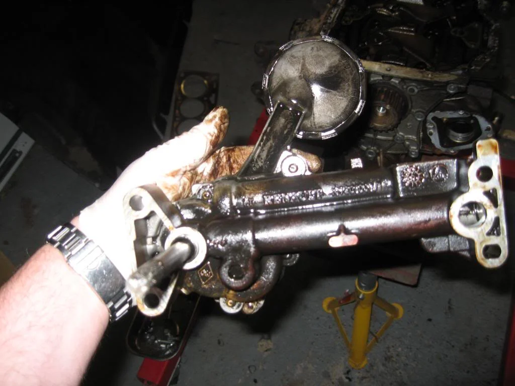

Couple of gratuitous oil pump pics, I don't think its very healthy as it doesn't turn very easily and clunks a little bit :S not too bothered as I'm getting a new 1 anyway
Oil pump gone and that gasket s**t is fuckin everywhere :mad: I want a proper gasket for this not the liquid s**t renault say it should be :nono:

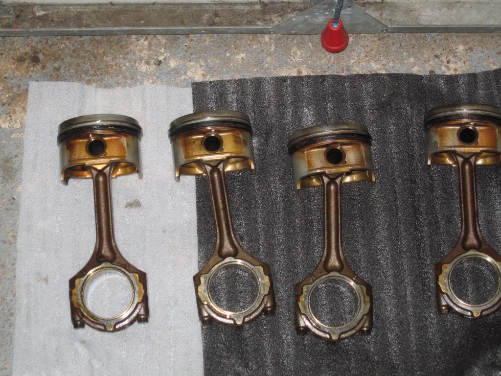

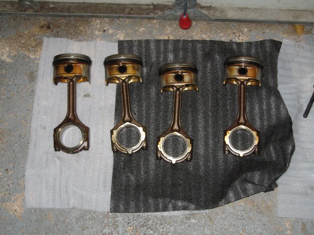

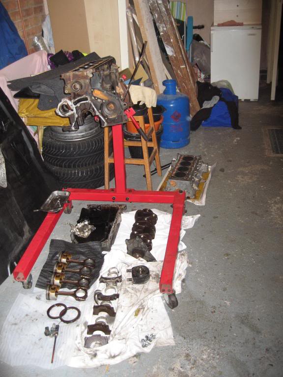

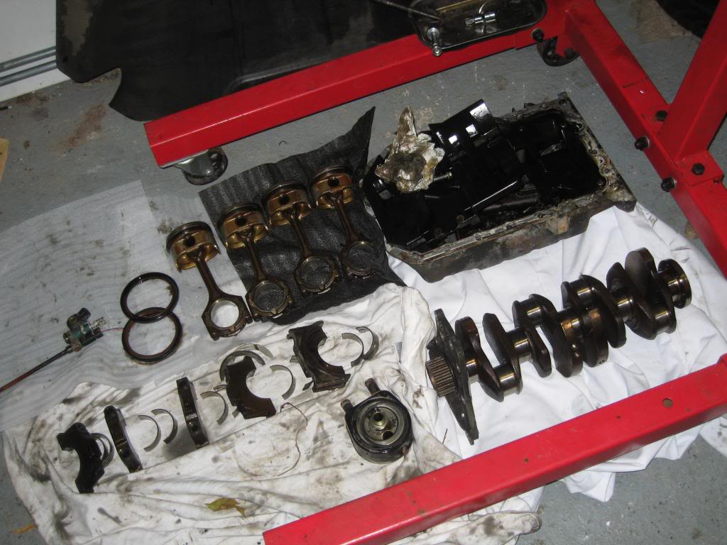

Next out was the rods & pistons

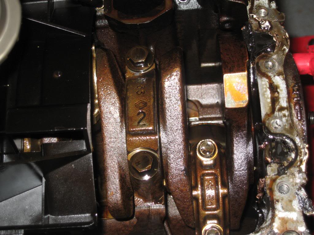

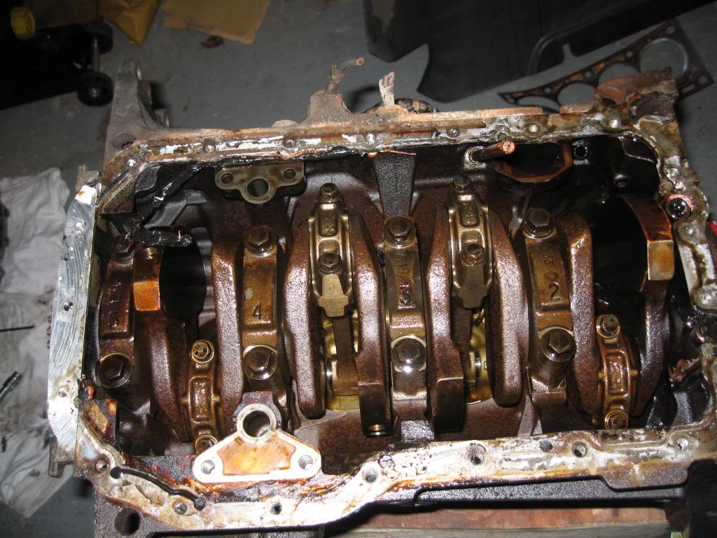

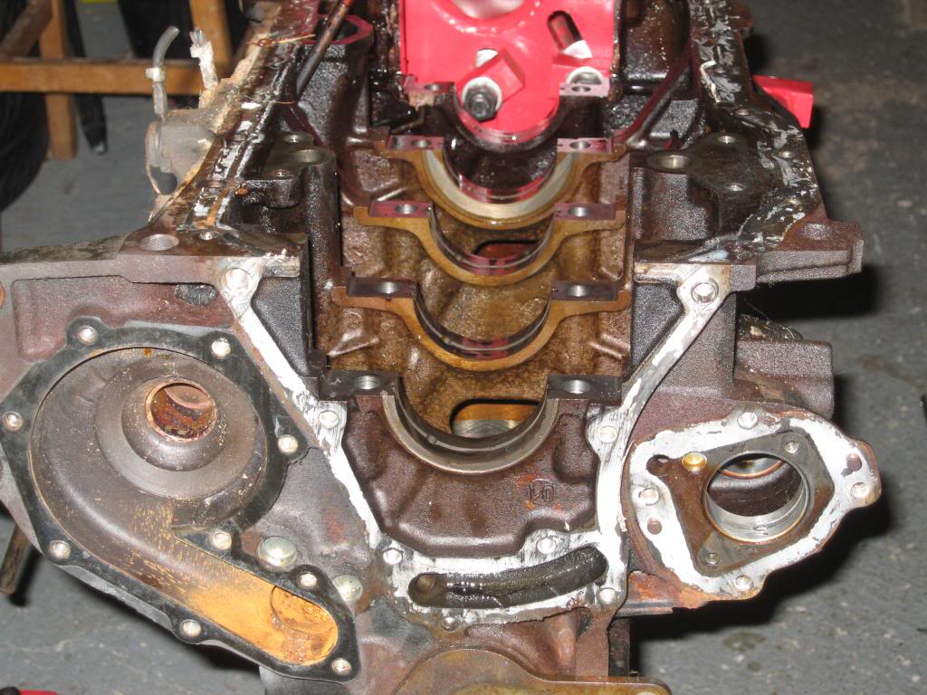

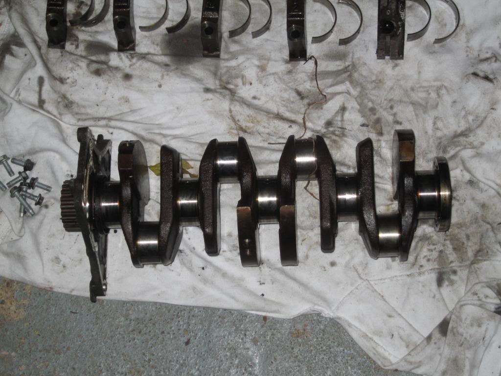

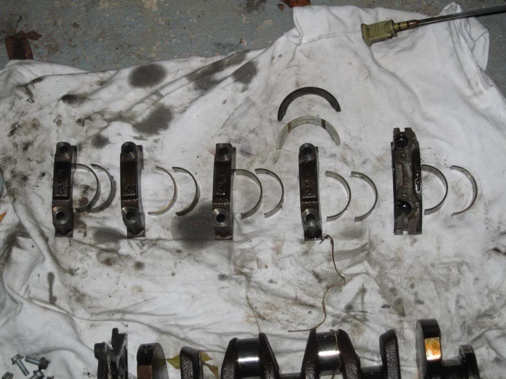

Next off was the end caps, I need some educating here :rolleyes: what are these shells/bearings called? I already know the crank big end bearings as they're with the rods, just after the name of each 1
Then it's out with the crank
Next to come off was the oil cooler
I intend to put a mocal cooler on, do I still need to keep the std one? Is it there to help get the oil up to temperature or can I bin it? :S
My nicely organised floor full of engine :D
I've had the crank and the block measured up and I'll be ordering the rods, pistons, gaskets & bearings etc on monday :evil:
  f**ked ph1 172
big ends on the con-rods
and the others are main bearings and the half circle things are thrust bearings./

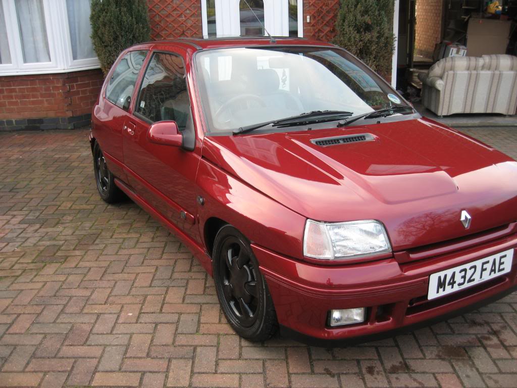

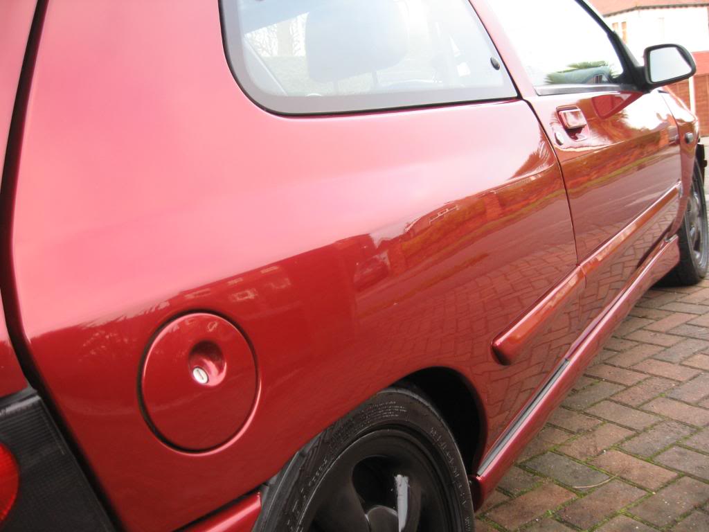

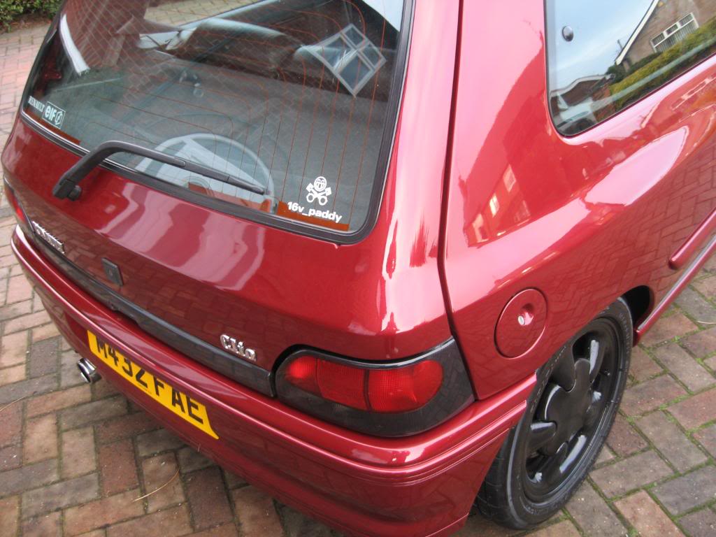

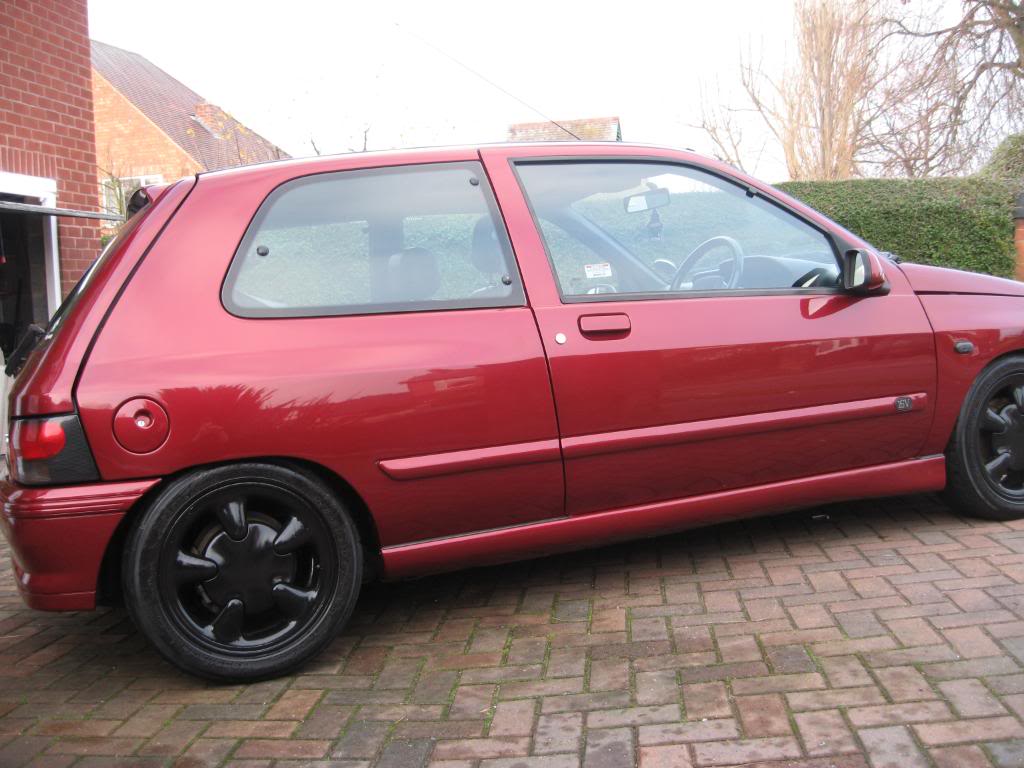

I finally got her back on christmas eve, but since I was working all over christmas I didn't get chance to take any pics :cry:

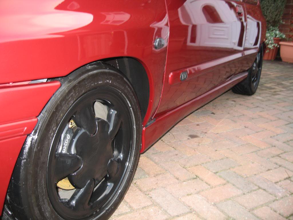

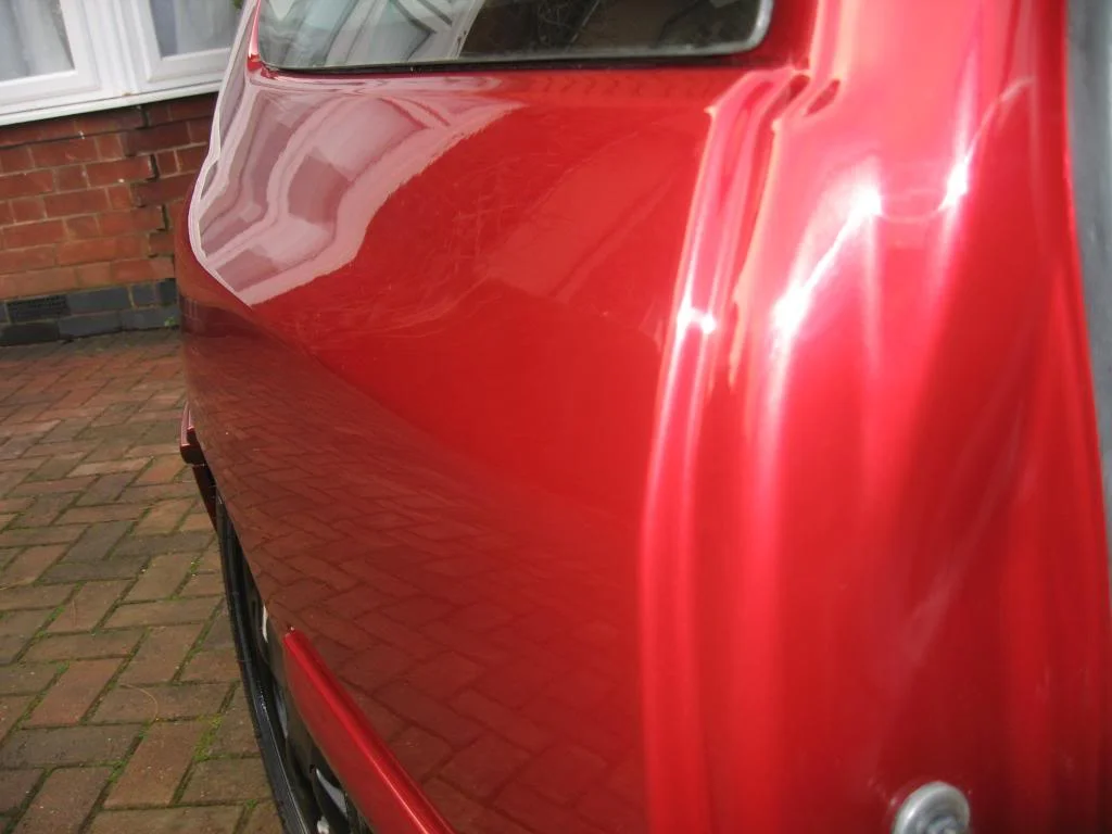

But I've been busy all day and she's had a full on valet, wash, polish, wax inside & out so she's back to total mintness :D

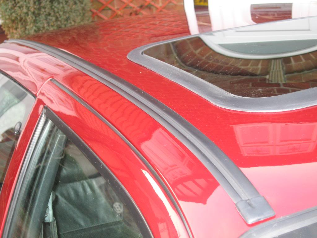

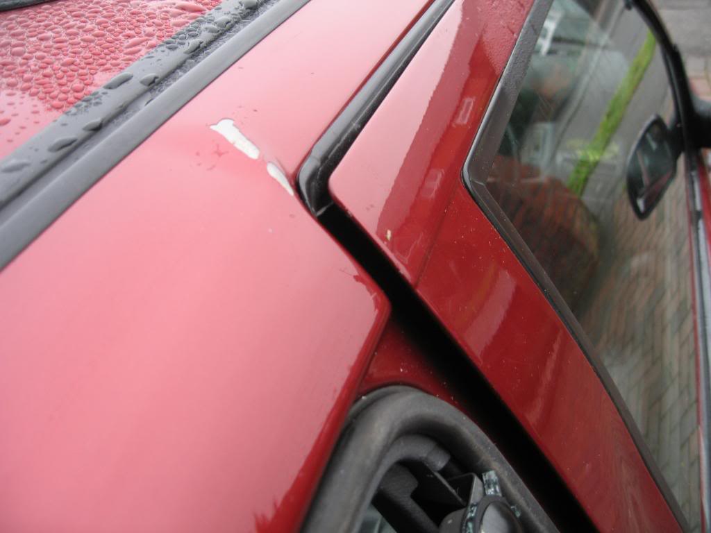

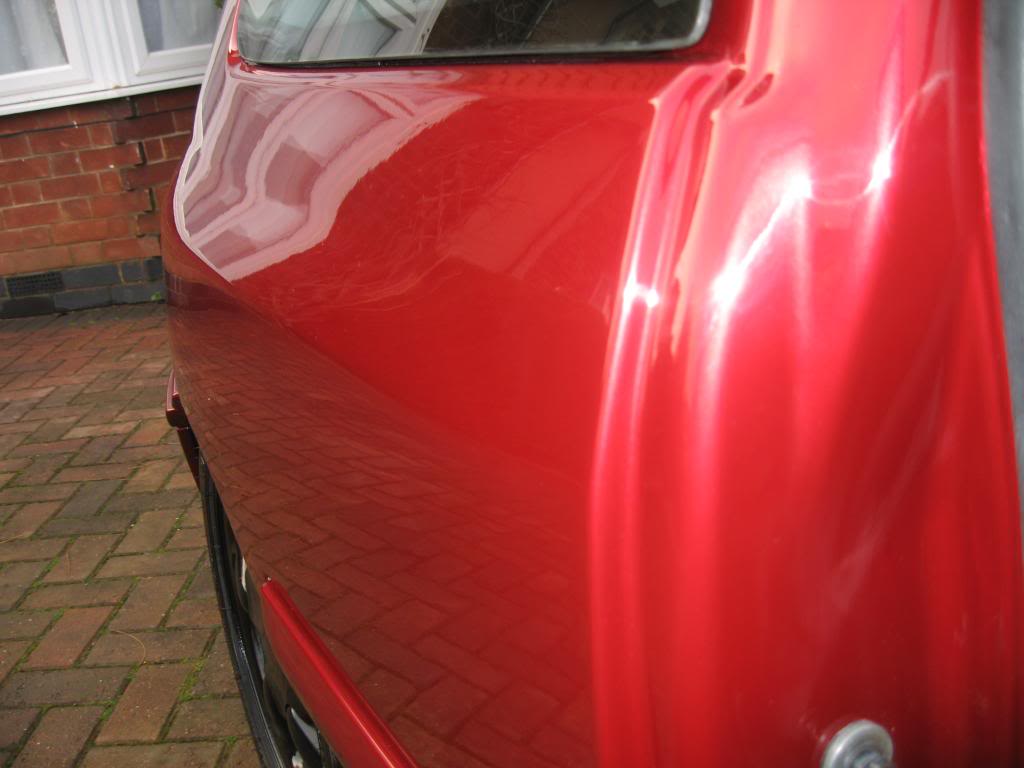

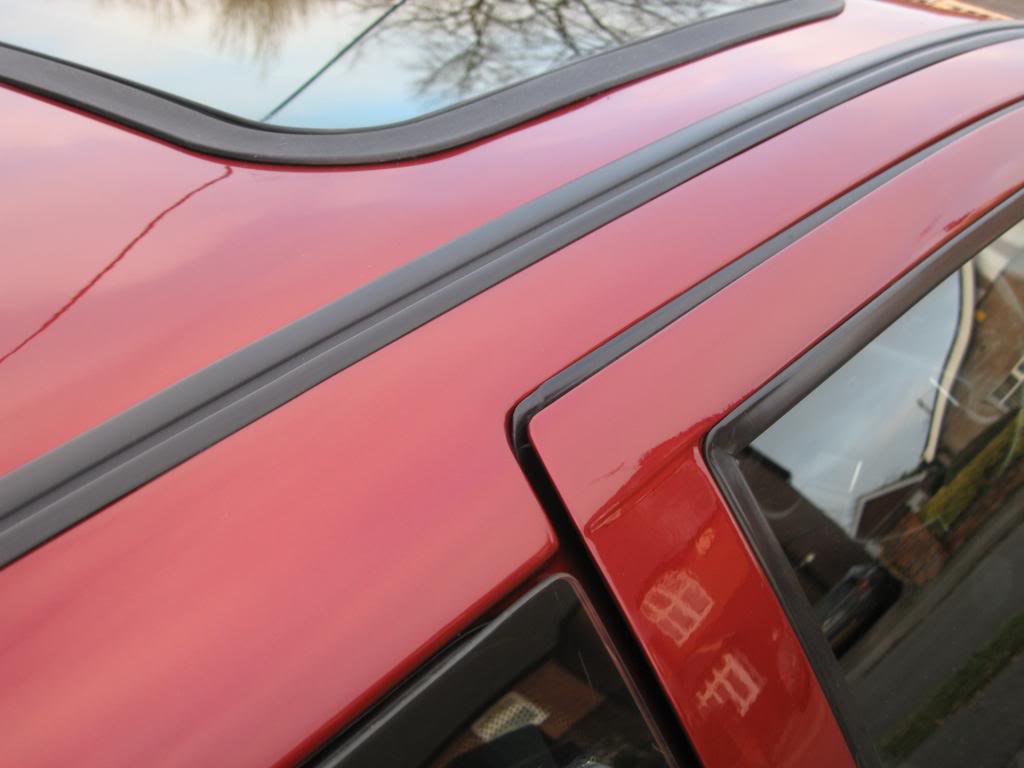

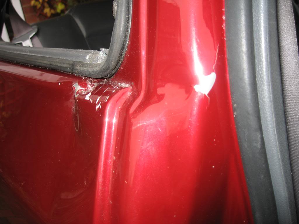

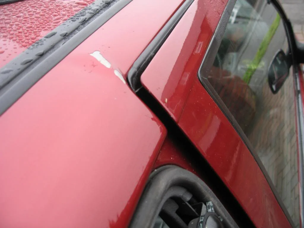

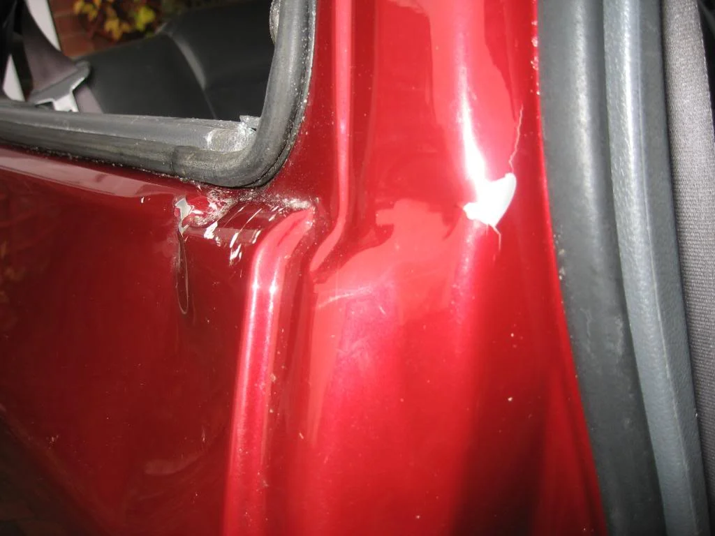

Some before & after pics of the damage & repair

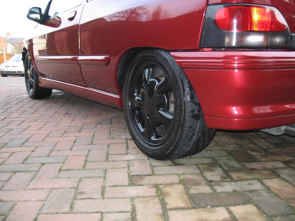

Now some gratuitous naples porn :rasp:

Stunning example mate, will be even better when the 2.0 goes in!

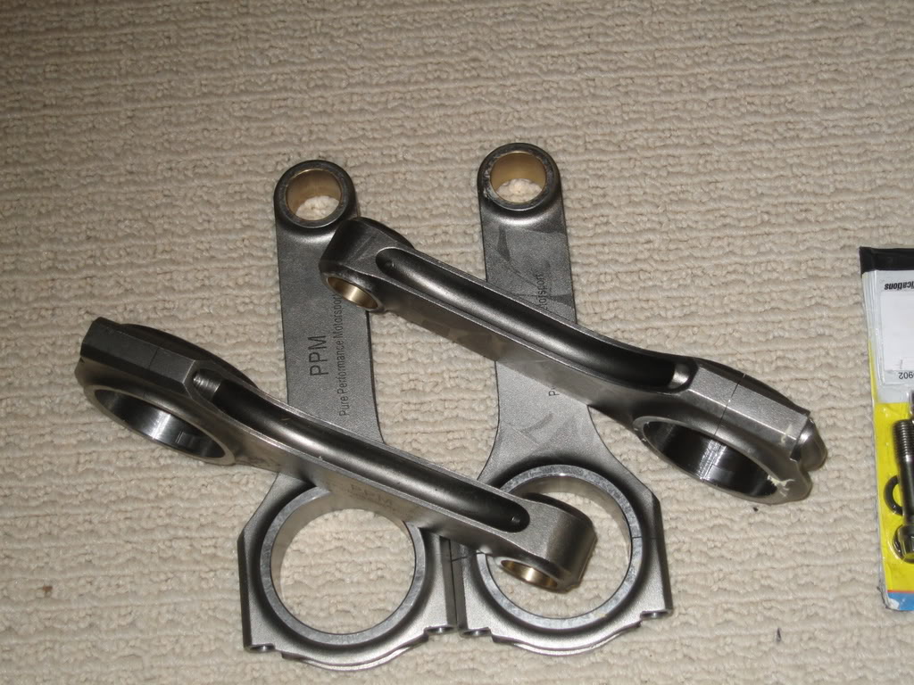

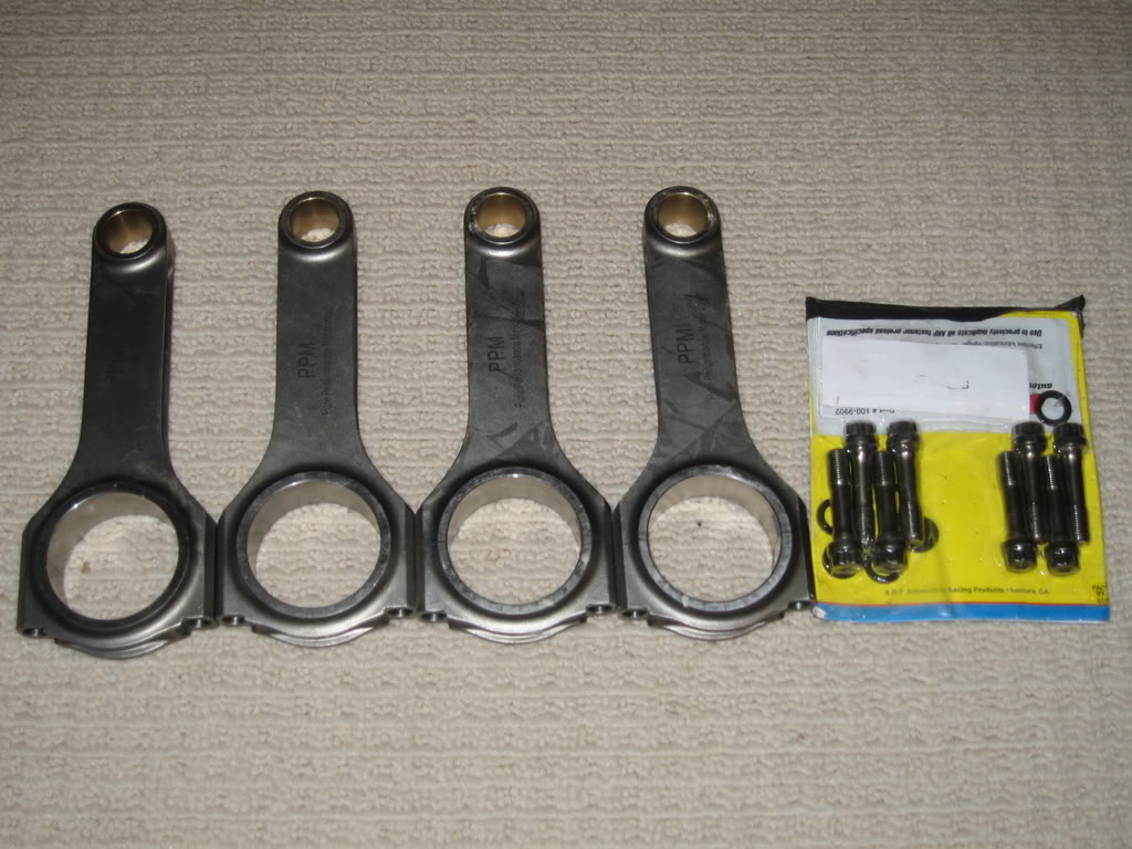

Woke up not long ago to find a nice box on my doorstep, opened it up and look what was inside
Some lovely Forged H-Section con-rods with ARP bolts :cool:
