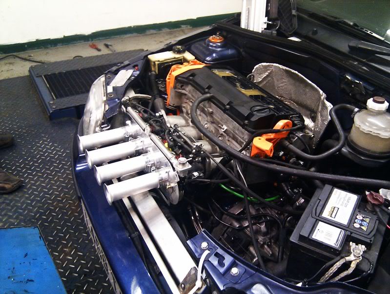

Minor update...
Swapped my 90mm trumpets for 120mm ones
Sorry for the crap instagram pic
Also found one of my injectors was missing - which was causing a bit of a missfire and apparently ruining my MPG quite a bit
Had 8 injectors so played around till I found a good set - car feels loads smoother already and I'm getting 38mpg again LOL!!
I don't know if it's the injectors or the trumpets but it sounds a lot throatier now and pulls better from low revs.
Off back on the rollers next month hopefully to do some back-to-back tests with the 90mm/120mm trumpets and give the map a tweak :)
In THEORY (and a few people have tested them) - the longer inlet length should bring the torque curve a bit lower down the revs - so there's a bit more mid-end grunt
I figure as renaultsport designed the original inlet to go all the way up and over the engine to get the longest length possible there must be something in the theory :)

General rule of thumb is longer is better for low down power and shorter is better for high rpm power.
The length you have now is probably optimum at around 10-12 Krpm though, so it really is a case of more is better.
Correct... but you kinda have to stick to the physical dimensions of the car
The length I had before was optimum more around 12-14Krpm so at least I'm going in the right direction lol
A few of the 106 lads tried curved trumpets - some even 180 degree ones that came up and over the engine. Got some interesting results
I think you could get 150mm trumpets on the Clio if you angled them down 10degrees or so - but there isn't a filter big enough for them and Jenvey don't make anything over 120mm so you'd end up in custom parts territory pretty quickly
  182/RS2/ Turbo/Mk1
Yeah its a case of just putting the longest ones that fit in fairly easily and just live with it, anything else isnt worth the hassle for the relatively small gains.
I don't think it would fit
I run
60mm carbon reverie backing plate - with the C603D filter
It gives 150mm internal clearance - but that means really you can only run 120mm trumpets as you need air space between the end of the trumpets and the filter
You could try the C604D which gives 125mm internally - but it wouldn't fit with the bonnet on lol

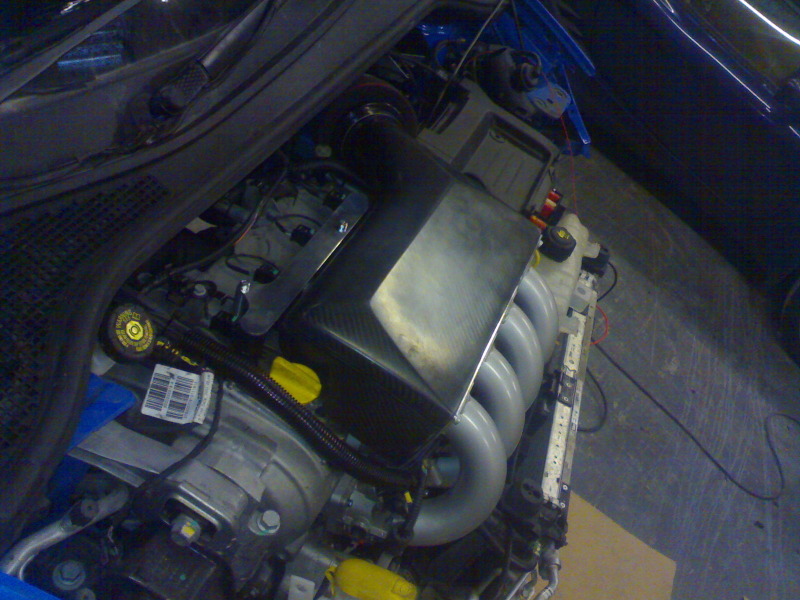

lots of up and over testing done on the 197 a few years back too (at omex, back when i was working there)
final product being this
