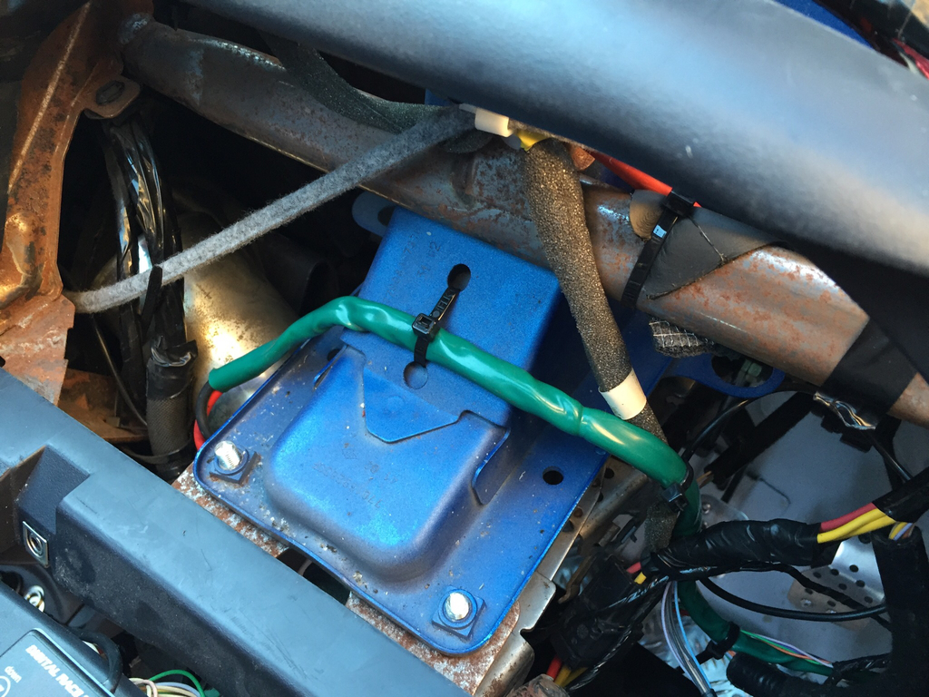

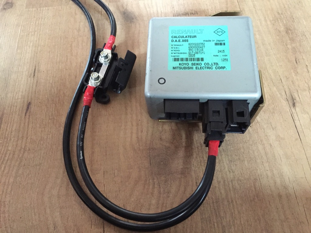

Made a start on the epas wiring, opened the power connection plug and managed to get new cable in there to cut down on the number of joints, managed to stab myself in the thumb doing it lol

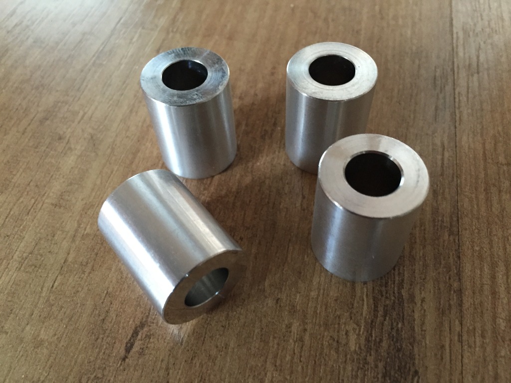

New steering column spacers

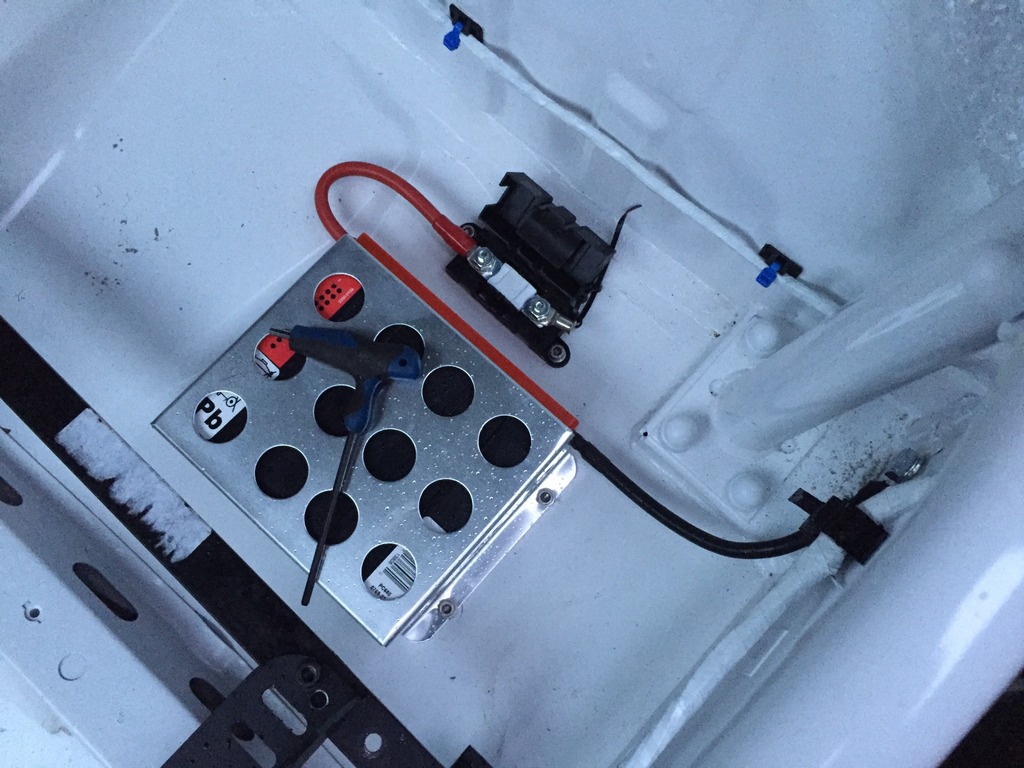

Fuse looks a bit close to the ecu - think it needs to be near the battery!
Akay
  Clubman Cooper S

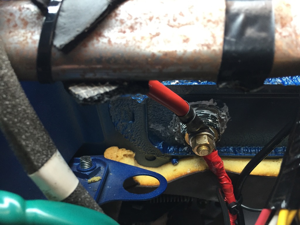

Ah fair enough! Was the longacre easy to fit? Ive got one and a holesaw to fit under the scuttle tray!
yeah, easy enough, luckily I already had the right hole saw, I put some silicone round it to make sure it was well sealed too. Glad I didn't bodge it with a grommet now I can lift the epas power off it :)

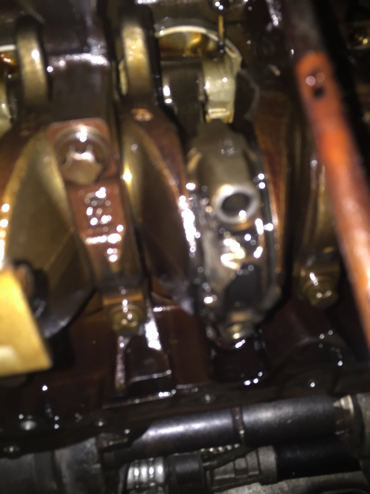

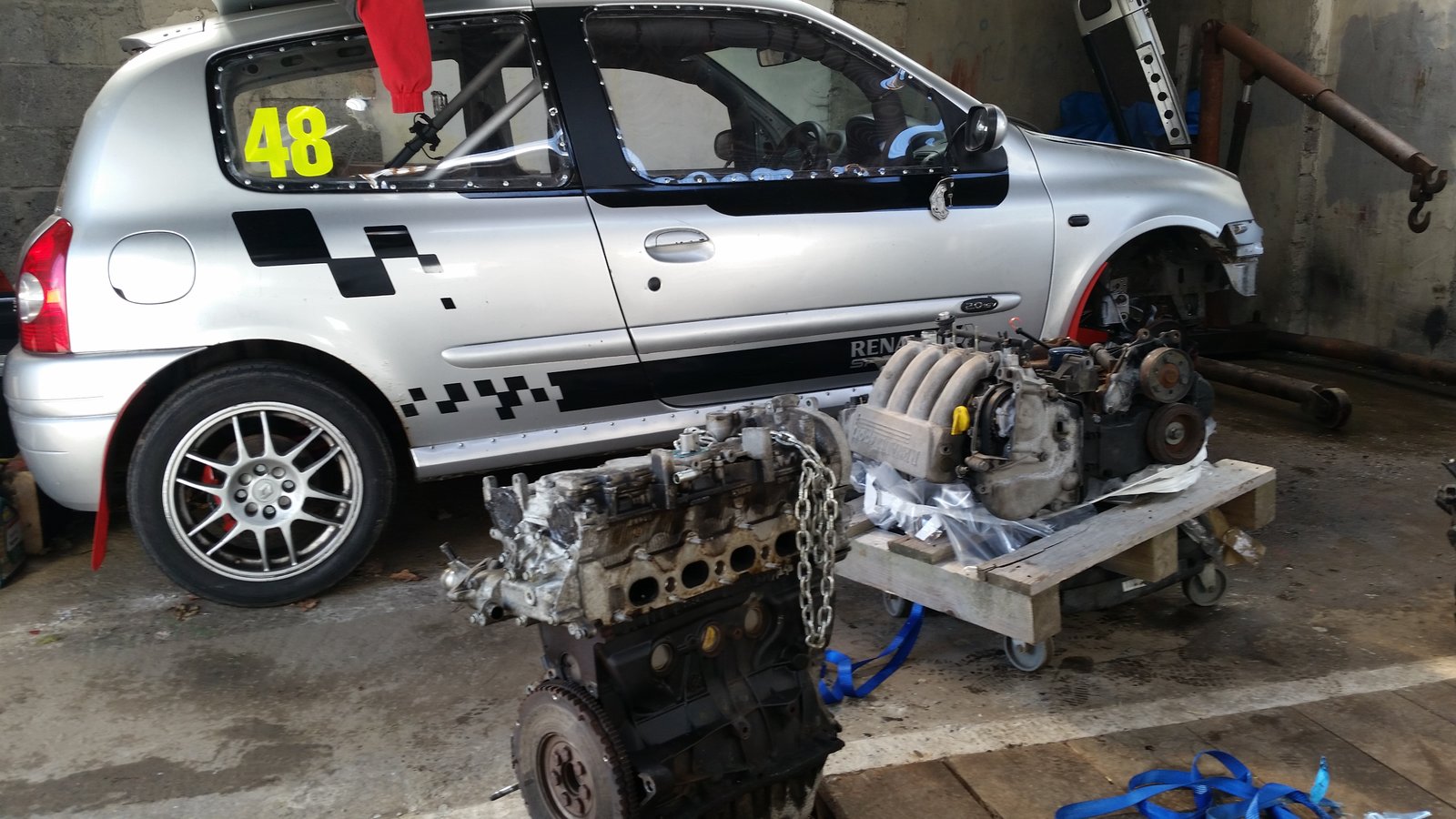

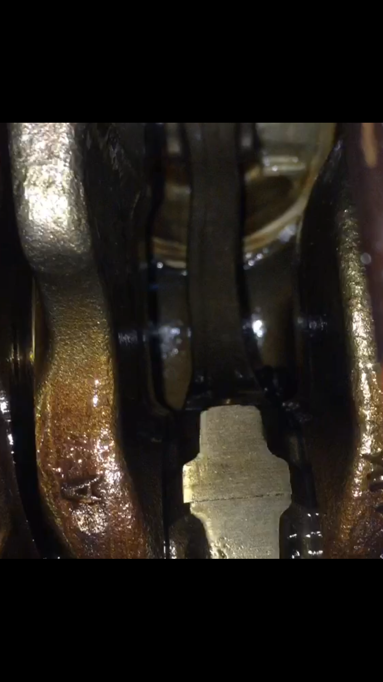

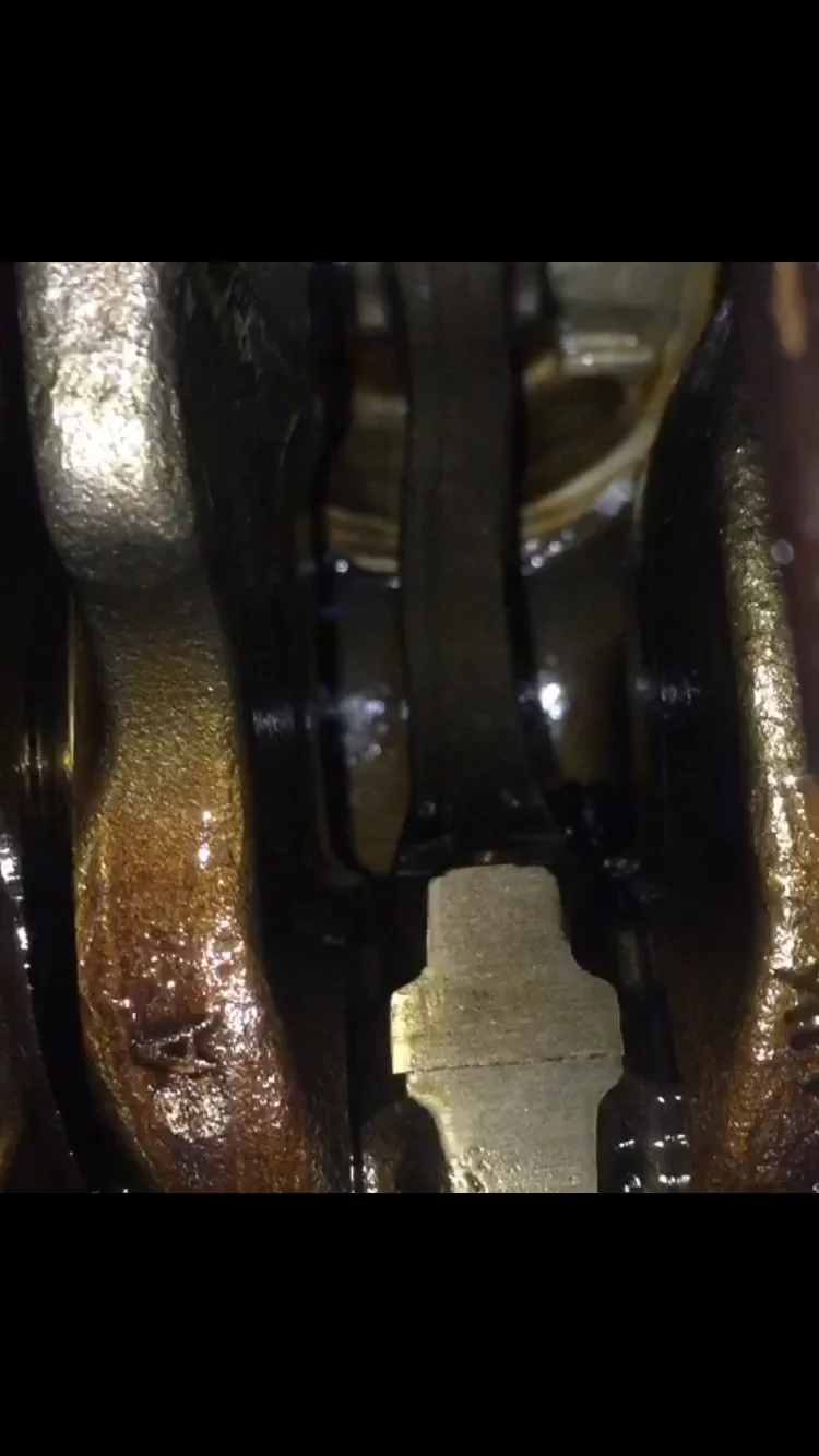

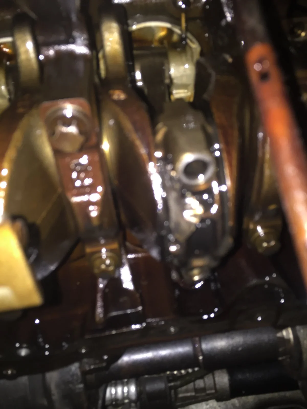

Half the mileage (previous blew at 160k)

Got the engine in Preston & shipped over with pallet way for £70. 83k on this one which was Ph2 so we'll see how she goes. Sitting ready on hoist but putting a new clutch in to be on the safe side. I'll drop it in next sat and if I have time get her wired up and running. No rush though, taking things easy enough at DOE pace.

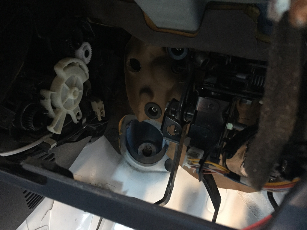

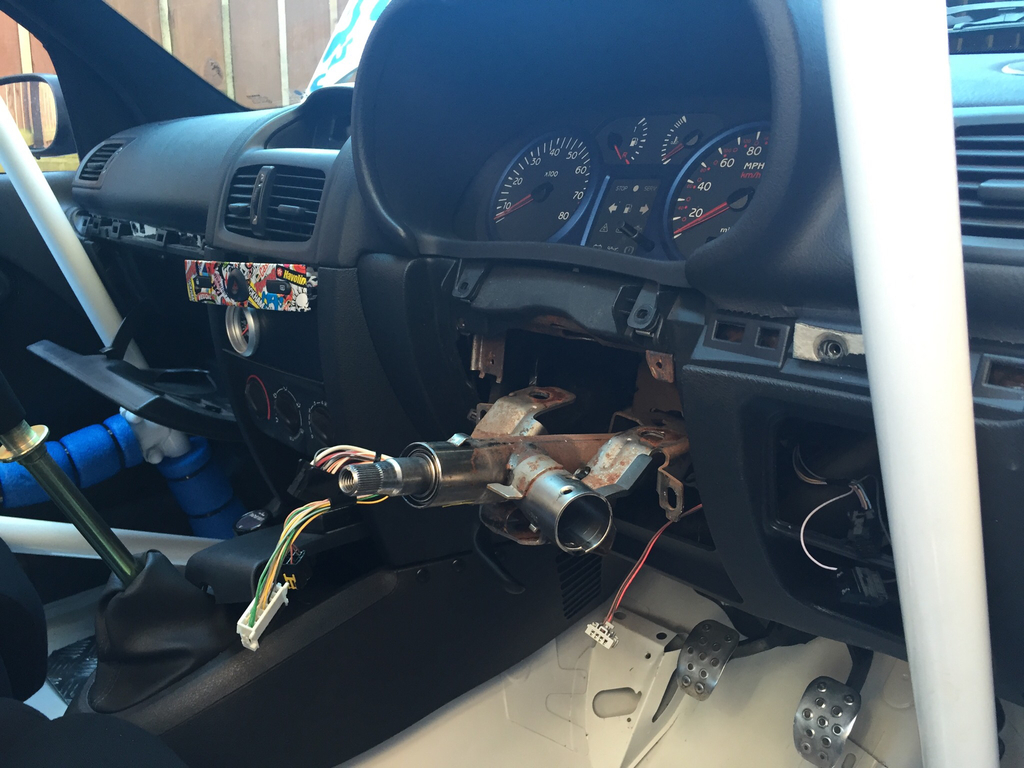

Made a start on fitting the epas this evening,
Strip down
Column gone

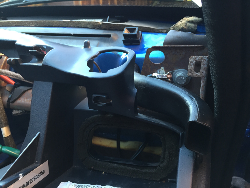

Ecu earthed here

Tight fit getting the epas motor in isnt it!!

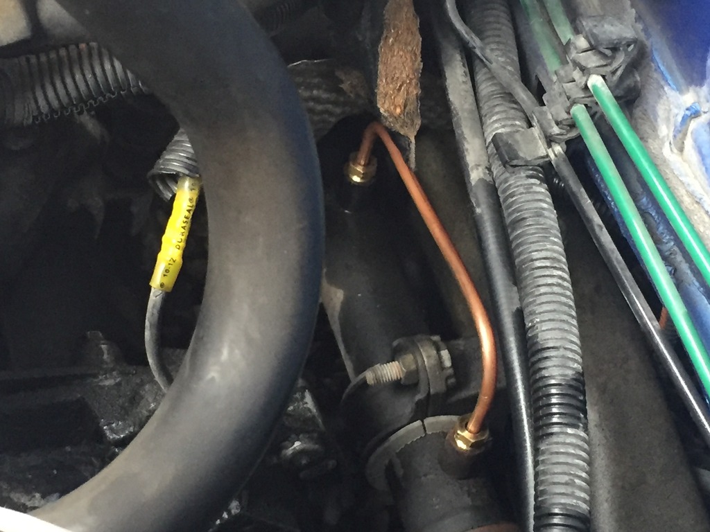

What have I done!? Had it out for a blast to test the epas.....I really don't like the way it feels, bit numb and overall a bit weird, the assistance is odd :confused: It's definitely lost something. Maybe it'll make sense on track, but the only way I could get a setting liveable on the road was about 5 degrees from off. I'm going to change the track rod ends (not really needed but not been done in my ownership!) and have the alignment done again and try again!

1) Dump all associated PAS
2) Dump or sell all associated EPAS
3) Eat extra egg
4) Hammer on regardless!
5) Relax in knowledge you've less weight and less parts
That's very strange Mark. Of course the assistance is at a set level and doesn't change with speed. I found that I like it'd about 25% on although I haven't driven my car for ages so can't exactly remember. I have a problem with mine at the moment where the steering is incredibly light in the centre and then normal resistance past a certain point. Check for play in the column UJs. It should feel the same though as mechanically you haven't lost anything. Assume you've blocked off all four ports on the pinion and haven't left any of the other pipes connected other than the loop.

Try removing the loop pipe or making up 2 separate pipes that are open to atmosphere. It could be hydraulic pressure building up.
Yeah we had that problem with @Martin. 's rack when it was first looped. Could turn it a bit then the pressure stopped it and when it then dropped you could move it more. Felt notchy.

The assistance isn't changing, rack doesn't feel like it's locking up either, it's just odd, the car feels different, bit less feel, bit of a dead spot in a straight line too, I can feel the motor and it just doesn't feel natural! Definitely no play in the joints, gave them some abuse before I went near the car :) the 4 ports are blanked, but I'll remove the loop to see if there's a difference, thanks for the suggestion :up:
