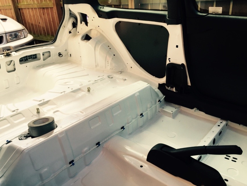

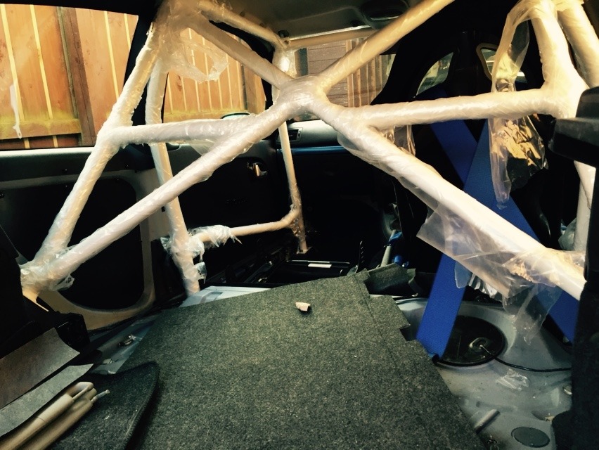

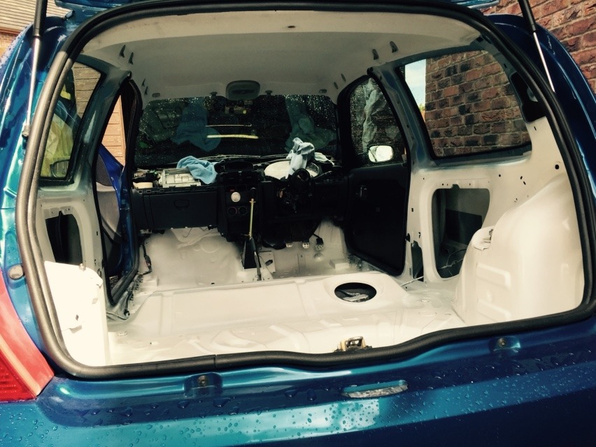

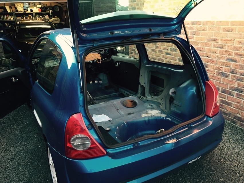

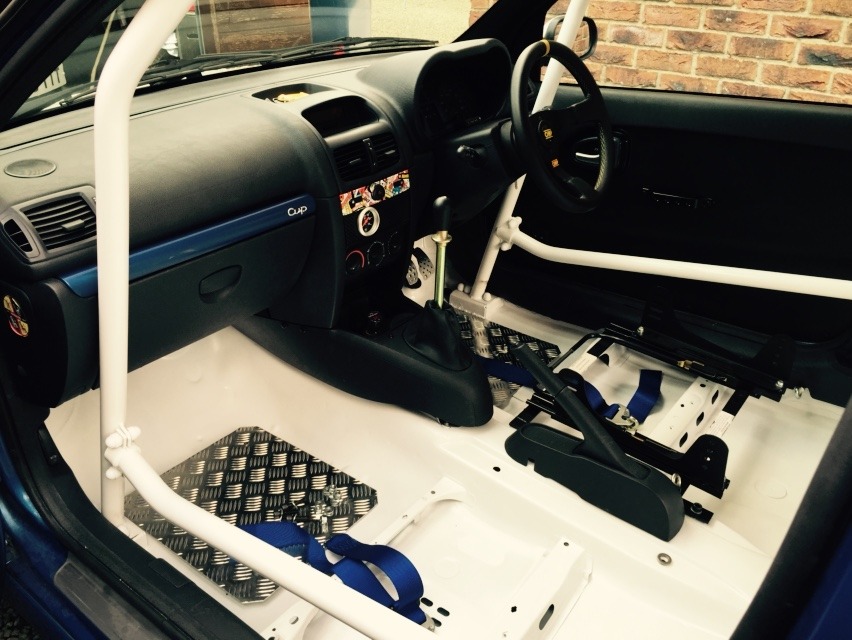

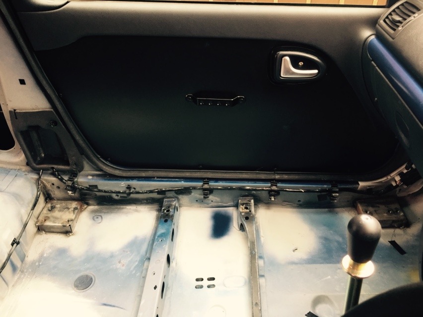

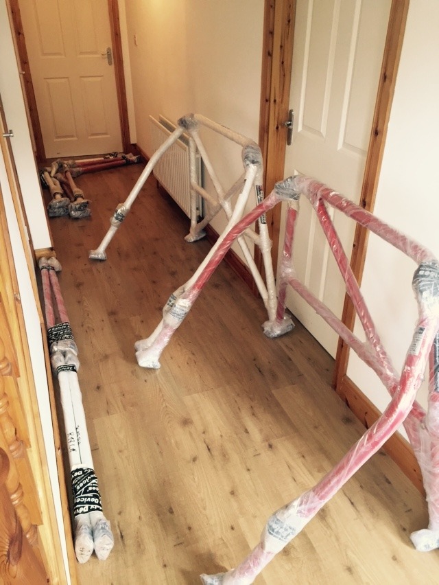

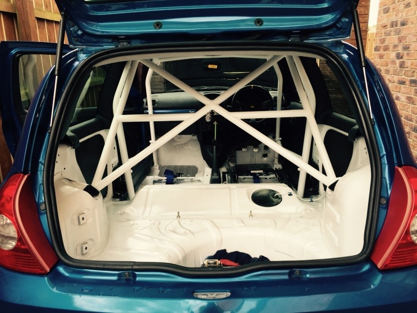

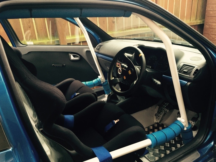

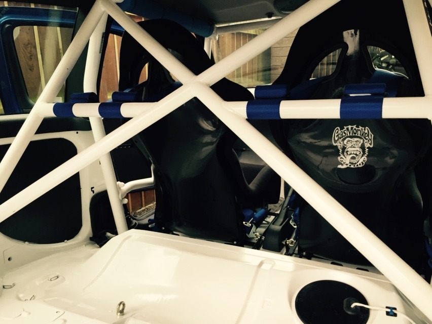

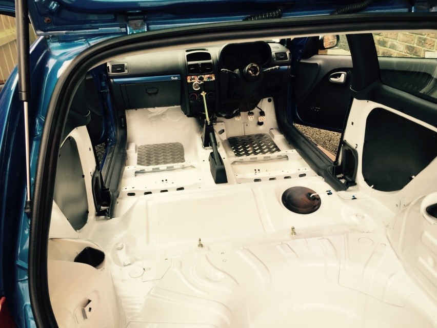

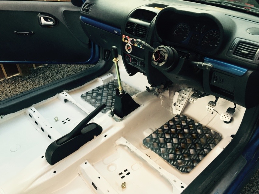

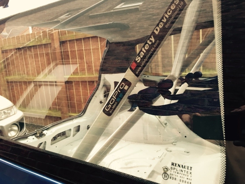

Nothing too much more on mine, cage was test fitted, towers tacked in and then I started to strip it out, re-routed some wiring and got a spot weld bit to get rid of brackets etc. Awaiting final welding, then I'm painting the interior,naps I've skipped the carpets this time :tongueclosed:

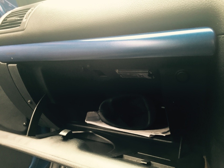

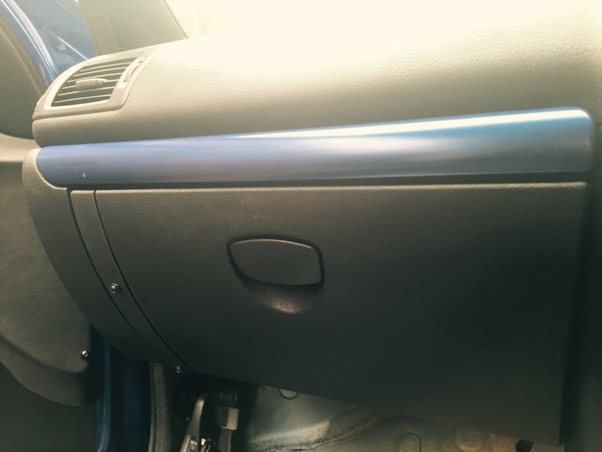

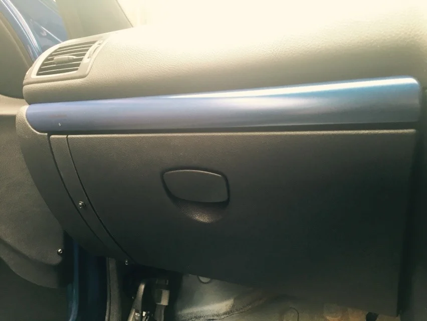

As the cage fouls the glove box door, I had a go at cutting it, need to find tidier screws but all I had long enough at the time

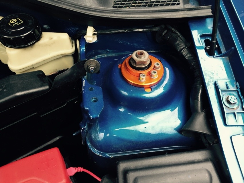

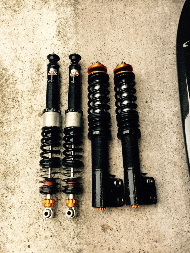

Can't wait to try these, AST sportline 2s afaik but no numbers on them anywhere.
Not sure what to do about the top mounts, my pms ones are bolted on so the AST ones would leave visible holes, not sure if there would be a strength issue but would really like more camber I could have :astonished:

Yeah they're sportline 2's mate. Proper suspension. :up:
Thats the only problem with AST top mounts as you cant use the pms brace, I went back to using the omp race but used M8 bolts and large washers to secure it to the posts, its far more stable than it ever was, again I keep meaning to do testing with and without one to see if lap times are actually effected, its ok if your Roll Cage pick up points end at the turrets.

ASTs are on, no knocks, no rattles, no leaks, just awesome, very happy :smile: Alignment on Wednesday and track day on Sunday. I broke an Allen key in one of the rear adjuster rings, d'oh! Can't get it out, a job for another time lol

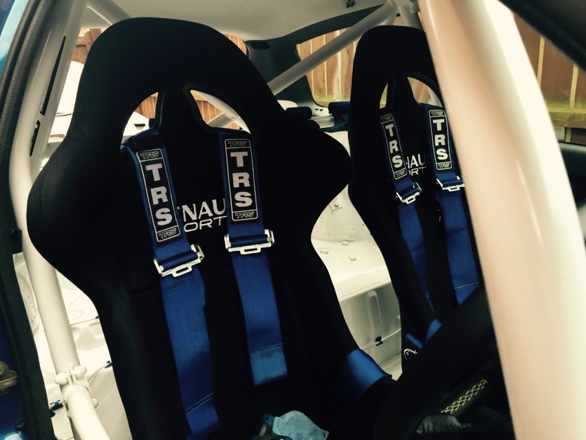

Looks great mate, I really should have painted the inside of mine after seeing this..... Think that will be the next think on the list!! Keep up the good work :)
