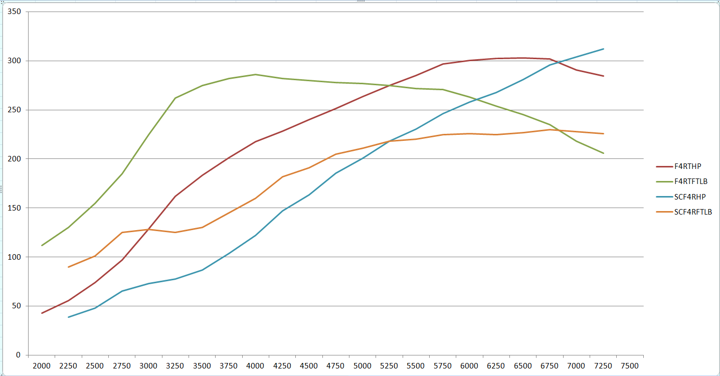

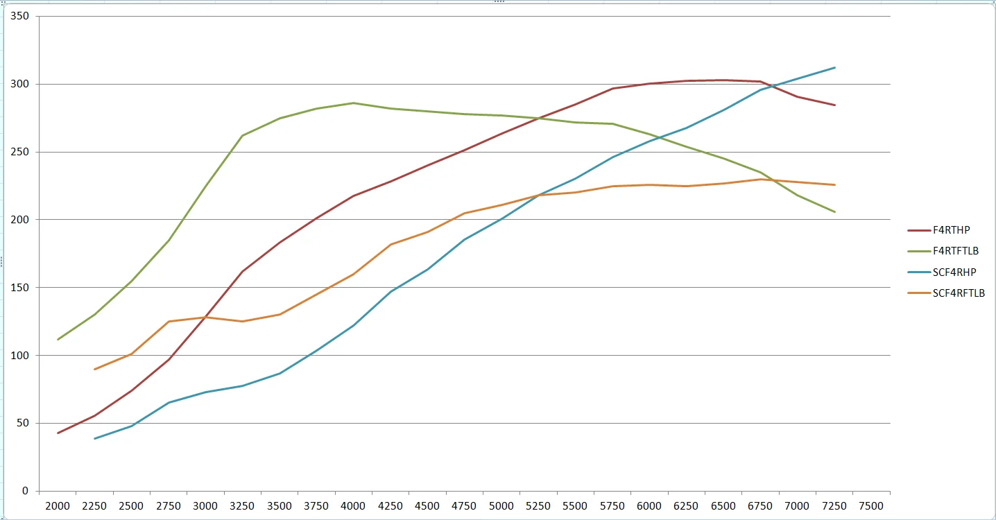

How are the cams timed up? Wonder if less overlap would have helped?
Moot point as it sounds like you are very happy so congrats!
Stock timing, a few degrees swing would of changed the out come for sure. We've already made more power from this turbo on stock cams but dialed it back. It's actually a great upgrade just not bringing in the willy waving numbers

Will be class on the road, nice linear spread of power.
20t with larger hl rear housing and turbine wheel and the power will fly up if you need more.

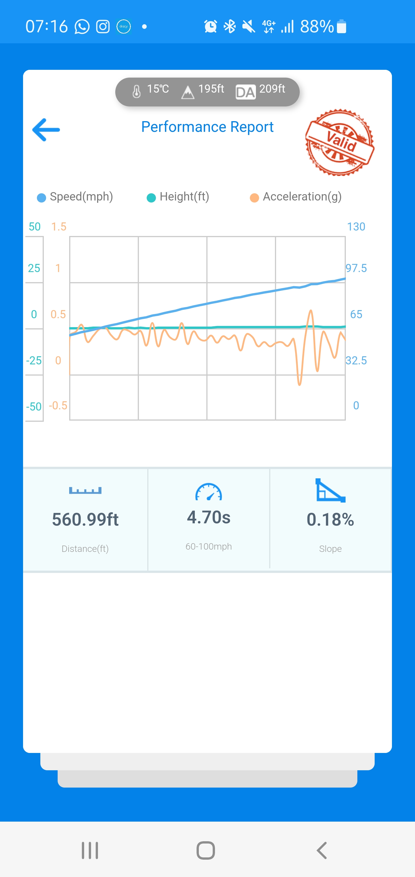

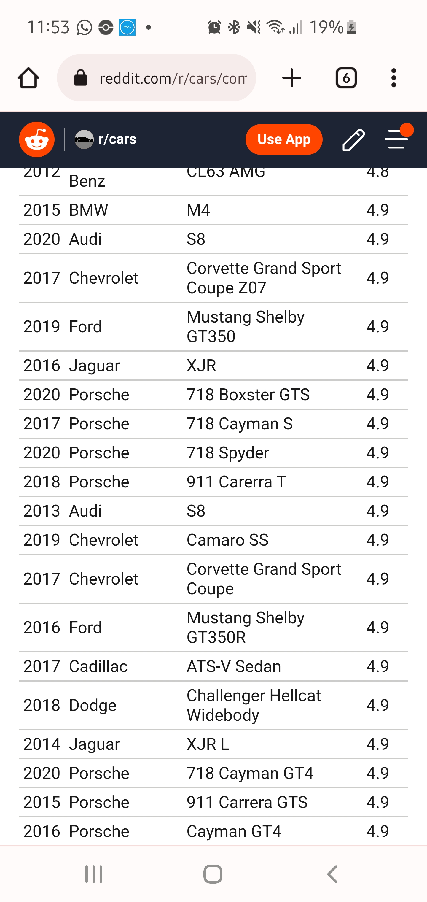

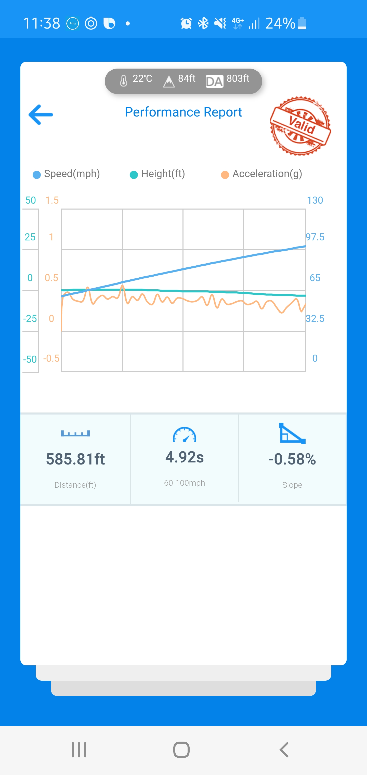

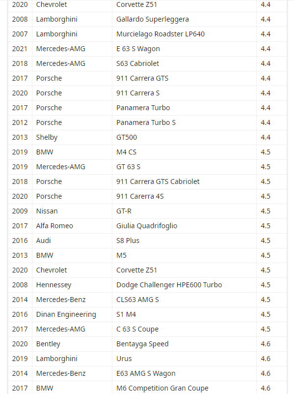

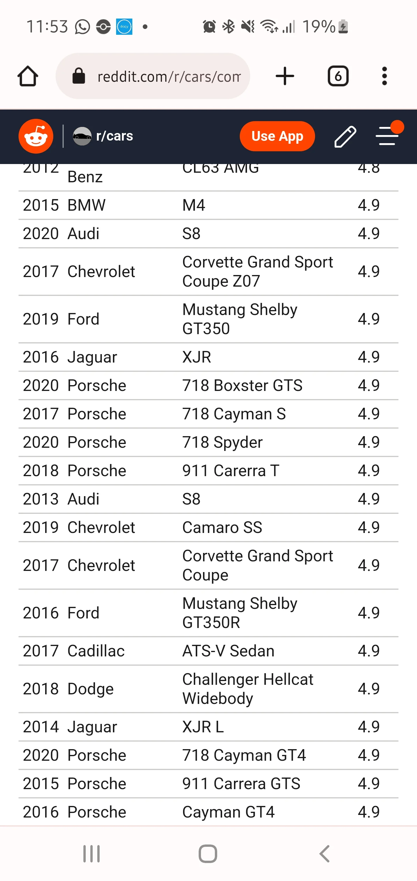

So this morning was nice, dry but cool so I decided to try and do some pulls on the draggy. 60 to 130mph is actually very hard to try and do in any sort of safety, same for 100-200kph. I think ill stick to my normal 60-100mph (still silly but safer still) managed to get the following result from the records.
4.51 60 to 100mph isn't shabby at all, and id recently being thinking it was feeling slow....

I think rolling he would do the 35d but I think from a standing start the xdrive would benefit. I'd imagine from standing start and all that power in the twingo it may be difficult.

Yeah ive not tried launching too much tbh, it wont be any good. Itll do a good impression of a Jack Russel on a laminate floor though
I need to get a dragy and see what 60-100 times are. It'll deffo be slower than 4.5 though as m4 is up there etc.

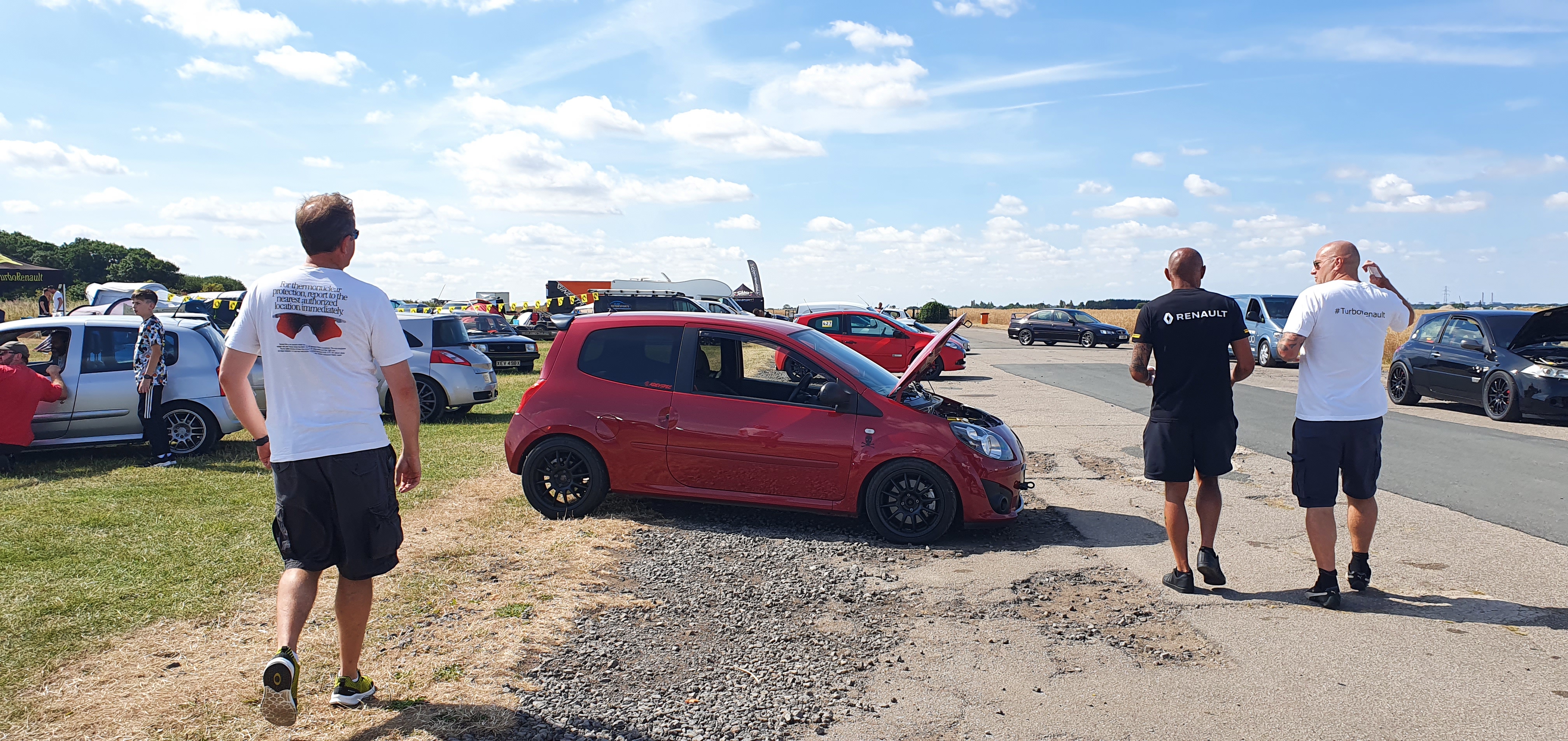

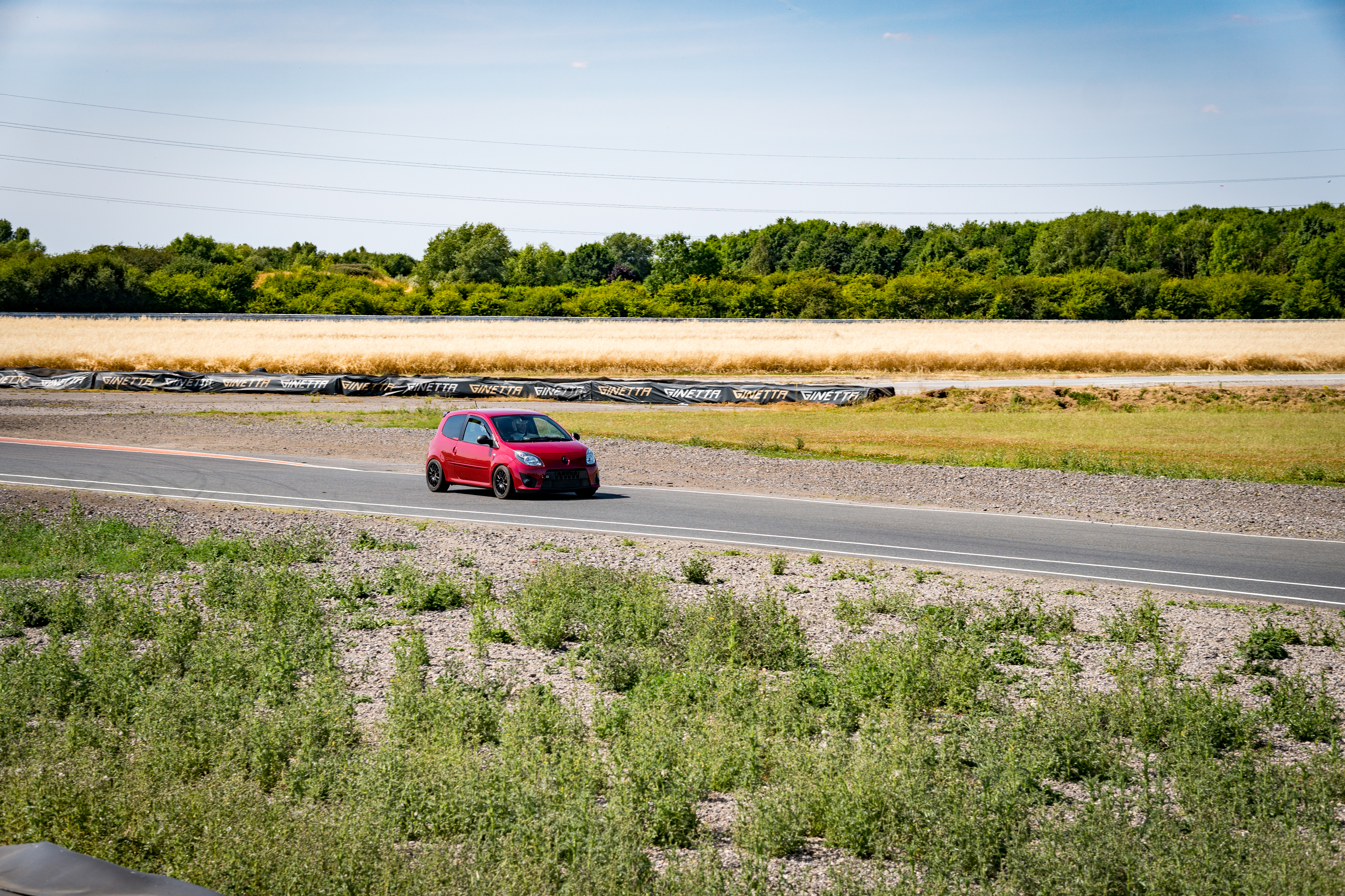

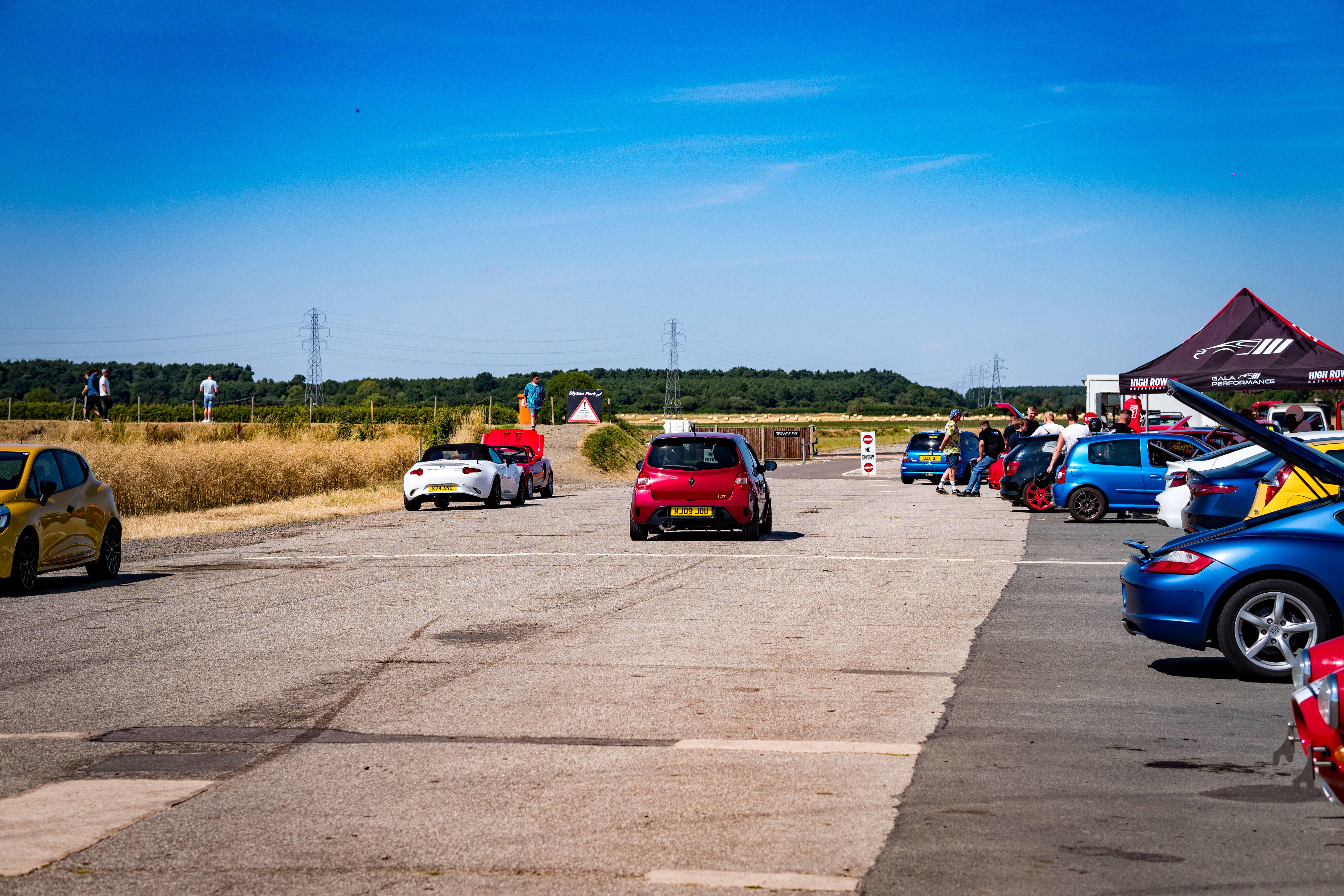

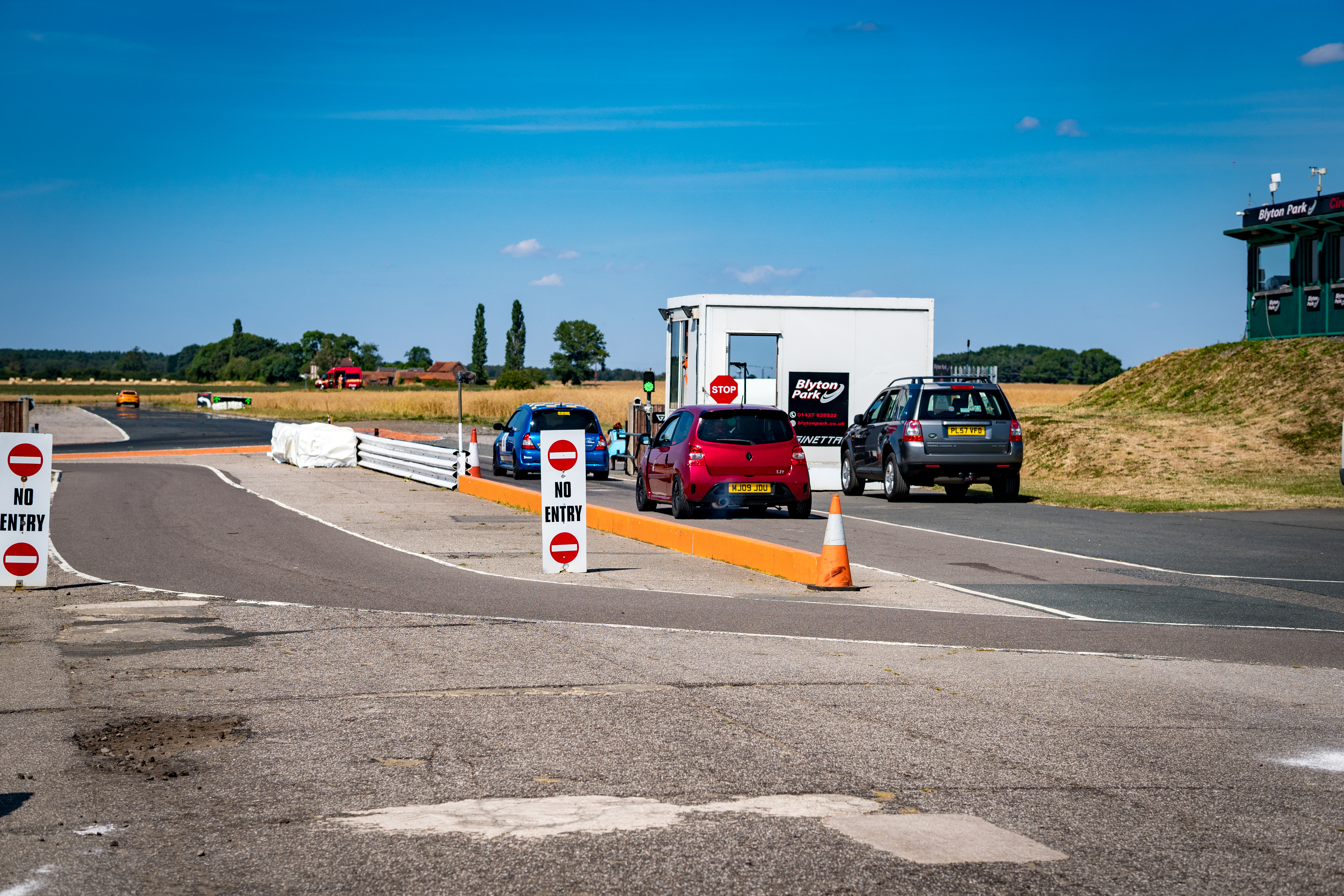

So where are we at, Took the twingo to the Cliosport Festival. The drive up was stupid with accidents and diversions along the way and took about 4.5 hours. Drove up with @jezer101 and met up with @ricardo for a night in the hotel. Got up the next day and met up with the rest of you reprobates (y) The car performed ok throughout the day despite the heat so was kept in low power mode. Intake temps stayed only a few above ambient but the coolant wasn't as happy. It would regularly rise to 100-105 and require a cool down. By the end of the day you struggled to get a good 2 laps in before having to cool down. Upgrades are on the cards to address that, I also have a turbo that may be starting to weep a little when up to temperature. First job when home on the Sunday was to give it a once over, no oil in the boost pipework or catch tank. Nothing to note in the bores and compression still the same as it was. Spark plugs looked good too. Though no oil has been spotted in the downpipe I'm still leaning towards it being the culprit of the smoke 🤷‍♂️ . Only real casualty was the loss of a turbo to downpipe bolt. Anyway @Brigsy has donated me an ali rad so that can go in soon and hopefully help with the cooling and ill try and find myself an undertray which I hope will keep air going through the rad rather than under it.

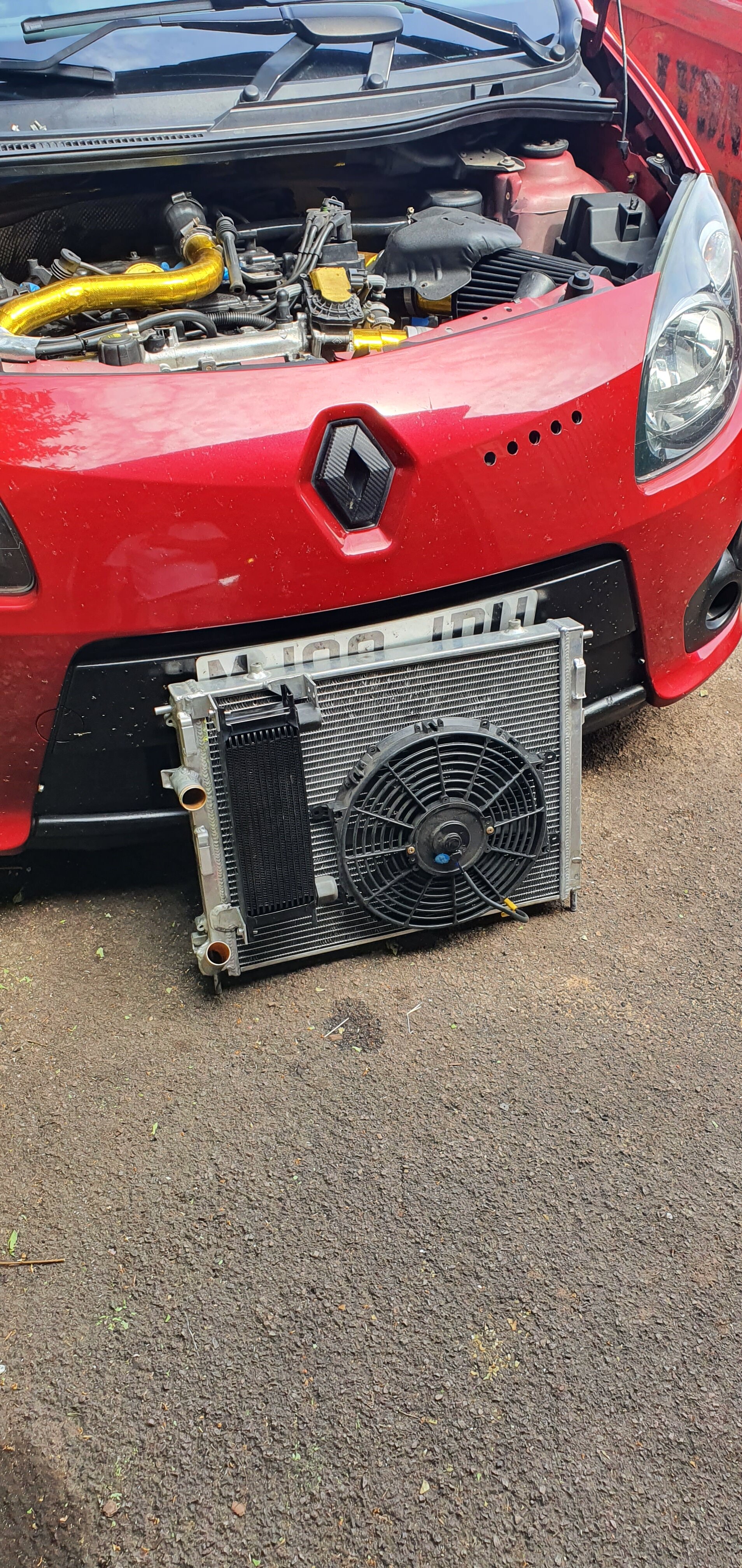

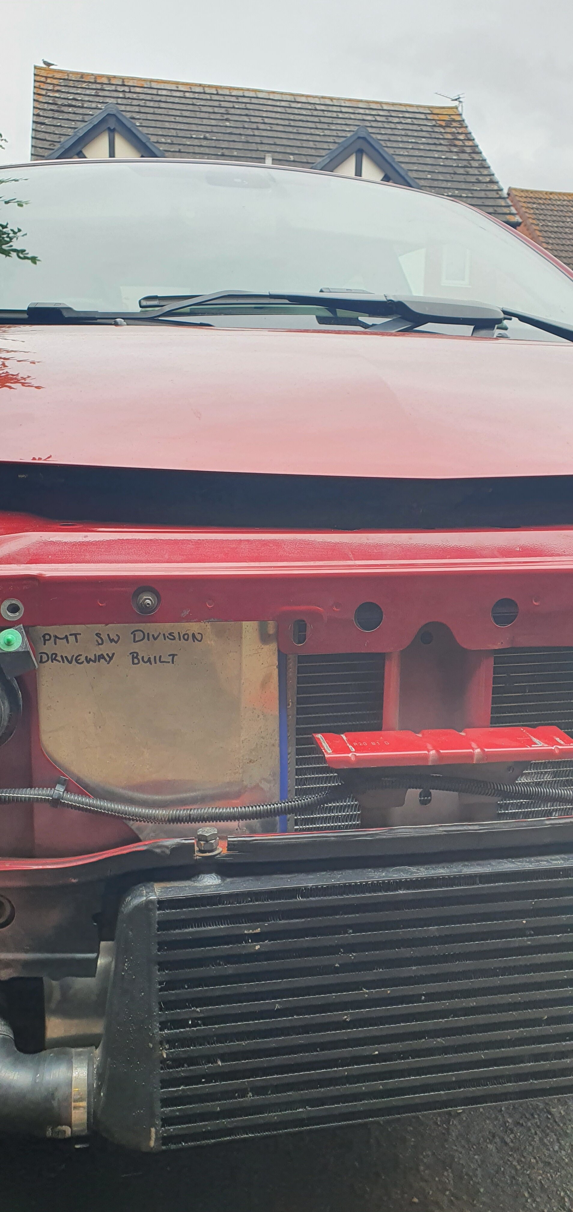

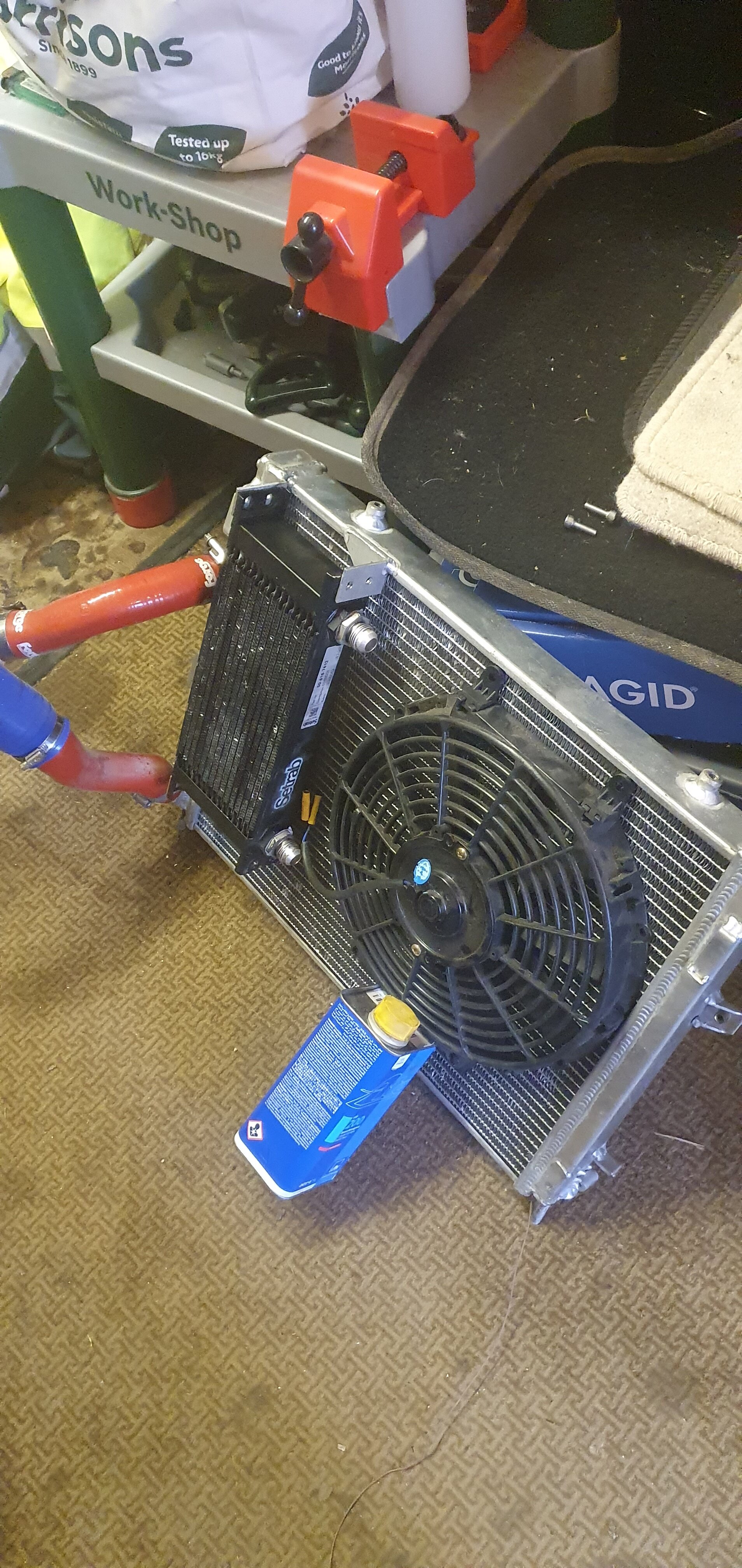

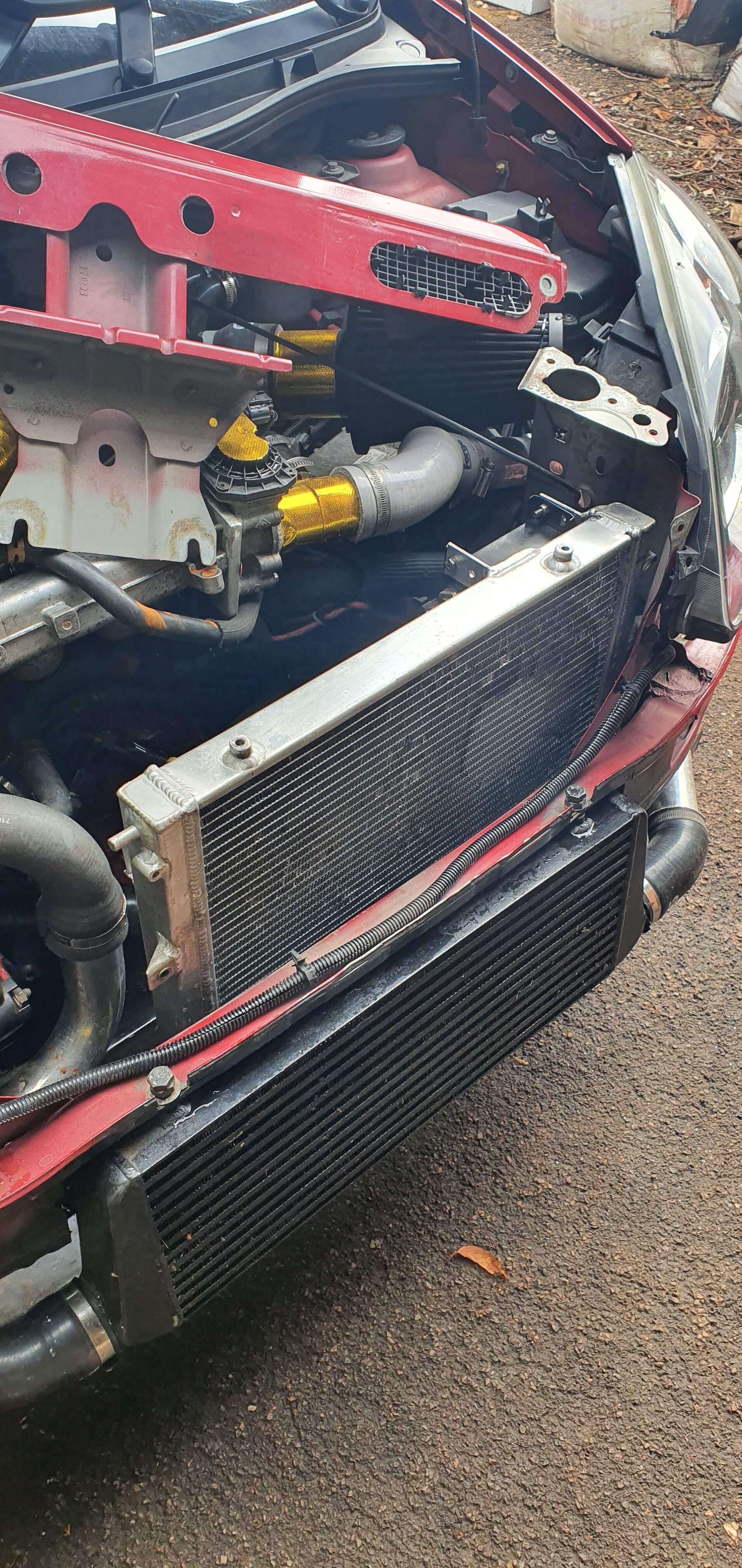

It's been a few weeks since blyton now and thanks to @Brigsy its had a pmt ali rad upgrade and mocal thermostatic takeoff and setrab external oil cooler. Temps now stay pretty solid in the 80s even with 28/30 degree ambient. I've done some constant silly pulls and can get it to the low 90s where it still stays solid until I drive sensibly and drop them down a little again. I'd defo say that's a win so cheers Jon 👍🏻
It's defo getting tight in there now. Next news is the turbo is on its way out, it was a second hand unit when I fitted it and as seen at Blyton it's starting to pass a little oil when warm. Still undecided on which route to go yet as currently the car is fantastic, I worry that a bigger turbo will make it useless and break more things. Will have a think on that.

Glad its gone to a good home and sorted the cooling issues mate. The alloy rads work well as same style as oem with lots of small bars compared to the aftermarket larger bars and less of them which are not as efficient.
Go 20t with a larger exhaust wheel. Will get loads more bang for your buck, more power for less boost if you want around the same hp, which in turn keeps egts down and charge temps lower. Winner all round in my eyes.

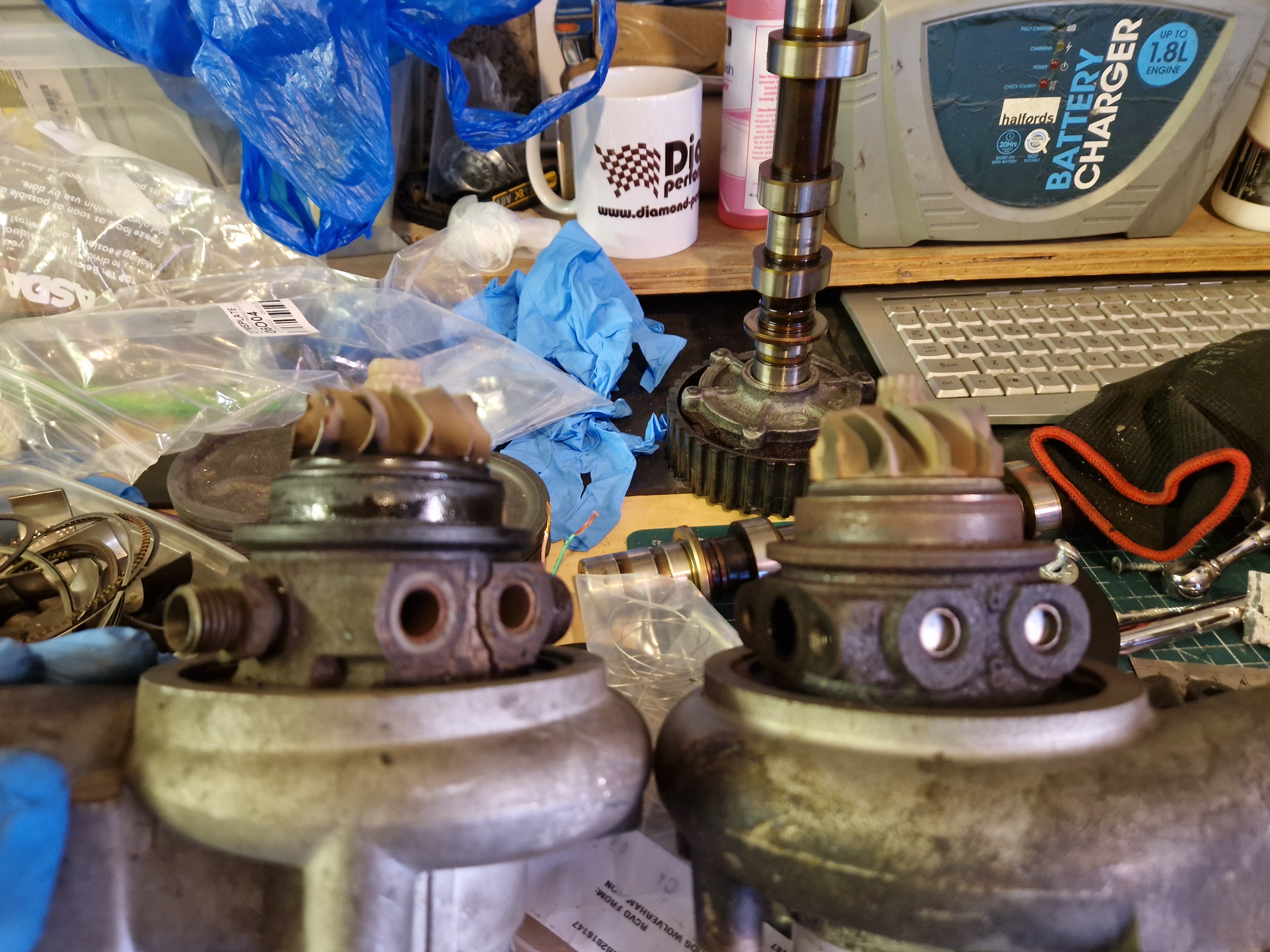

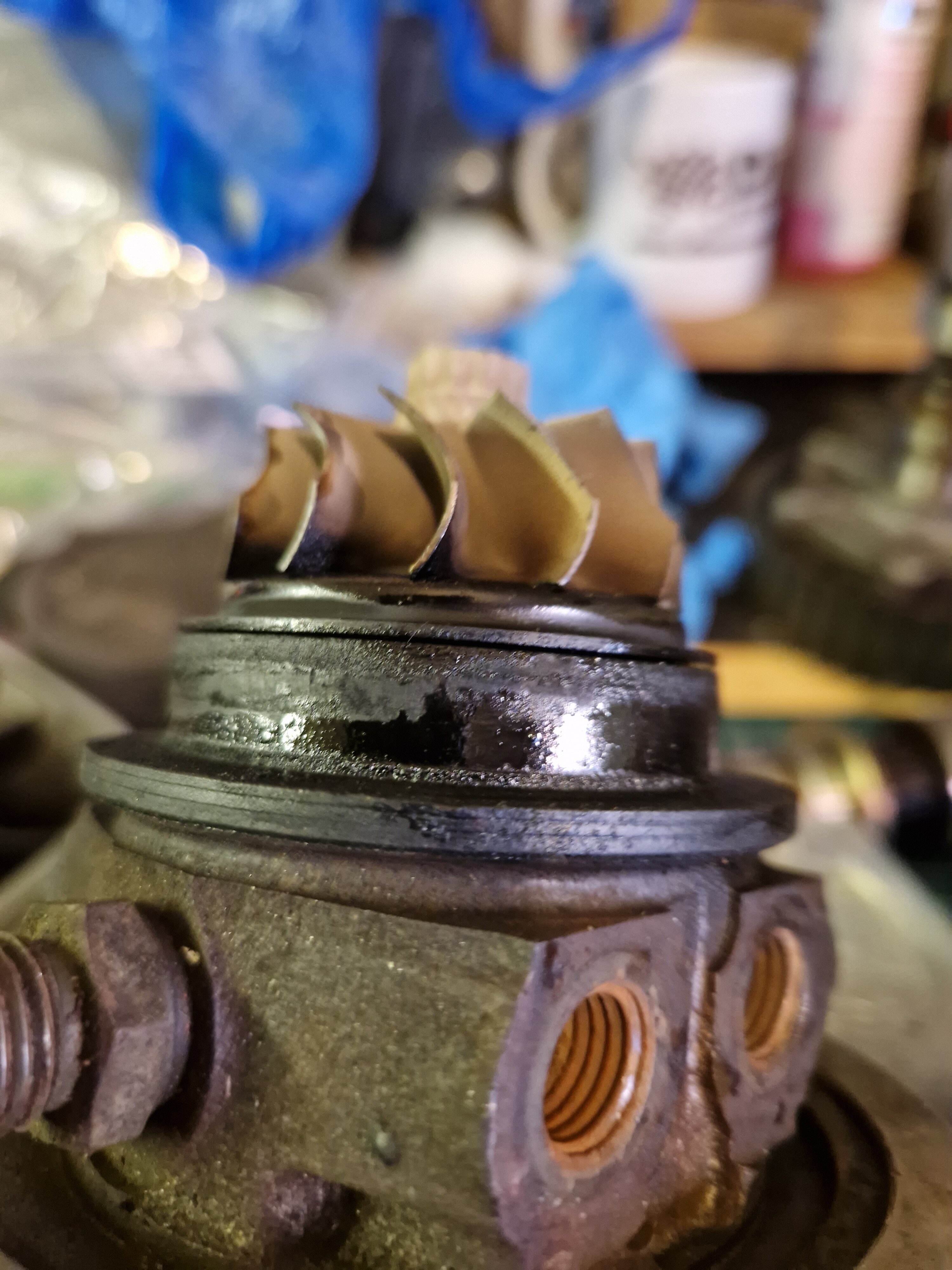

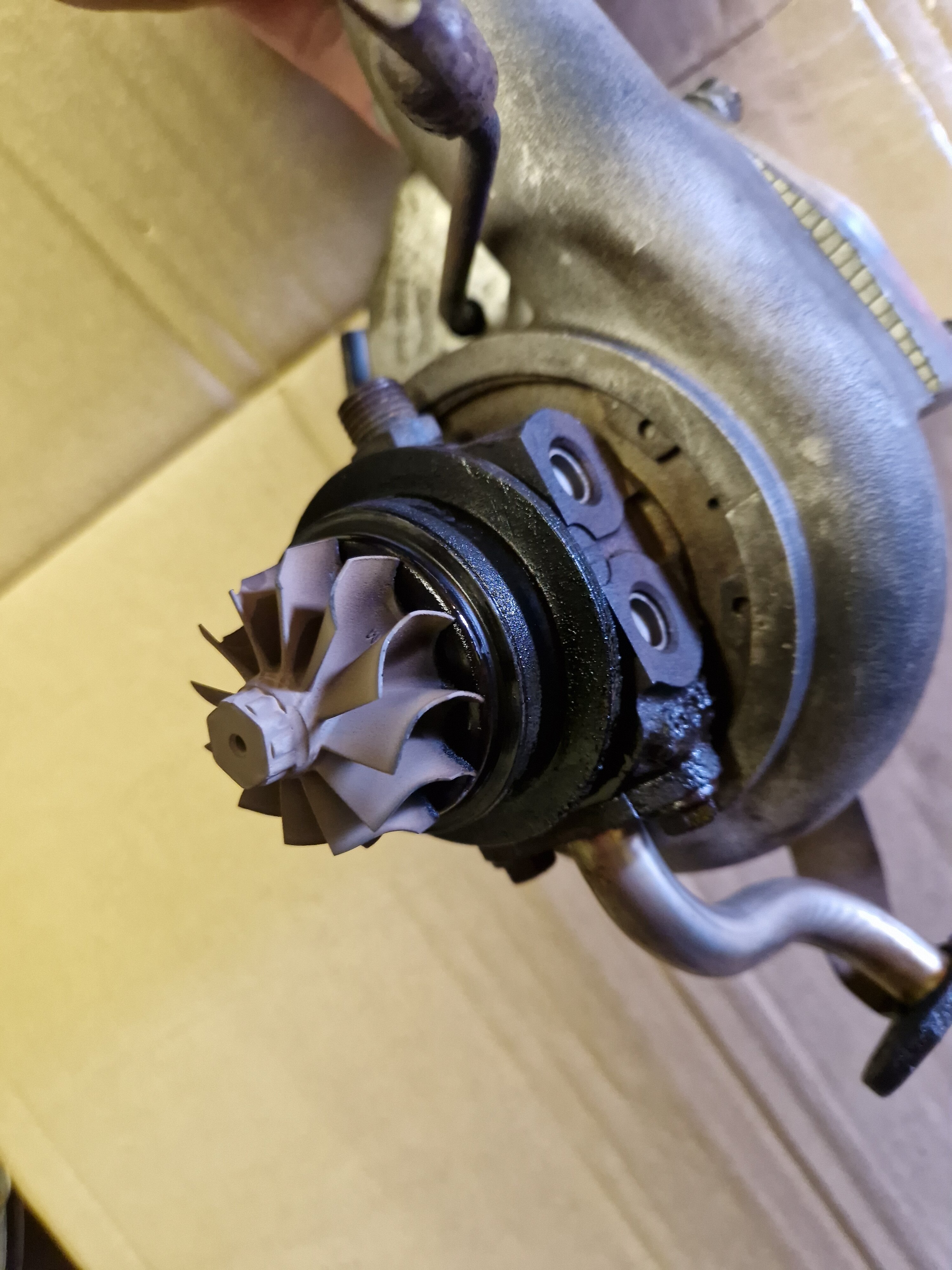

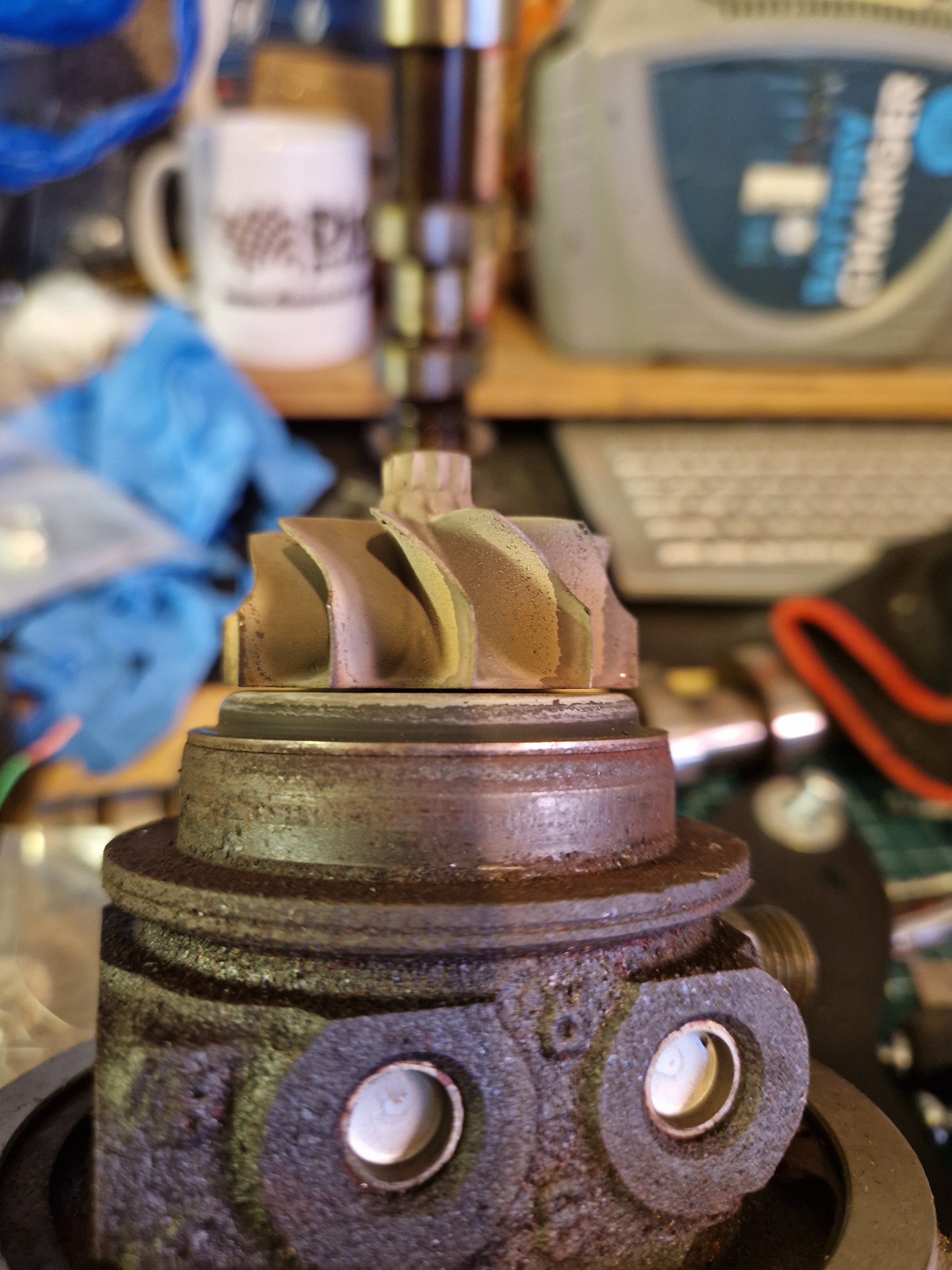

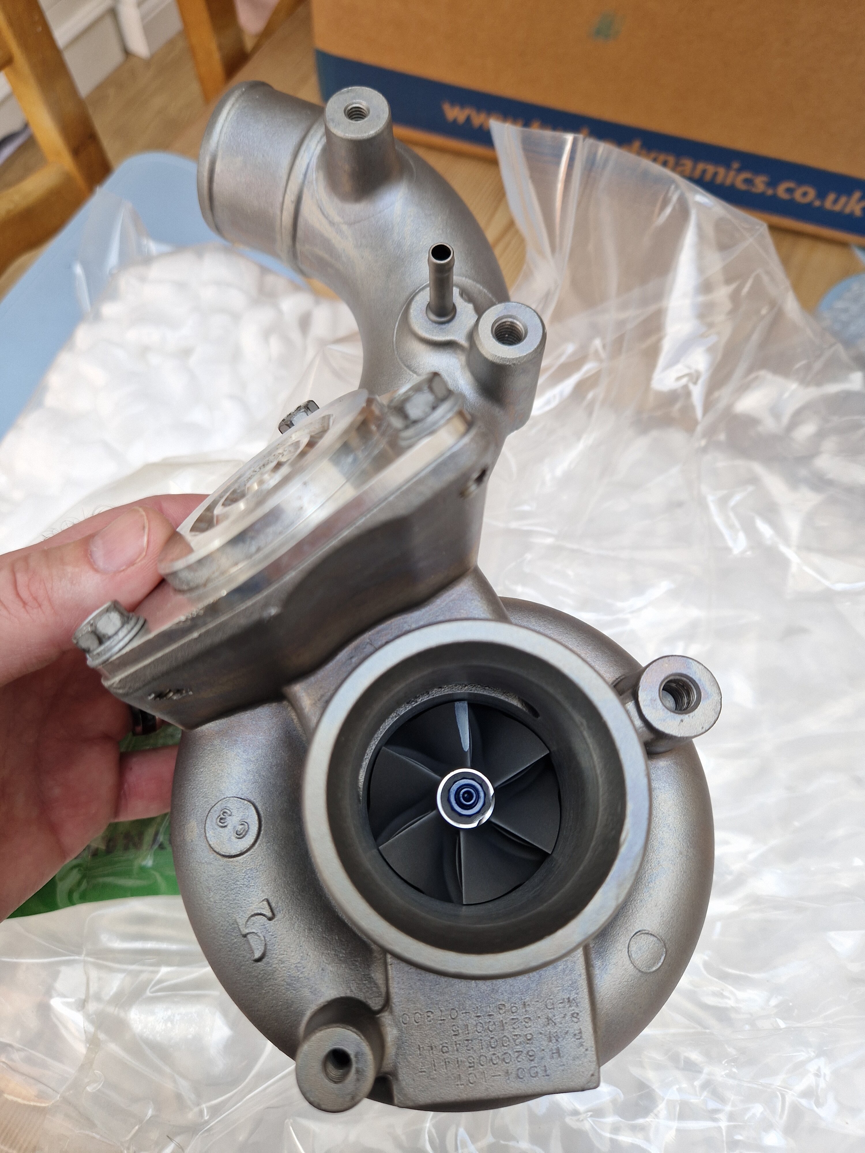

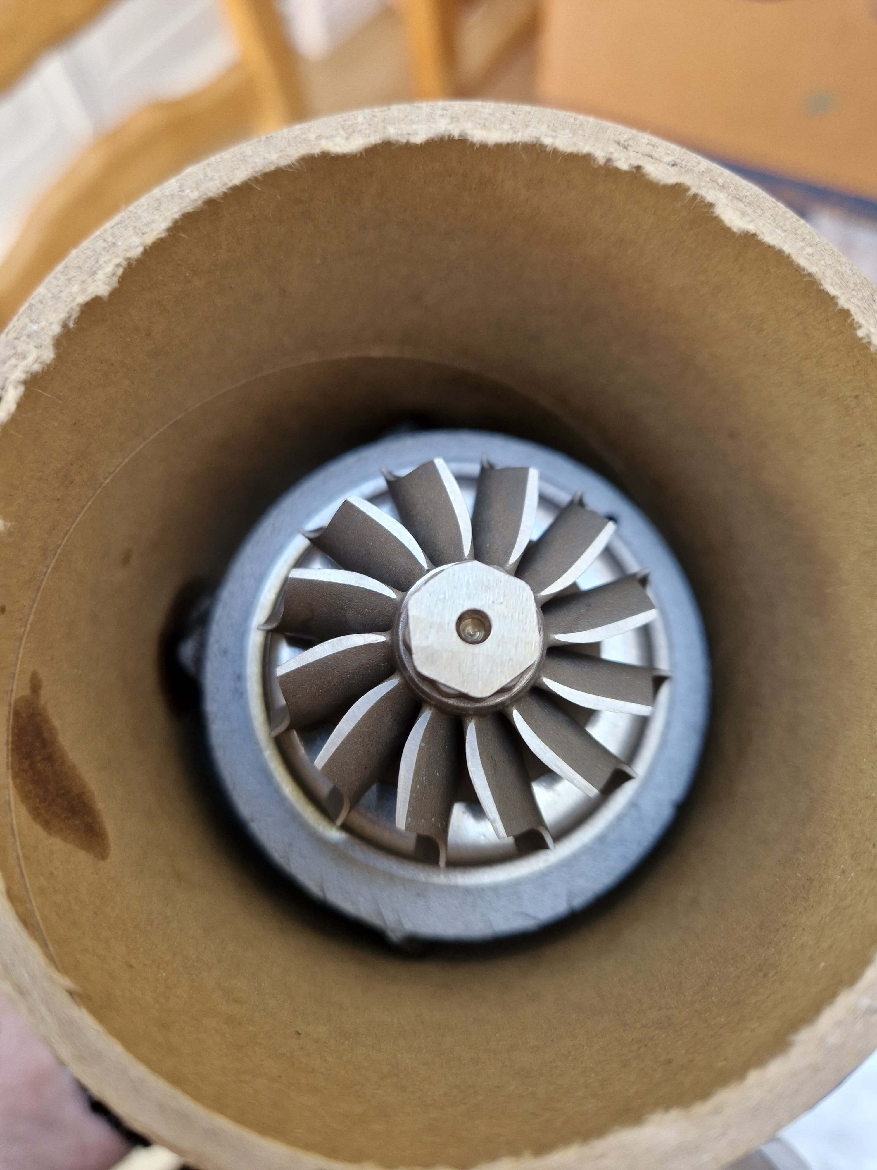

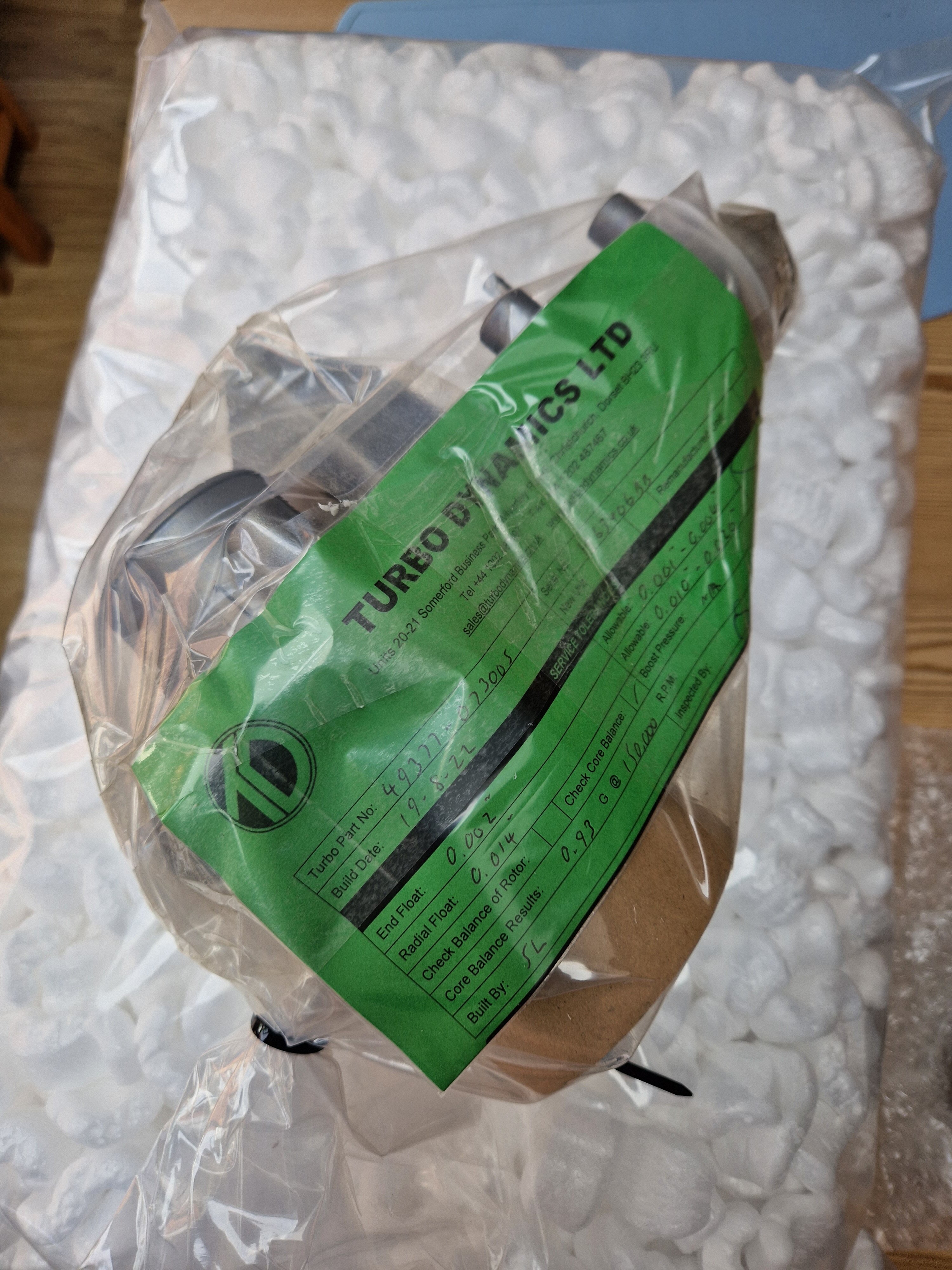

So a small update, the car is currently off the road. Turbo was whipped off and sent to TurboDynamics for a refresh. I also included a spare stock turbo just in case they needed any spare parts to work on mine. The report came back and it wasn't great tbh. There was some forward an back play in the turbo which has written off the comp and turbine wheels, bearing housing and backplates. The oil feed in the thrust bearing was partially blocked which likely caused the issues to start and probably came from me running the Turbo after the rebuild. Oversight on my part, not sure why I didn't fit the old turbo or an inline filter like we would on the old Renault 5 GT turbos. For some reason it was fitted with a TD04L turbine over a TD04 item, even though the wheel is a tiny bit larger it has an extra blade in it and would of probably caused my top end restriction and lower peak figures. TD couldn't think why it would of been used as it adds restriction rather than reducing it. Out of all of it the only parts being salvaged for use on the new unit are the bearing housing from my old stock turbo and the machined compressor housing (which wasn't done to a high standard either so is also getting reworked) So all in all my still boosting fine turbo that had a bit of play and oil loss is a write off lol 🤦‍♂️
On the positive side, (after a little bum and wallet raping, though still loads cheaper than an off the shelf hybrid turbo) ill have a newly assembled 19T Hybrid with nearly everything new, built up with cut back turbine blades and upgraded thrust bearings.
TD04 Turbine
TD04L Turbine 12blade

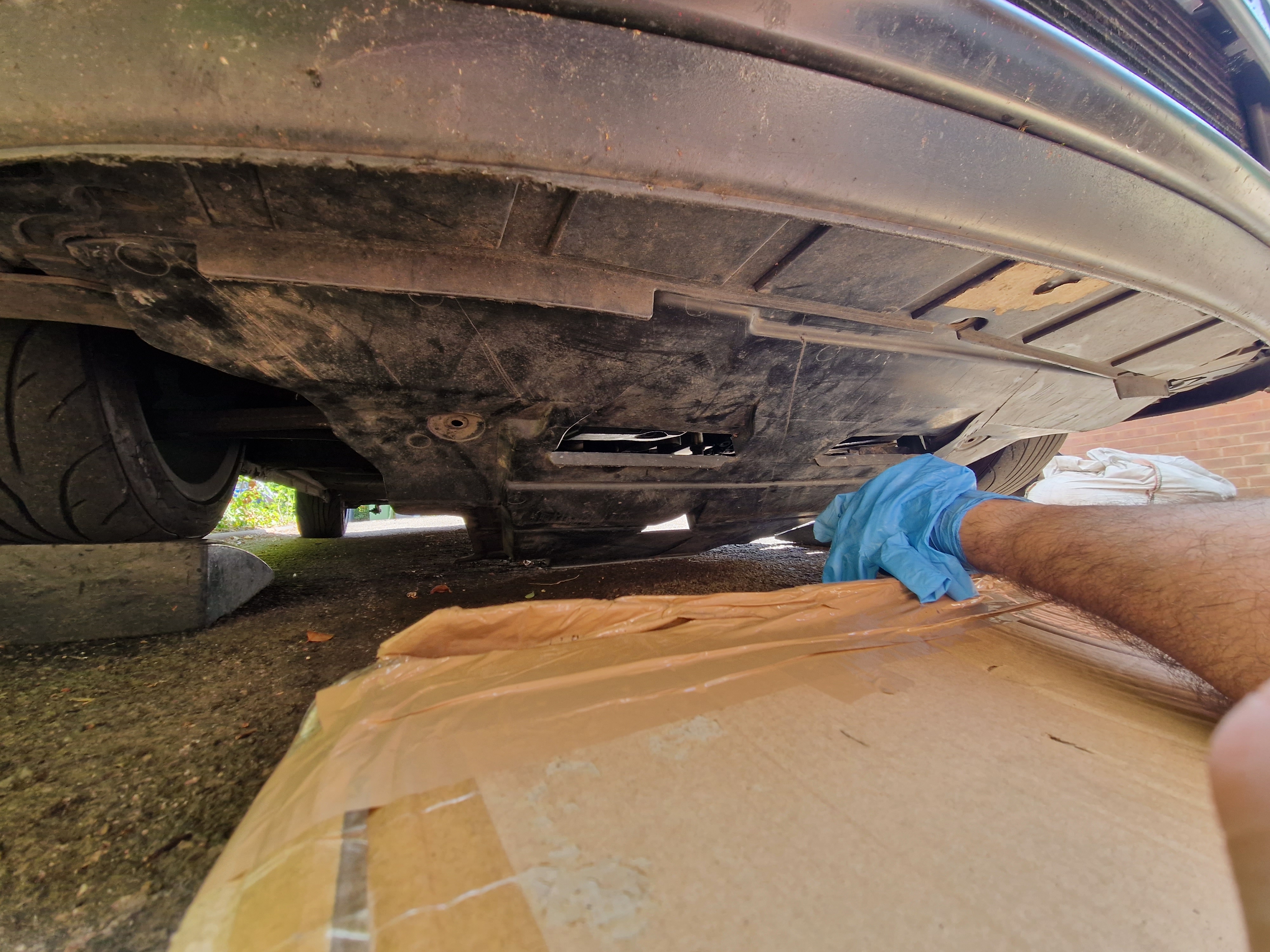

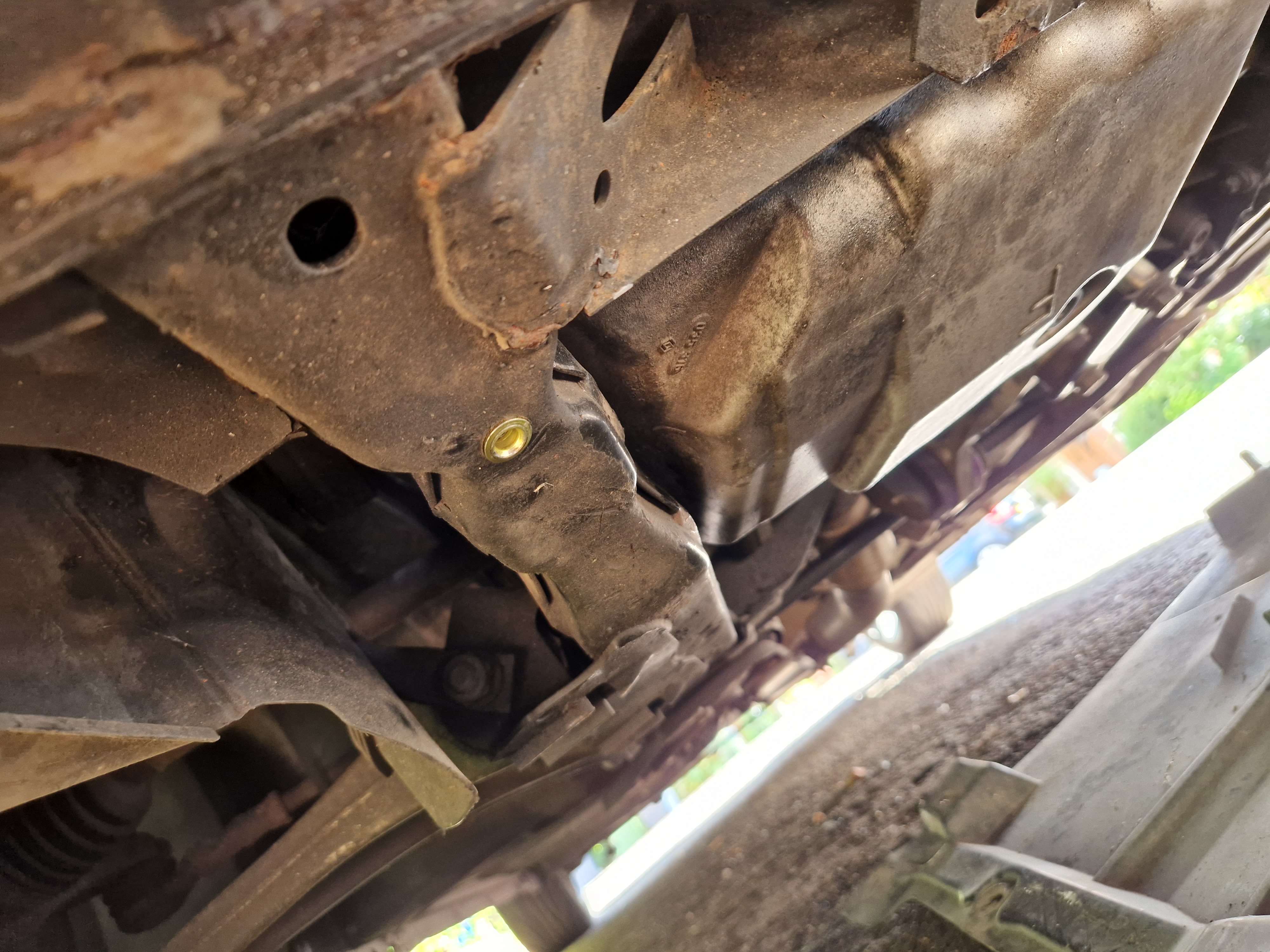

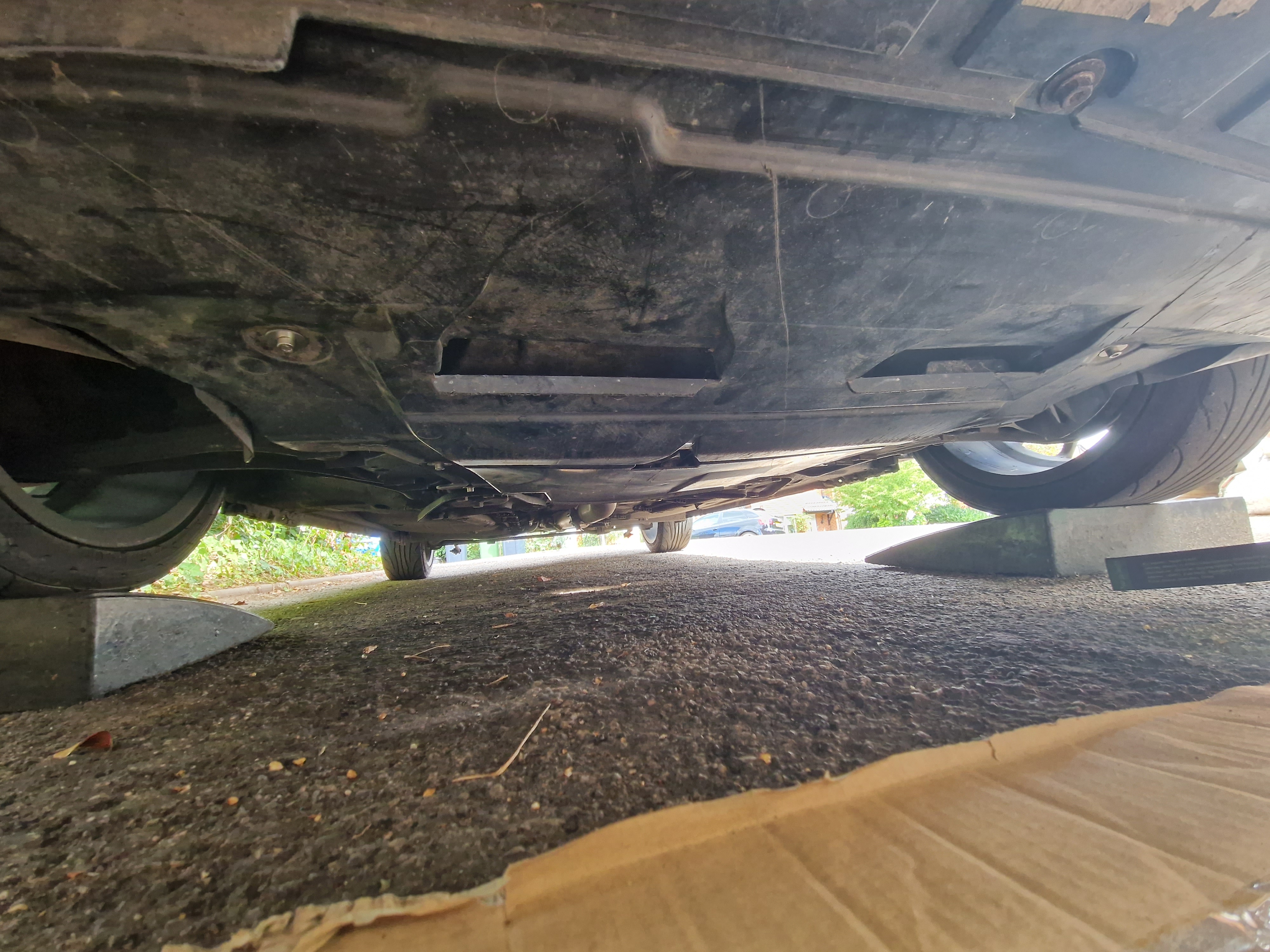

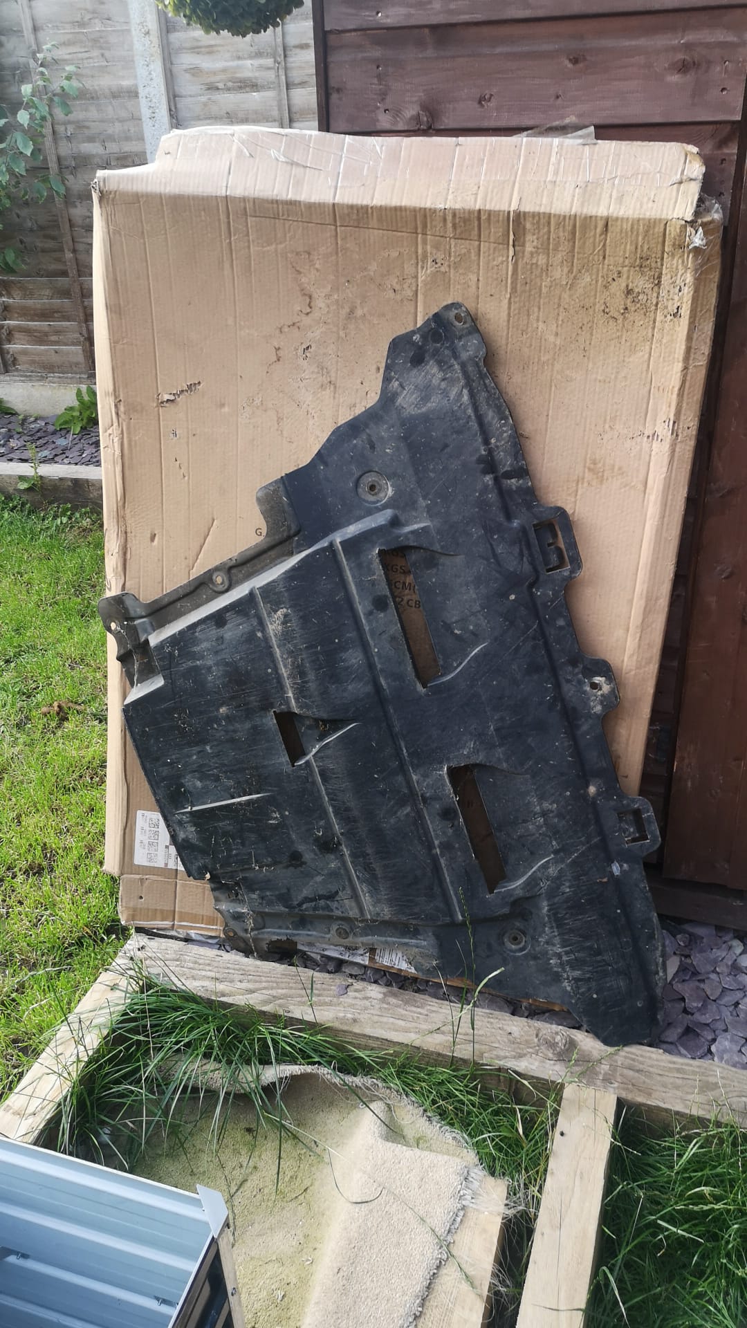

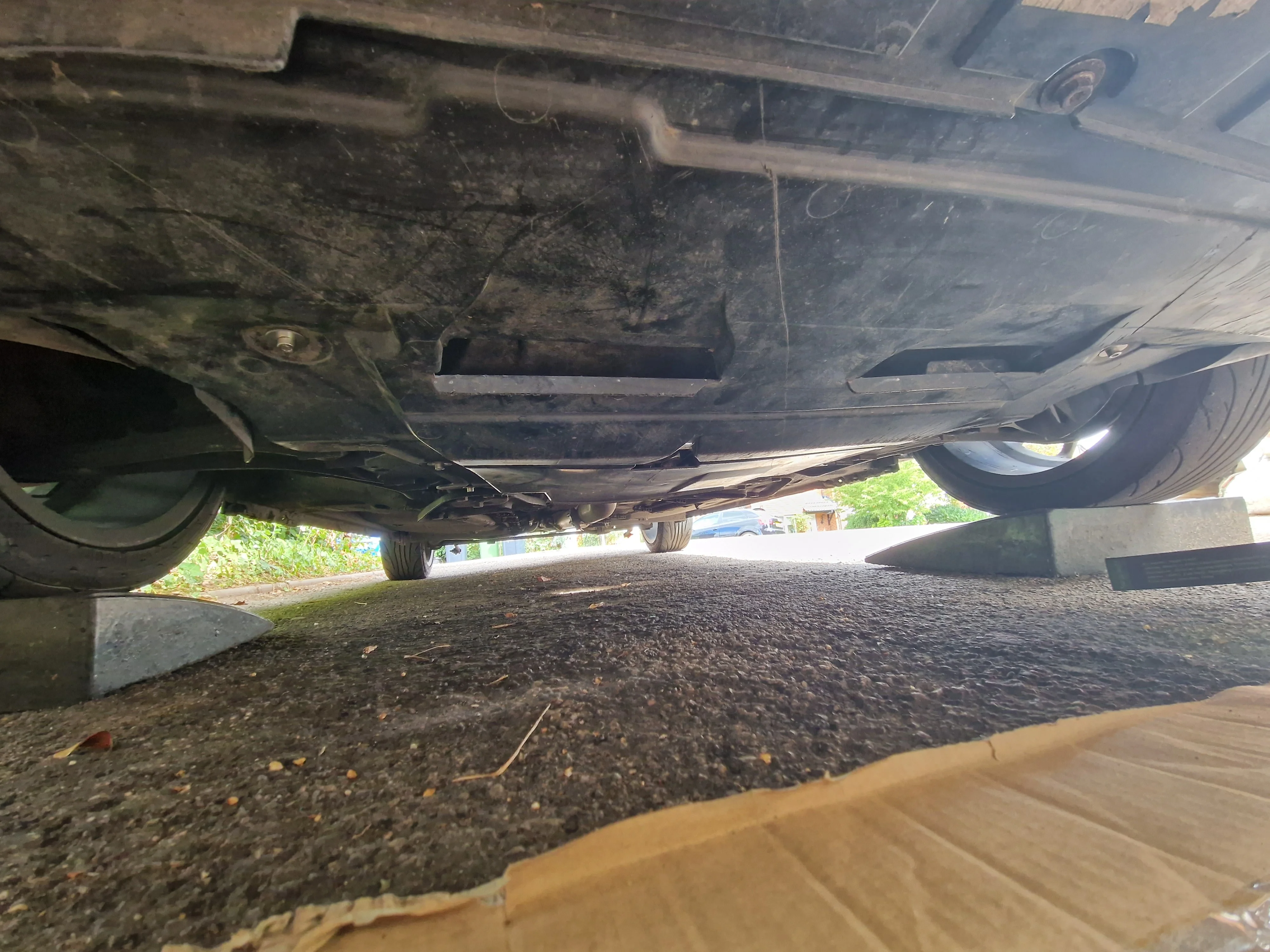

Whilst the kids and wife were out in found a few spare hours to look at fitting the rs133 undertray. The holes all lined up with ones on the subframe but had no actual fixings or threads in them. I'm unsure how they are held on on the 133 but I went with rivnuts and stainless cap head bolts. Should help with smoothing and directing airflow under the car and hopefully help towards keeping the bay cooler. Another unseen upgrade I guess 🤷🏻‍♂️

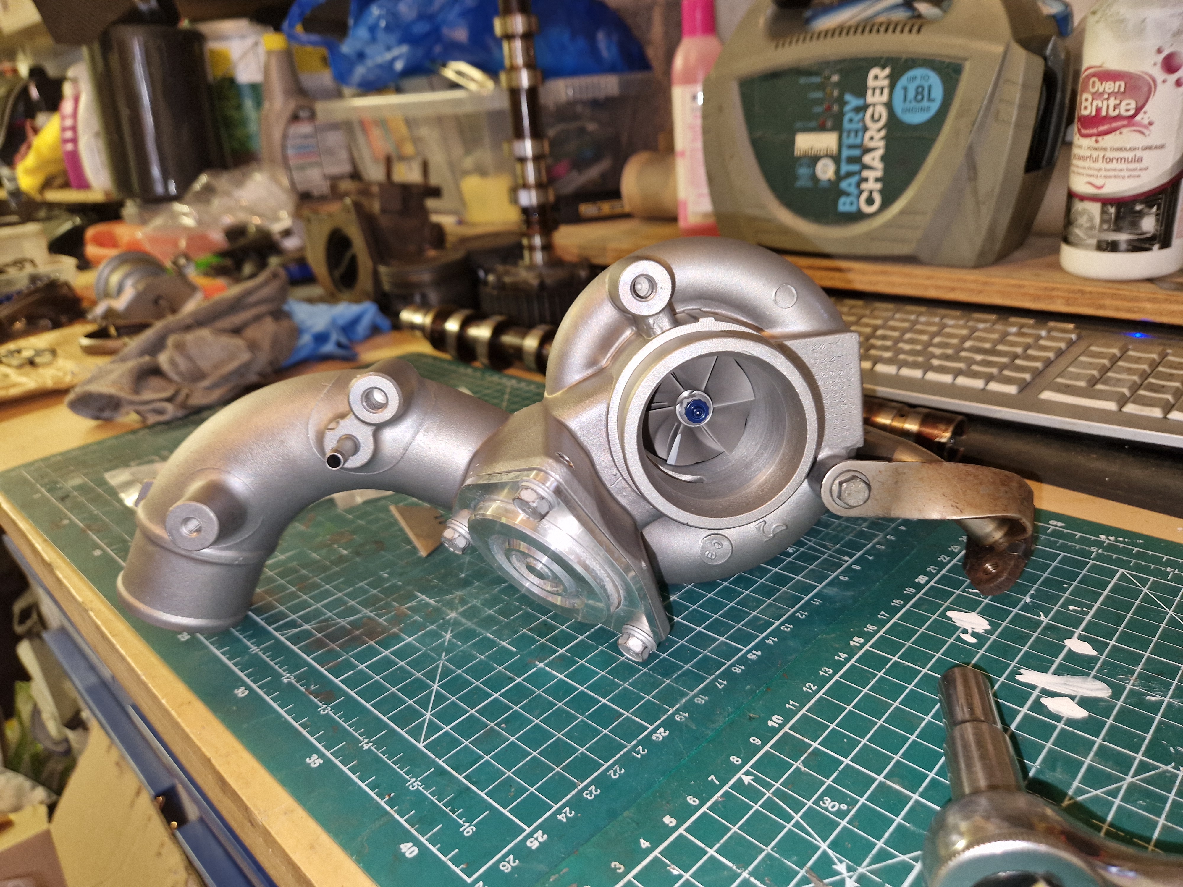

And we are back and rolling. New turbo back on and doing the business. Boost is lower than before due to it flowing better than the old unit. I run open loop boost control so it needs a few presses on the up button. Unsure what to do now. Got a hankering for another retro and i think I've gone as far as I want with the twingo so it may go up for sale. 7kono if anyone is interested 👍🏻
Have some shiny new turbo pics
