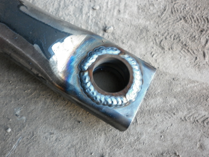

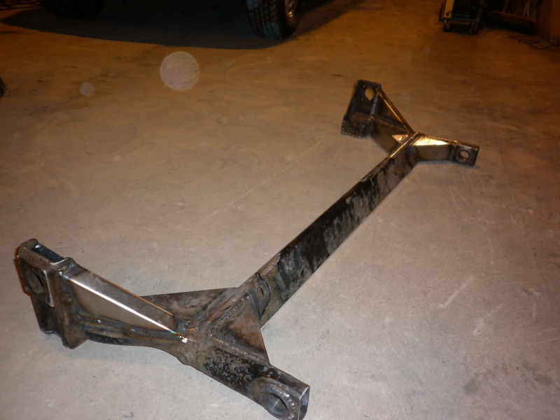

Right another small update, finally got the gas bottle for welding yesterday and set about fitting my Pure Motorsport axle strengthening kit and sperical bearings.
Axle just needs blasted and painted and powder coated when all the brake lines have been mocked up.
Well impressed with my new welder, some good results with the axle, now to continue onto the cage.

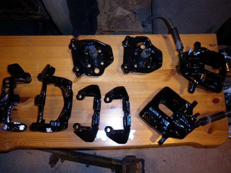

Got my mate to blast my brake calipers, mounts and stub axles for painting, applied ceramic primer, black VHT paint and lacquer.
Forgot to take pics but will get some up tonight, brilliant results with a VHT caliper paint kit.

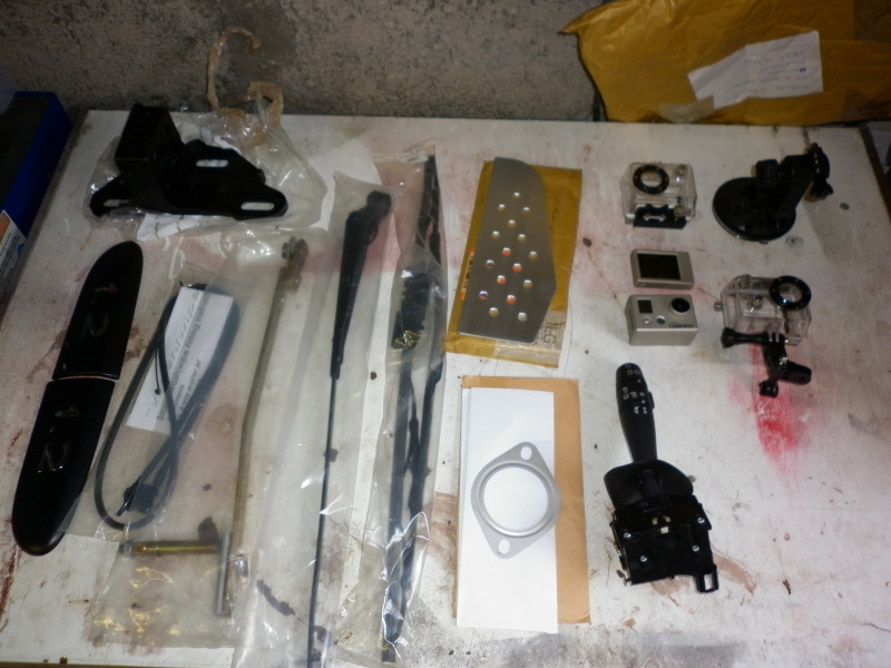

Some more small parts arrived including storm single wiper kit, go pro with lcd screen.
Some parts from the forum so thanks to who has supplied me so far.

Storm kit looks like great quality, comes with everything including blanks for old wipers and a new run of washer tubing etc, It will be one of the final touches so could be a while.

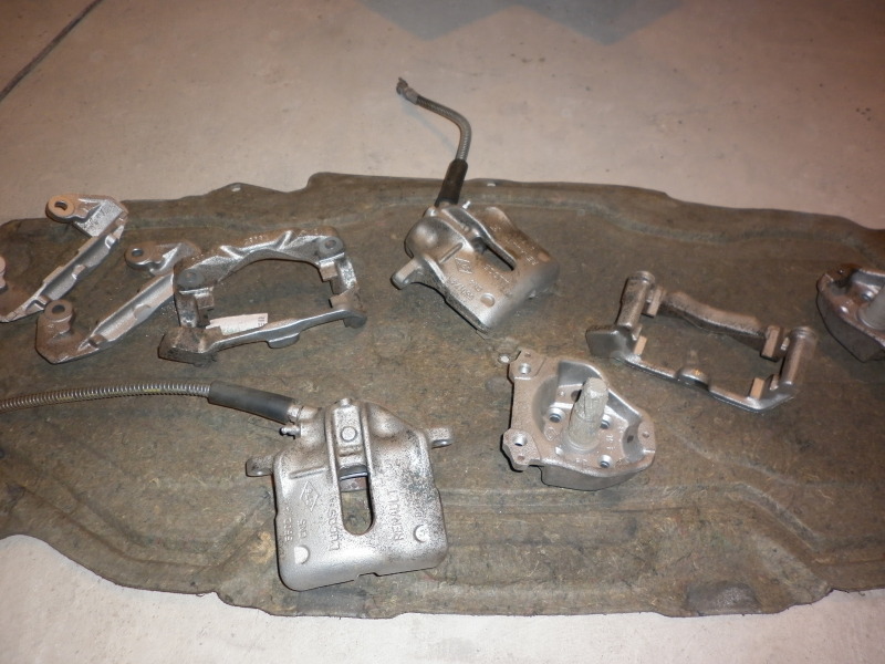

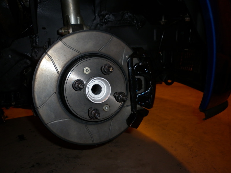

Another night at the lock up trying to knock more jobs of this never ending list.
After painting my calipers etc te other nigh gave them a chance to dry up.
Then after receiving my stud extractor tool as two nuts locked together would budge them.
I then fitted my caliper's, carriers, braided hoses and stud kit. I won't need custom brake hoses after all, I was worried they wouldn't fit with extended track.
Just need front and rear pads and thats the brakes complete.

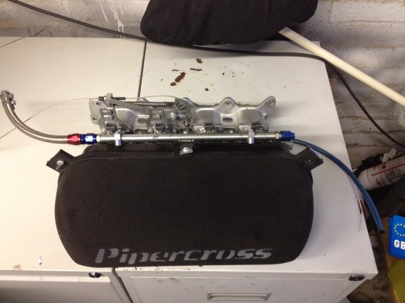

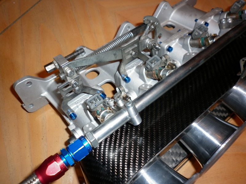

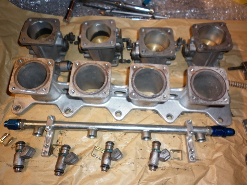

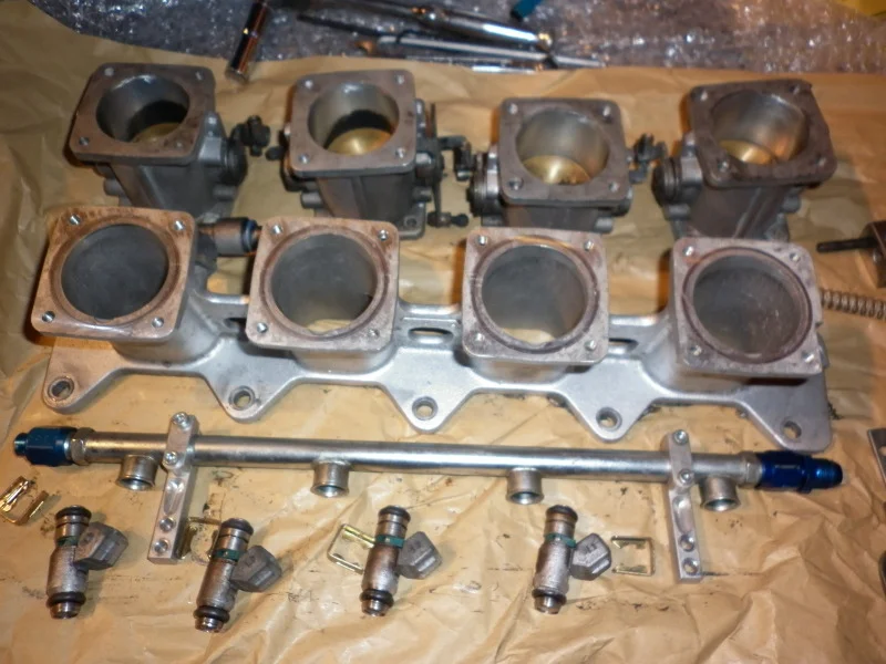

I received my ITB's this morning along with Omex 600.
They are looking a bit sorry for themselves after being on a few cars now and being painted on the car so i stripped them down and clean all the linkages and bolts and rebuilt the linkages.
Manifold will be getting blasted, ported to the head and repainted, ITB's will get washed in a parts washer and a bit of blasting to bring back raw finish then lubed, airbox will get wet sanded and polished back up along with the trumpets and all aluminium parts. Some new anodized dzus fastner's and aeroquip hose and fittings ran internally back to tank and that should be induction sorted on the engine, I will be going with the Omex raychem loom if I can get rid of most of the O.E wiring and probably Race Technology dash 2 as this can be made to speak to the 600.

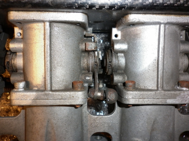

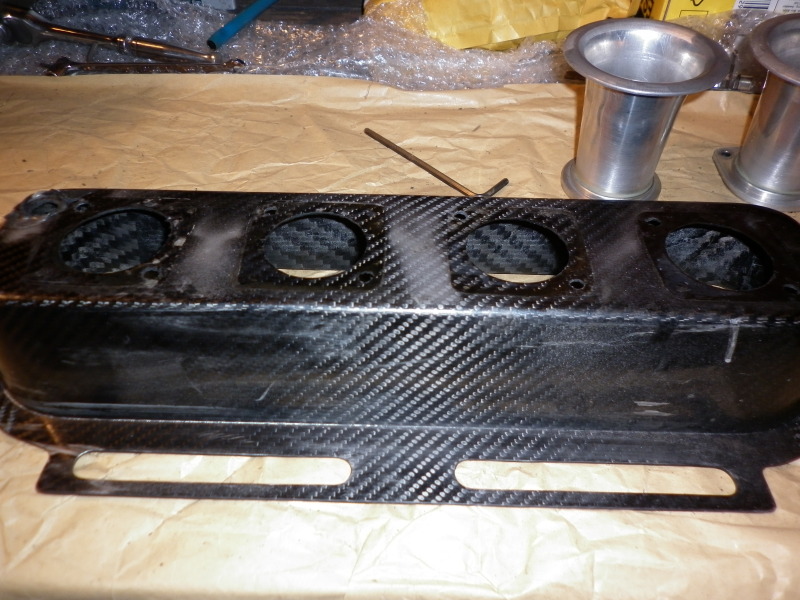

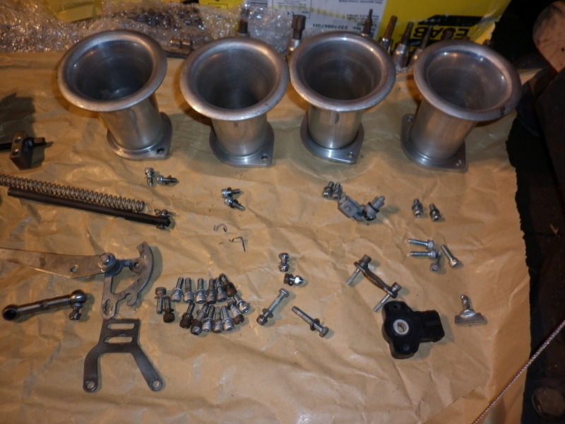

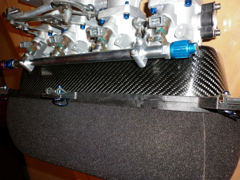

Another little update, couldn't be ar**d with the car today so decided to rebuild the trumpets, looking brand new again with some new bolts, paint and elbow grease.
