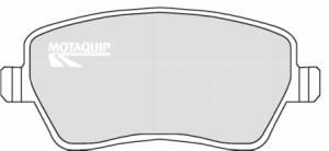

I've been searching the internet all afternoon for Ferodo DS2500 brake pads in the Clio mk3 (non sport/1.2-1.6) fitment. DS3000 seem to be out there but from what I have read they are suited for the track only and don't have much of a cold bite.
Already purchased Mintex 1144's but received the wrong size (mk2's) and heard they give out pretty quickly on track so happy to return them.
Anyone know if they even exist? If not I will give Fred at BTM a call tomorrow.
This is the pad shape..

They don't list them in the DS2500 in that pad shape mate (but do the DS3000 like you say)
Neither do they list the M1144 in it either

Ideally I'm looking for a more aggressive pad as I will be tracking the car in October. Any other recommendations? EBC Ultimax and Stuff seems available but I've not read anything good about Ultimax and Stuff seems to be unreliable..

Ah brilliant. Yeah I should have really checked there first :p Well I should be picking up a 182 or 197 this time next year so I will have a lot more choice and I will definitely use you again. Well it's for generally fast road use as the car is my daily and I will be going round the Rockingham track, 2 sessions over a weekend. 30 minutes each. Maybe more if I feel up to it.
Really I'm just after the best pads available for Road and occasional track use that are available for my Caliper.
