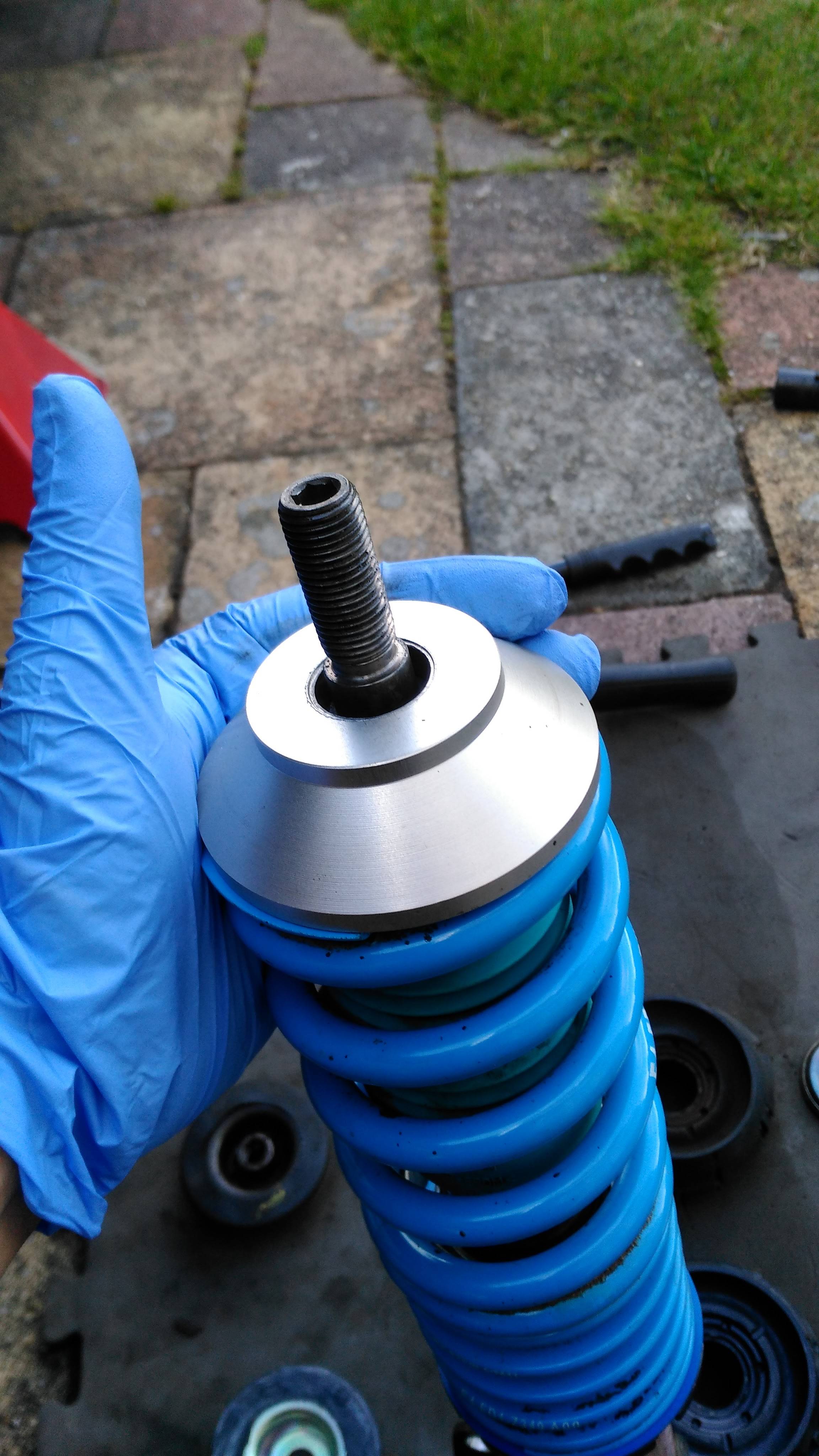

Rear Setup : Dampers

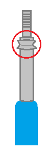

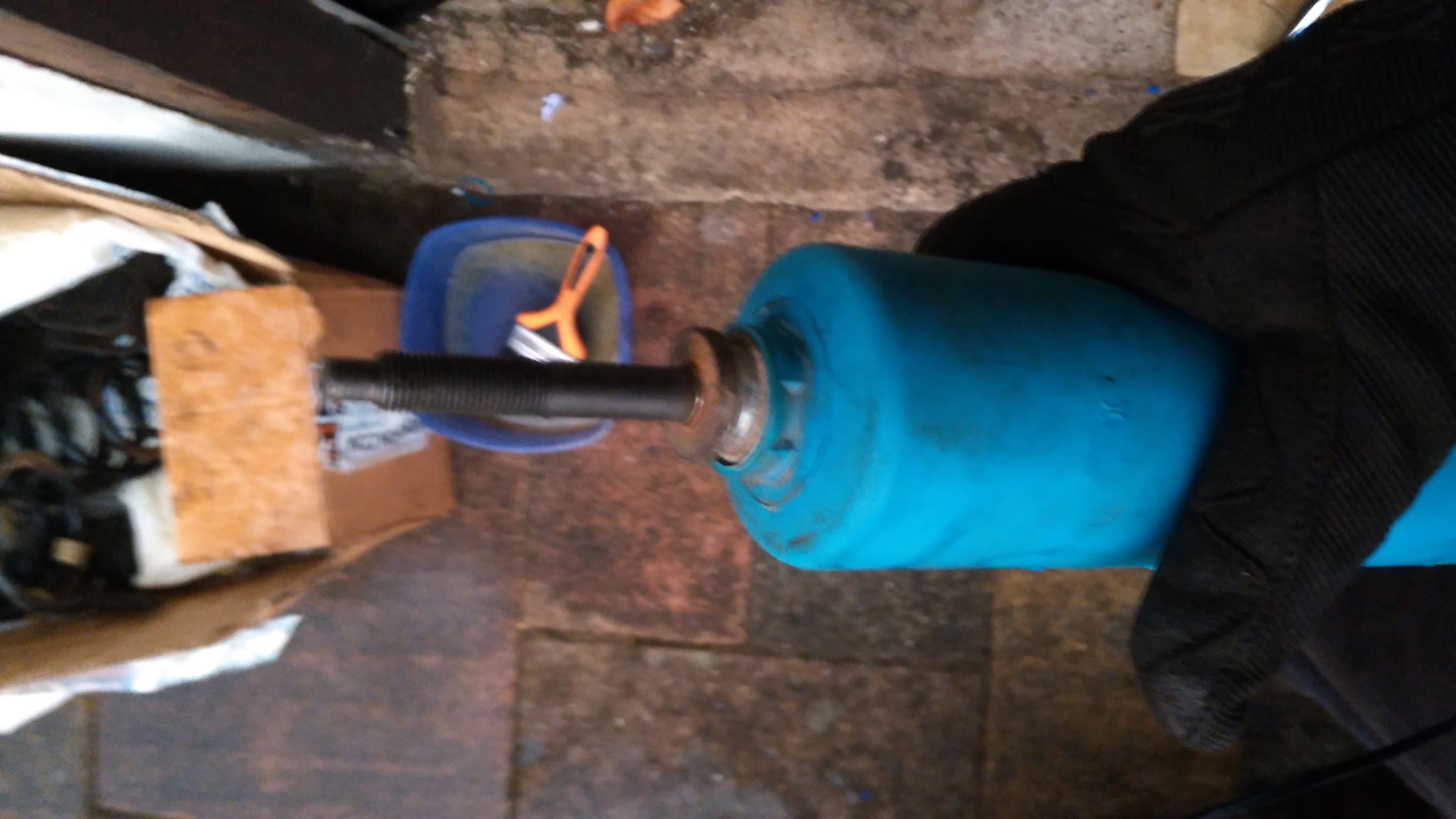

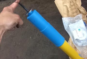

Mine came with no large washers for installation. Instead they came with some metal bush-type torus affair at the bottom of the thinner metal shaft up by the threads. Frustratingly I failed to take any photos so please see the area circled in red in this dodgy paint reconstruction diagram. It was like a deflated metal torus that would only seat down the shaft properly one way.
This differs from what i've seen on @incy-spider 's reply to @dann2707 's 182 thread where it was said that the rears should have a concave washer that sits on the foam under the blue plastic boot and then another flat washer just below the rubber mounts that sit in the bodywork, as seen in his photos re-hosted below
Is the oddly shaped metal bush/washer on my shock a later design, or should I still have the larger washers as seen on other threads?

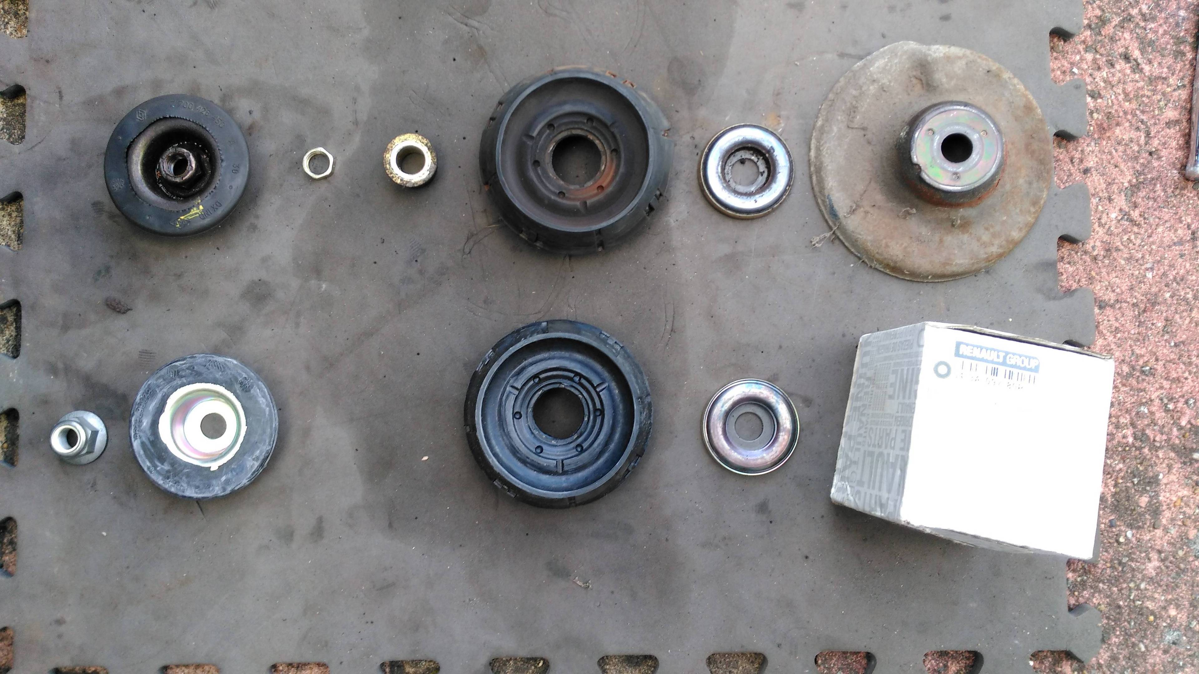

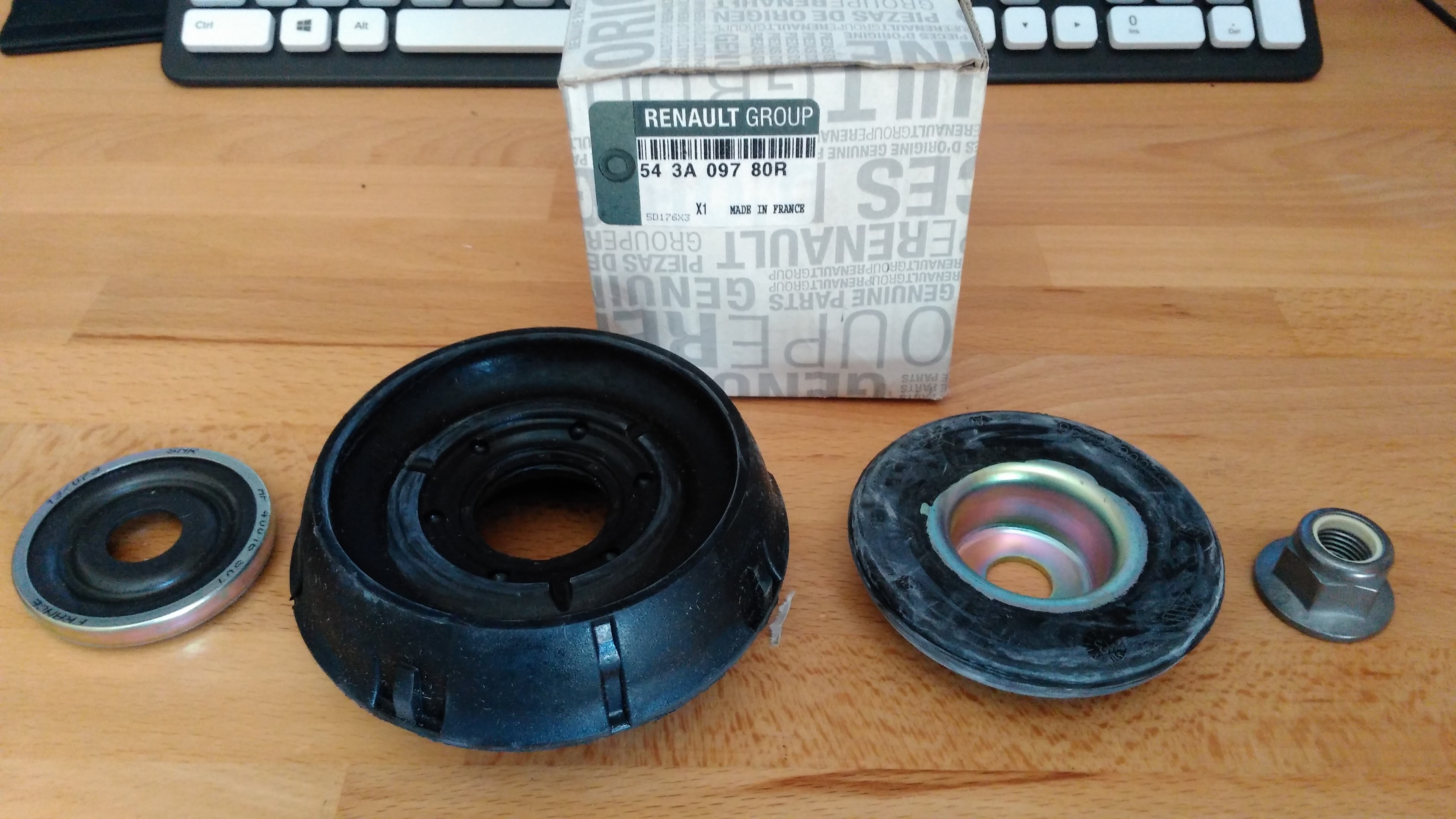

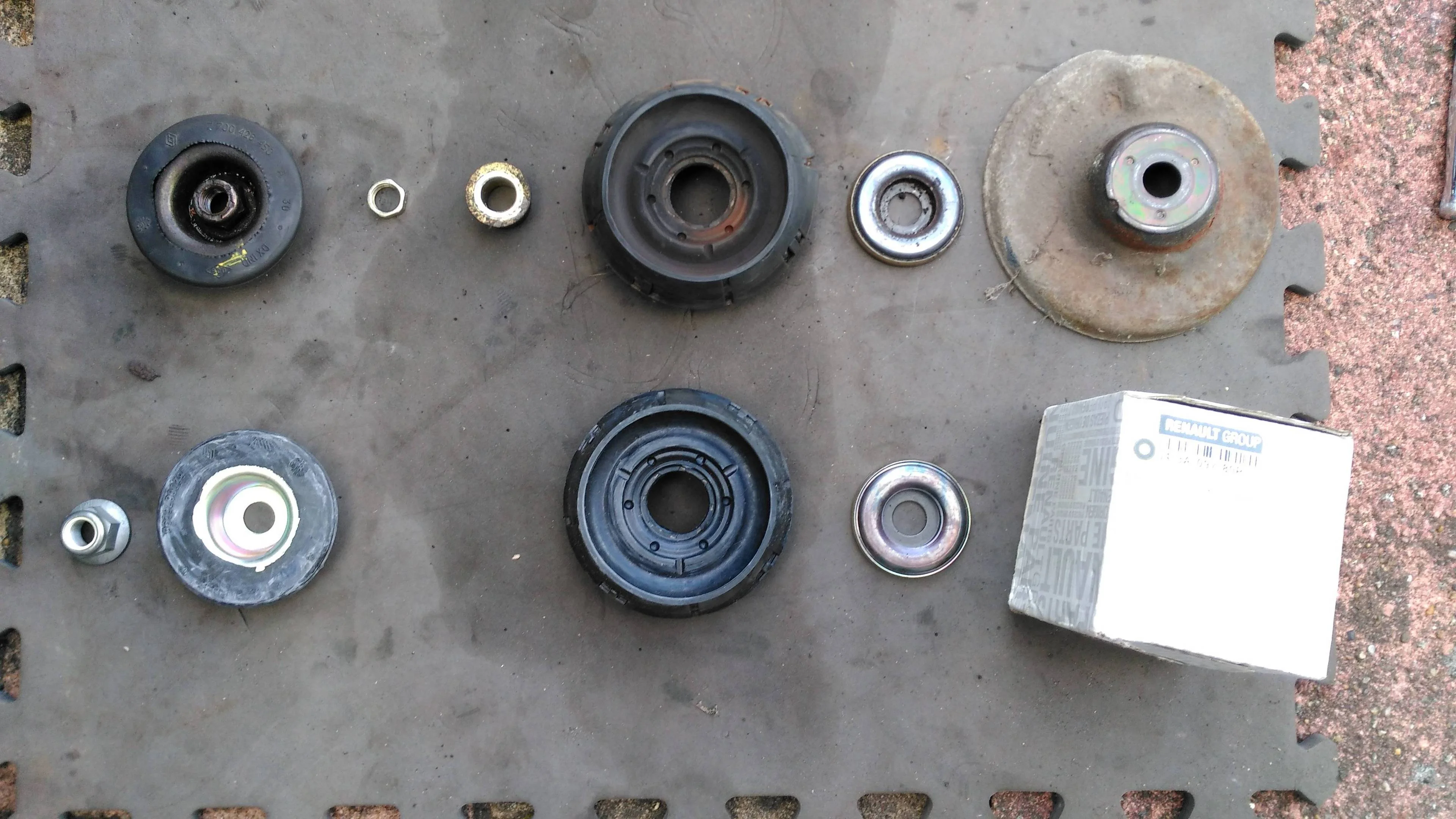

This is something that's been covered a few times in other threads but I wanted to double-check that i've understood them correctly. I ordered new top mounts from @Renault Wolverhampton which arrived next day. They looked like this.
Dismantling the strut on the car I was left with these parts.
They stack from right to left. Upper spring cup, strut bearing, rubber donut, old style spacer, 17mm thin nut (holds it all on). This is then poked through the suspension turret where the top mount and 21mm nut are bolted down on top. I used the flanged Renault locknut that I got new with my topmount kit.

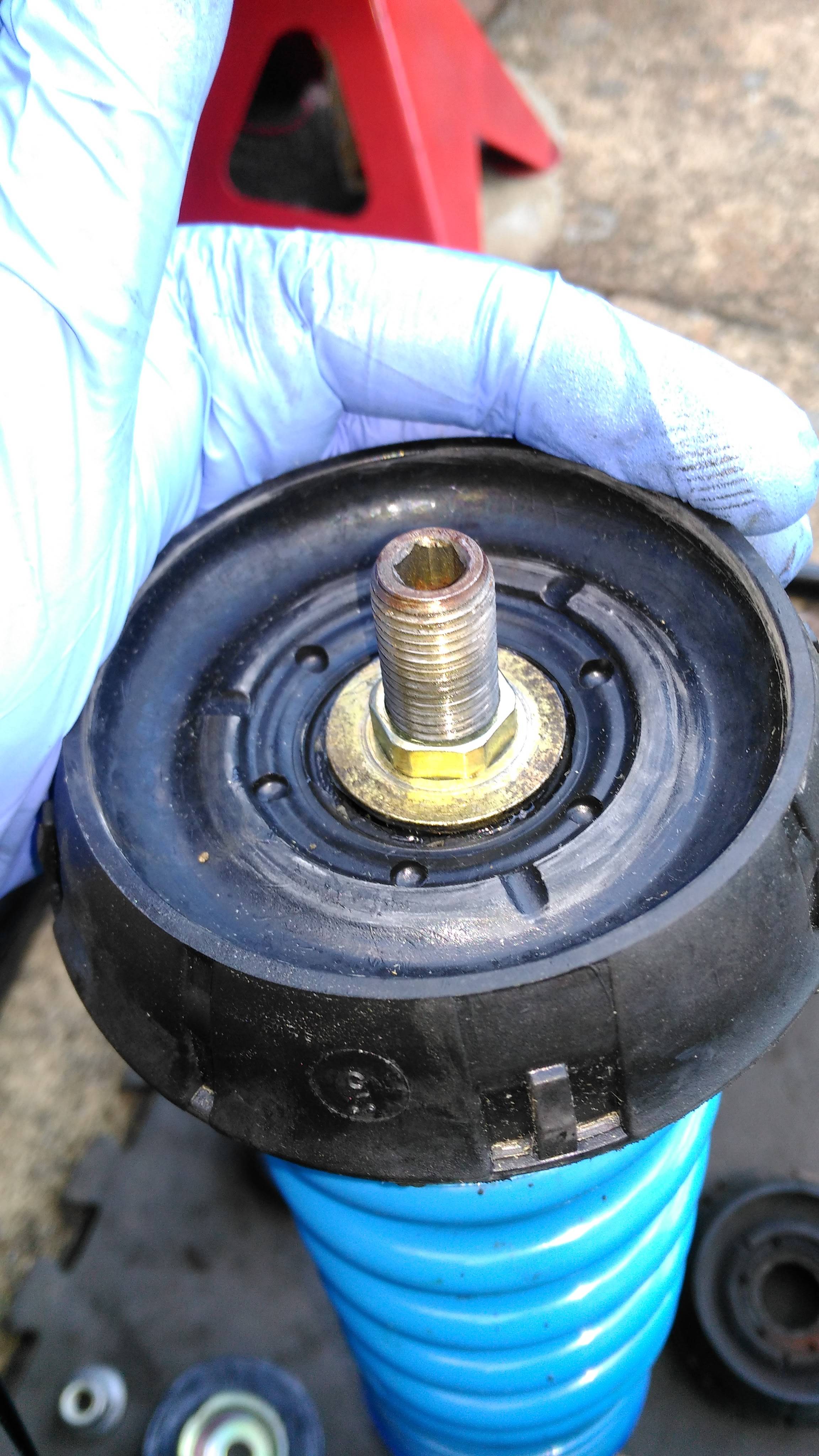

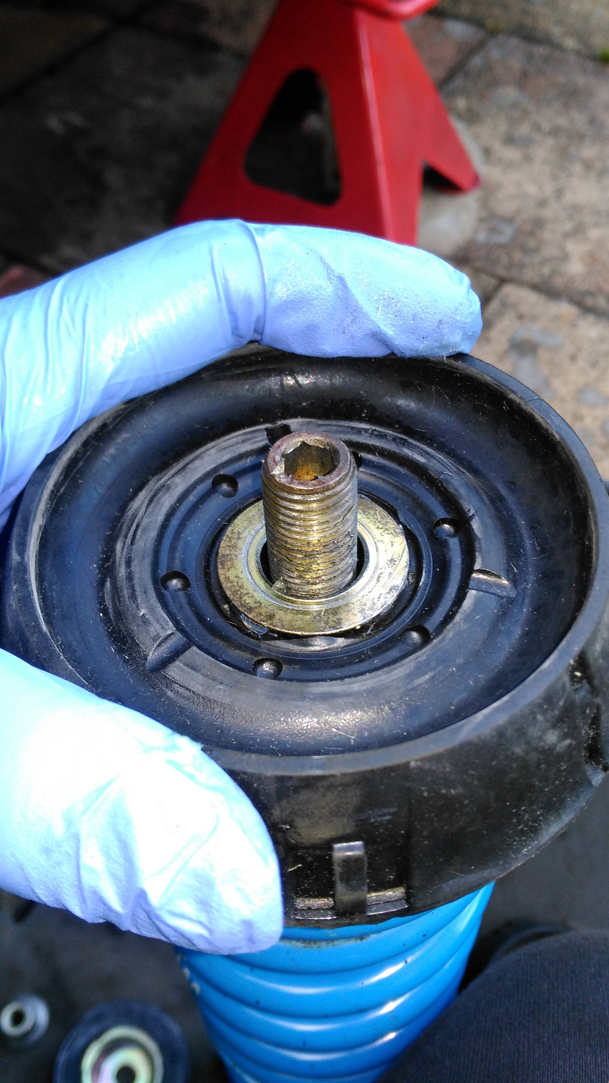

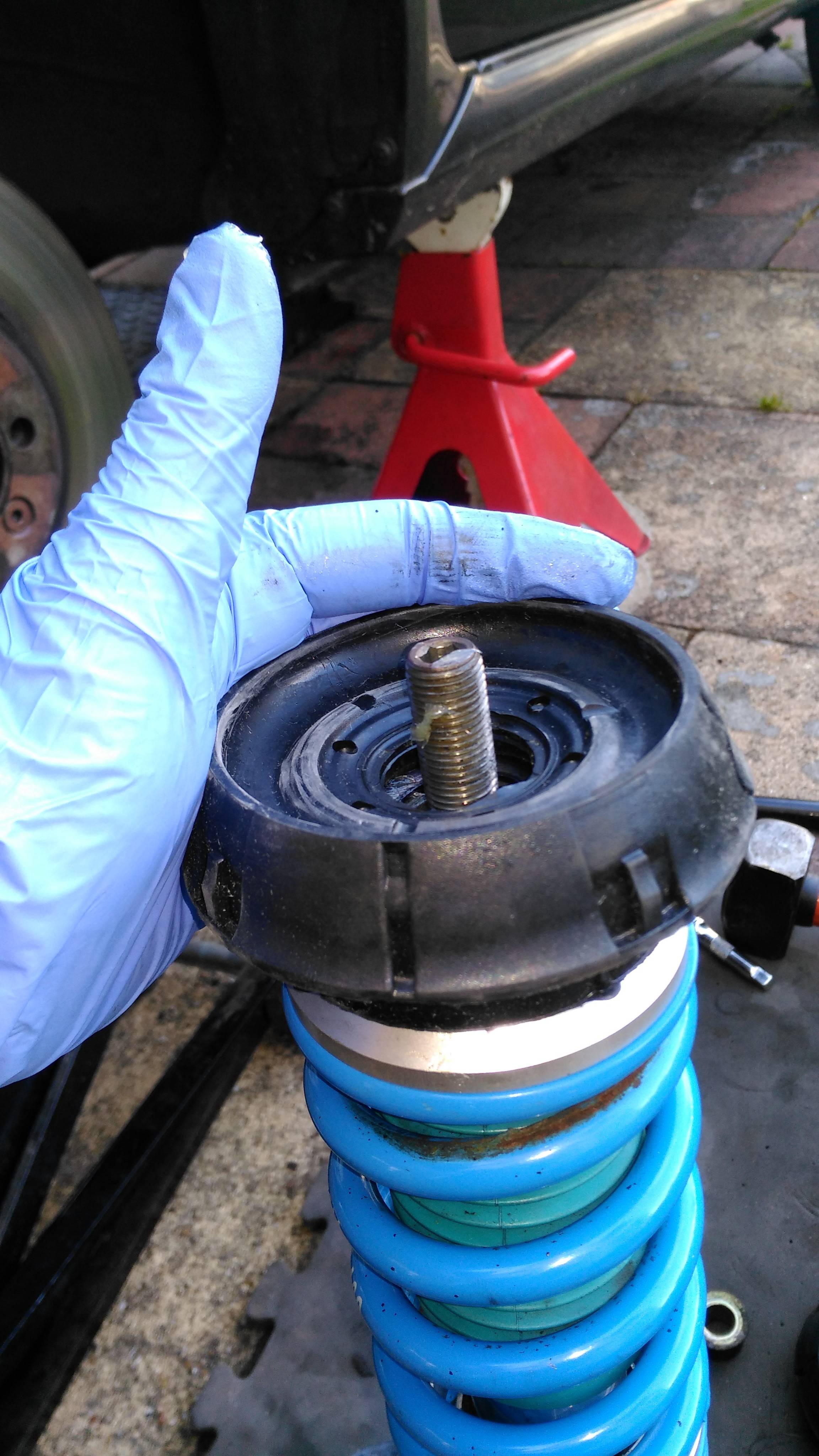

Thus on the Bilstein's the step by step rebuild goes (Excuse the matching blue gloves):
Bilstein top spring cup
is covered by greased bearing with recess facing up
then the big rubber donut
the 'old style' spacer slips in
17mm thin nut clamps it all down before the entire lots it fed up through arches into the car.
The top mount is then sat on-top and the 21nut is tightened down whilst the shaft is held in place with a 7mm allen/hex driver.

The rear dampers look to be the older style setup mate. You'll be fine without the washers as the oe rear top mounts have a metal base to them anyway. They've obviously changed the design to get more support to spread the load.
Regards the rear height adjusters, just take them out completely if you want it to sit lower. You'll find that the rear springs just become a bit more audible as they will move around a bit, but mainly over bumps.

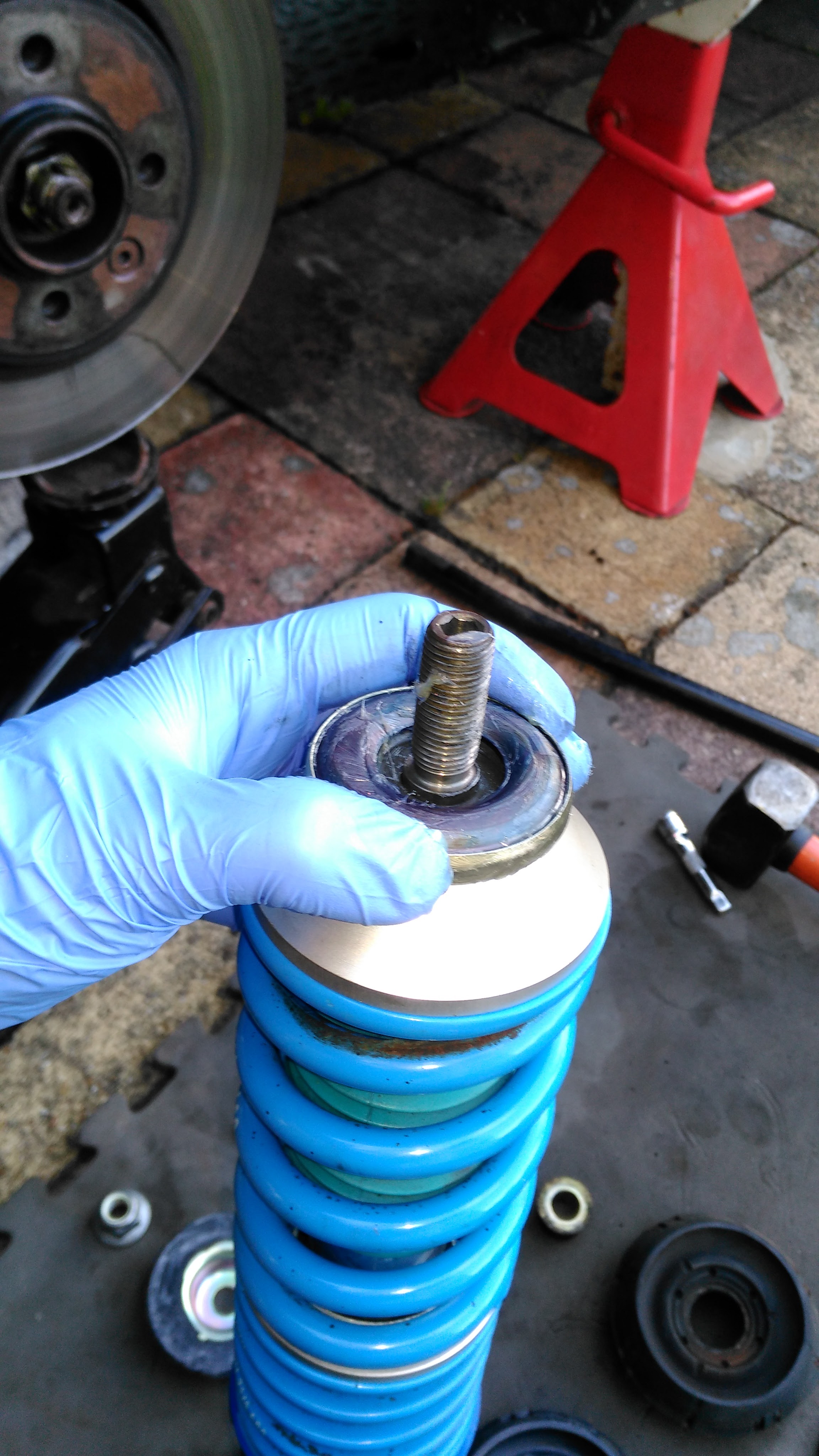

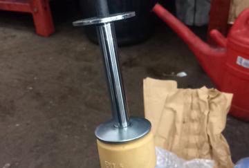

@NorthloopCup Thanks for clearing that up. I did get a photo of the damper top but by the time I got it out of the car it was getting dark and raining quite heavily.
You can see the metal part just above the blue dust cover. The lower rubber mount slides down over the shaft which then goes up through the suspension turret.

Given you bought these from me, you could have tagged me in and I'd have answered your questions.
They are the original b14 design, and the "metal part" you highlight was the pre-cursor to the washer set up you have highlighted in your early post.
If you were supposed to have the washer setup, it would have been in the box with everything else. Funnily enough.

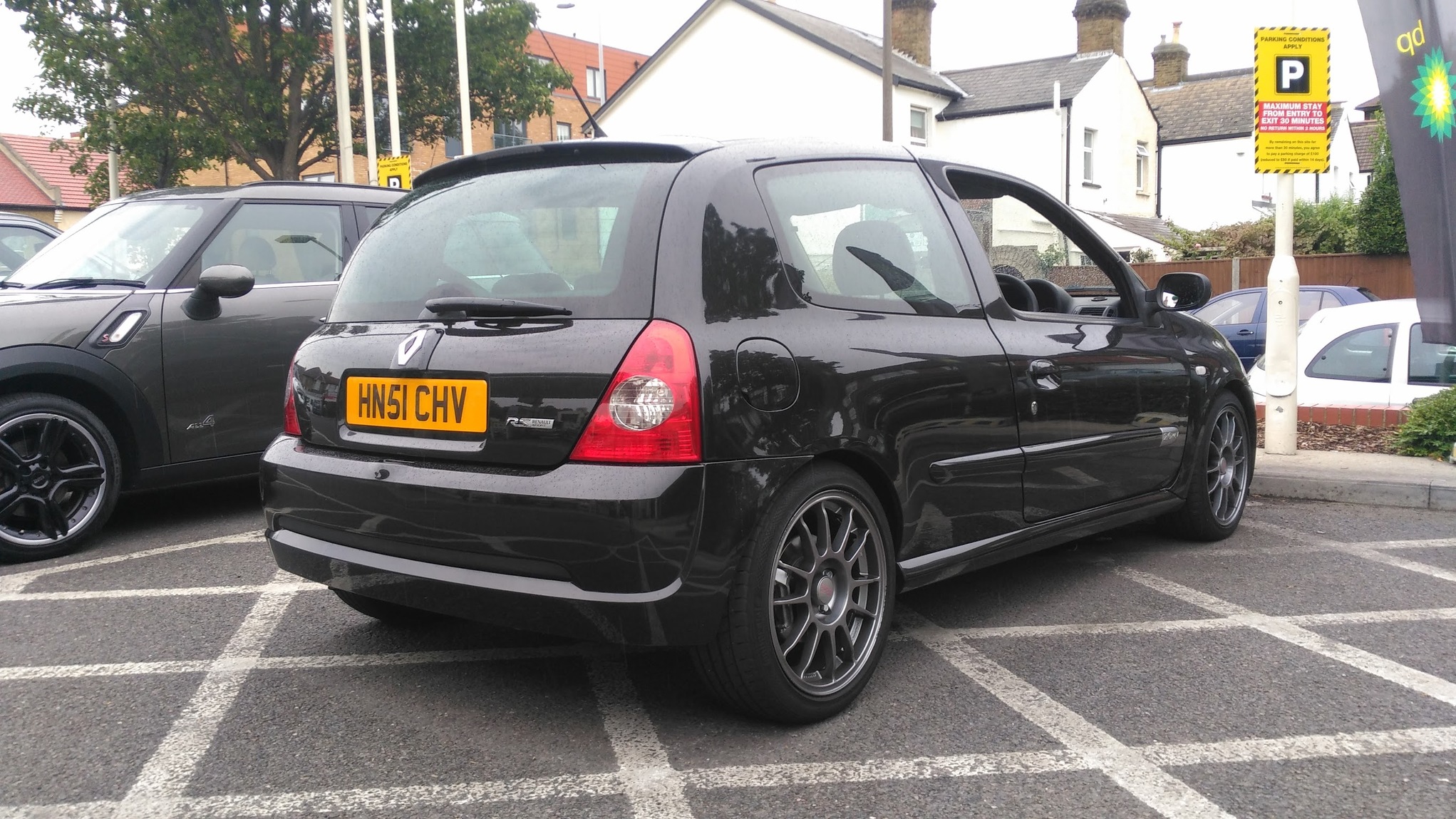

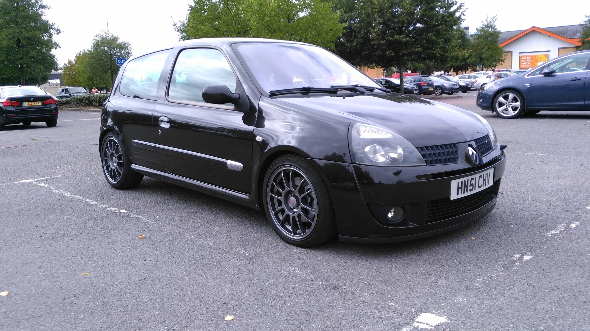

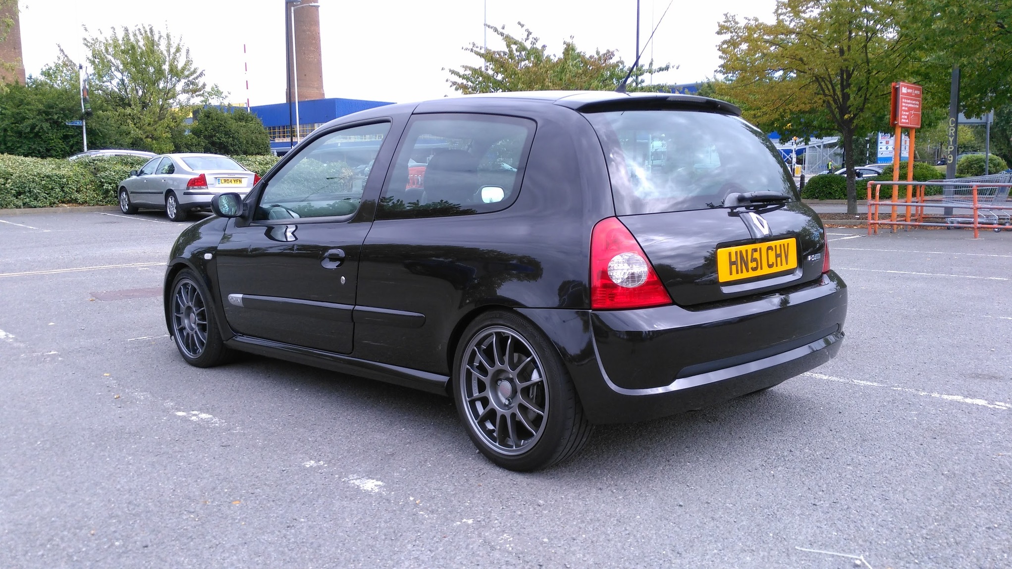

I removed the rear spring adjusters but left the threaded section in the rear to ensure the spring seated correctly. I then set the fronts so there was 95mm of thread showing from the bottom of the spring (not lock) ring to the end of the thread.
Measured from the arch lip directly above the centre of the wheel, to the floor I had : Front L/R 580/582mm & Rear L/R 576mm/580mm. This left me with a great looking (not overly low IMO) car with this 'stance'
But I did find at this ride height that the ride was extremely compromised. The car never felt that it was soaking up the small bumps, on a B road it felt like the car never 'rested' or stopped moving up and down, for want of a better description. It was always shifting and bumping about, which for a daily driver made the car tiring to drive.
Since then I have re-installed the rear spring adjusters and raised the car to : Front L/R 595/591mm & Rear L/R 589/590mm. This extra 10mm has really made a different and the car is noticeably more comfortable (probably as the helper springs aren't squashed quite as flat anymore) although I feel the car isn't as low as I would have liked (looking at photos the rear looks higher than my old car with its cup dampers/eibach sportline setup!).
Over the weekend I may experiment with winding the front down a touch before it goes for its alignment, but would like to know if there were any considerations regarding the front to rear rake.

Try and get about 10-12mm of rake mate. Set the right front coil over around 5-6mm higher than the left as well. Right hand drive remember so more weight on the right. Then set the left rear 1/2 to 1 turn of the adjuster higher than the right rear. It's all to do with corner weights and diagonal weights.

It looks too flat to me. I.e. Not enough rake.
Also, there is a balance between looks and peformance, and I'd always go with performance personally. I'd rather it was higher and handled better, than lower and looked "cooler".
They aren't designed to "slam" it flat. If you want the slammed look, buy a VW.

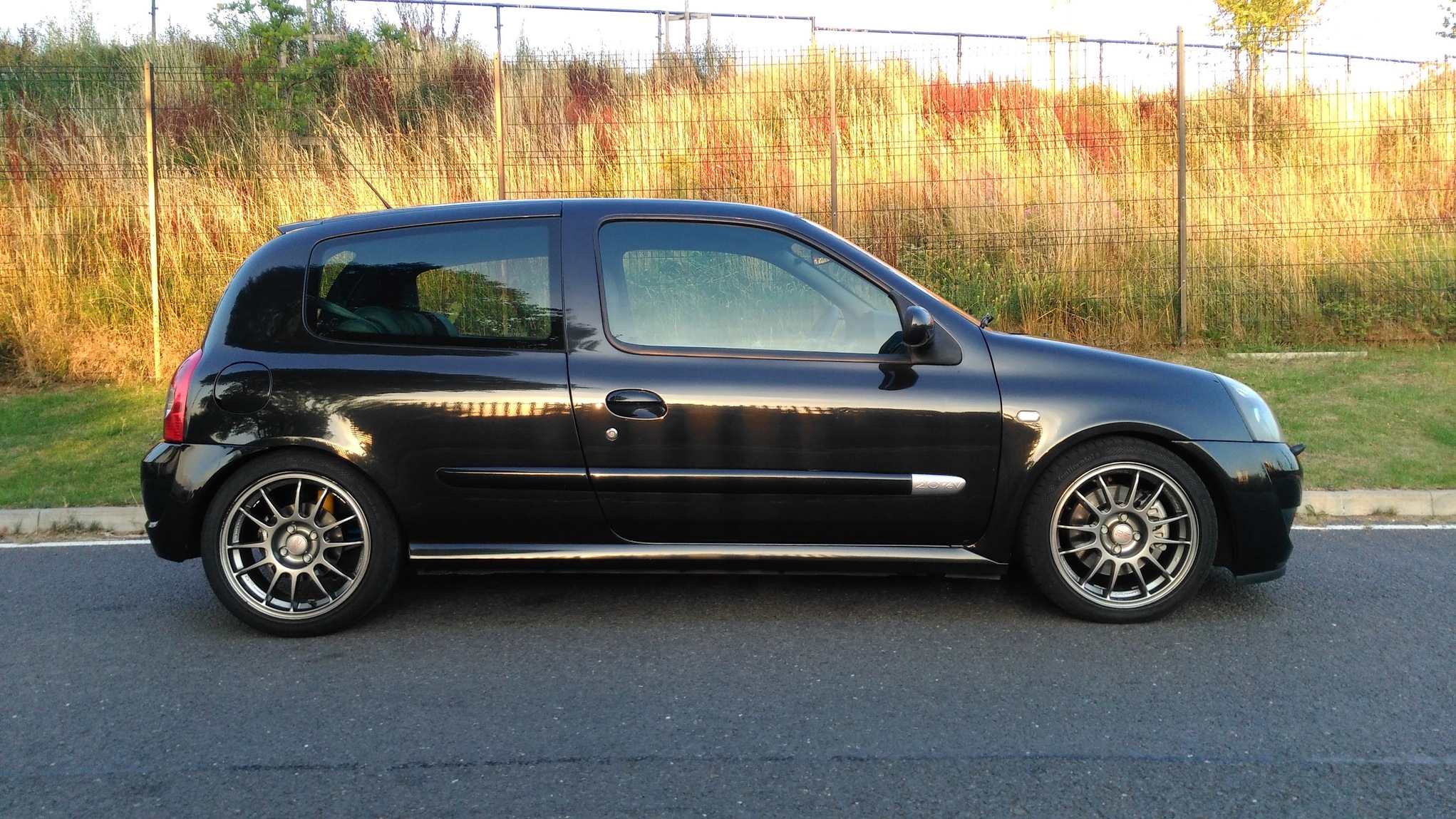

I ran mine with more rake. You can see it in these photos;
