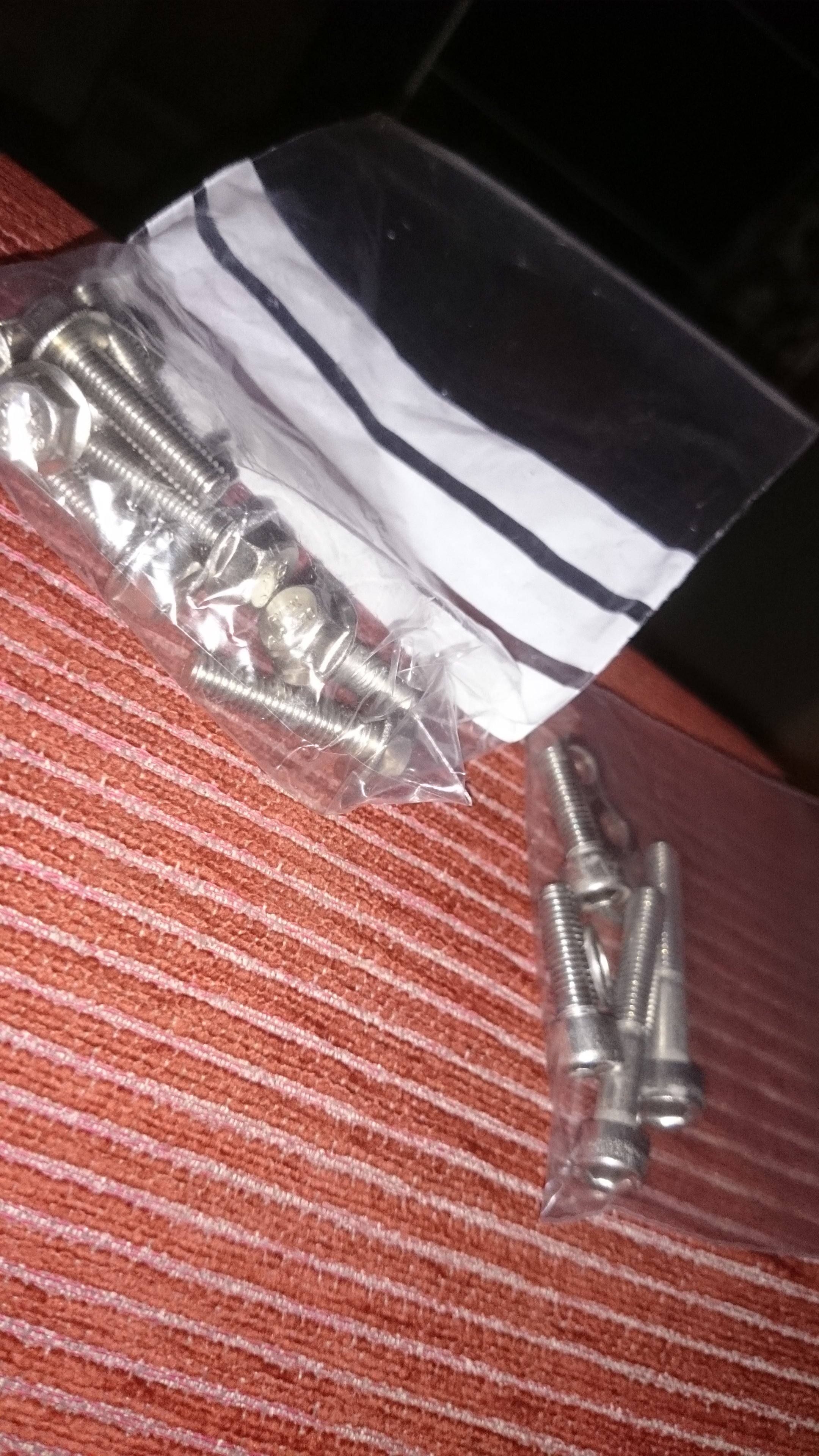

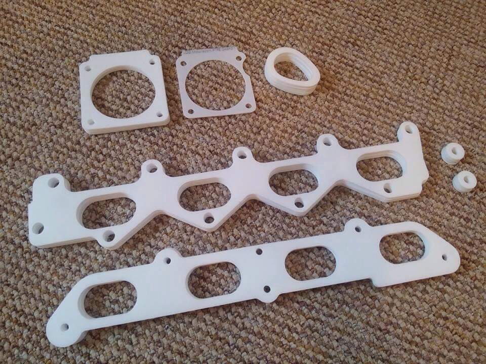

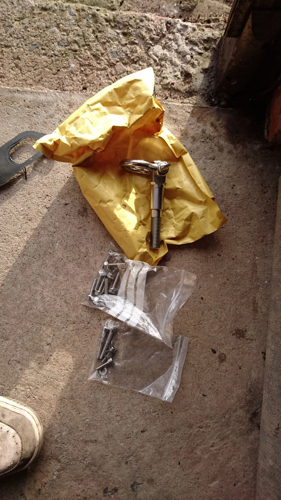

More parts arrived and ordered foe the engine bay overhaul,
New bolts for the plenum as I learned my lesson last time about how easy they snap in half.... And nicer engine cover Allen key bolts,
And ordered muhself a complete set of ptfe gaskets for the inlet and throttle body
Next in line is a battery cover and also maybe a silver tow eye to add a little somethin to the front end

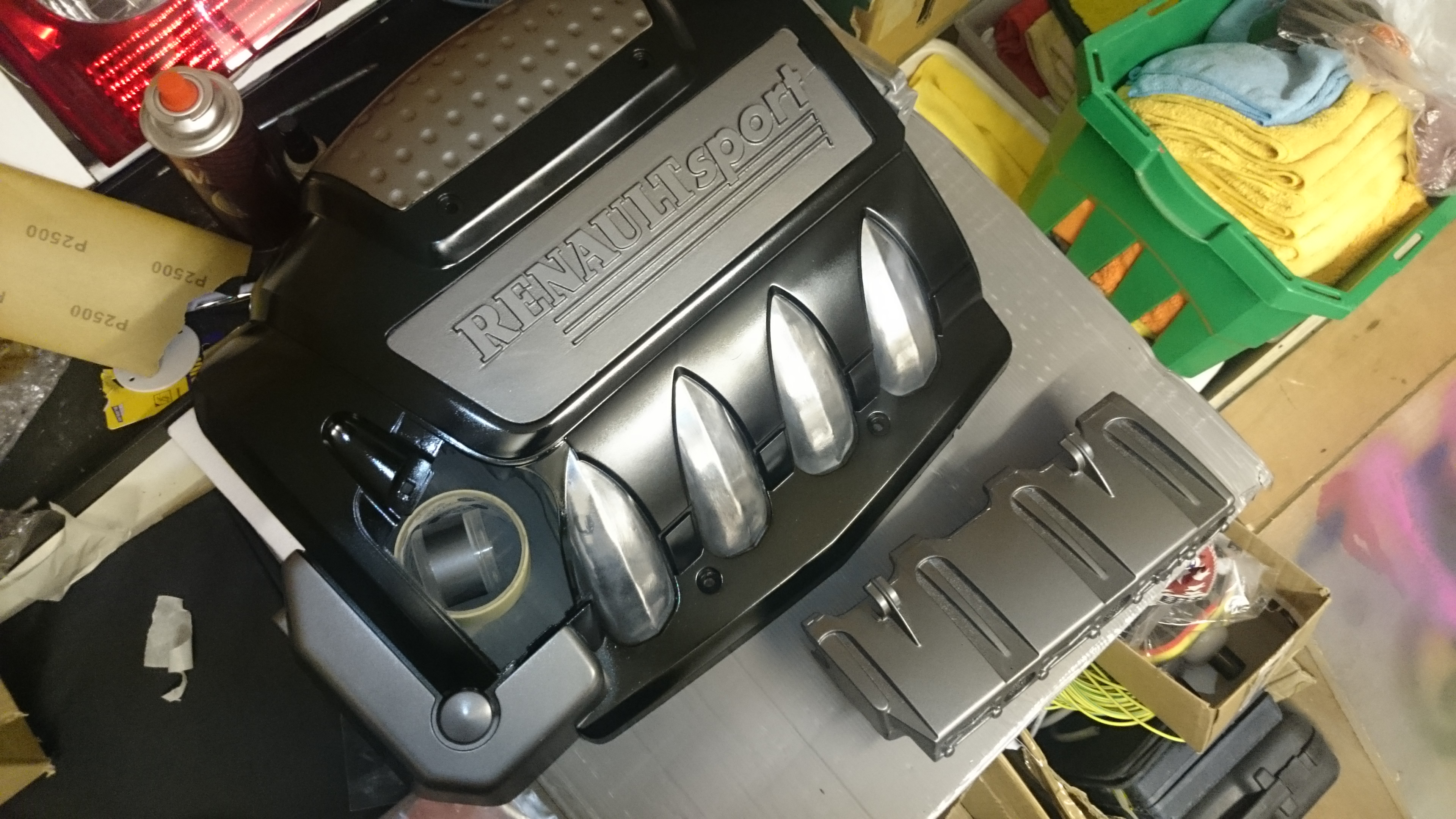

Not much to update on overhaul yet. Nearly finished painting the engine cover and ordered the standard 2.0 16v sticker to put back on, gunna order up a battery tray and itl ne good to fit, dunno which tray to get though

Where did you get the gaskets from mate? I wouldn't mind a set of these[emoji3]

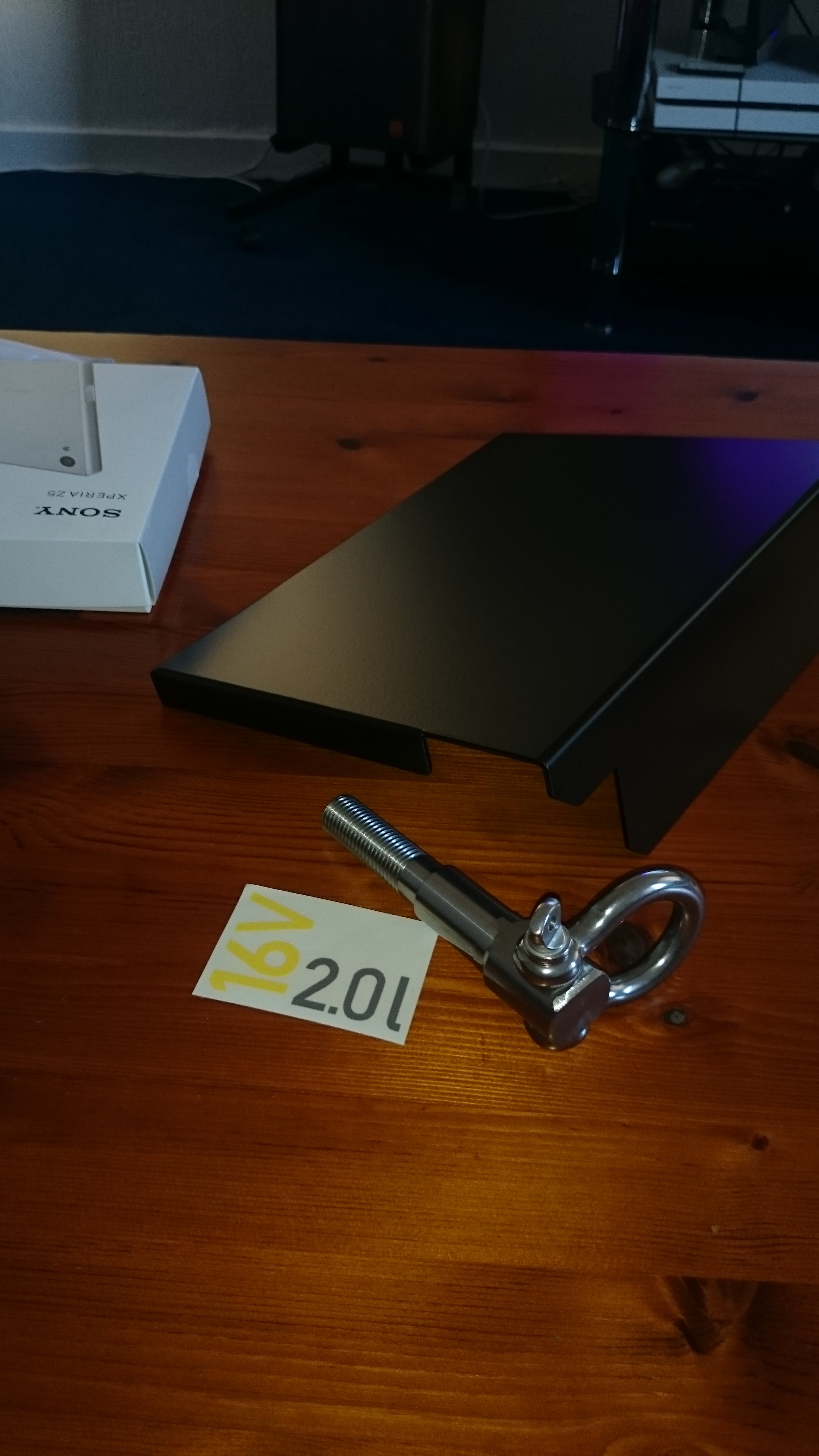

New bits came, battery cover, tow eye and the new sticker for the engine cover
Now it's time to get the engine bay overhaul under way!!

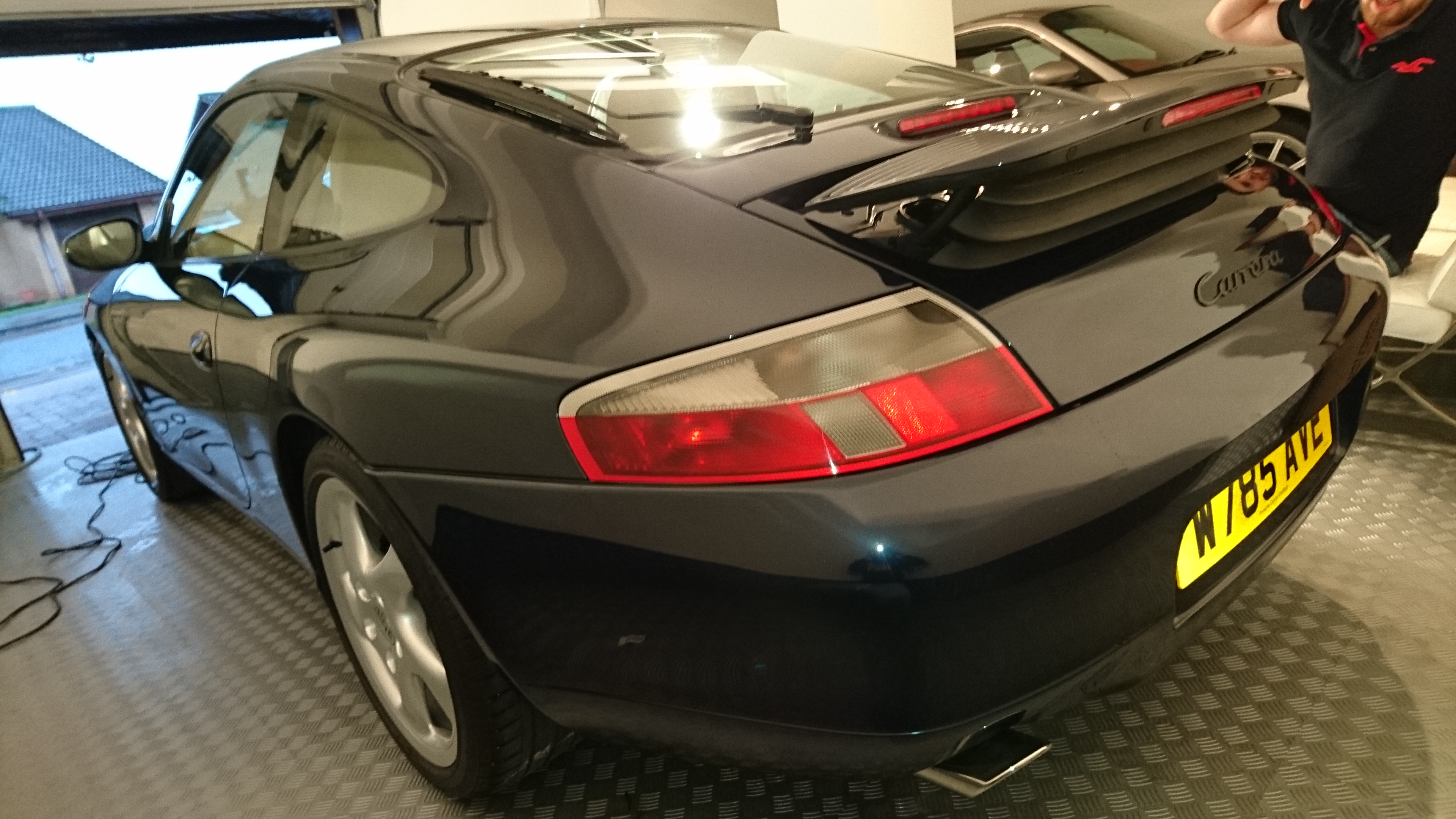

More parts came, may have ordered a Decat, engine bay hasn't been touched yet got busy last weekend detailing a Porsche ]

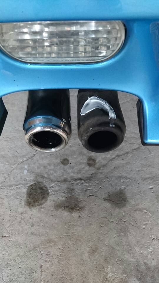

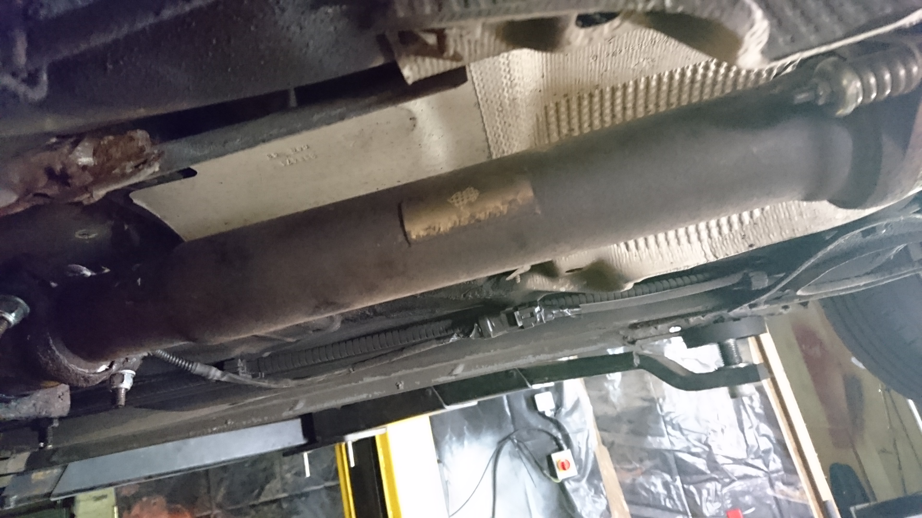

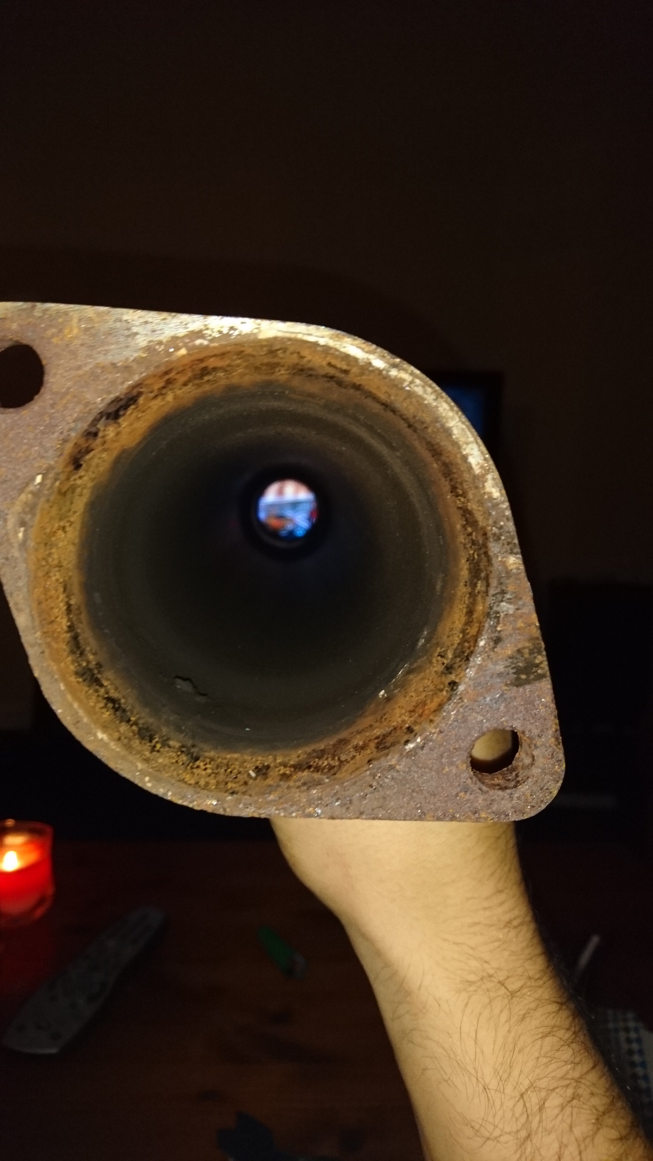

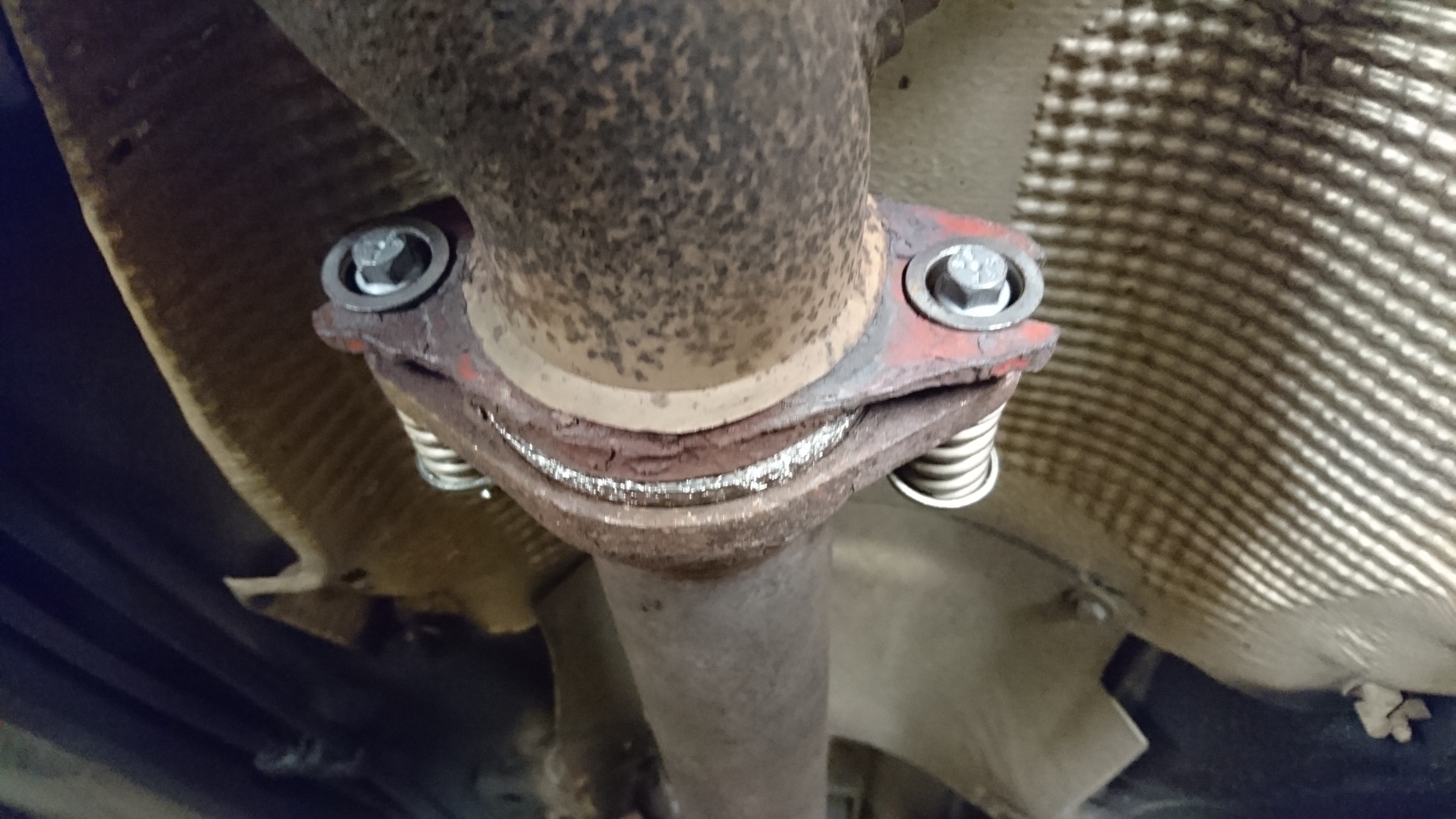

Finally got my Decat fitted.... Much loud.... Love it actually feels better too, and got the screenshots and numbers needed on the rs tuner to send away for a map and a license
Cheap Decat was cheap, had been warned about the Toyo Decat badly fitting but it seemed to be perfectly fine
Shid the Decat sloth lol

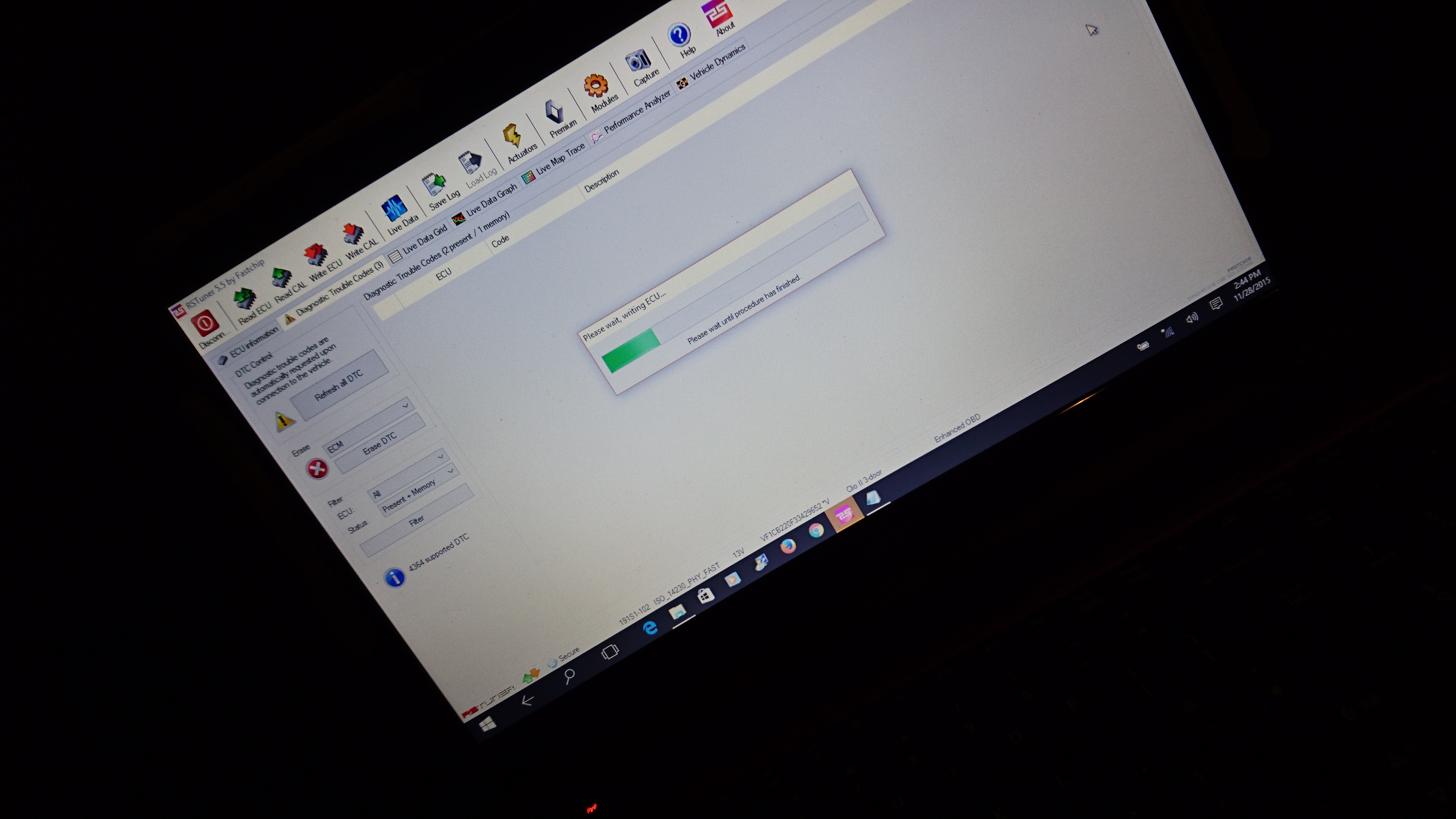

Car mapped today with my rs tuner and what a difference! The car is completely different to drive now and pulls like a Train! So happy with it

120 quid man its the latest firmware and Its also got an airbag module
benji93
  ph2 182, mk1 mx5
Which in more current news wasn't really worth the extra for the module for me cause eine turned the airbag in the drivers seat off however I think it is the whole pretensioner is fucked and throwing up a code
benji93
  ph2 182, mk1 mx5
A had to borrow a laptop for it but it's very easy to do, had to change my battery before mappin because it was giving out 11.8v which fastchip seen this on my rs tuner screenshot and advised me to get a battery before they confirmed my payment for the map file, hardest part of the whole thing was changing the battery haha, man hands are a curse!

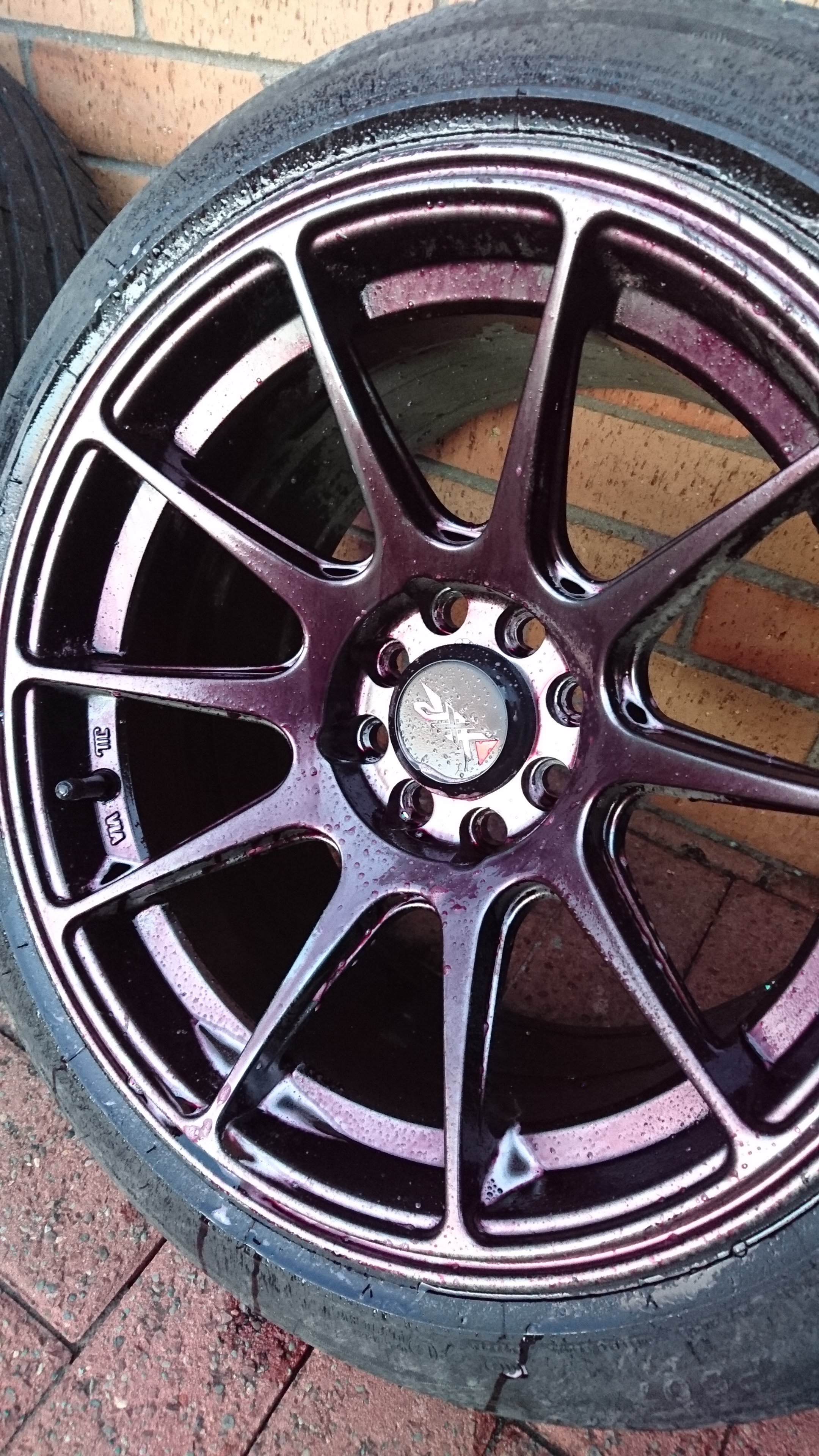

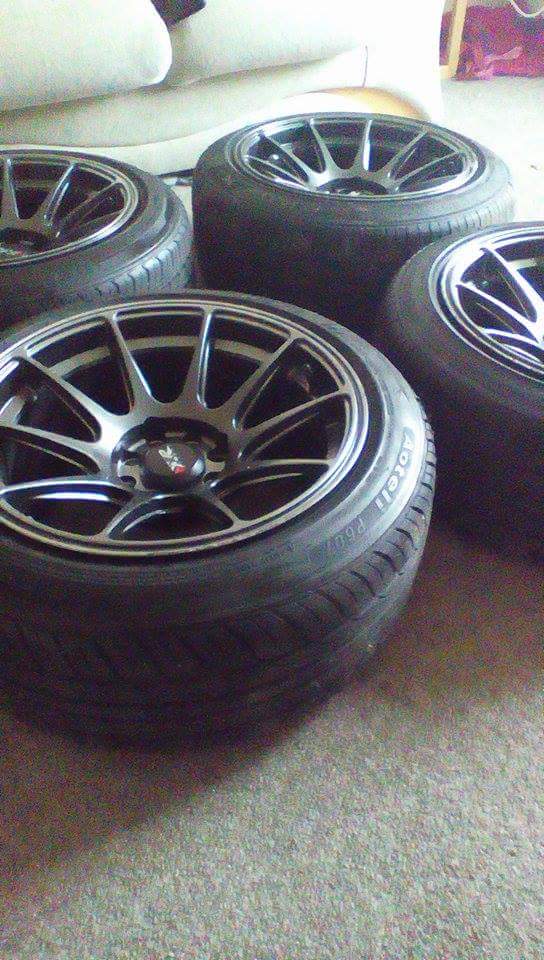

Swapped my 17's for a set of these probably for the mx5 but maybe a test fit to the clio haha
LOL scene points yo

Cleaned the car and the recently acquired alloys
Decon much
However they look good purple

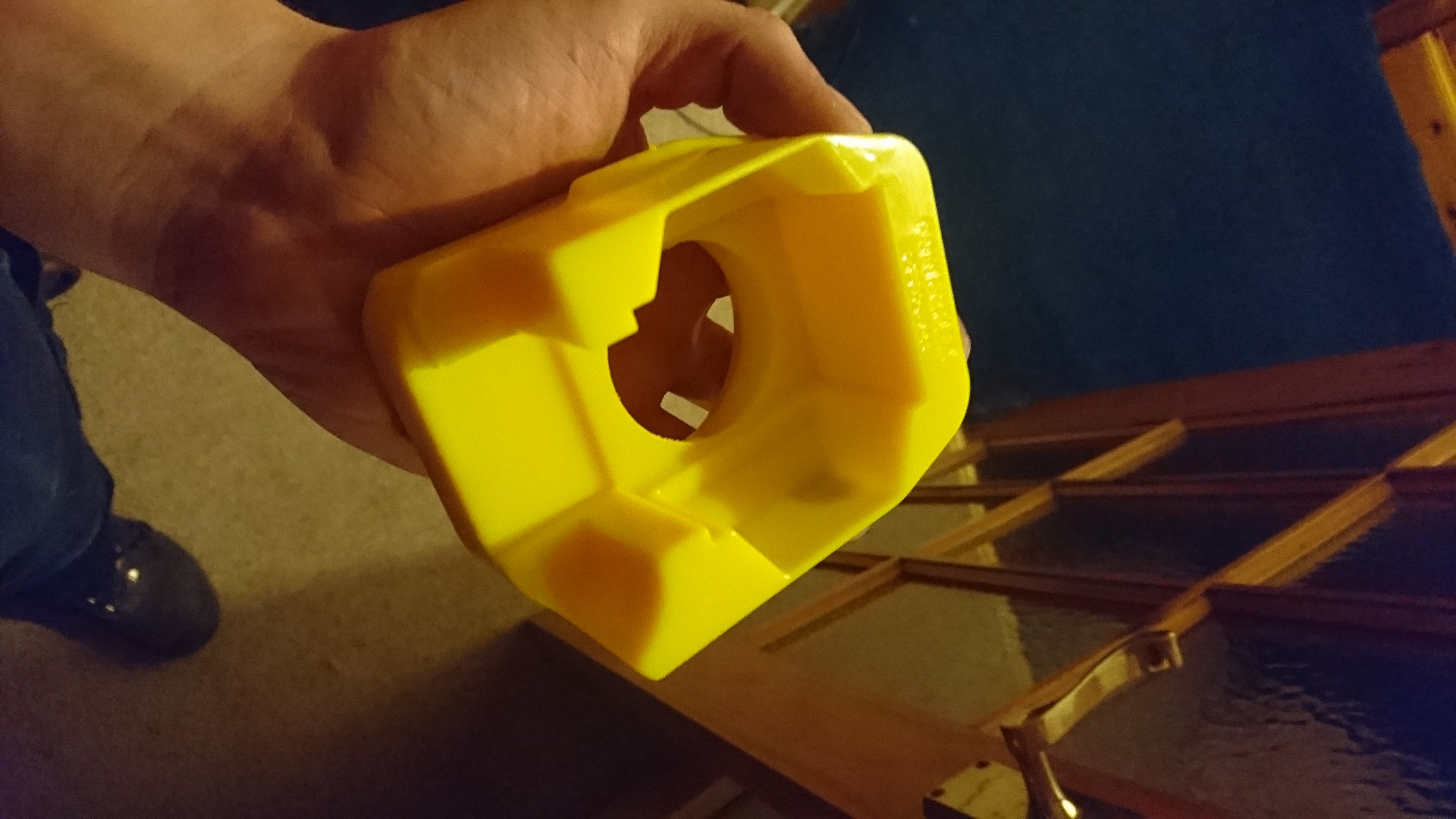

Powerflex upper engine mount support thing came, it's waaaaayy bigger than a thought it'd be! I'll get that fitted sometime toon

Same! Should be as easy as jacking the engine up a bit? Do you know the torque setting for it?
Not a clue mate but it won't be hard to find out!
There you go pal , hardest part will be deciding whether or not to get a new mount and just fit it to thst instead!

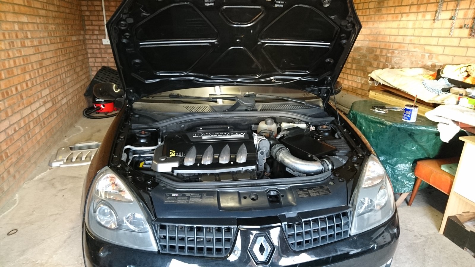

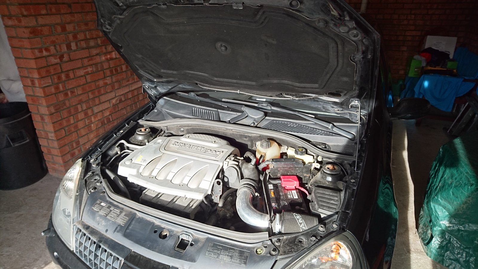

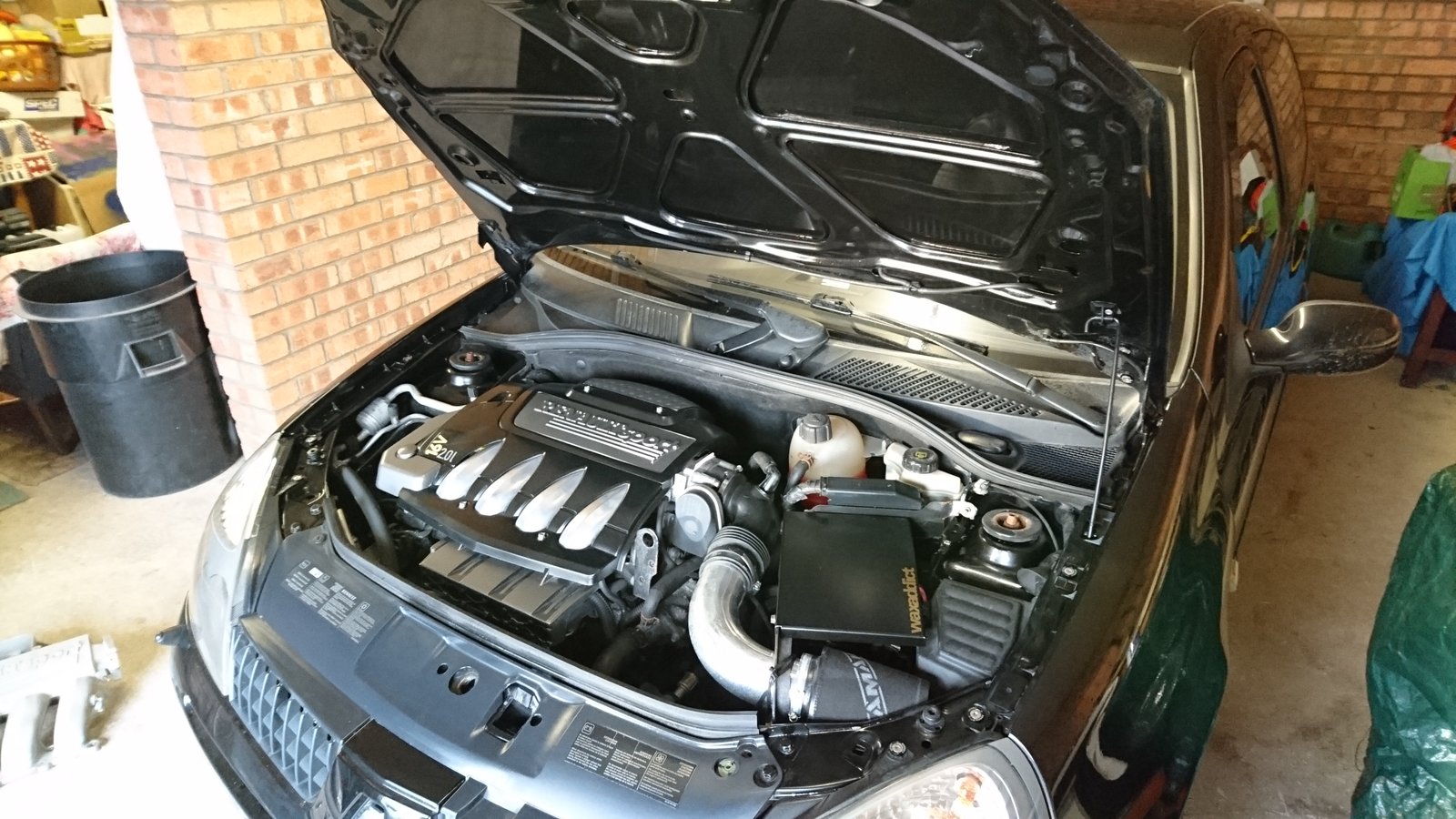

Eventually got round to fitting the tasted up engine bay bits today, cars hunting on idle and at about 2k just now so I'll have a look at thst tomorrow looks good though! Tow eye on aswell, going for a deep clean tomorrow! Or I might hold off for my car salon mystery box to come and see what's in that I can use haha!

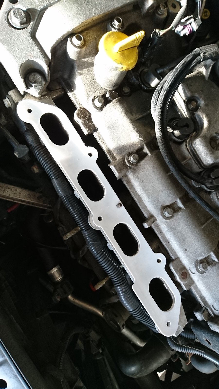

Fitted the ptfe gaskets aswell
Along with towing eye, new plenum bolts and cap bolts for the engine cover

A new coolant bottle and either polishing that inlet pipe or painting it black would finish that right off. Looks good other than that now I can see it properly on the PC!
benji93
  ph2 182, mk1 mx5
Forgot to clean thay bit, noticed after taking pictures , black will be easier so probably black, and correct, the washer bottle is fuckin gantin

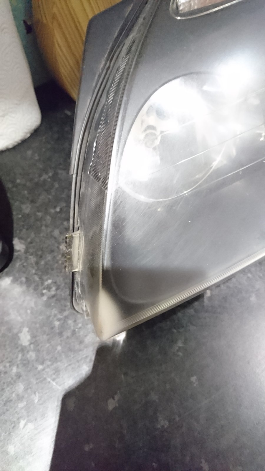

Aw and I need got a cheap set of 172 xenons, turns out one of the ballast support in the passenger side was fucked so tried to heat it up and forgot about it... So need a 172 passenger side xenon and have an awfy melty one if it's any use to anyone haha!

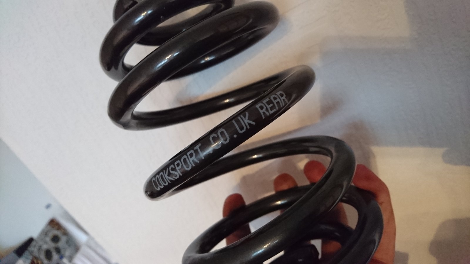

On another note just seen that cooksports are back in Stock so they've been ordered!! Fuckin apex pish can go to the scrap pile

Sorted the Rev hunting, the ptfe gasket on the oven outlet on the bottom of the plenum wasn't really doing anything, put the standard one back in there and it's all good! Clios driving well just now and it's great to see. Cooksports will be a great addition, ordered this morning and got a text saying they'll be here tomorrow!!

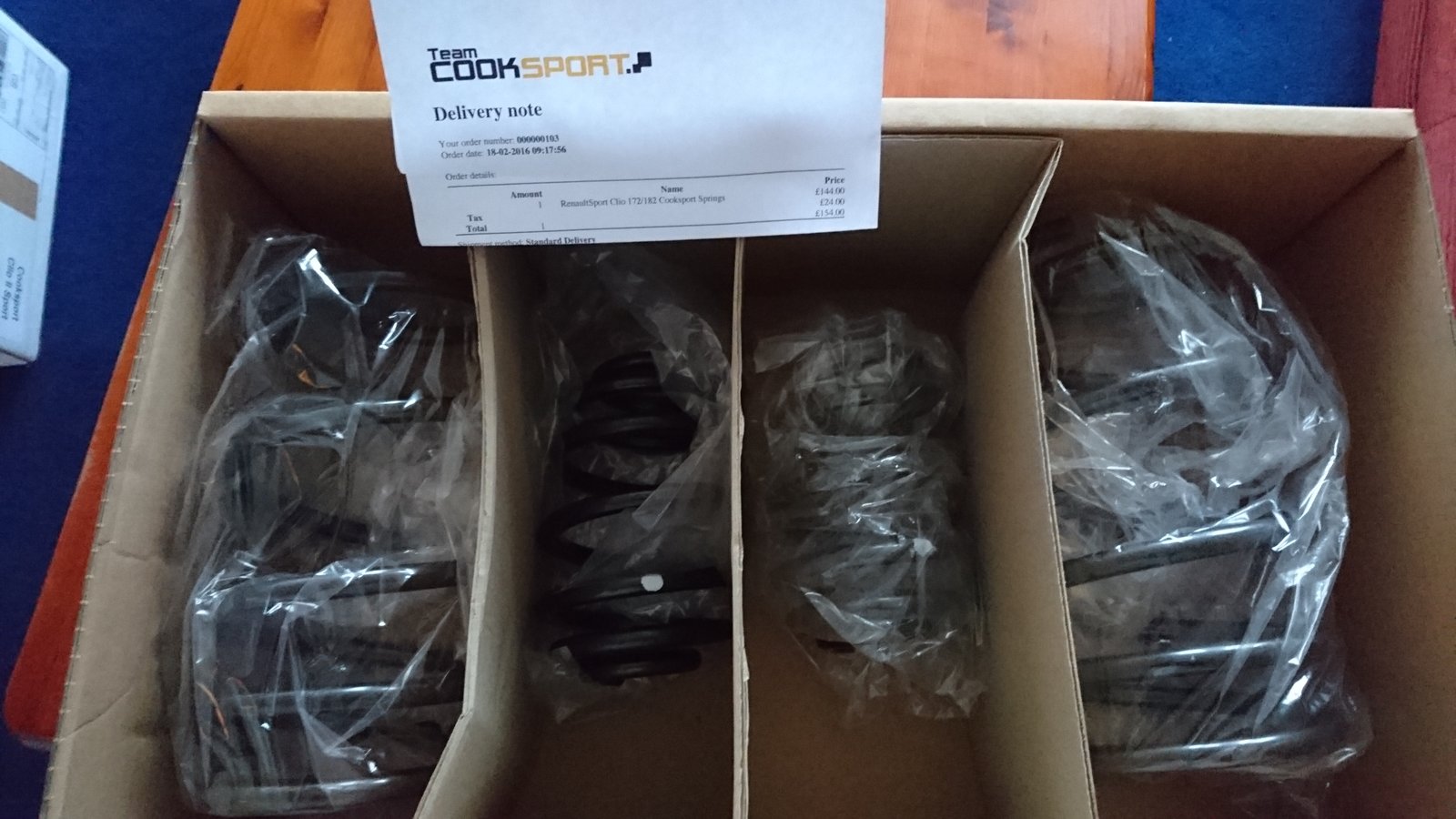

Cooksports are here! Next day delivery is awesome
They'll be fitted tomorrow with some before and after pictures

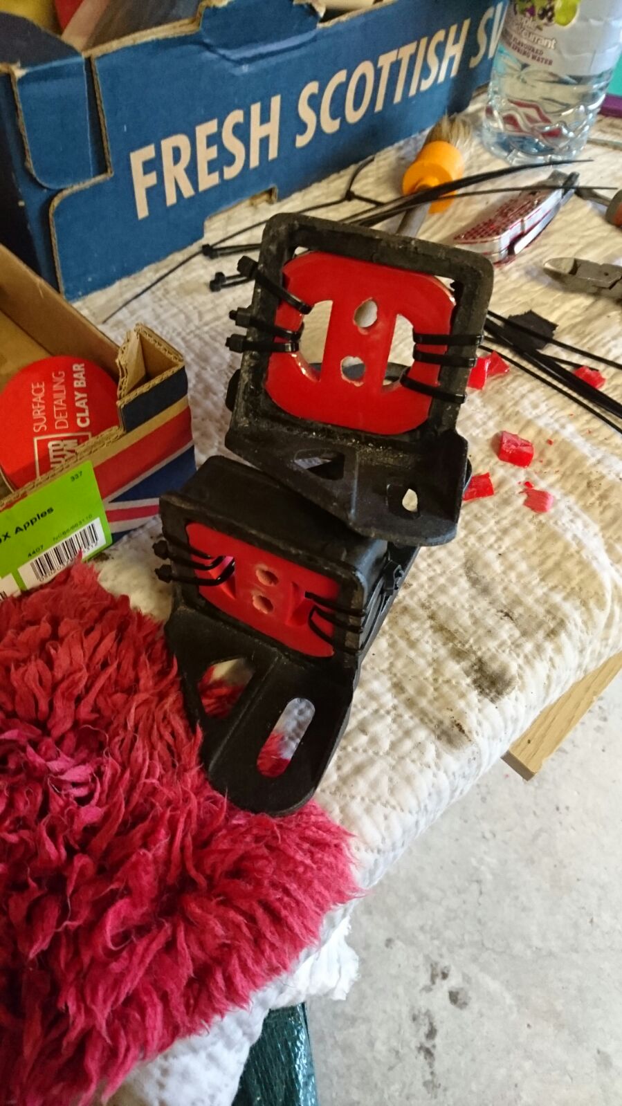

Also fitted my homemade polybush exhaust mounts from a thread on here, sitting a wee bit high so I'll adjust the holes slightly sometime soon but it doesn't bounce about off the bumper any more! Severely happy with the clio just now
