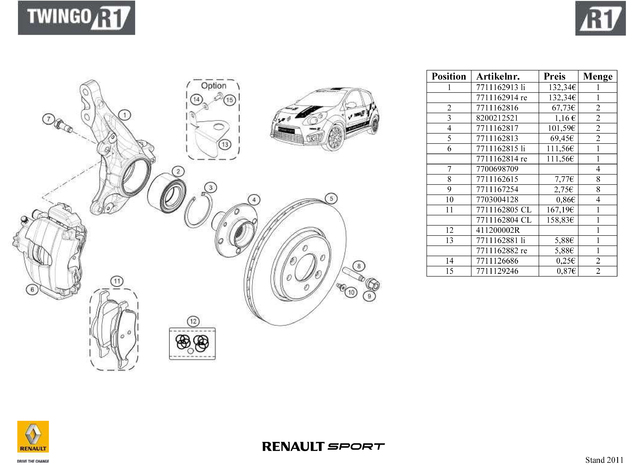

  172/1.2/E30
If the Twingo R2 hub is the same as the 1*2 hub, this should be a straight fit. Might be quite expensive with Renault Motorsport parts. What's wrong with the 225 calipers, adapters (like the ones from NOOS) and standard discs? The Clio is a pretty light car that doesn't need a massively big braking system imo.

R2 calipers 7711162814 & 7711162815 & R2 hubs 7711162913 & 7711162914

Had a very interesting discussion with some folkes racing Twingo R1/R2 today. The center of the discs and bolt spacing is confirmed to be the same. Same thing with boltspacing caliper to hub 142mm just as the clio. It looks more and more as this kit may be plug and play on a Clio 172/182.
Still have a few things to check though such as the part number of a standard Twingo Sport hub and the offset between caliper mounting surface and the disc mounting surface. If that measurement is the same im 100% certain it will be plug and play.

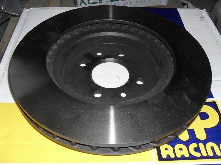

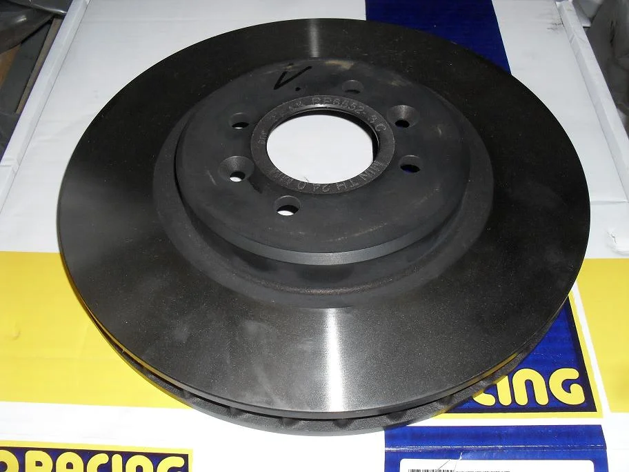

Here comes a picture of the 300x27 R2 Evo Tarmac discs. Discs are produced by AP and have curved vanes (side specific)
  182 trackday racer
Offset between disc mounting surface and caliper mounting surface is 60mm = same as on Twingo R2.
Distance between center of driveshaft to the center of each caliper mounting bolt is 100mm = same as on Twingo R2.
Spacing between caliper mounting bolts are 142mm = same as on Twingo R2.
Brake disc is confimed to be plug and play on Clio hub so I can now confirm this kit is plug and play on a Clio 172/182.

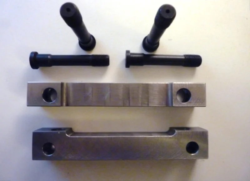

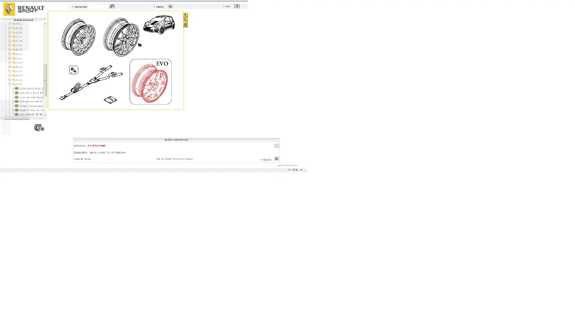

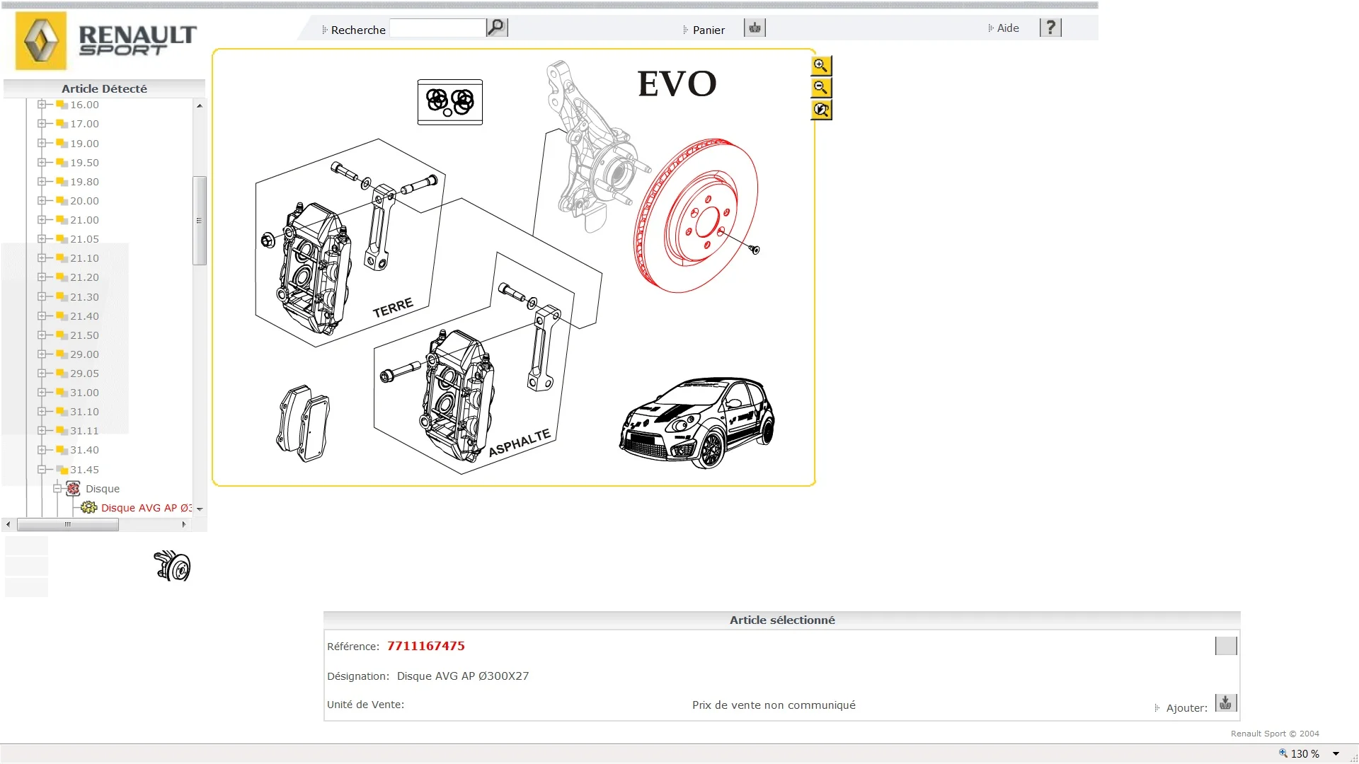

Brake parts Twingo R2
Part
EN description
ItemNr
pcs
Price a piece ex VAT
Disque AVG AP Ø300X27
Disc
7711167475
1
153,48
Disque AVD AP Ø300x27
Disc
7711167476
1
153,48
Etrier AVG
Caliper
7711167539
1
208,46
Etrier AVD
Caliper
7711167540
1
208,46
Support étrier AV Asphalte
Caliper bracket
7711167480
2
120,82
Vis CHC M14x150-80
Caliper bolt
7711167479
4
3,96
Vis CHC M12x125-45
Bracket bolt
7711160599
4
5,10
Rondelle contact Ø12x24 ép:1.8
Washer
7711156931
4
0,20
Thought I posted the full specification of items required earlier in the thread. Obviously I did not... Well here it is, all the parts you need except for brakelines and pads.

He explains in what way the clio 197 calipers must be modified to take standard Clio 172/182 280x24 discs. These discs are used on Twingo and on Twingo R2 Gravel setup. If you take a look at the exploded view of the R2 Evo setups you can see both a gravel setup and a tarmac setup, and both use the same caliper!!! This leads me to think the R2 Evo calipers will have some minor modification equal to the one described in the link above. May be far fetched but seem logic since the RIKUS setup is a straight copy of the R2 Evo setup.
EDIT: But that would be a minor problem since it would probably meen a milimeter or two would need to be skimmed of the bracked instead to use 197/200 calipers.
