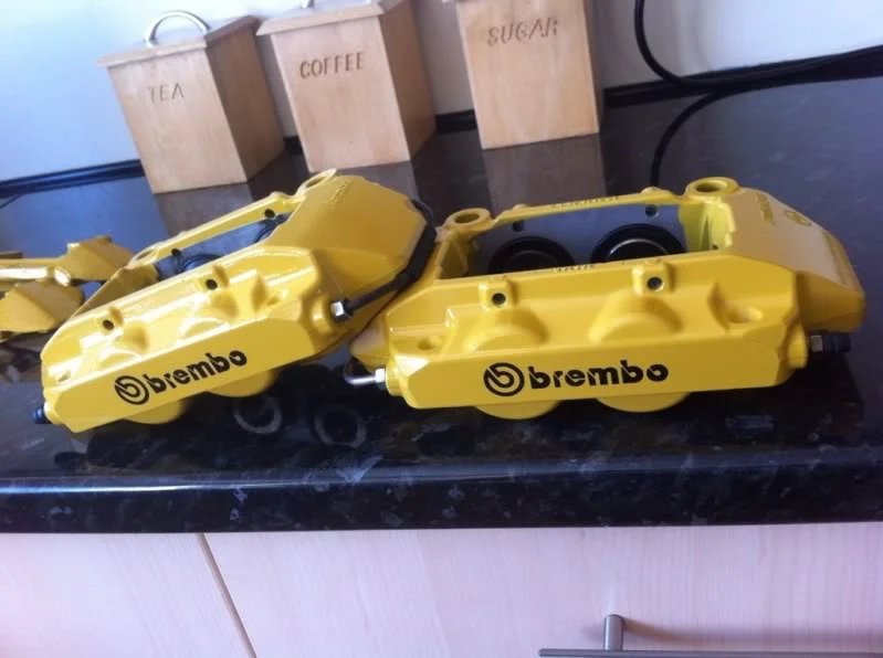

Even with 16" wheels the calipers are very close with the 300mm discs.
Im using the genuine Renault caliper bolts & some 12.9 Allen bolts to mount the brackets.
Where did you get your calipers refurbed? They look the dogs danglys.. How do people find the brake pedal is after fitting these? I heard a rumour about changing the master cylinder because the pedal would be too long to run a 1*2 master cylinder...

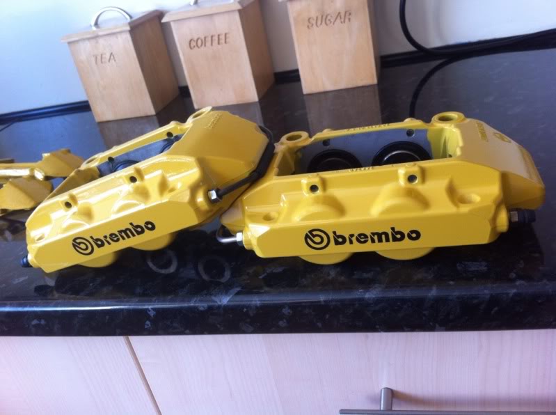

hi i have just bought some bermbo r26 brake calipers, just wondering where i can get the brackets for them to fit and what disks to use and what i will need to fit mJy clio 182 cheers david
It is all detailed in my above post, french guy over on clio rs concept sells the mounts & disks in various different sizes. Depends what size wheels you want to run as to which size of disk you can get away with.
You will need clio 197 front brake flexi's- Custom caliper mounts- disks depending on what size you want.

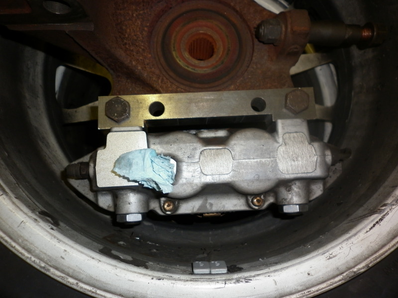

This is basically the kit I have, the caliper mounting face that touches the caliper carrier needs machining by a few mm to fit under most 15" wheels, as to how much im unsure yet but will know in the next week.
Brackets kit for set up keeping standard disk (280mm kit) (calliper will need to be modified) = 220 Pound
Option: brand new set of modified caliper (grey) = 470 Pound
Minimum offset is ET40
It will fit in some 15 inch Rims (400mm clearance on the inner wheel needed)
It comes with caliper mounting screws, I will provide Renault part number for bracket mounting screw ontu the hub

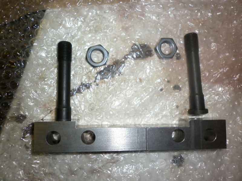

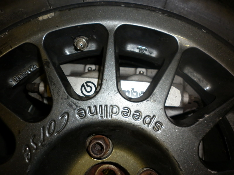

Had a little time to put my brake kit together with some spare wheels and hubs I had lying around. No disks were fitted so need to get them tested on the car.
Wheels- speedline 2118's in et 48.5 (cup racer fitment)
Caliper mounts- 280mm version ( mounts look ok, a little thin in places where the studs pass through for caliper, but I have been assured there safe after years of use on other cars)
Calipers- megane 225 calipers.
For people looking to fit 197/225 calipers under 2118's it is possible but you will need et38 wheels or spacers to suit your wheels and the caliper's will need machined by around 5mm on mounting face, its a really tight squeeze for these calepr's but look brilliant squeezed under 2118's.

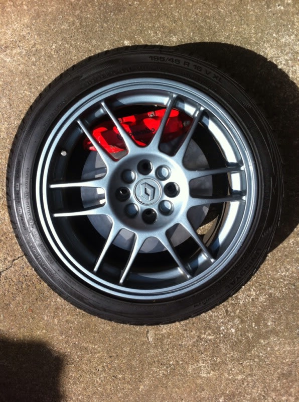

I've ordered the ap 300mm discs from the twingo r2 also managed to reserve some brackets from seiz, hopefully get them at the end of the month, if not I might just bite the bullet and get the r2 brackets too,
As soon as it all arrived ill get some pics up
