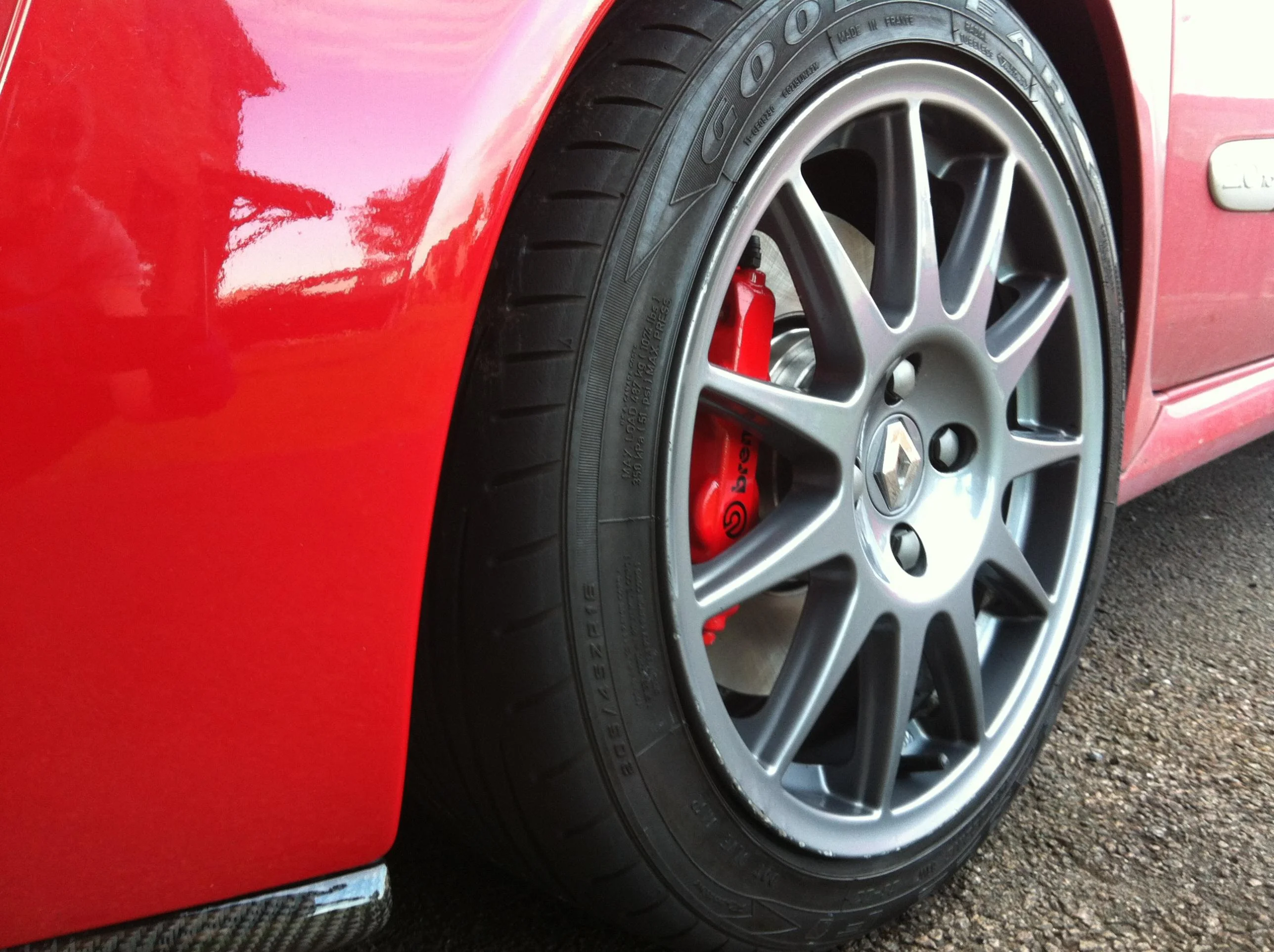

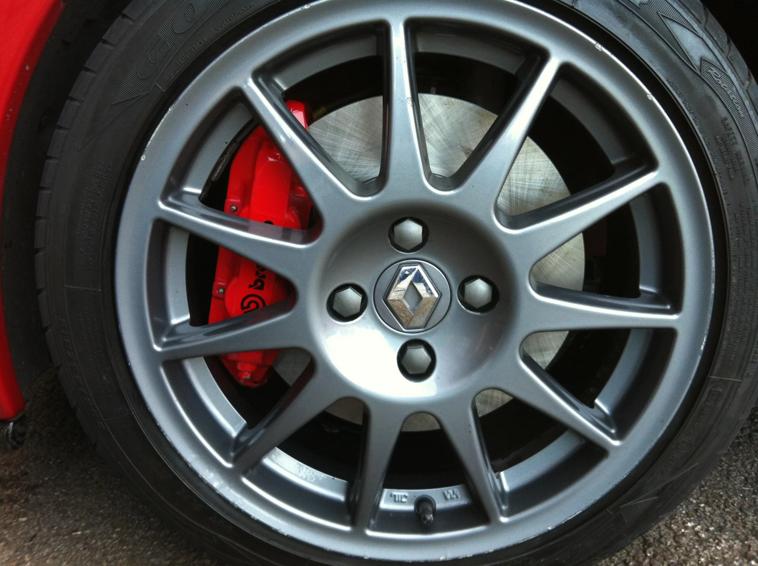

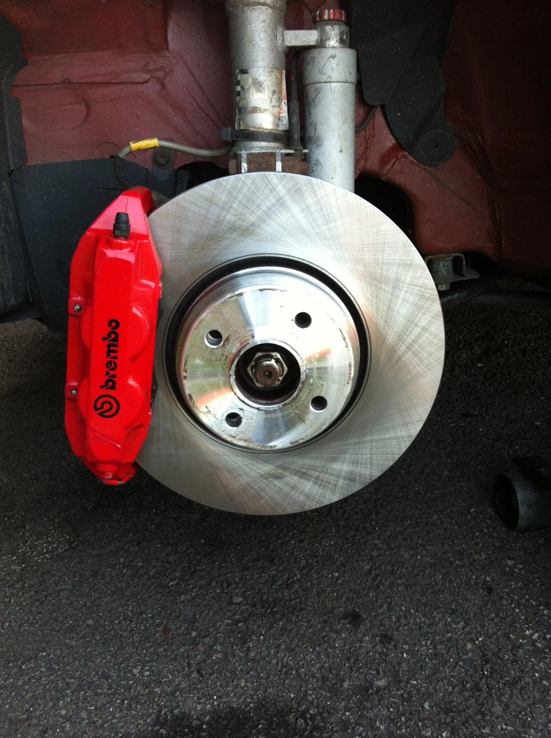

i have done this but everything is just mock up just now using my own bracket i made, 300x24 senic discs just to get size right, IMG_1461.jpgIMG_1447.jpgIMG_1458.jpgbrembo 197 callipers but i would like to use the correct discs and brackets from r sport so just really needing some feedback 1st
