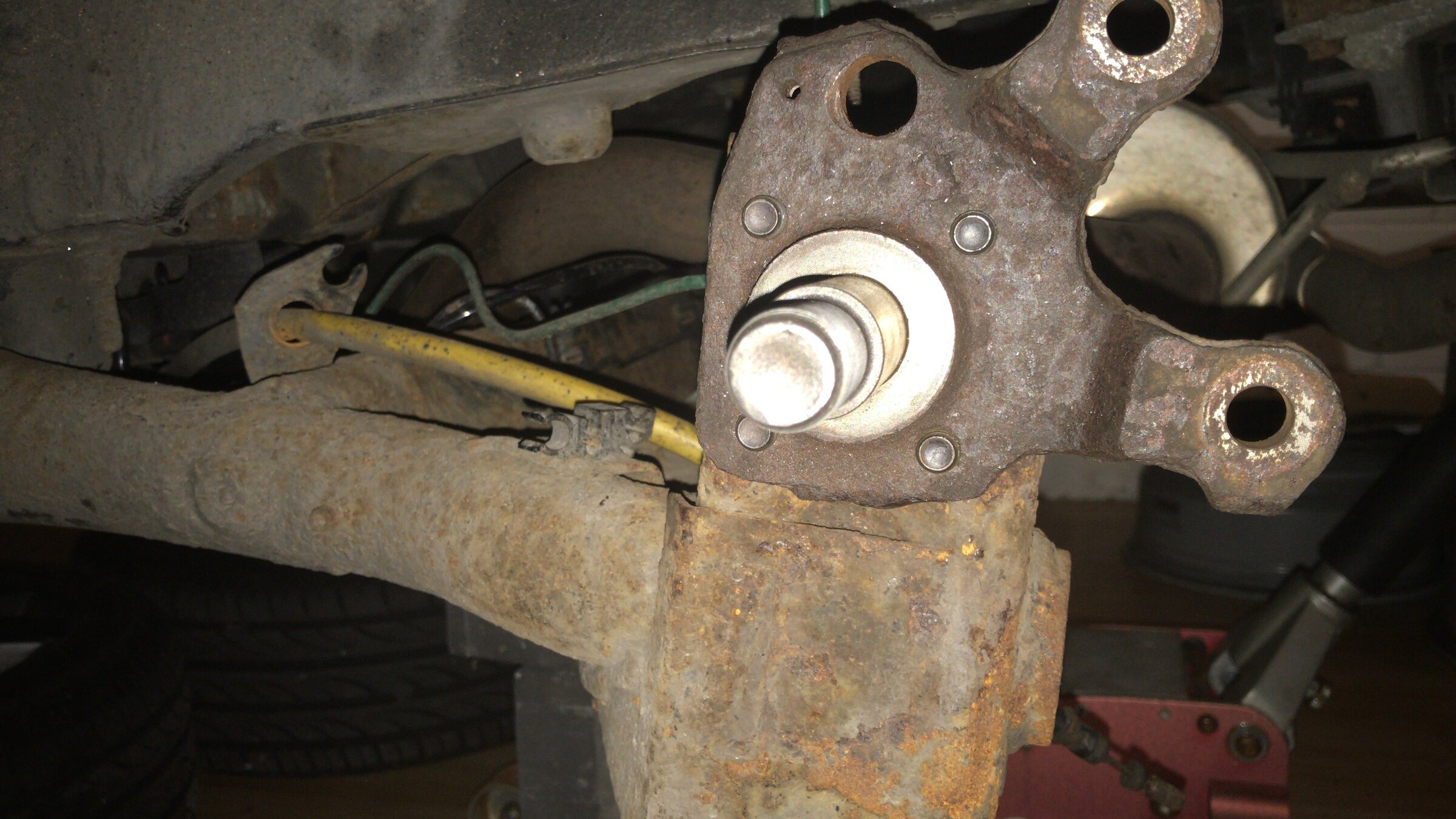

'supposedly you can fit' various model rear stubs and have bigger discs and bearings. After lots of searching I cant see how any stub from any scenic or laguna is a straight fit. I just bought a cheap laguna stub and disc but the square bolt spacing is bigger. All the mk1 versions are not square bolt spacing, all offset. So what specific model was it on a scenic or a mk1 laguna?
+1.Scenic 1.616v!Rear caliper piston 34mm plus the bigger brake pad and the disc ~270mm!!
This a mk1 laguna stub with seperate hub and disc, which is offset. I cant find any info on cup racers running them

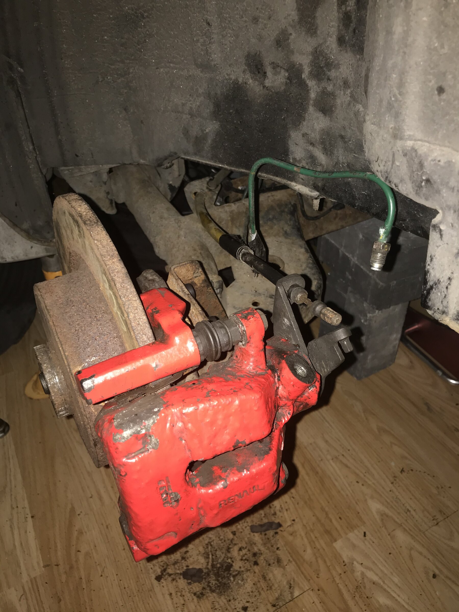

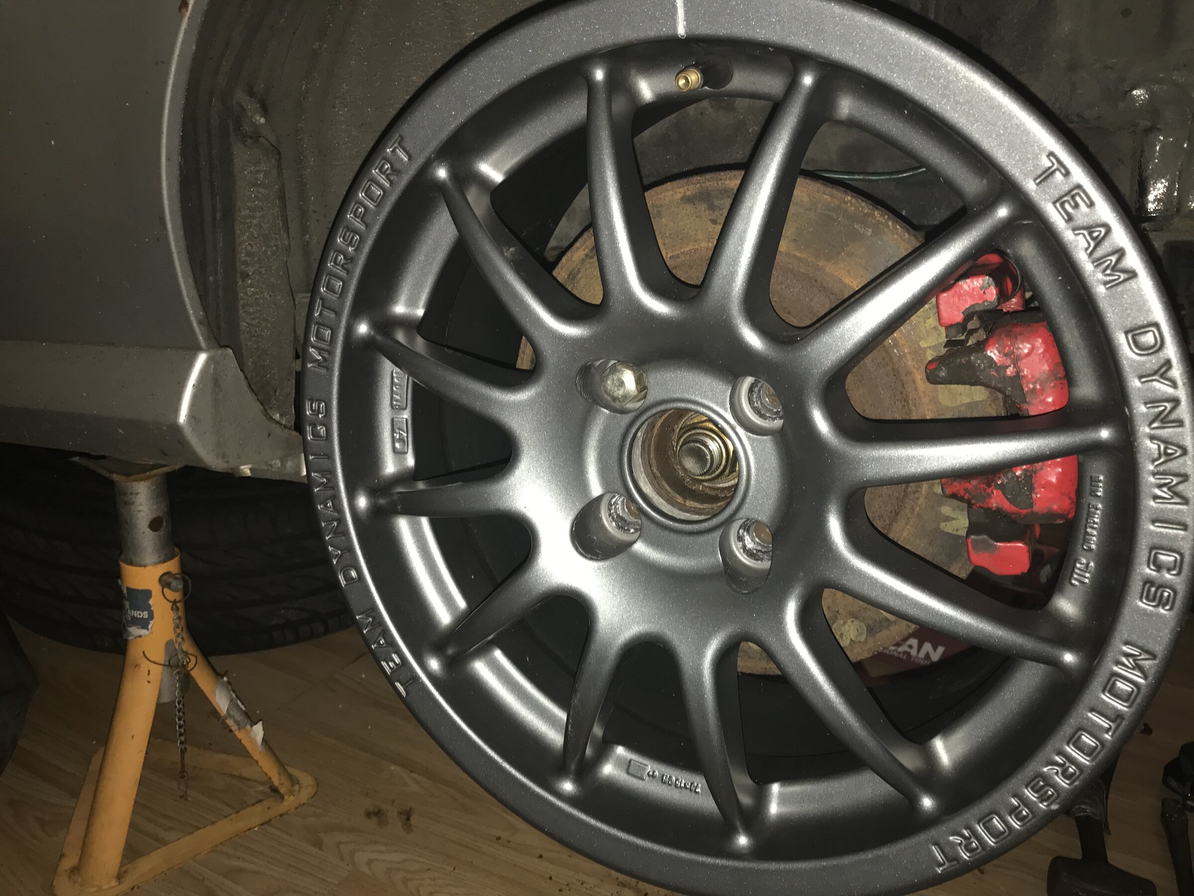

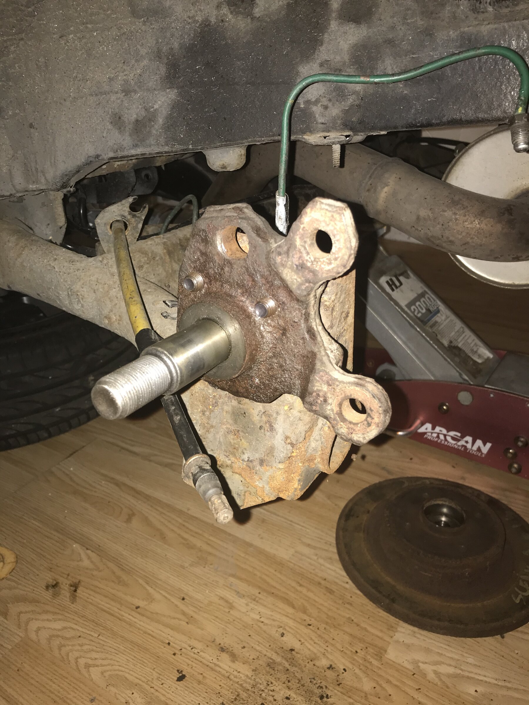

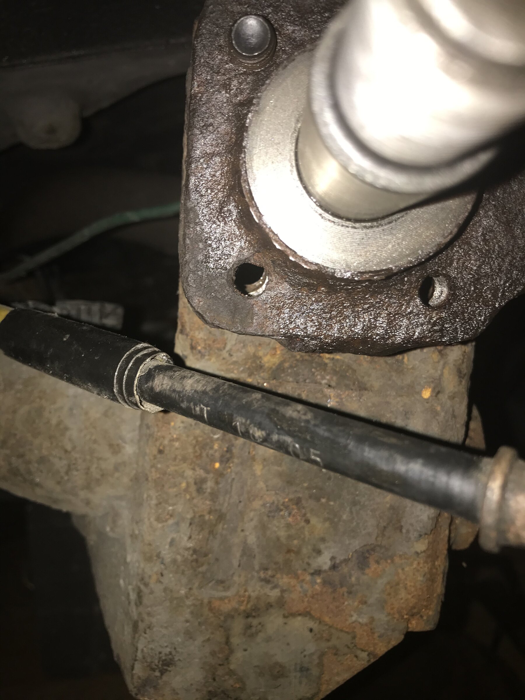

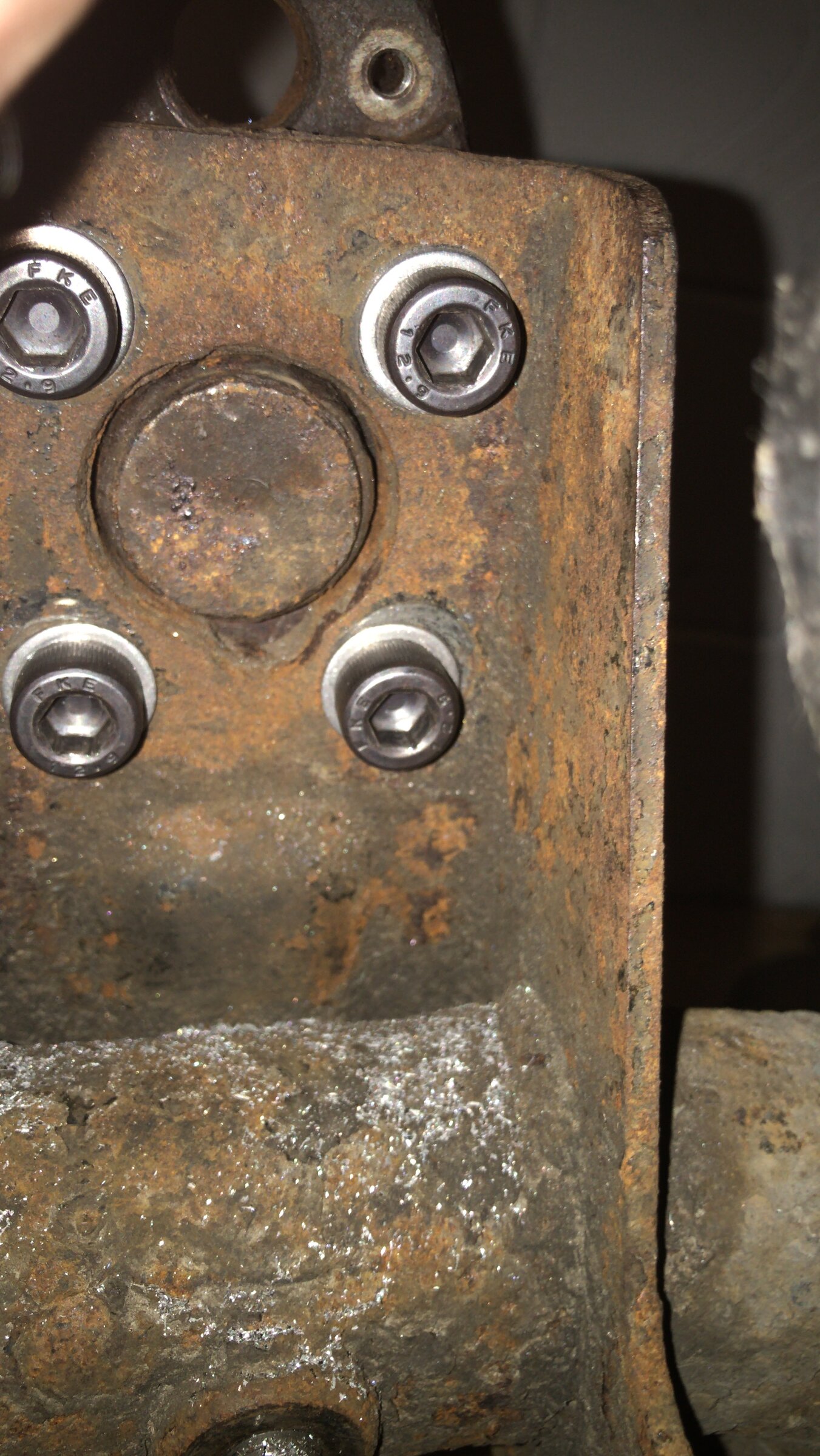

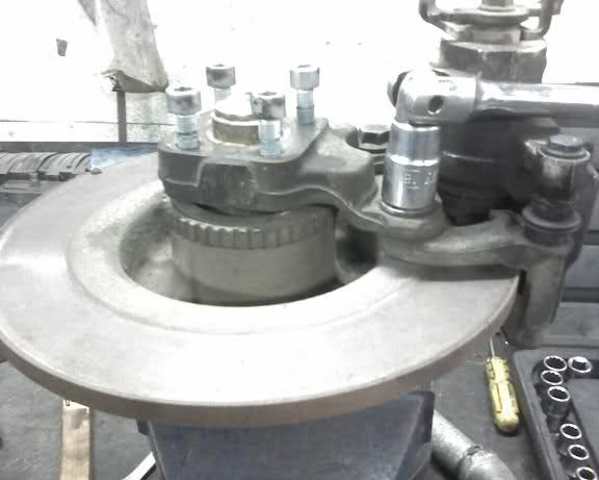

Used a die grinder for the scenic bolt spacing and also abs sensor hole in hub as was slightly too small, needs new brake lines both sides and o/s handbrake had to be moved under fuel tank, n/s needs longer one altogether, I have a new o/s so can try that. Is wider than standard so maybe 10+mm. Bolts straight up using m10 fine threaded which is a big reason I decided to go through with this, no more counter sunk bolts..
Having trouble with abs though, not reading anything, there is adjustment to how far the sensor to ring can be had so maybe they are too far away.
