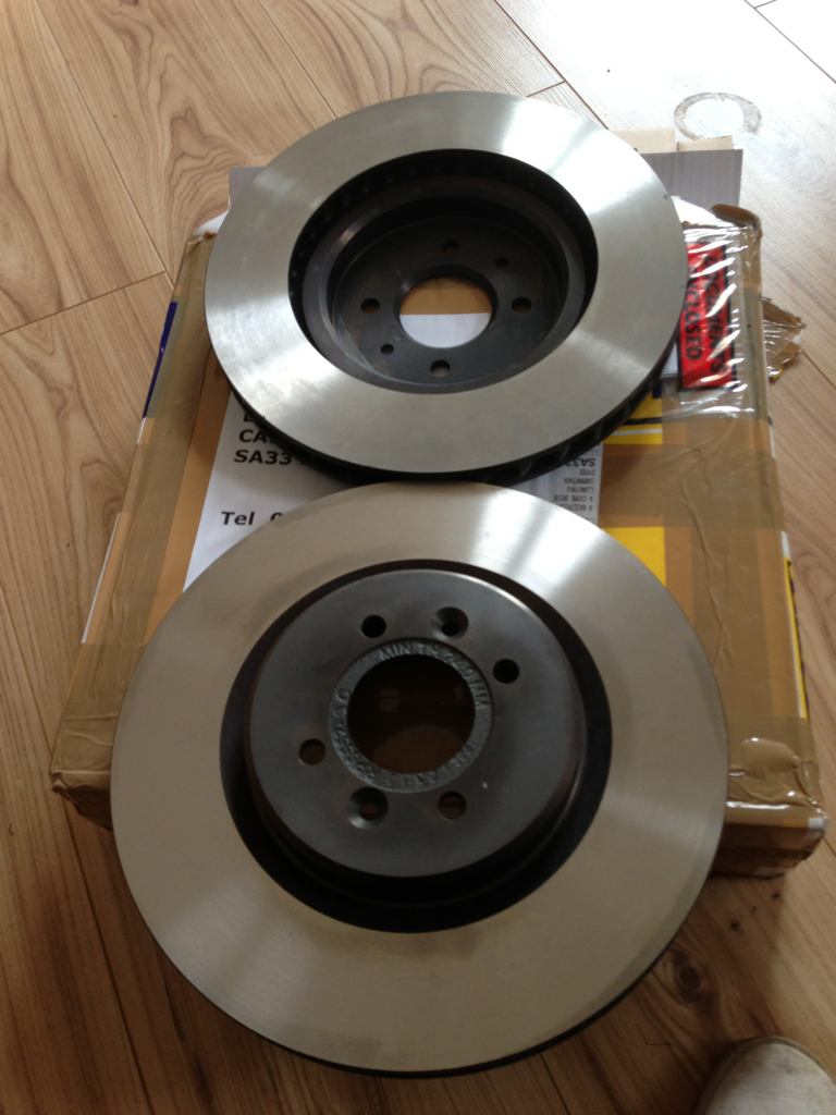

Twingo r2 ap 300mm discs just arrived, just waiting on the brackets now
  Clio172cup rally car
Ye these are just a solid discs with directional veins from renault for the r2, I could of gone down the floating disc route but they were a lot more expensive, may look into it in the future tho...

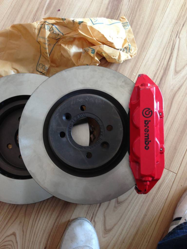

Just thought I would offer up the caliper to disc, can't wait to get this fitted an see what the difference is like

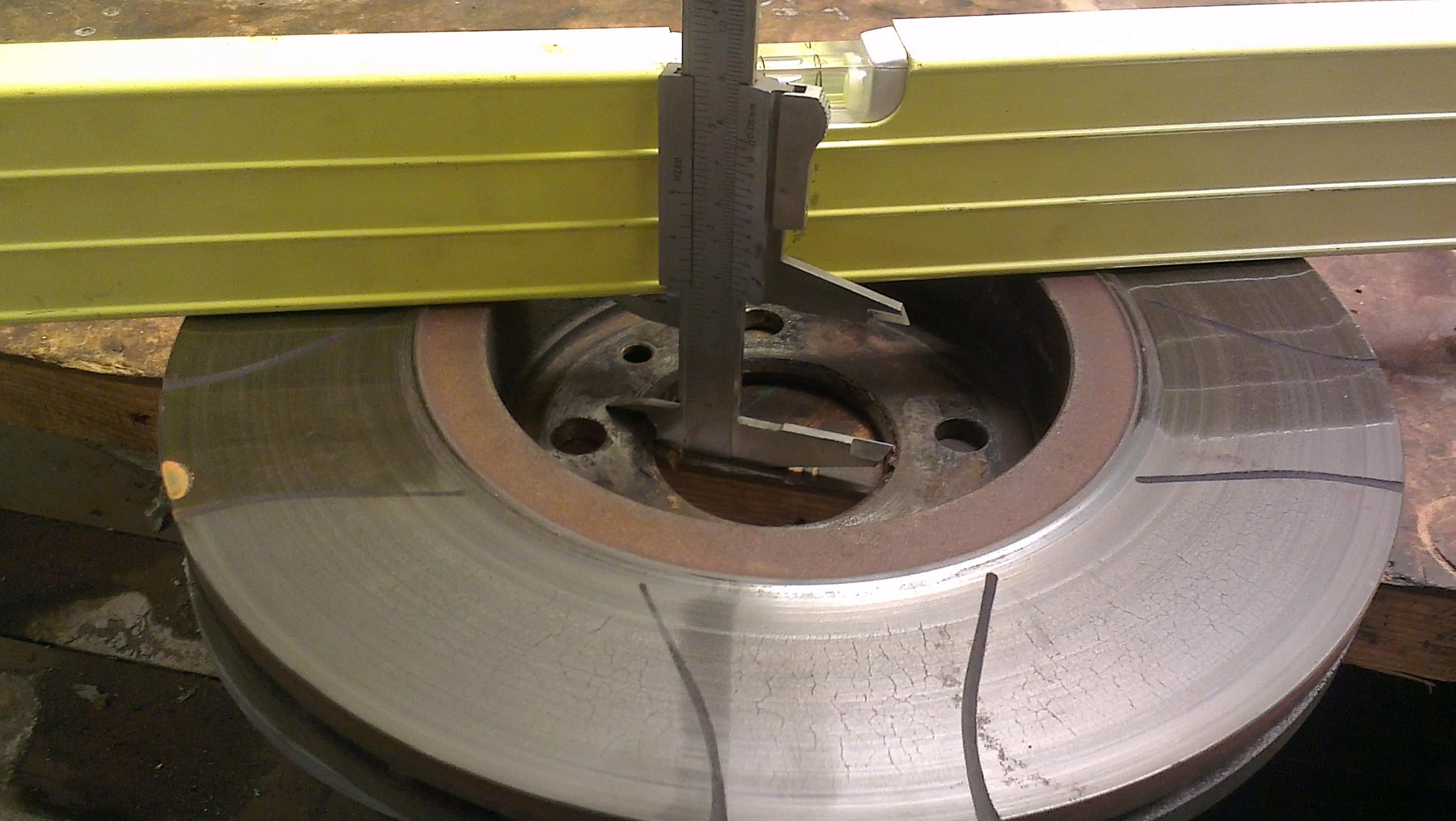

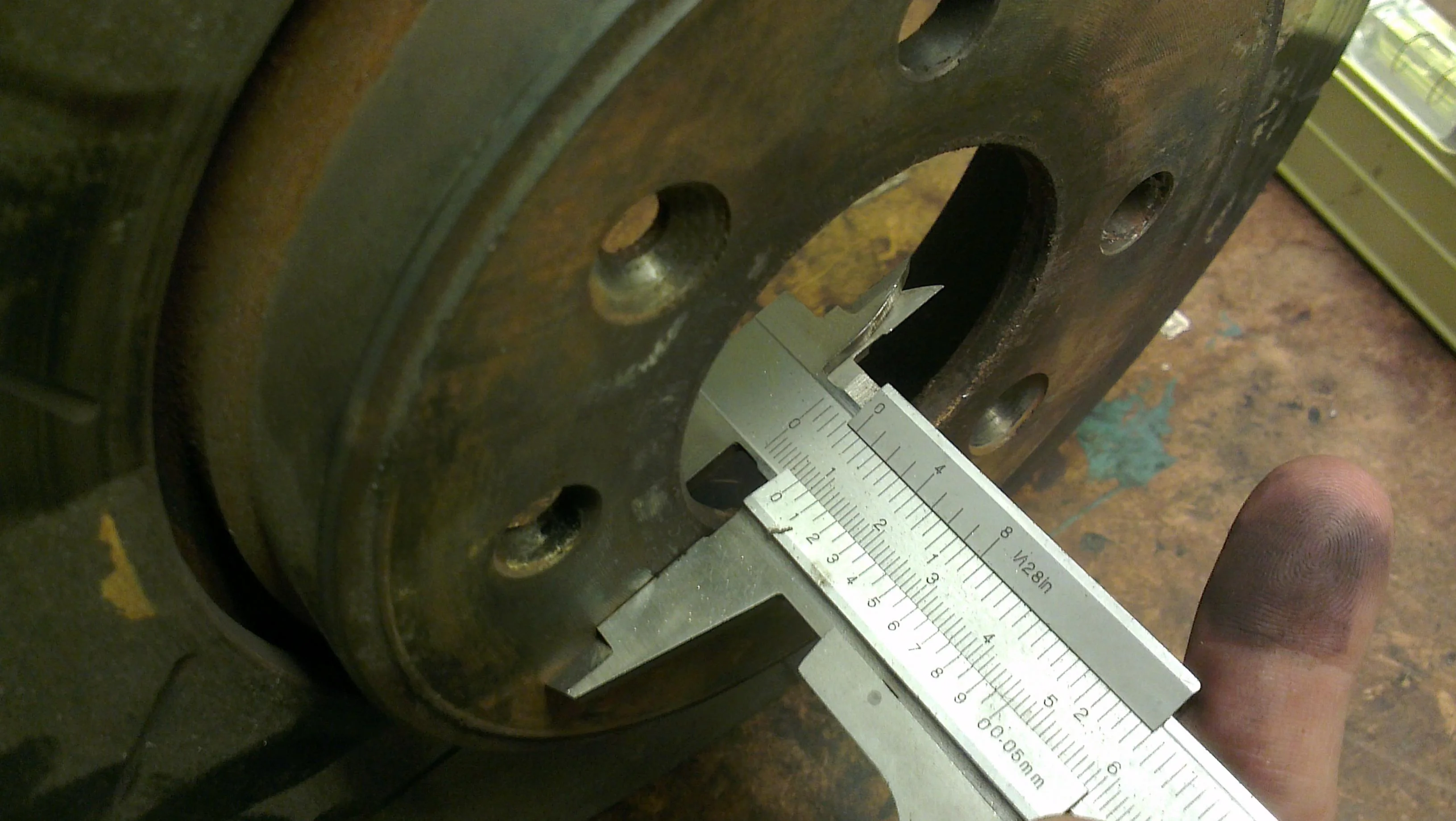

Andrew: If you could take a few measurements on those discs Id be very greatfull.
One key measurement is from the mating surface disc to hub, to inside of the padsurface on the disc (read offset of the disc)
Thickness beween: mating surface disc to hub and matingsurface of the rim.

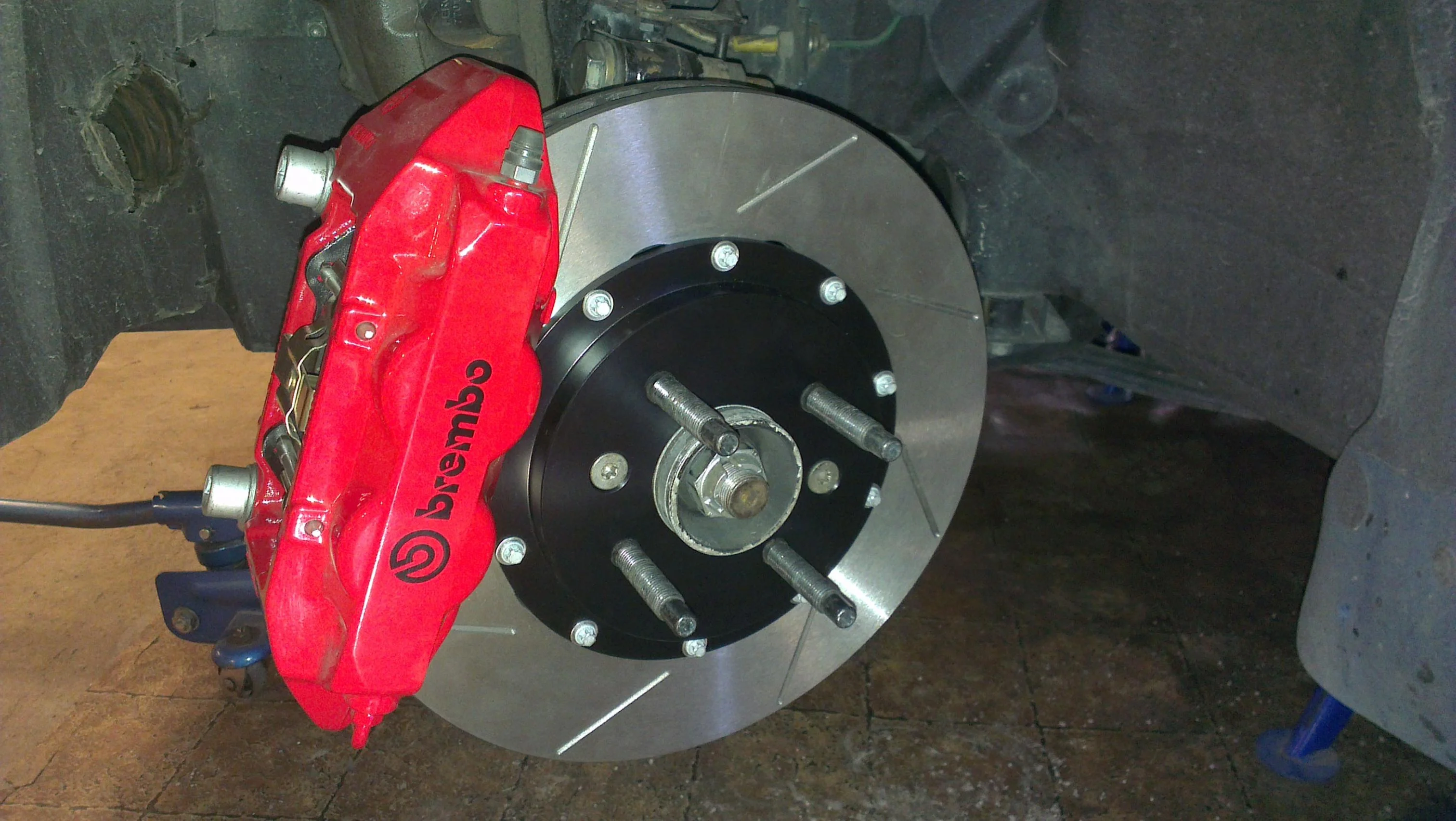

Also I'm now sending the discs and calipers to pure motorsport and they are going to make me brackets and look into maybe selling them as part of a kit :)

Sorry I just haven't had chance to measure them. I'll do it tomorrow when I go down the garage :)

The swept area is 53mm on the ap discs, sorry I have the measurement for you just forgot to pm you, I'll send them over now :)

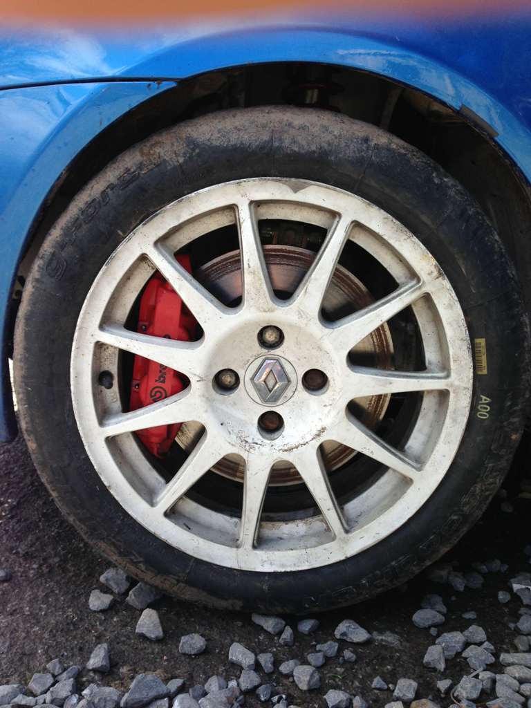

not the best picture and car needs a good clean but finally got the brembos fitted to the car with ds1.11 pads!! All i can say is awesome!

the kit is from pure motorsport, they sell the complete lot with brackets, new calipers and ap 300mm discs also includes new brake lines too
I'm the first person to use it, and were going to do some testing down prembrey in April, maybe he's waiting for us to complete the testing before advertising it to the general public?.
I'm sure if you give them a call they will give you more information on it.
As for the feel of it...it feels brilliant, can't say to much as yet because of the pads where using take a lot to get up to temp, but it looks and feels very promising.
