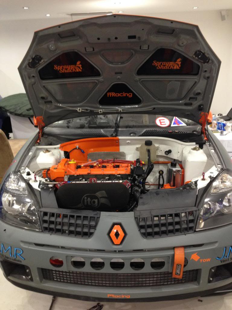

Clio Update:
So since the dog box exploded at Brands it has been apart and upto Gripper who are now making another Pinion shaft and then going to rebuild the box hopefully for the last time, This is a time consuming job though so in the meantime they have sorted me out with a box to keep me going (Very good of them :))
The original plan was to take the car down to Pure Motorsport with no engine in next week for the Adjustable top mounts fitting and was probably going to go with the adjustable wishbone kit too but that’s not happening any more so I’ve booked Brand Hatch GP in a few weeks and got the car back together tonight!
Went back together nicely other than being a few litres short of coolant on the shelf so will sort that tomorrow. Car started up on the press of the button :)
I’ve left the engine as it was and thats now coupled with a Speedo drive box with Gripper diff, std JC5 130 CW+P and shorter 5th gear. It seemed pointless to pull my good engine apart just for the sake of the Supertech pistons in it so for what i’d of spent in multiple gaskets, head bolts, cam belts etc it makes more sense to build a new bottom end up Supertech pistons, Megane rods and the ALD head with uprated springs and Supertech valves. I’m resisting creeping the spec at the moment although its very tempting to use the Catcams solid top end kit I have or start putting Arrow rods in but I keep reminding myself its just an engine for me to see if I want more power or if it will be enough.
This engine will go into the car with the dog box, light flywheel and billet/organic clutch after Le Mans and then upto RS-Tuning for mapping.
So the car is now ready to go on its next outing and the Lotus arrives on Thursday so that will be getting my attention in the garage until the next time the Clio spits its dummy!

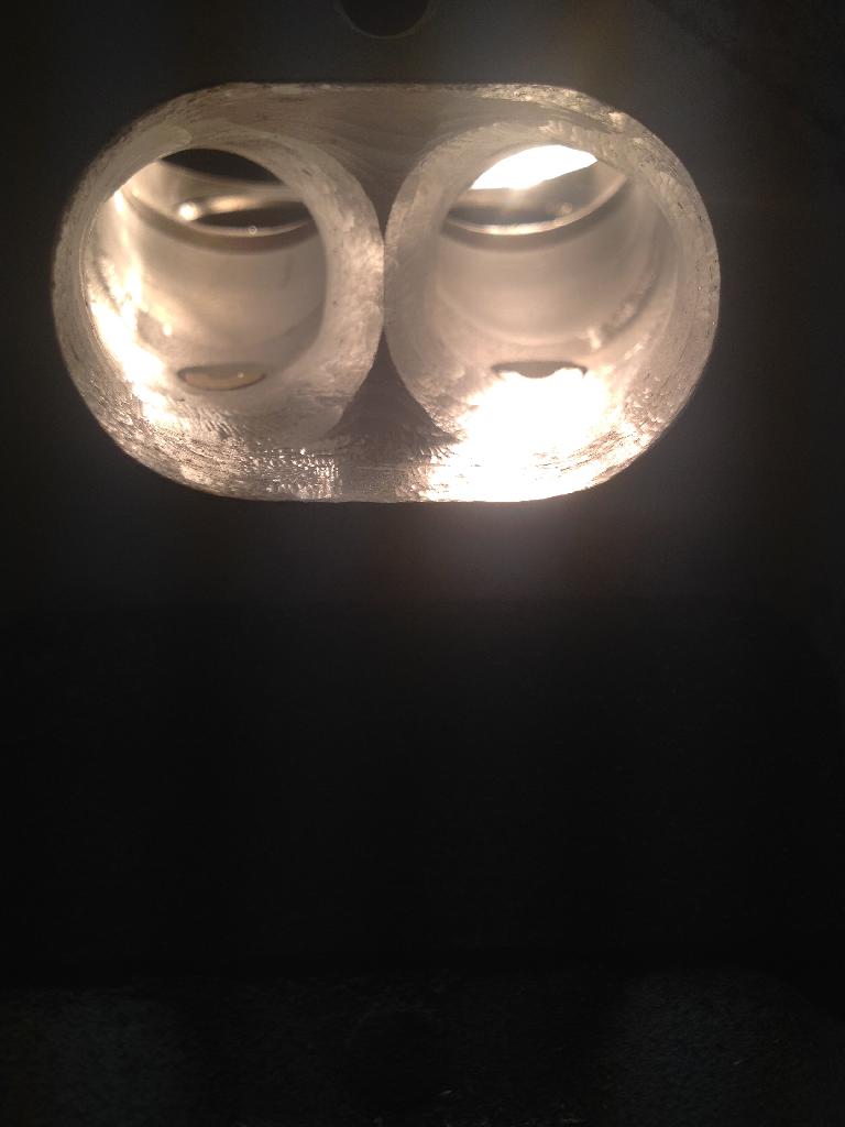

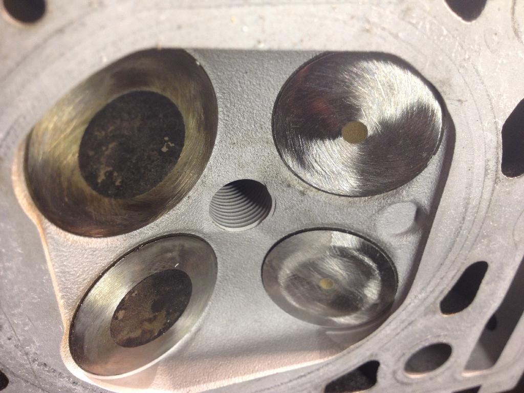

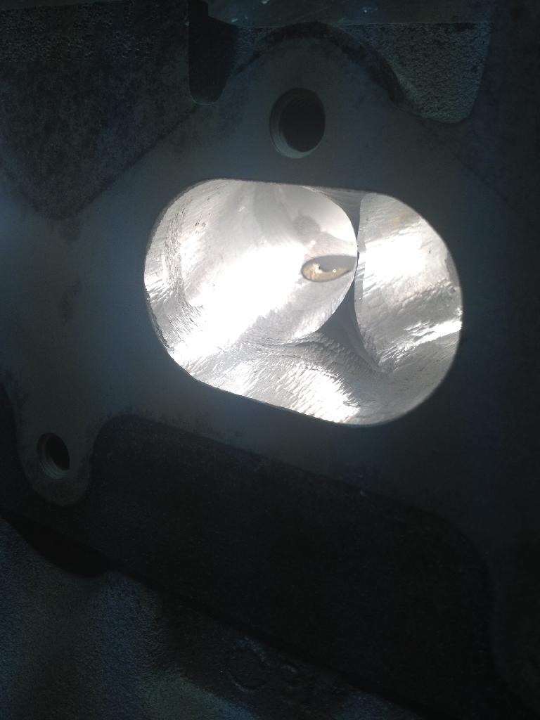

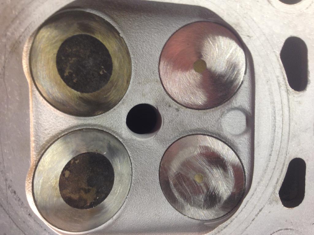

Managed to get some work done on your head, by starting on the inlets
I've taken measurements of the Roper head and and Ric wood head and the inlets and the exhaust ports are the same, Look like the Roper head has had some combustion chamber modifications so i started to modify some standard valves so i can do the chamber mods
