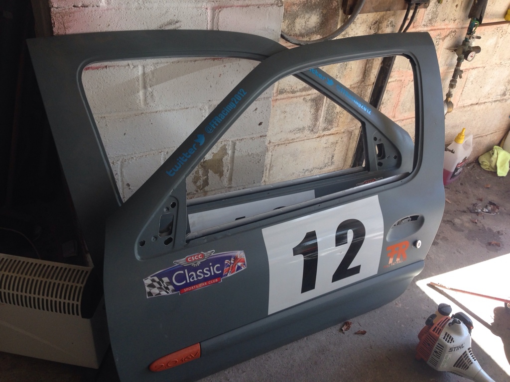

Clearing out my house that's sold and have my spare doors that are going to the scrap man unless someone wants to collect them? They are FOC collection from LS29 postcode :)
Its wrap although from memory one of the strips got grazed and I just re wrapped over it so they aren’t mint under. I’m afraid they all need to go as a whole so doors aswell need to go. Sorry just in a mad rush trying to get sorted out so thought if someone wants to collect them then it saves me a trip to the tip/scrapman
