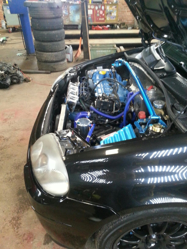

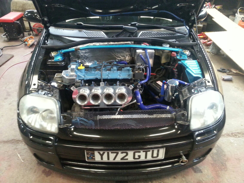

Not the best photos, but you get the idea:
