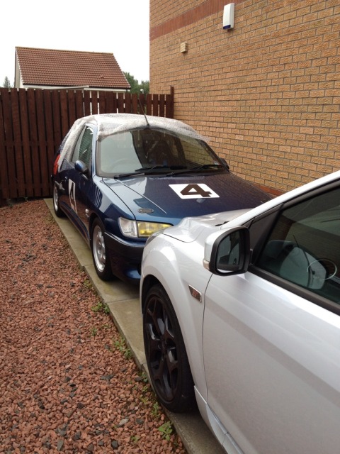

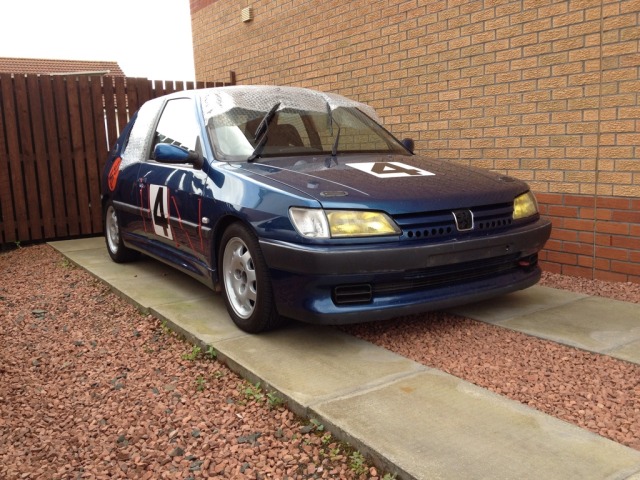

3 'minor' jobs and she'll be ready to go.
Re: My Budget Track Project. (GTI-6 Ph1)
I'm hoping to have everything done by next week, minus the decat.

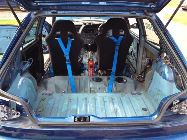

How much does a ph1 weigh originally, cant have been much lighter than a ph2.
Which means you have removed 200 - 300 kg to get it to about 950. Really?
Wheels are going bright lol.

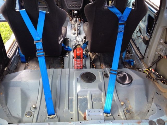

Probably removed about 200-250kg. The OE front seats weighed 68kg EACH!! :O
I never weighed mine, but had seats in and out of a phase 3 and 2, and there is no way they were that heavy. I could lift them straight armed in front of me no probs.
Ph1 seats must be lead-lined

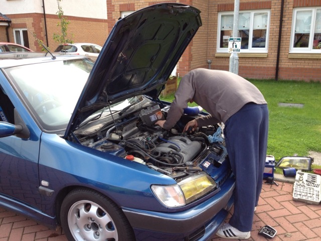

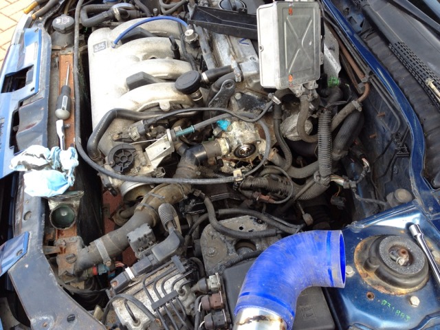

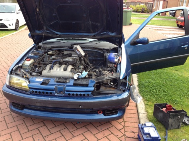

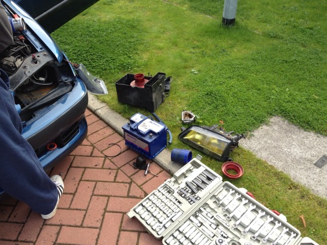

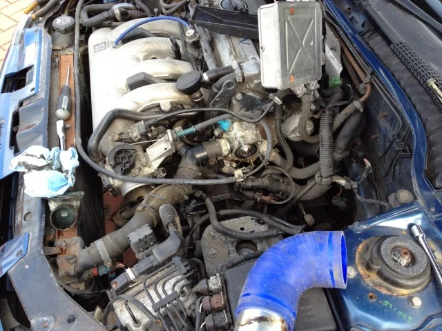

Got a fair bit done today.
Moved the battery and ECU back.
Relocated the induction setup.
Removed the front arch liners.
Fitted the fire extinguisher (different from pics).
Fitted a new thermostat and housing.
Fitted new clutch cable.
Fitted new throttle cable.
Tidied the rear half of the loom.
Swept/cleared the car out.

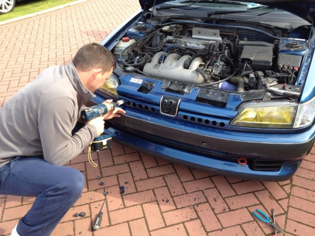

Drilled holes in the grille.
Cable-tied various parts.
All in all, had a good wee day on it.

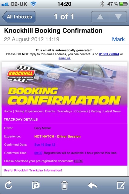

Booked Knockhill midweek.

Fantastic progress! I always wanted to shift that battery and have the induction kit moved to where it was. Also considered doing something similar with the grill...
