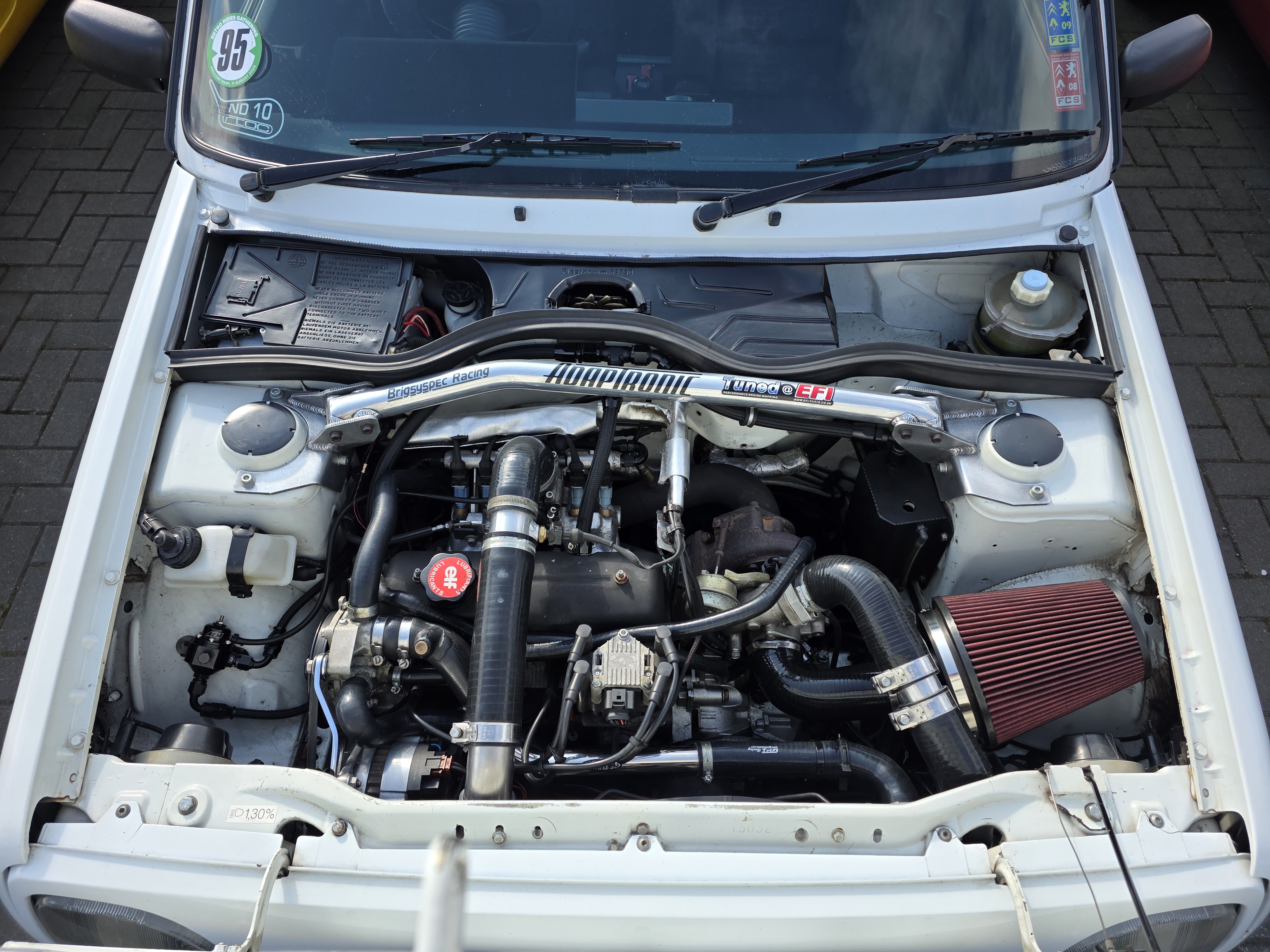

Kicked the Extra out of the garage whilst the kangoo is getting its ecu upgrade. Ive got a new mac valve to fix high boost so made a start on fitting.

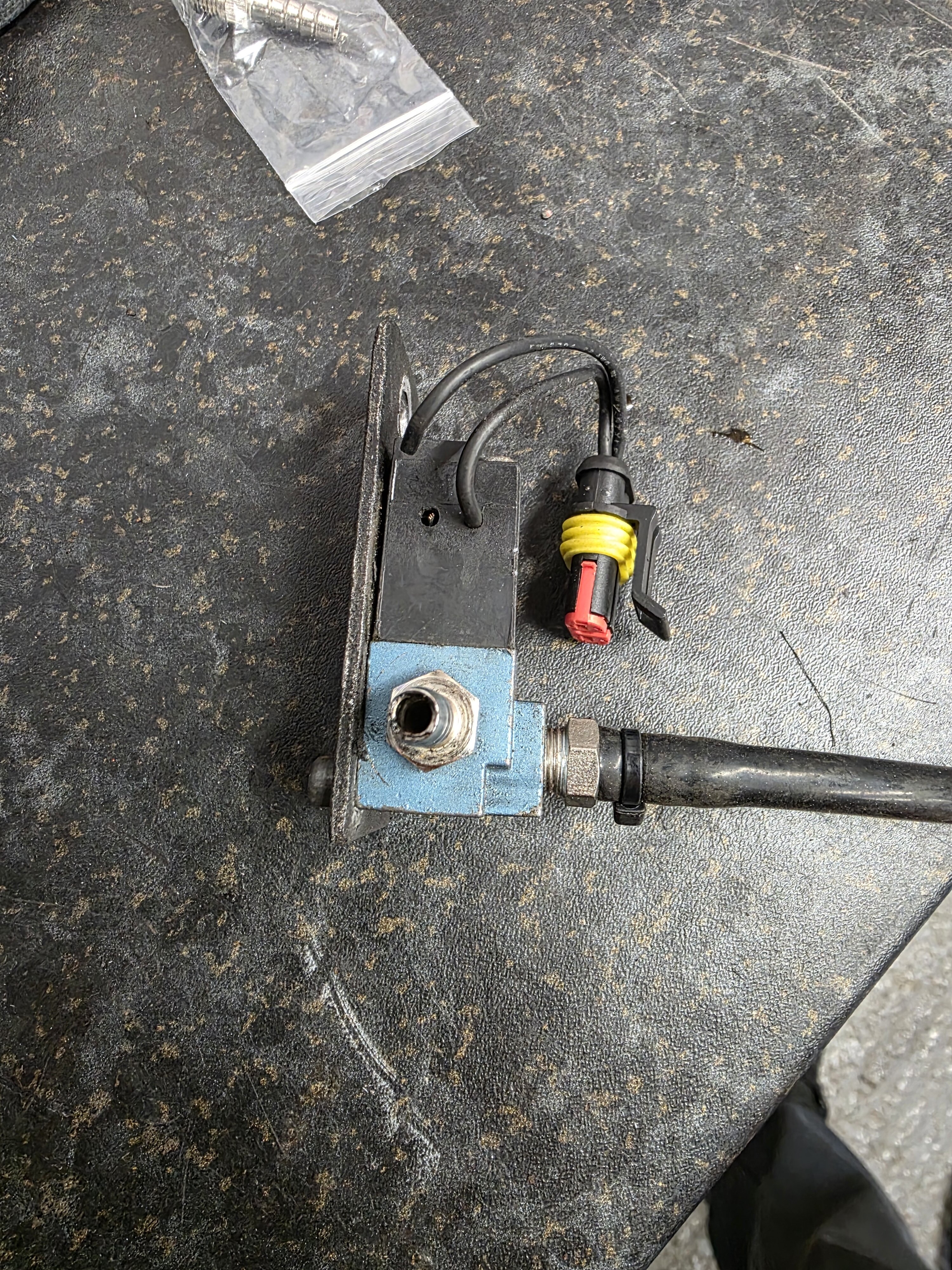

On removal the issue with the old mac valve was pretty obvious.

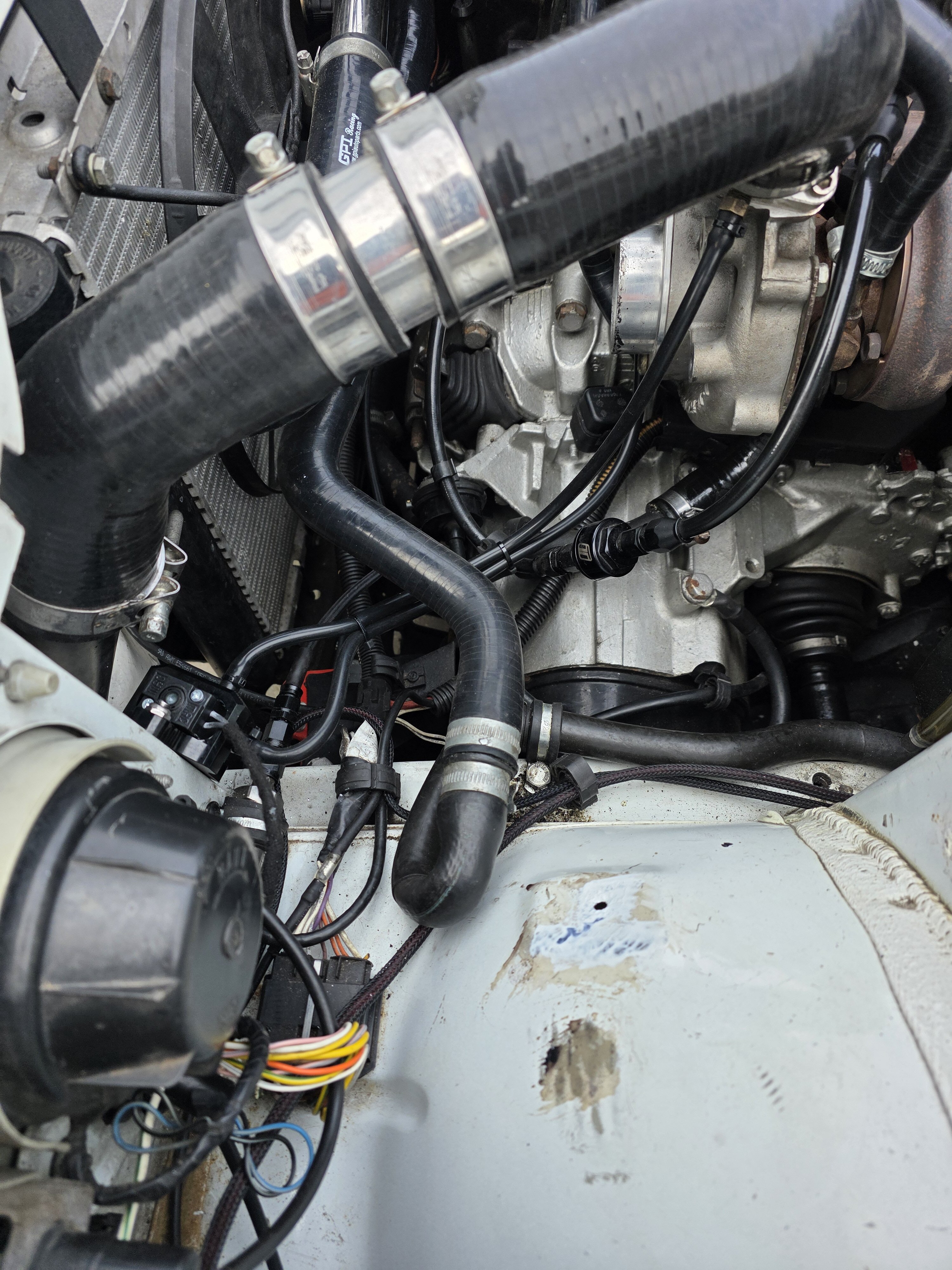

Clean ish break on the wire, unsure if fatigue due to vibration due to the location bolted to the turbo compressor housing. The areas surrounding the turbo are less than ideal for relocating it, so bolted it to the front panel. I dont think this is really optimal and hose length a bit longer than id like, but cant have it all.

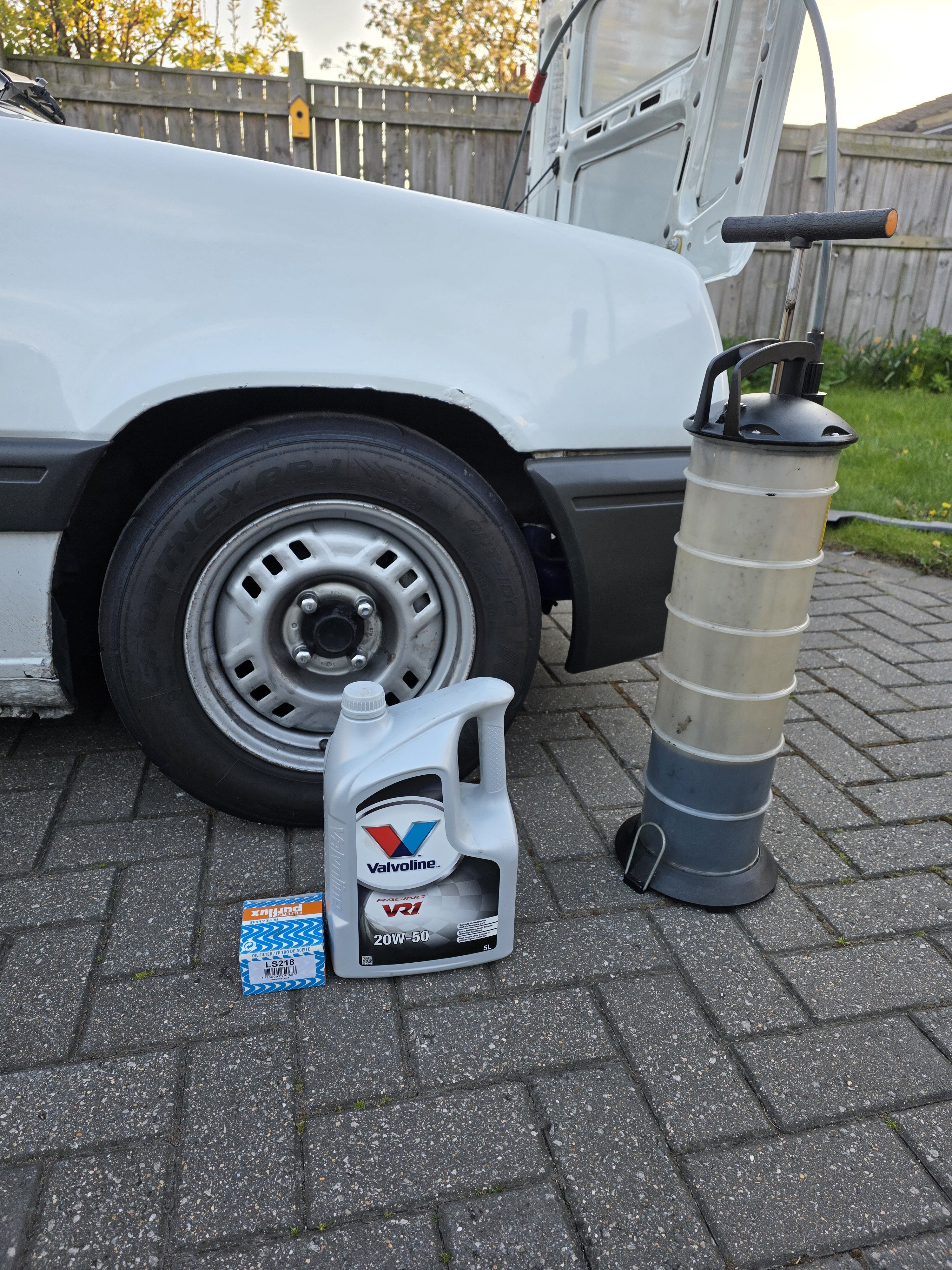

With that boxed off, i give it an oil change as due. Valvoline Vr1 20/50 mineral oil and purflux ls218 oil filter.
Extraction pump as usual as i refuse to remove the sump plug now its leak free.

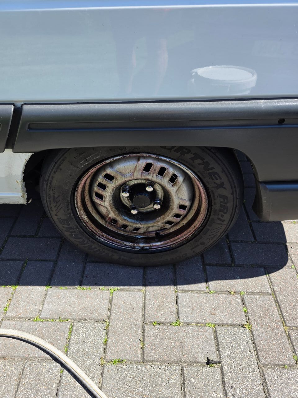

Rotated wheels front to back before the journey as front tread getting quite low, and think i lost a weight on front wheels at Croft over easter as had a little bit of balance wobble at motorway speeds.
Give it a quick clean. Bilt hamber auto wheel doing the business.
Clean

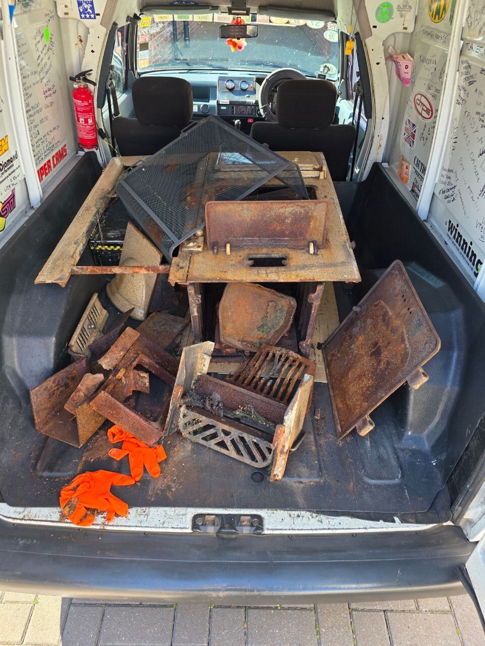

Hot as f**k day on Sunday but does not bother it, and just cruises along 72deg coolant temps. Get to the collection point for the fire and i then realised i totally underestimated how much the fireplace would weigh, so once loaded it was on its f**king arse. Not my first rodeo so laughed and steady drive home, luckily all motorway so smooth ish dodging the potholes.

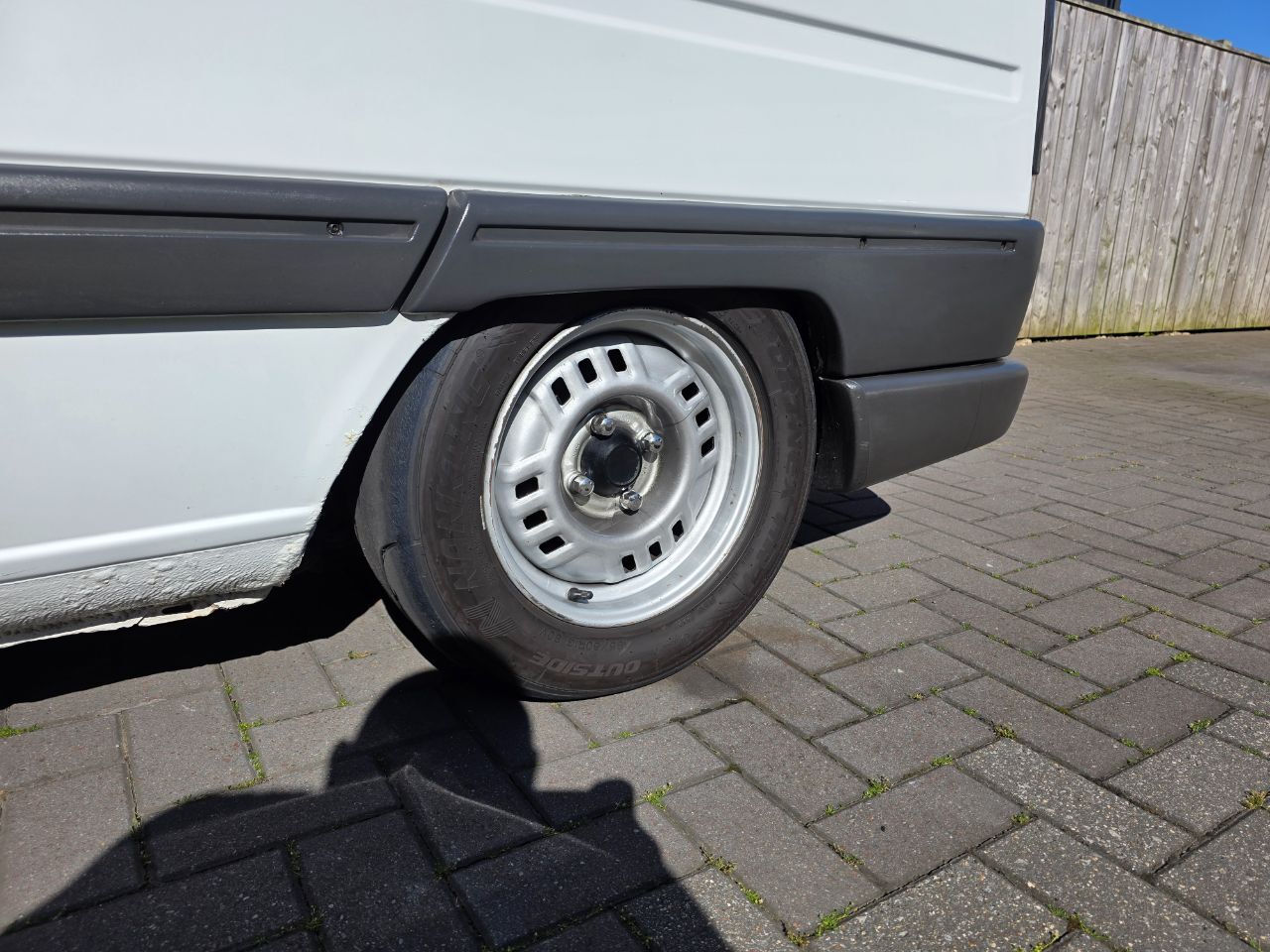

Ball hair gap between tyre and arch, actually looks bigger in pic but about 1mm. Tyres did not catch arches luckily as the profile on the nankang ar1 semi slick is wider than the toyo r888r i used to run. Arches well fettled years ago luckily for situations like this. I dont use this often enough for carrying loads, but ideally need higher et wheels like i used to run years ago for more clearance.

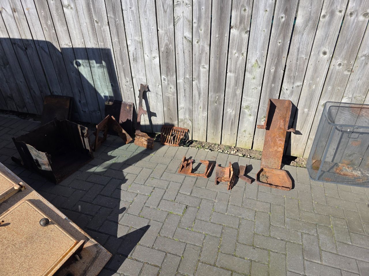

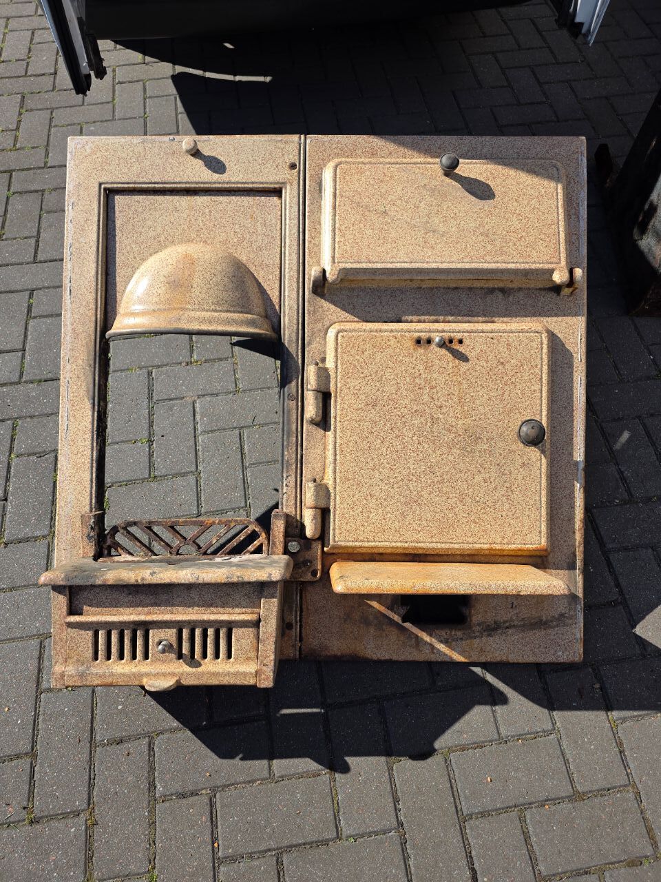

Fireplace looks good anyway. This will be a nice restore project when i do my kitchen in the next year or so. The seller said it was in daily use until 18month ago, it was only removed as they thought the flue /chimney was knackered but turned out the fire bricks were shot.
Sadly stored outside for a bit but should clean up ok, 100+ years old. Everything on it is heavy as f**k, The oven door is 15mm thick cast steel.
Stashed it to one side and ill look at that in the future.
