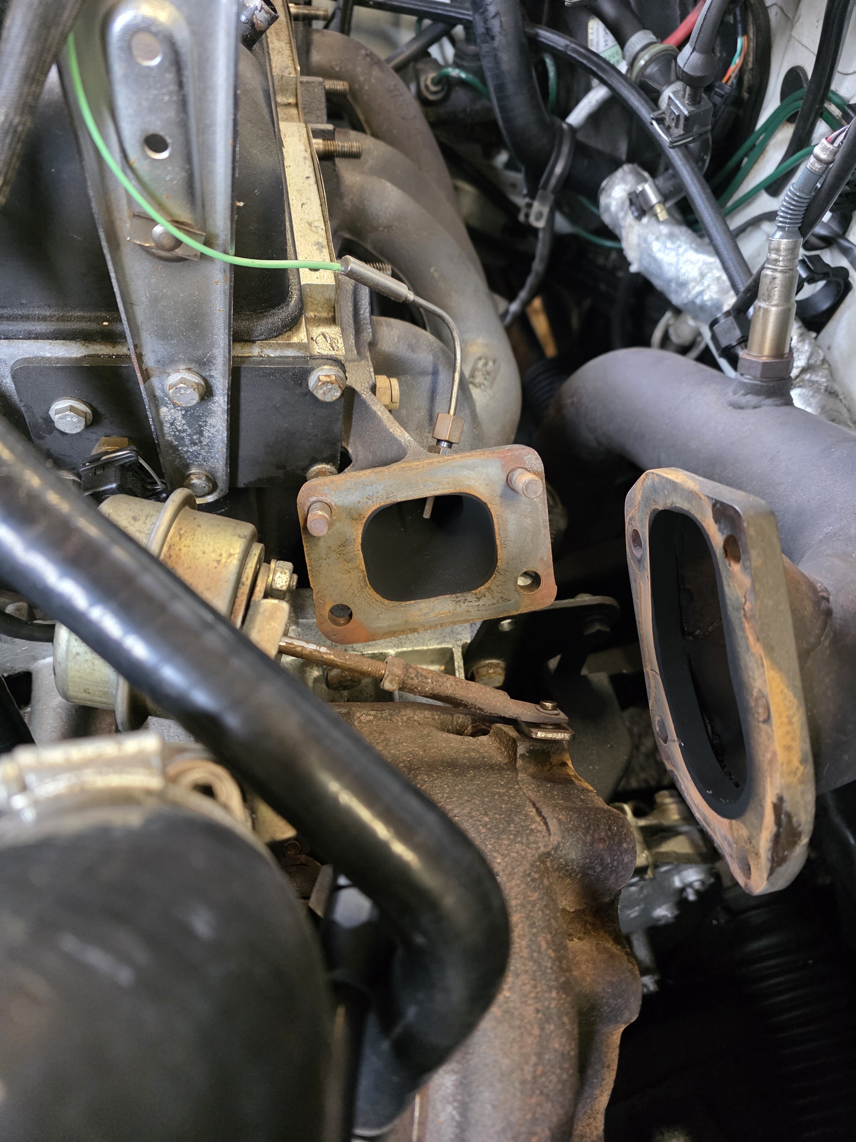

45 mins later, inlet off and turbo moved out of the way.
1hr30 in, fully stripped. Its fiddly to work on but easy in some respects as its all done from the top.

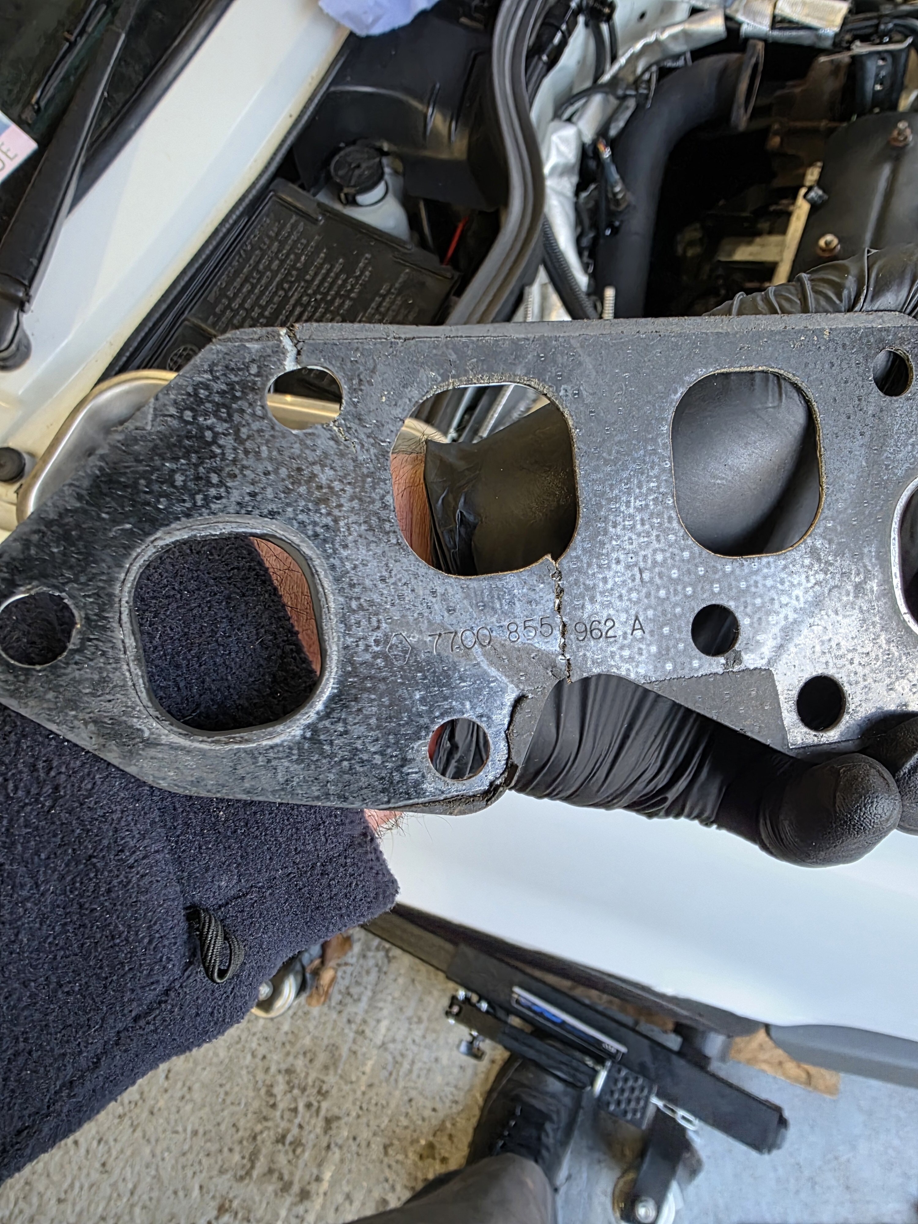

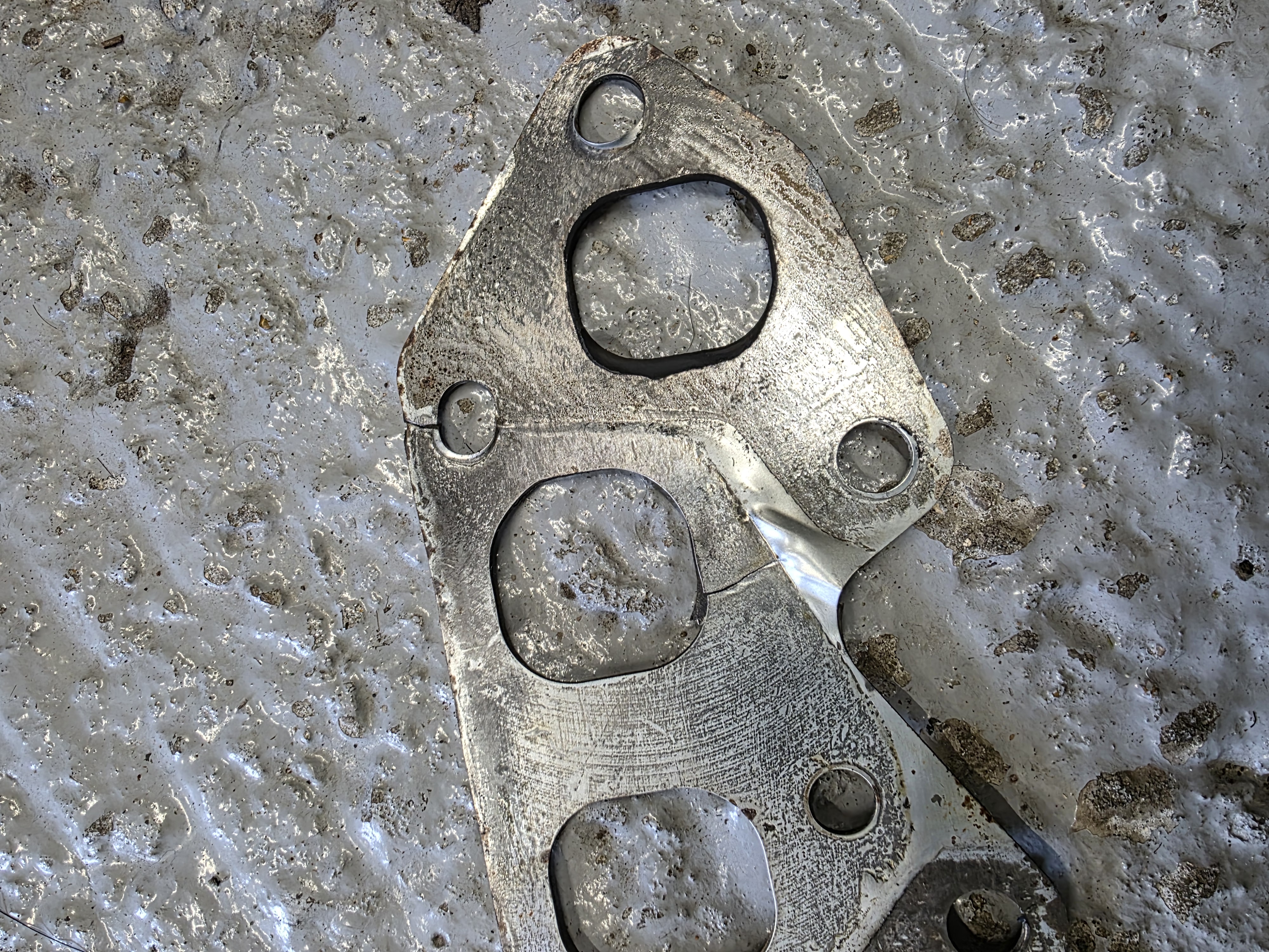

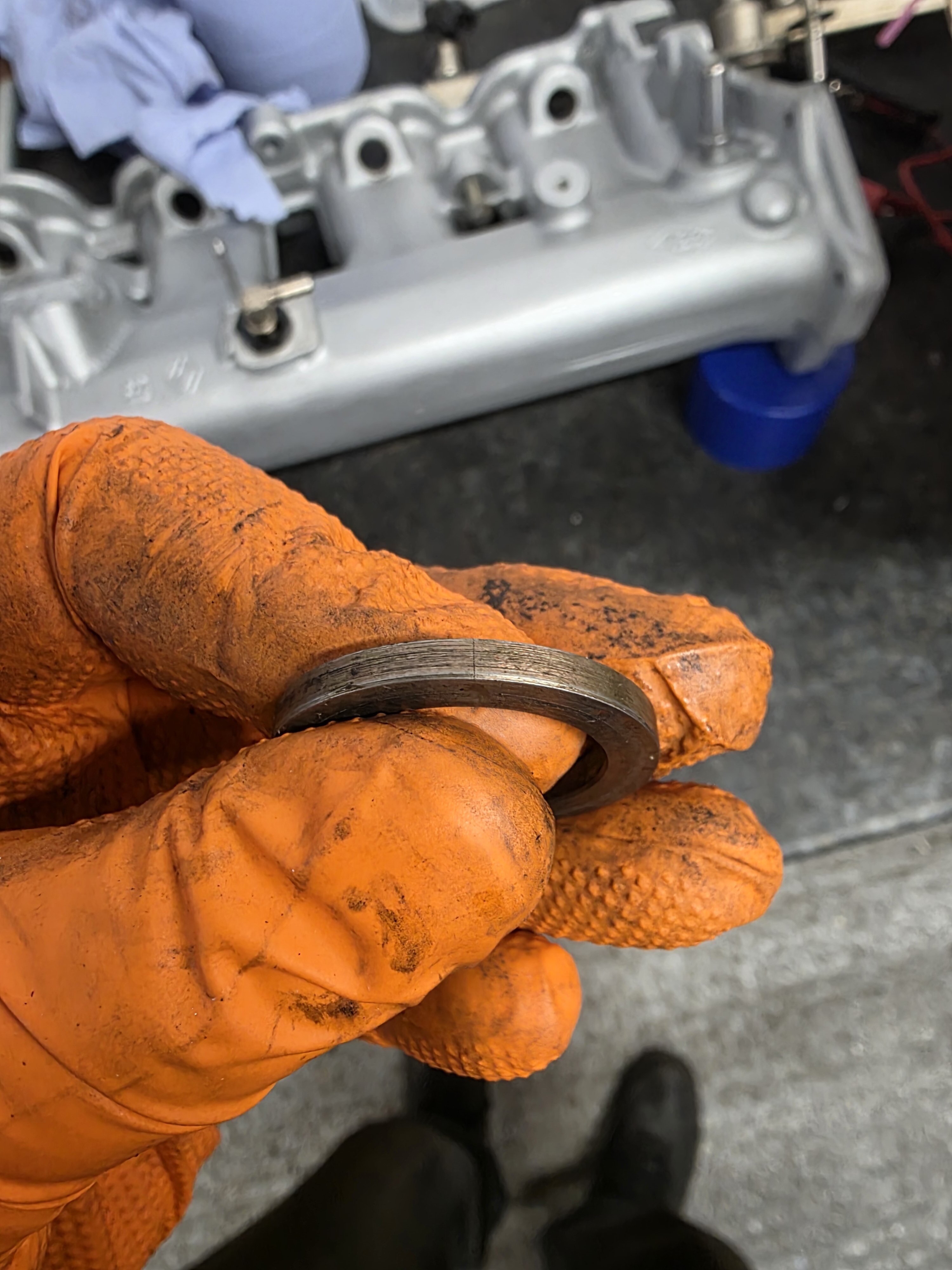

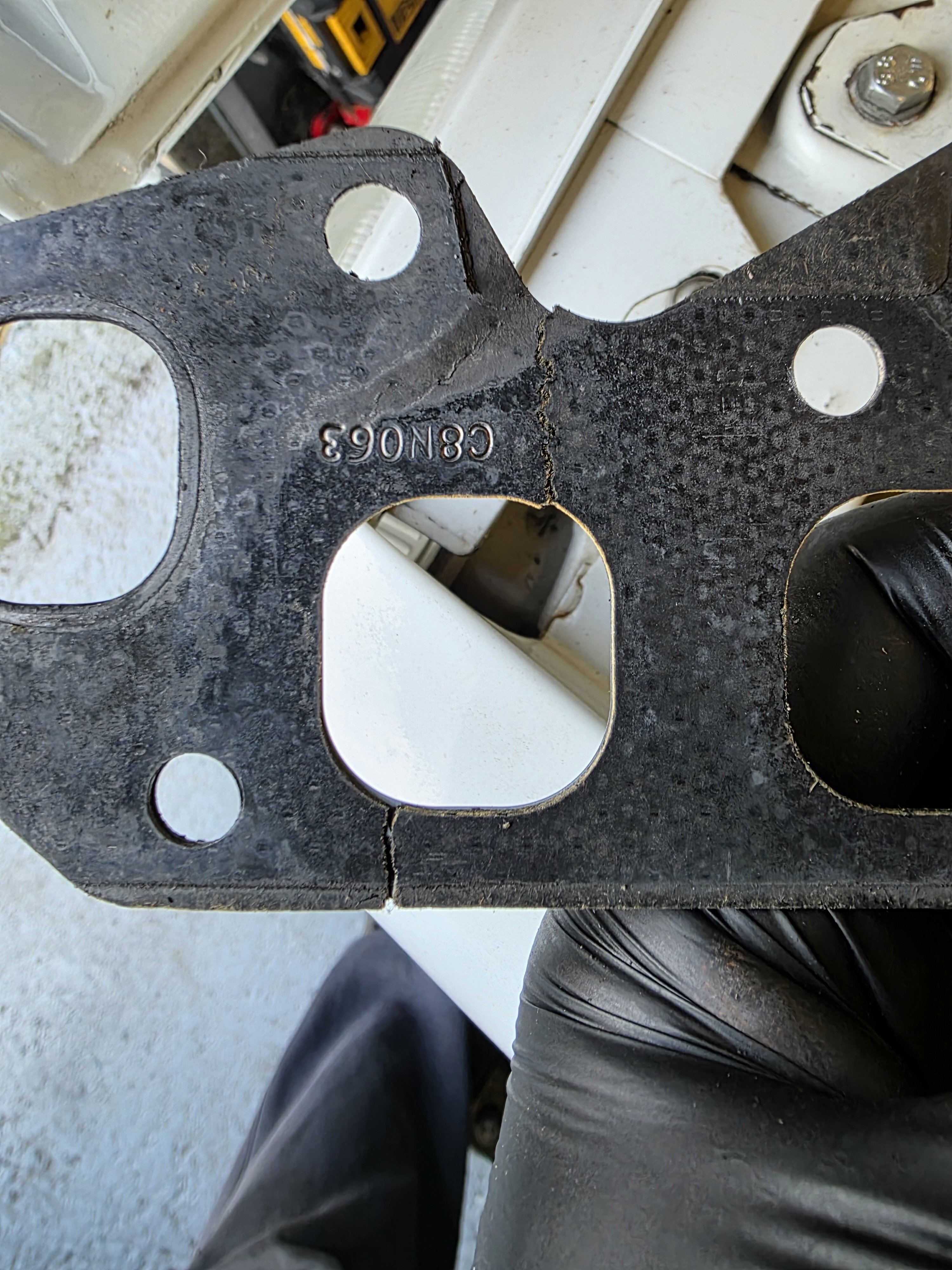

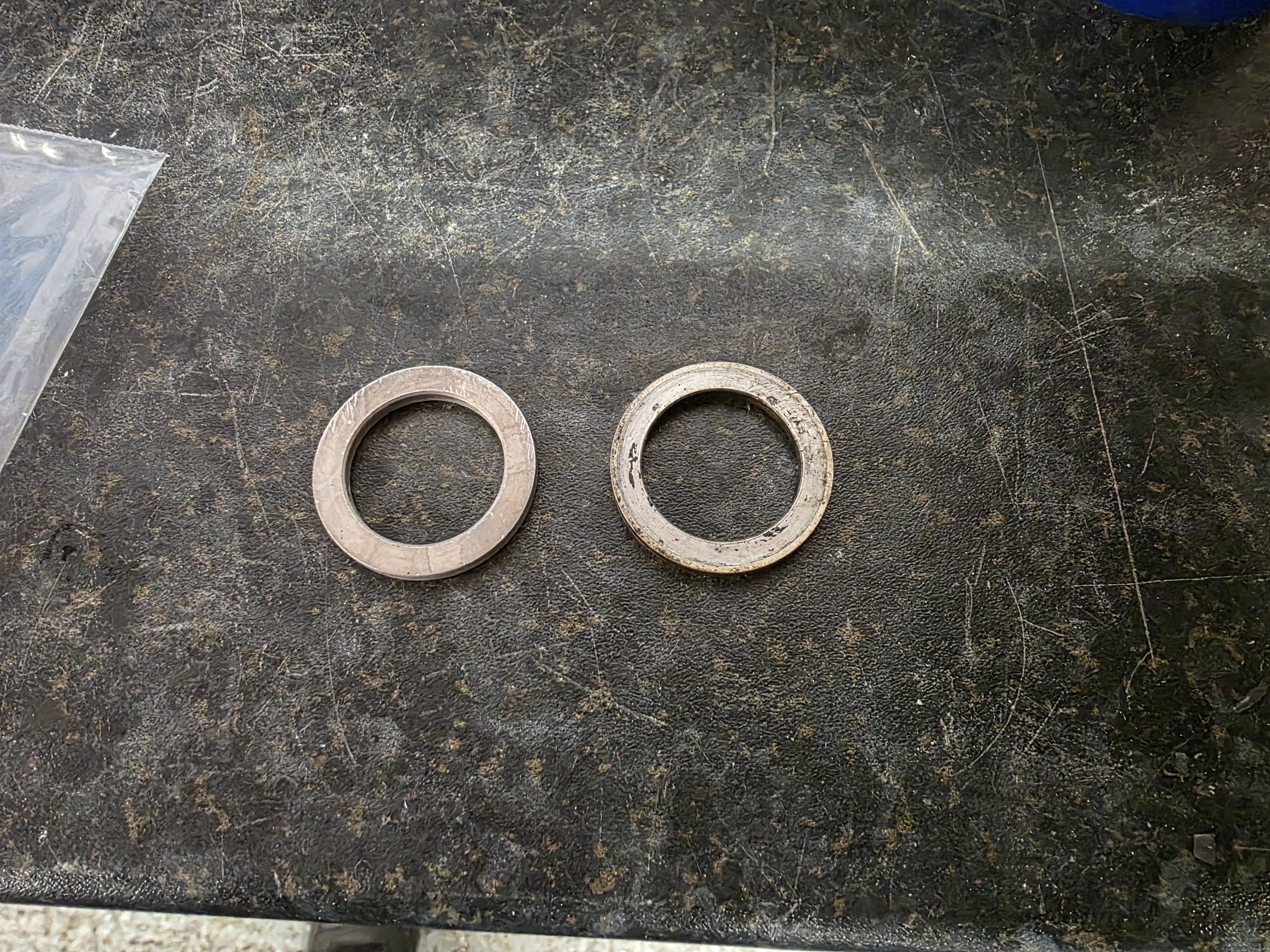

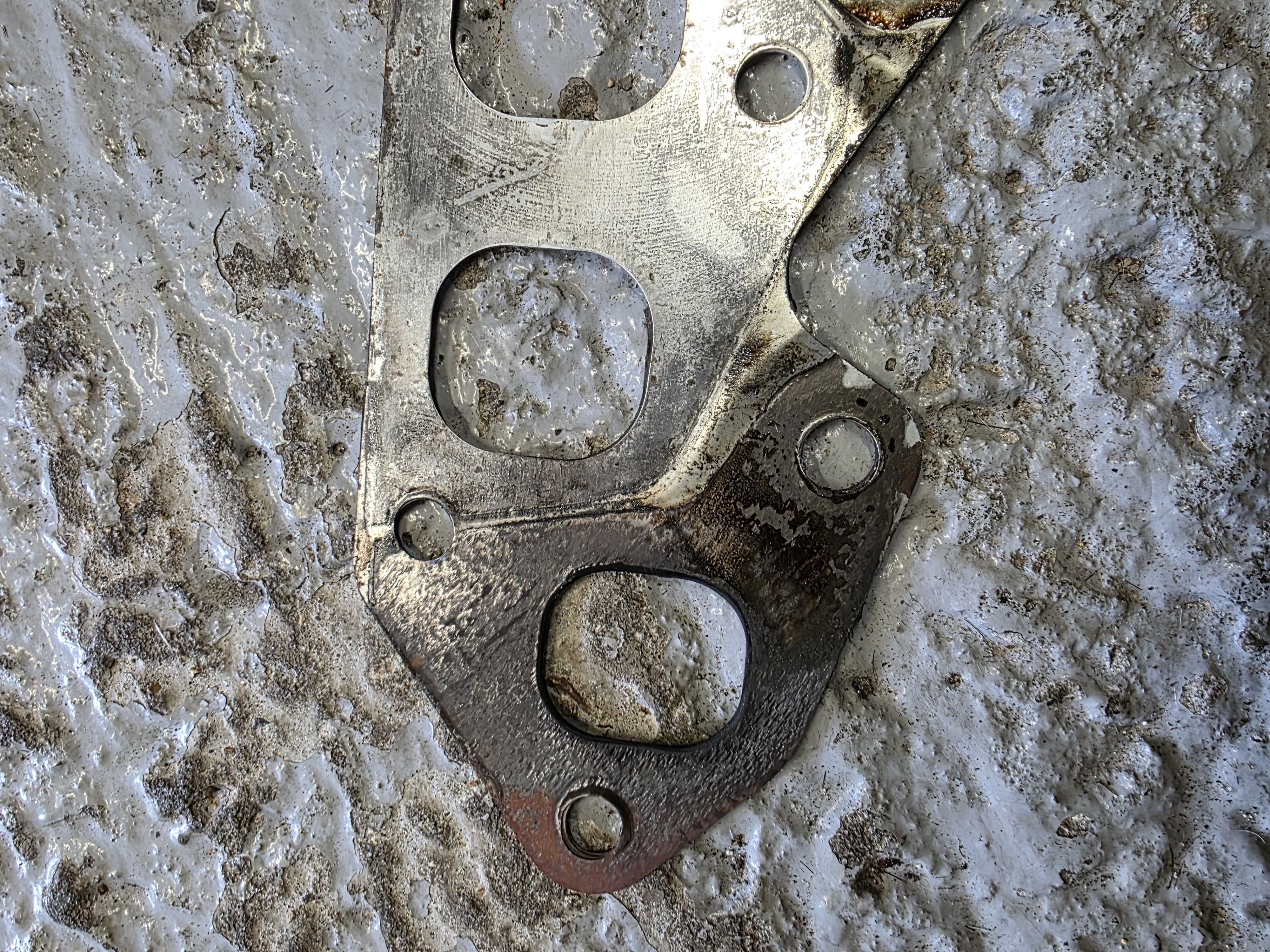

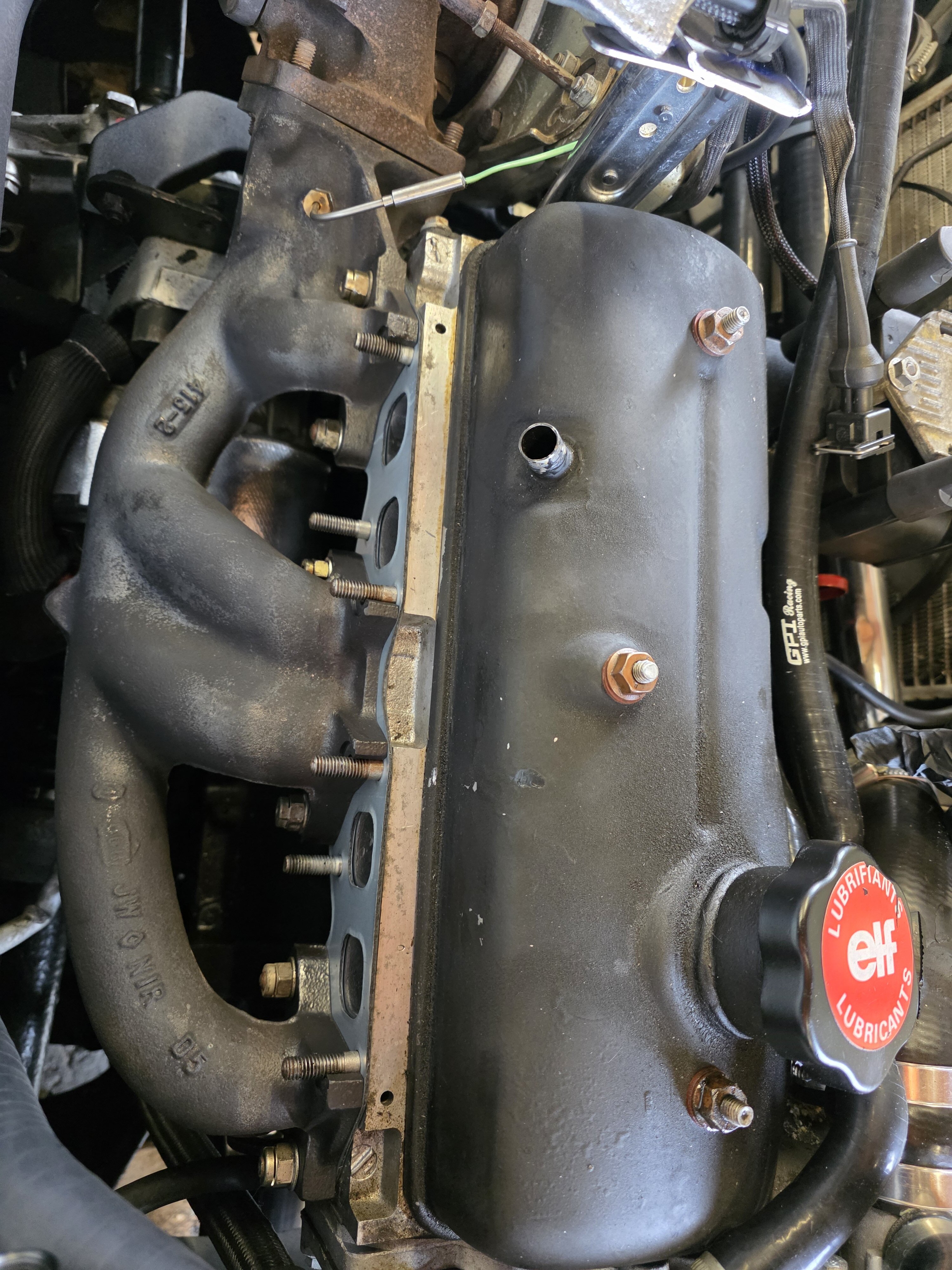

On stripping the gasket off, noted cylinder 1 & 4 inlet ports had split the gasket and rippled the stainless side. All bolts were tight so it had not blown out due to lack of torque on the fixings. Never seen a c1j gasket fail like this, i assume its high egt, high emap (exhaust pressure) related and the cast manifold moves a bit.

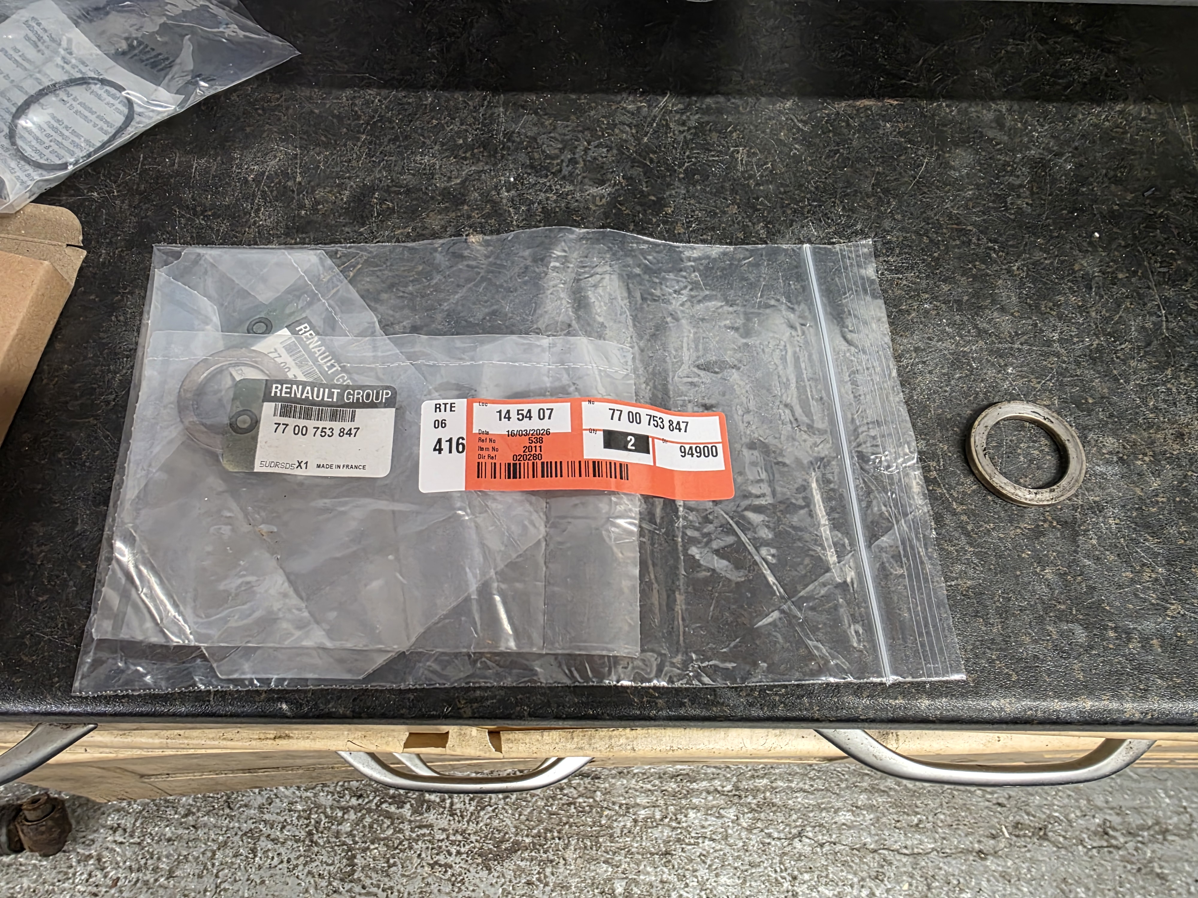

Oem renault gasket not up to the job.
Interesting ripples on the stainless side due to movement, cracks visible.
Ive had these fail before but not like this. The new one has stainless plate both sides and supposed to be better. However might be time for a material change, i have a lead on a copper gasket.

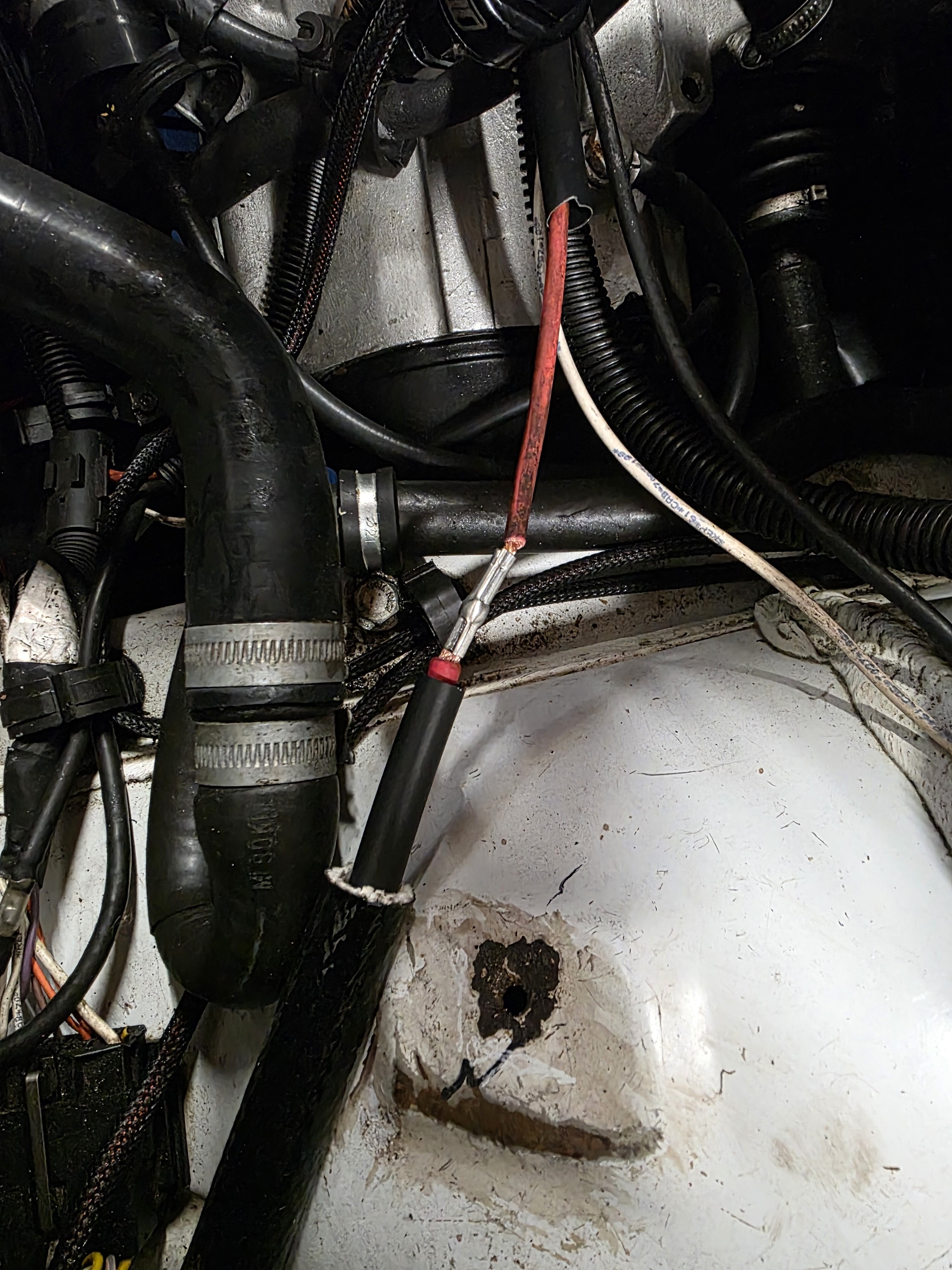

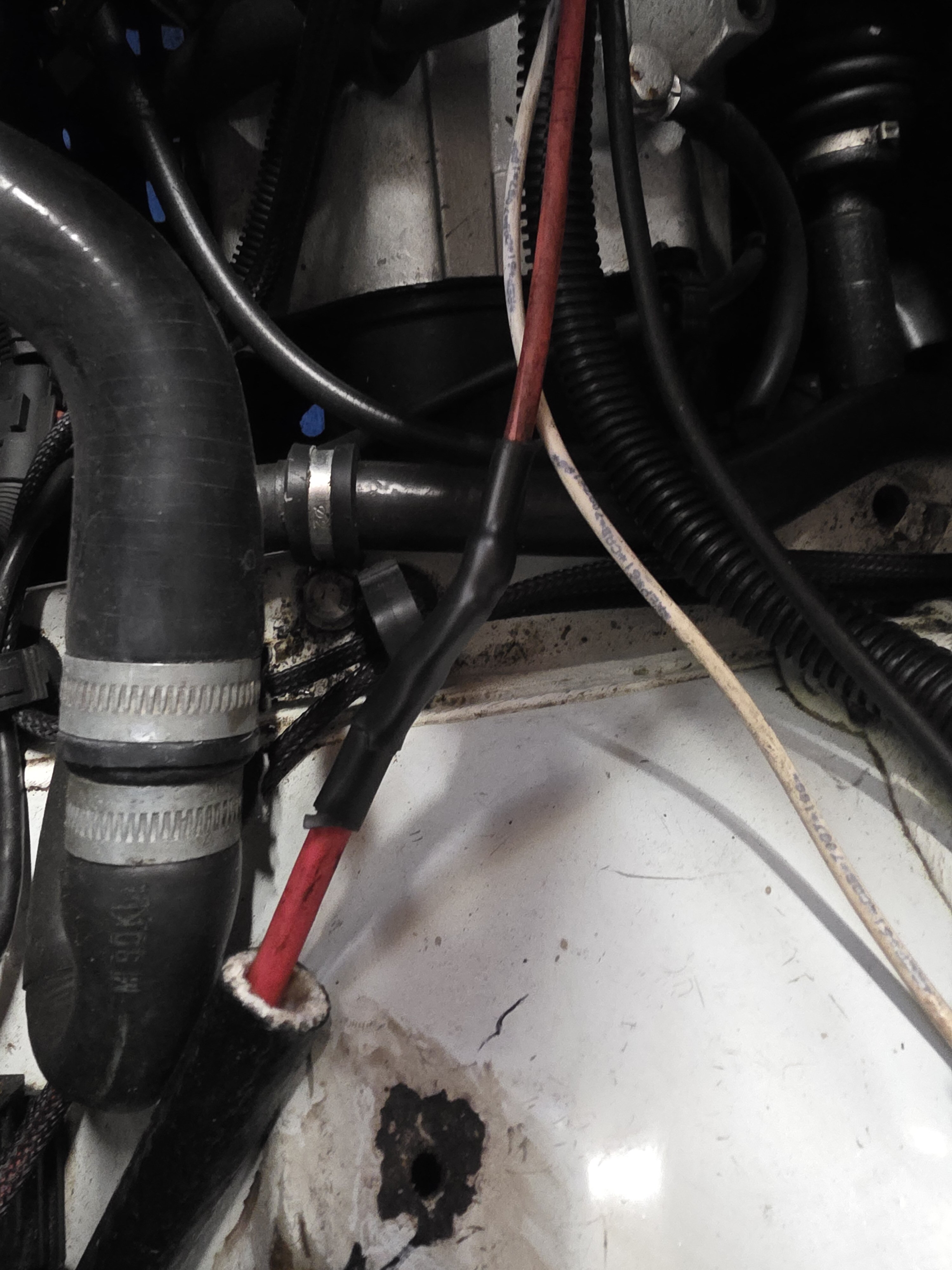

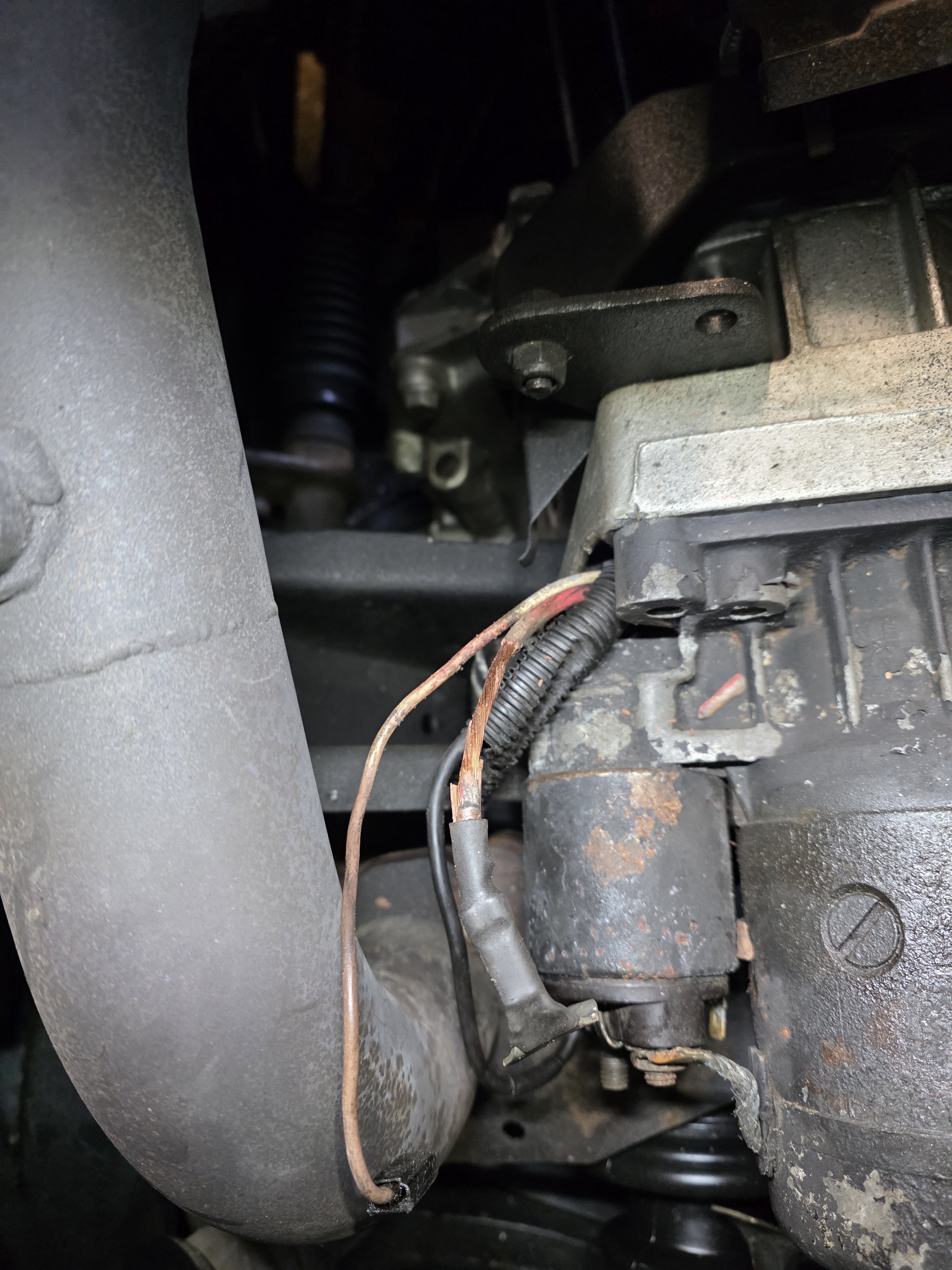

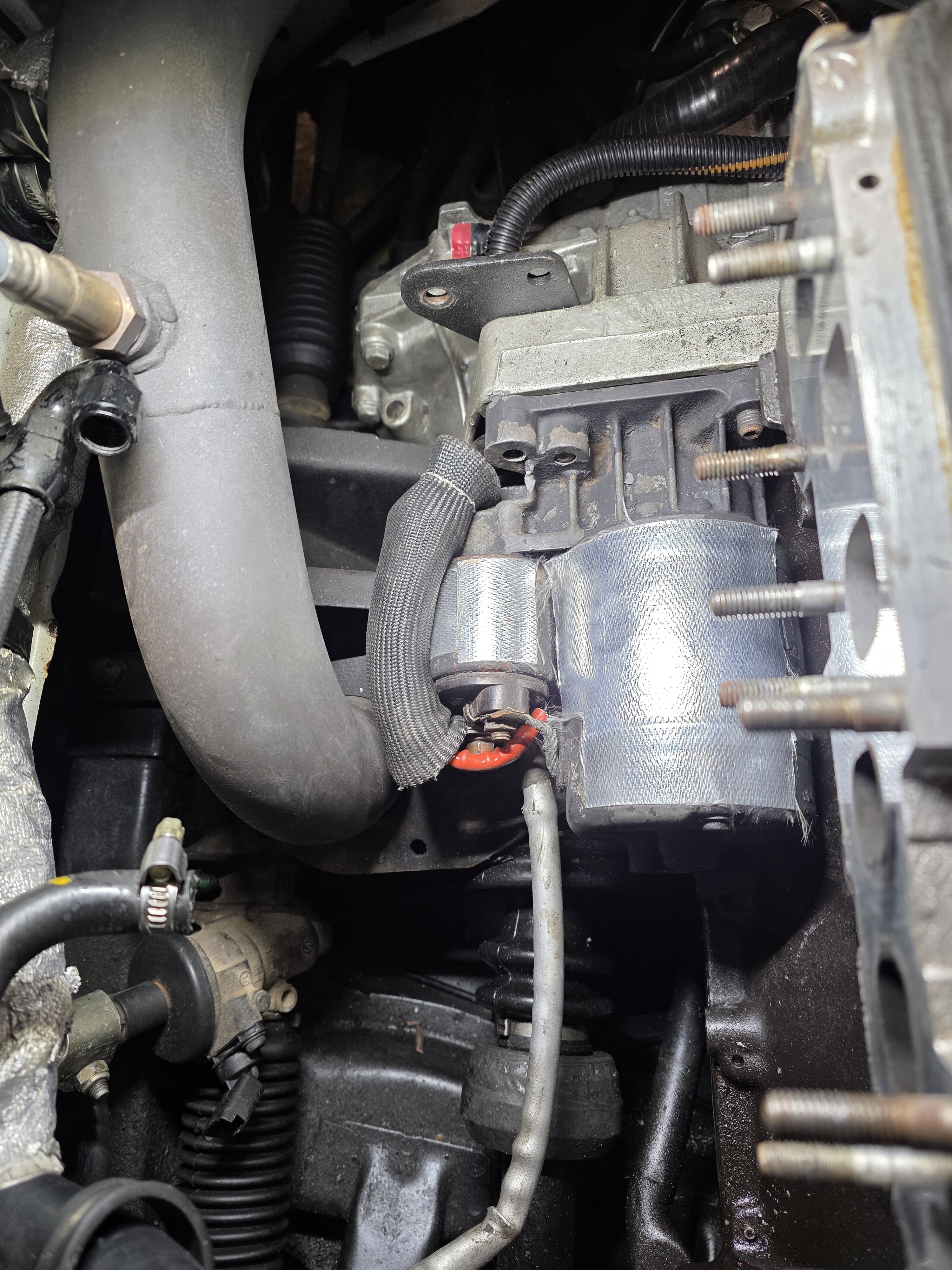

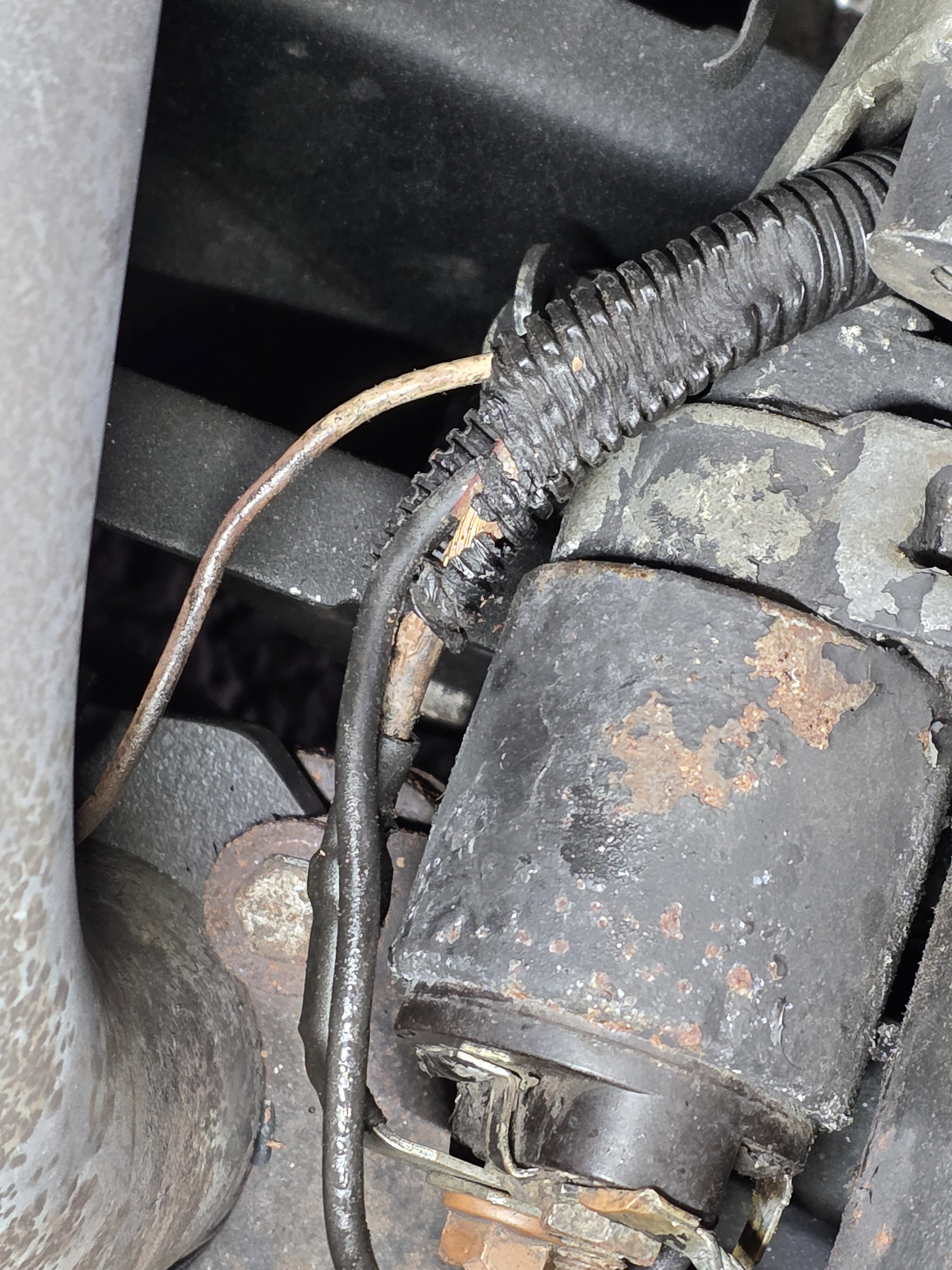

Id noted the starter wiring was a bit tired last time id been underneath, heat had affected it and the plastic conduit was melted. The r5gtt runs a starter motor heatshield originally but they fall to bits and get binned, ive done thousands of miles in this without issues but the efi engine is a different animal and clearly needs some protection
With access good the heat damage was clearly visible, Not the best.
Touched it and everything fell to bits revealing 50mm or so of bare live wire. This has no fuse as standard, good job it never touched anything or could have been sketchy.

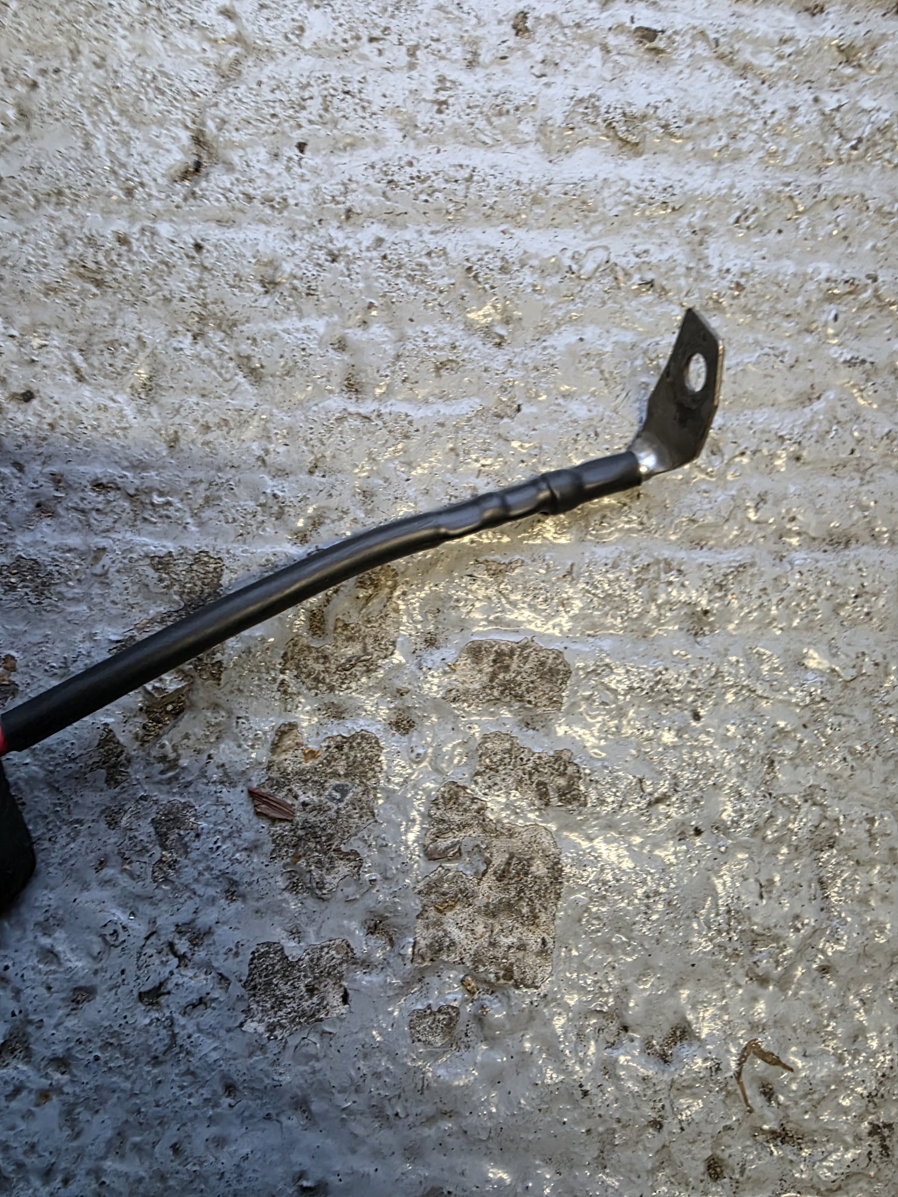

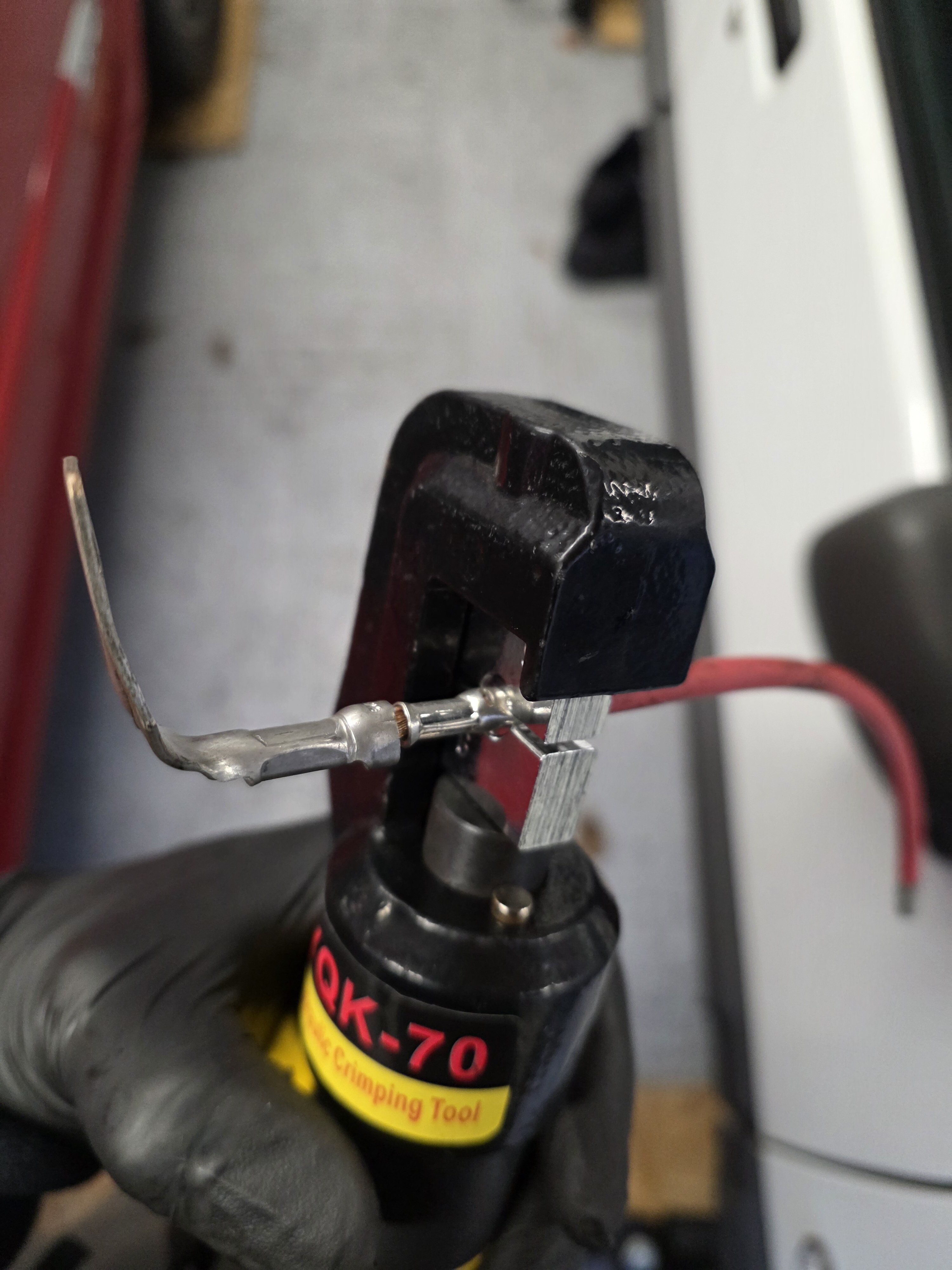

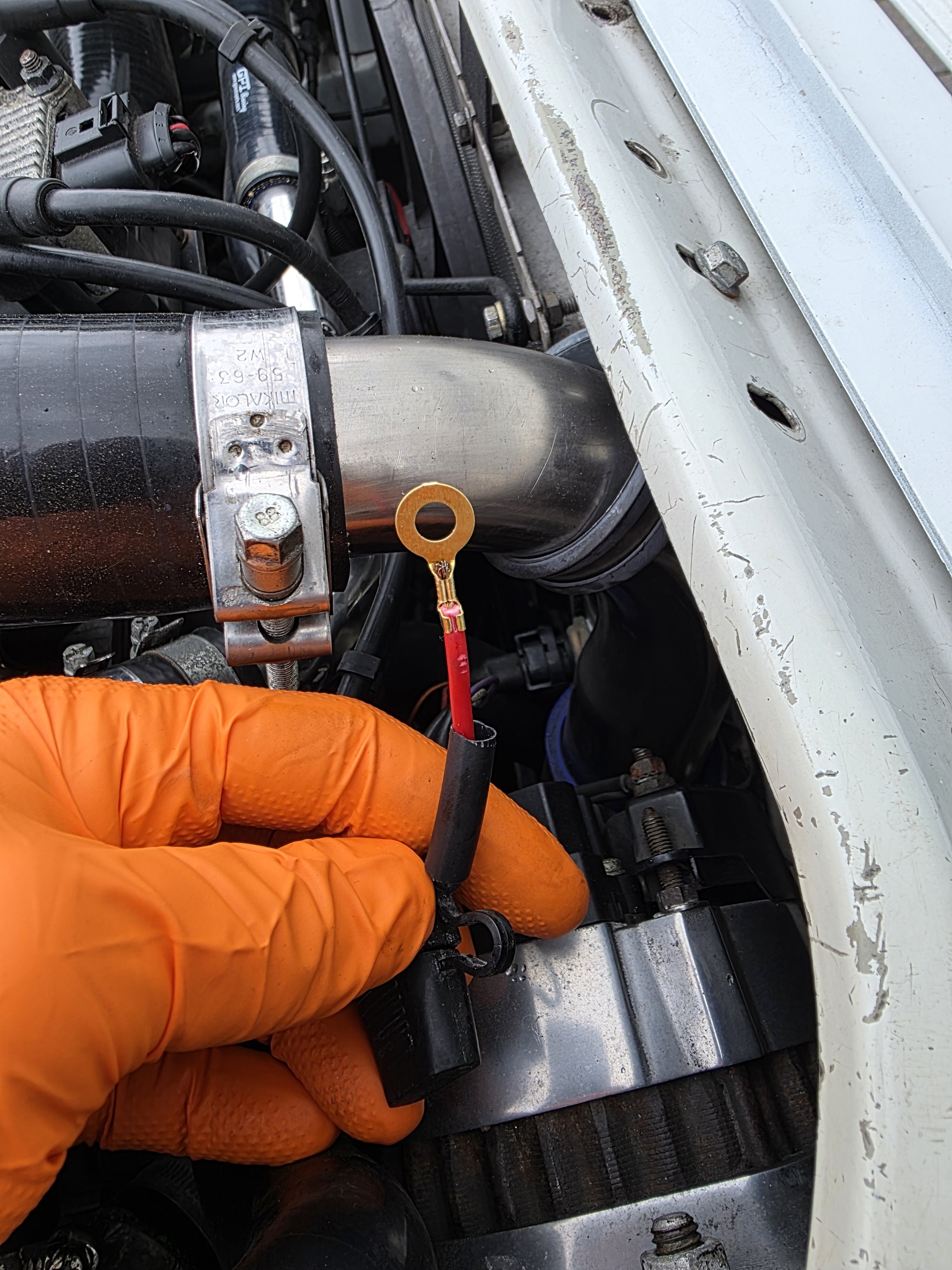

Heatshrink would not go over the angled connector to the starter + terminal so only option would be tape which is a bit bodgy. I need the angled connector and opted to splice a piece of new wire in. A quick rake about in the spare wiring and a bit of megane starter wiring found. Needed the angled connector for starter as access is tight, so crimped a straight joiner in, and chopped loom back which revealed an oem joint.
Hydraulic crimper gives solid joins.
Dual wall heatshrink x 2 layers.
Original loom cut and joined at oem joiner.
Dual wall heatshrink.
Fibreglass firesleeve added for heat protection.

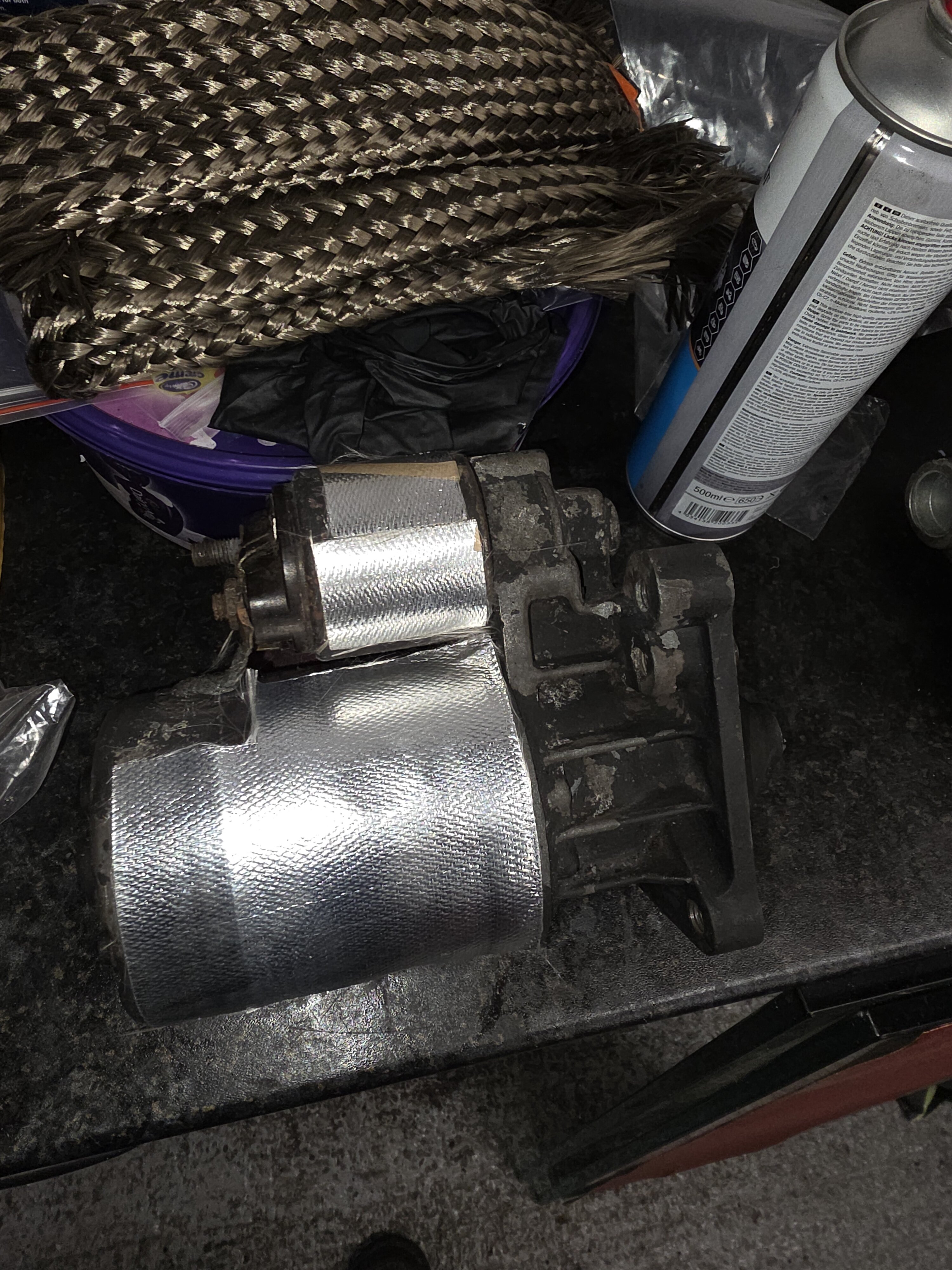

Starter motor had seen a lot of heat. Ideally it needs a heatshield making but can wait to another day. Added some dei reflective tape i had spare.
Refitted. Added a heatproof ht lead cover over the firesleeve, should be adequate. Ill add a maxi fuse into the positive wire to batt to avoid any issues in the future.

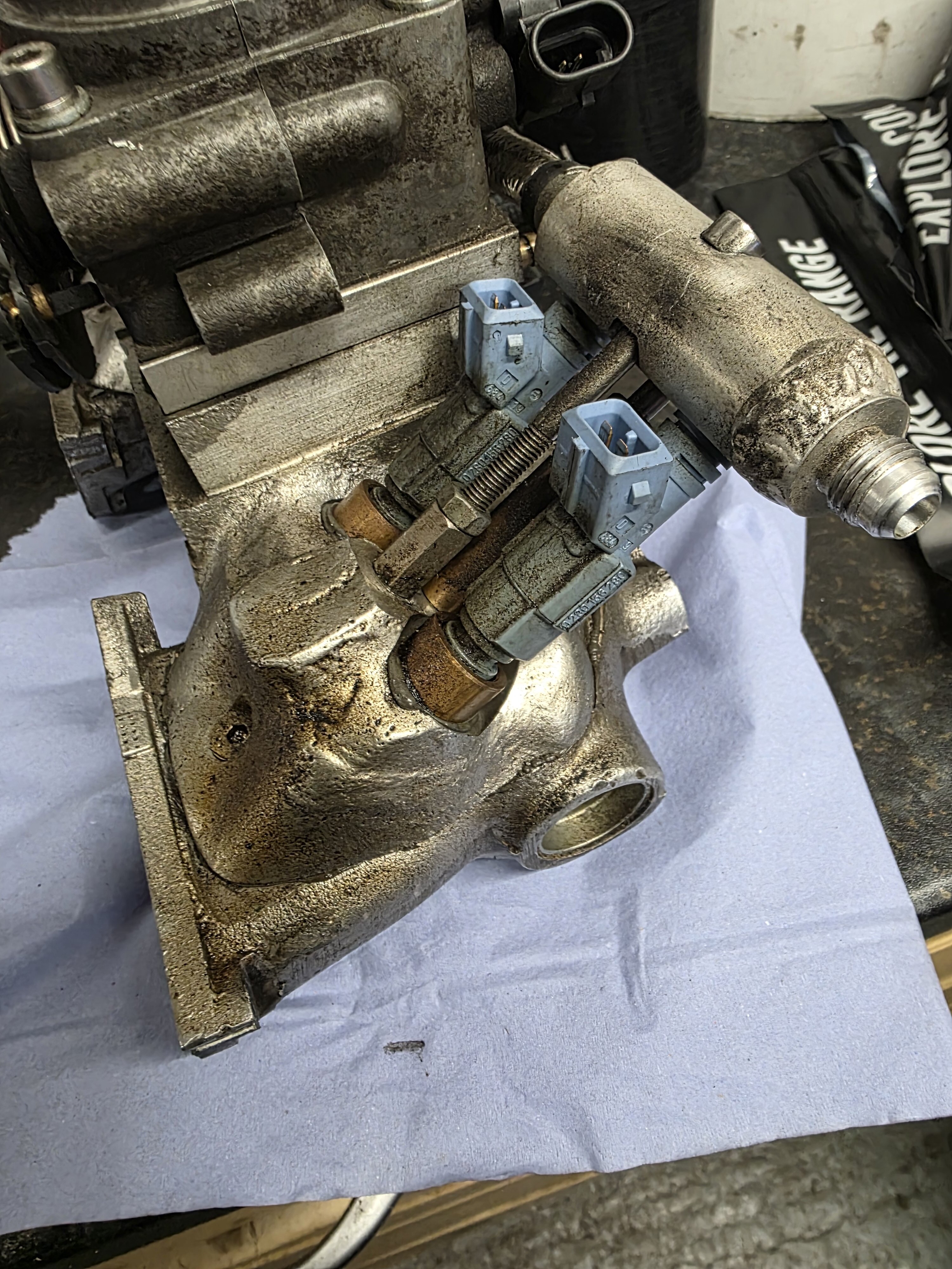

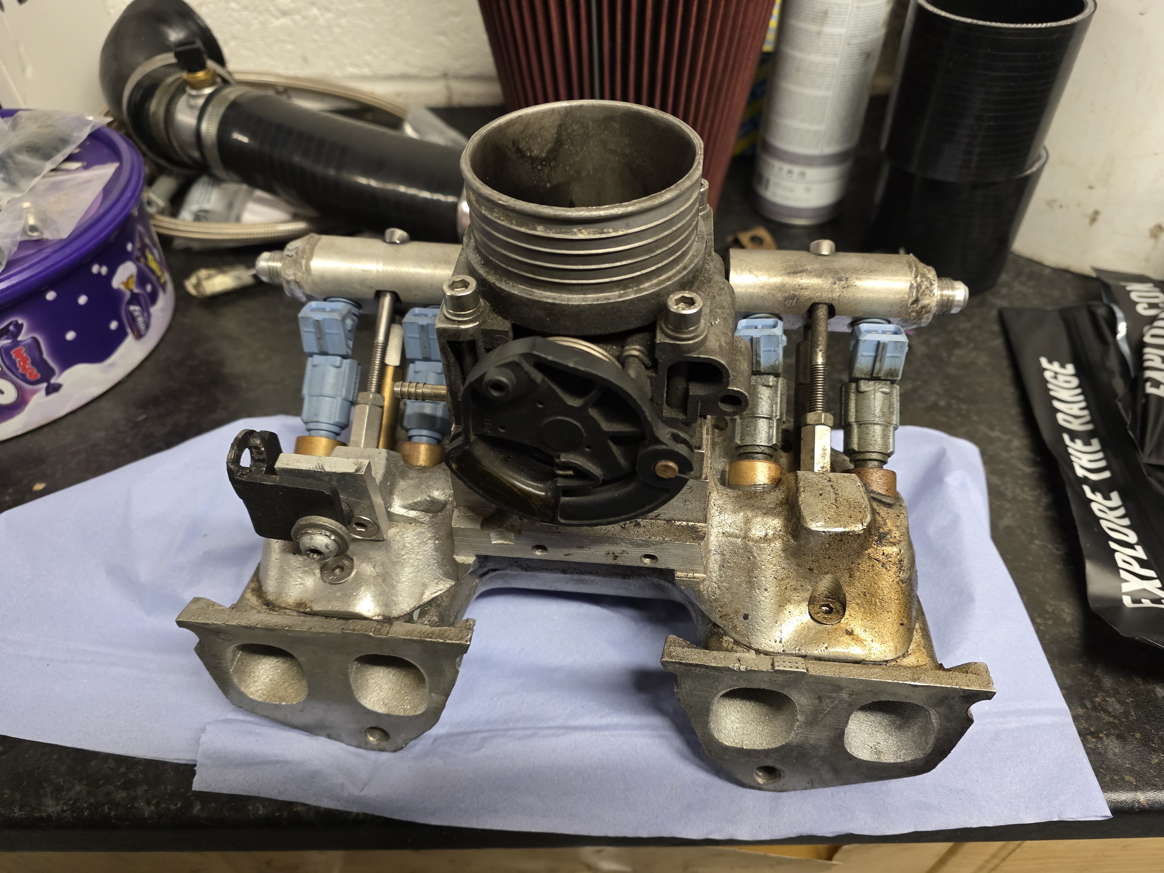

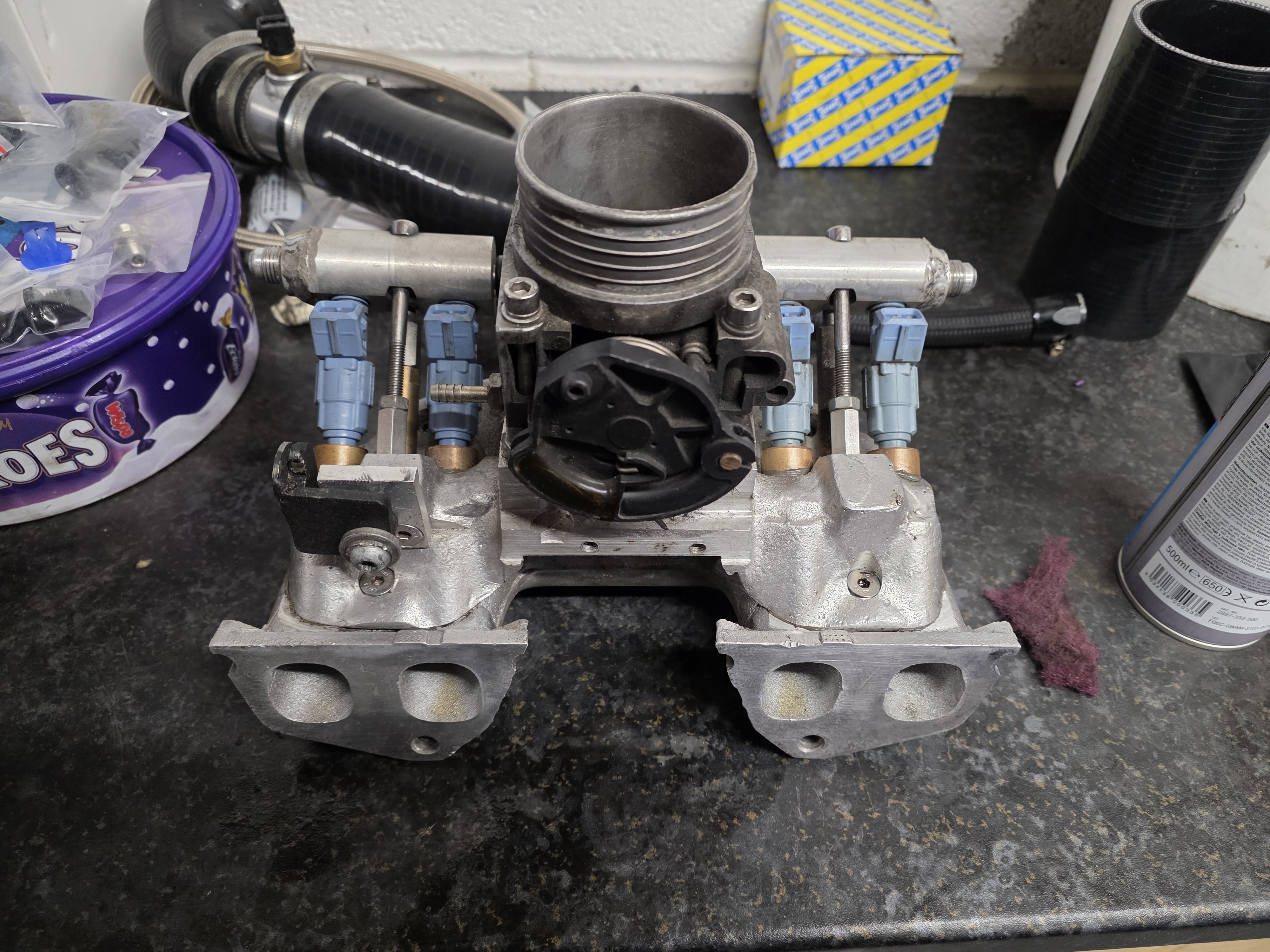

With this done started cleaning up inlet. The fuel vapour is clearly visible with added bit of exhaust blow.
Quick once over with brake cleaner.
Ran out of time so will refit today.

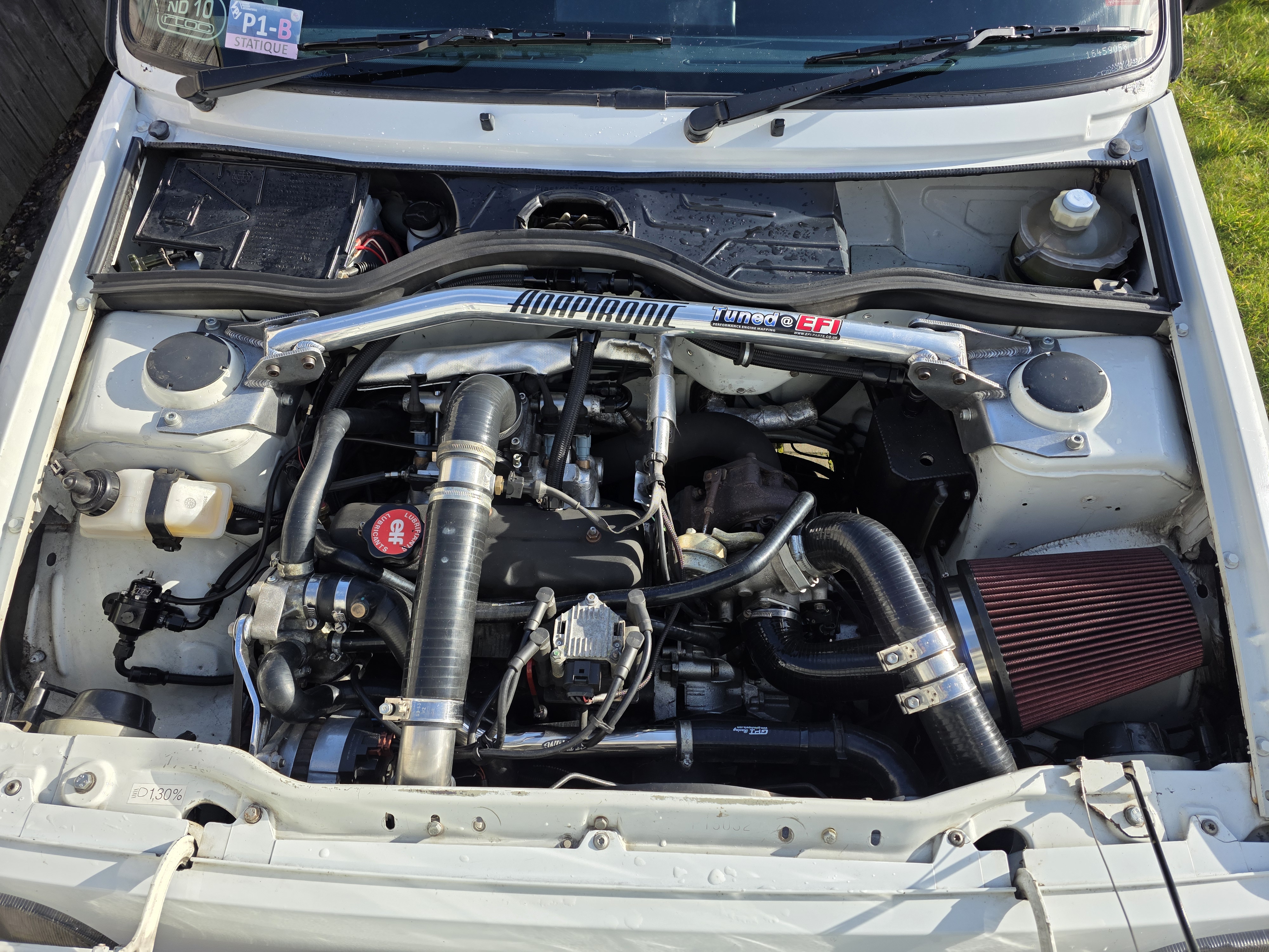

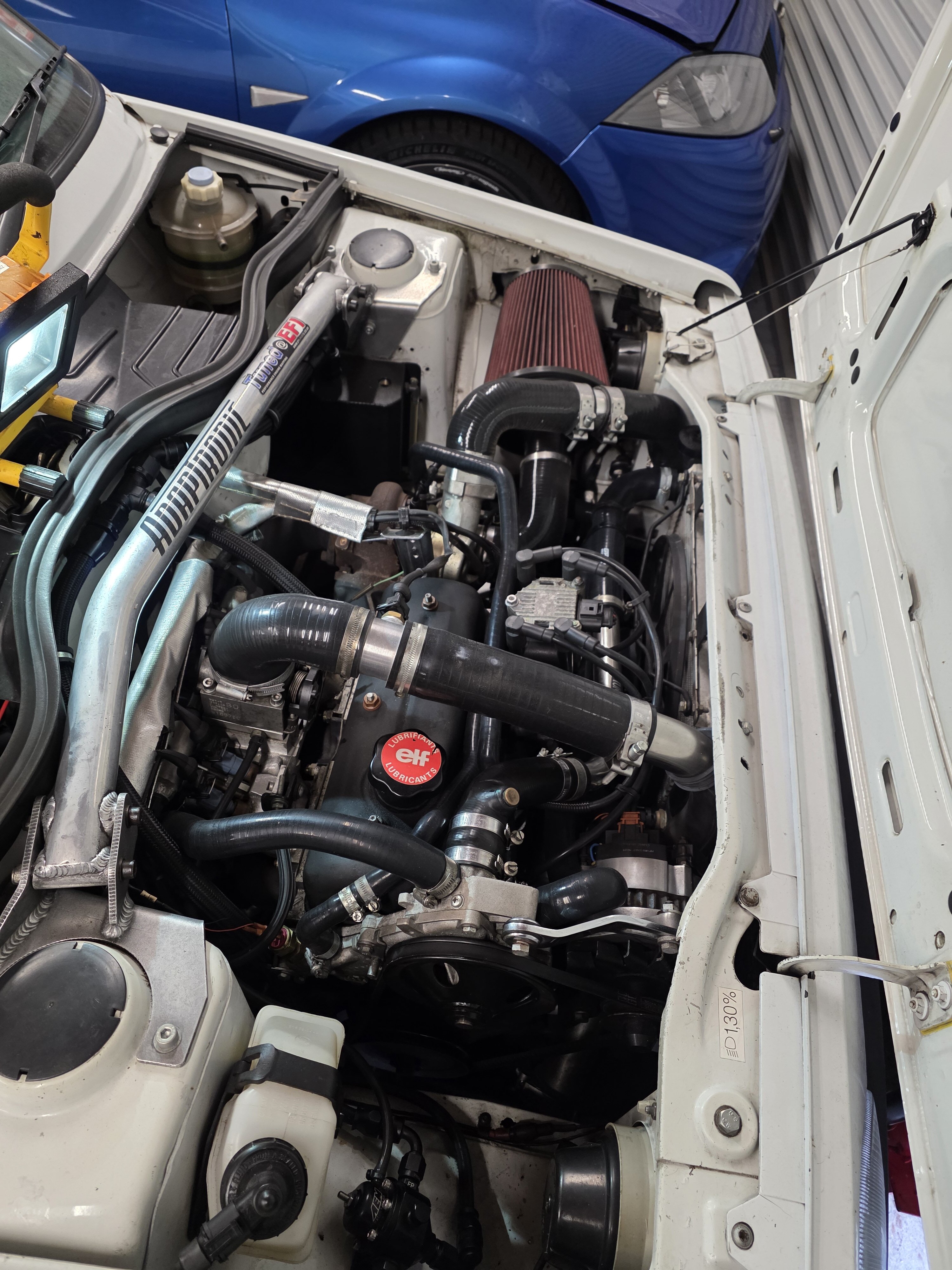

Back together. Give it a wipe over to clean.

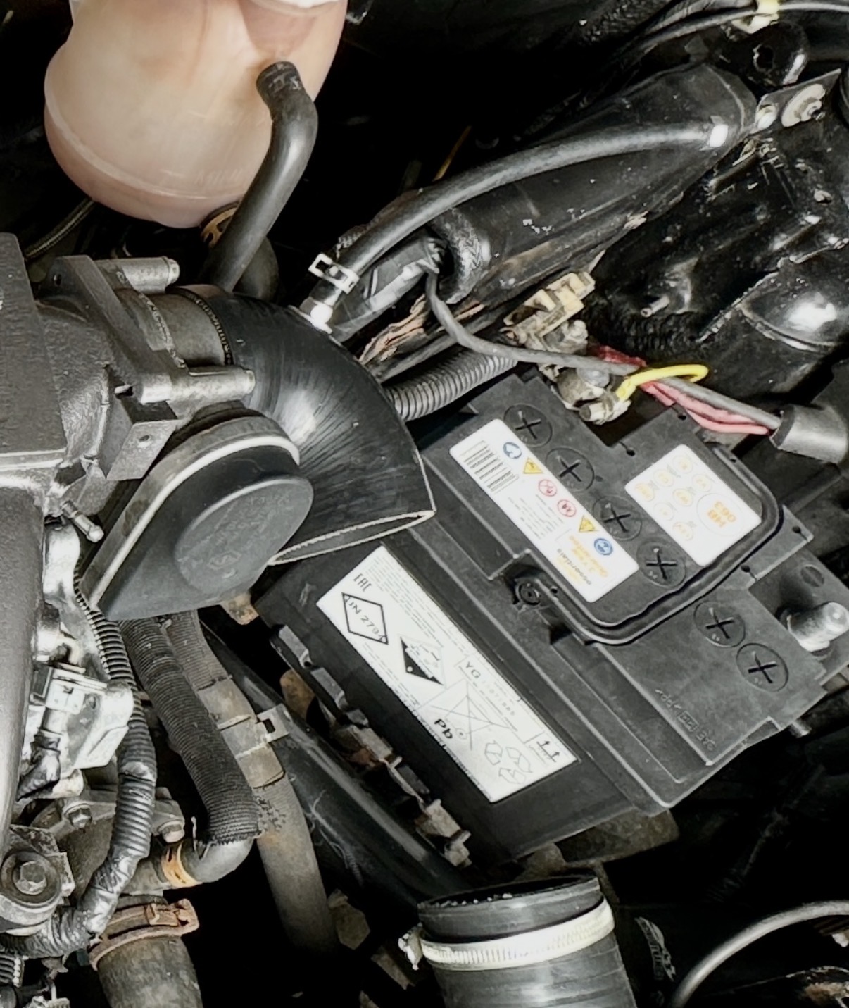

Battery back on, primed up fuel system with ign on and off a few times and good to go. laptop on to check sensors reading ok.
Primed oil system up by holding full throttle as the adaptronic has fuel and spark cut for flood clear, its a good feature. Oil pressure come up straight away, so went for a start and it fired straight up.
All seems to be good, engine idles better with no air leaks.

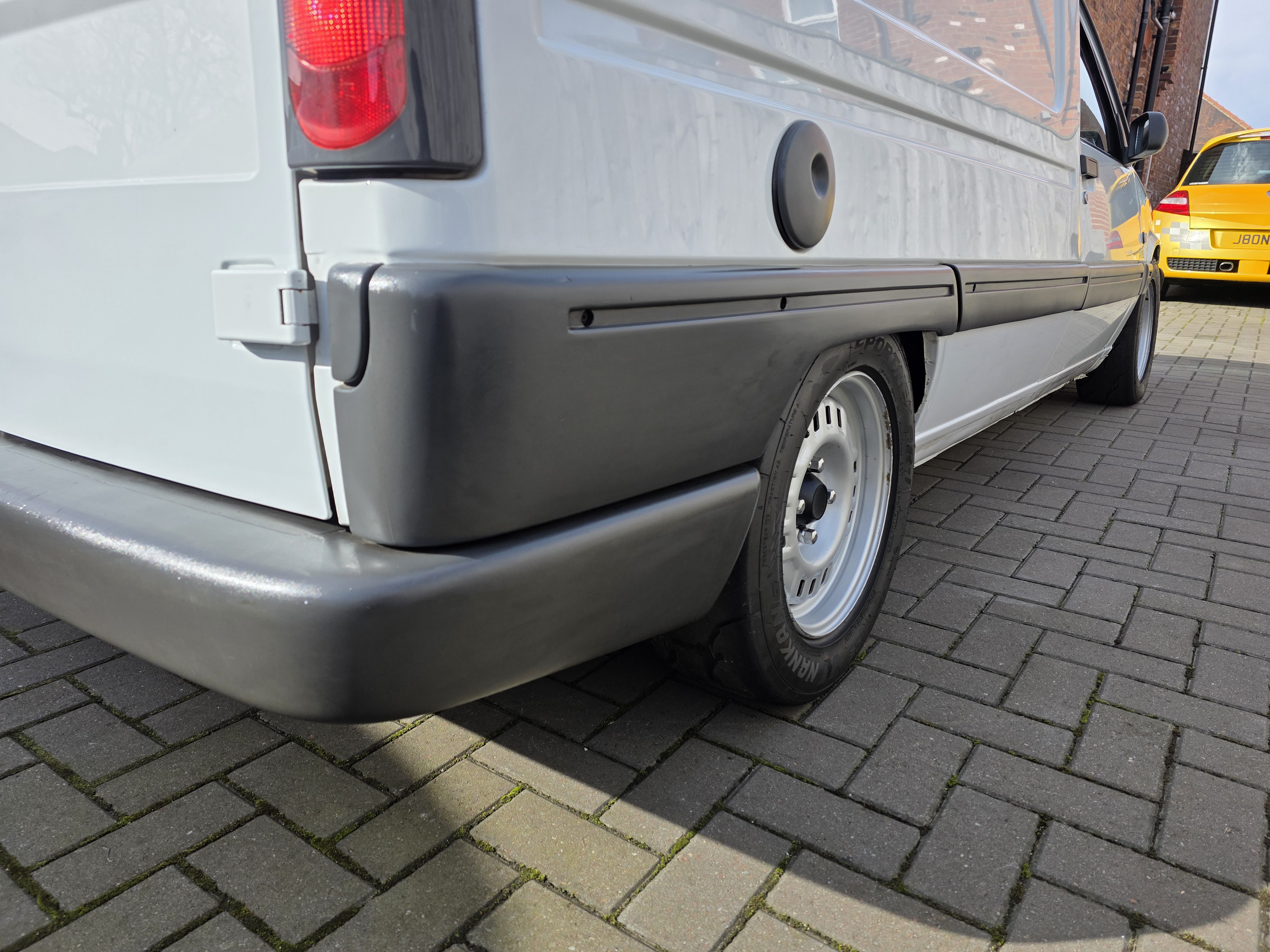

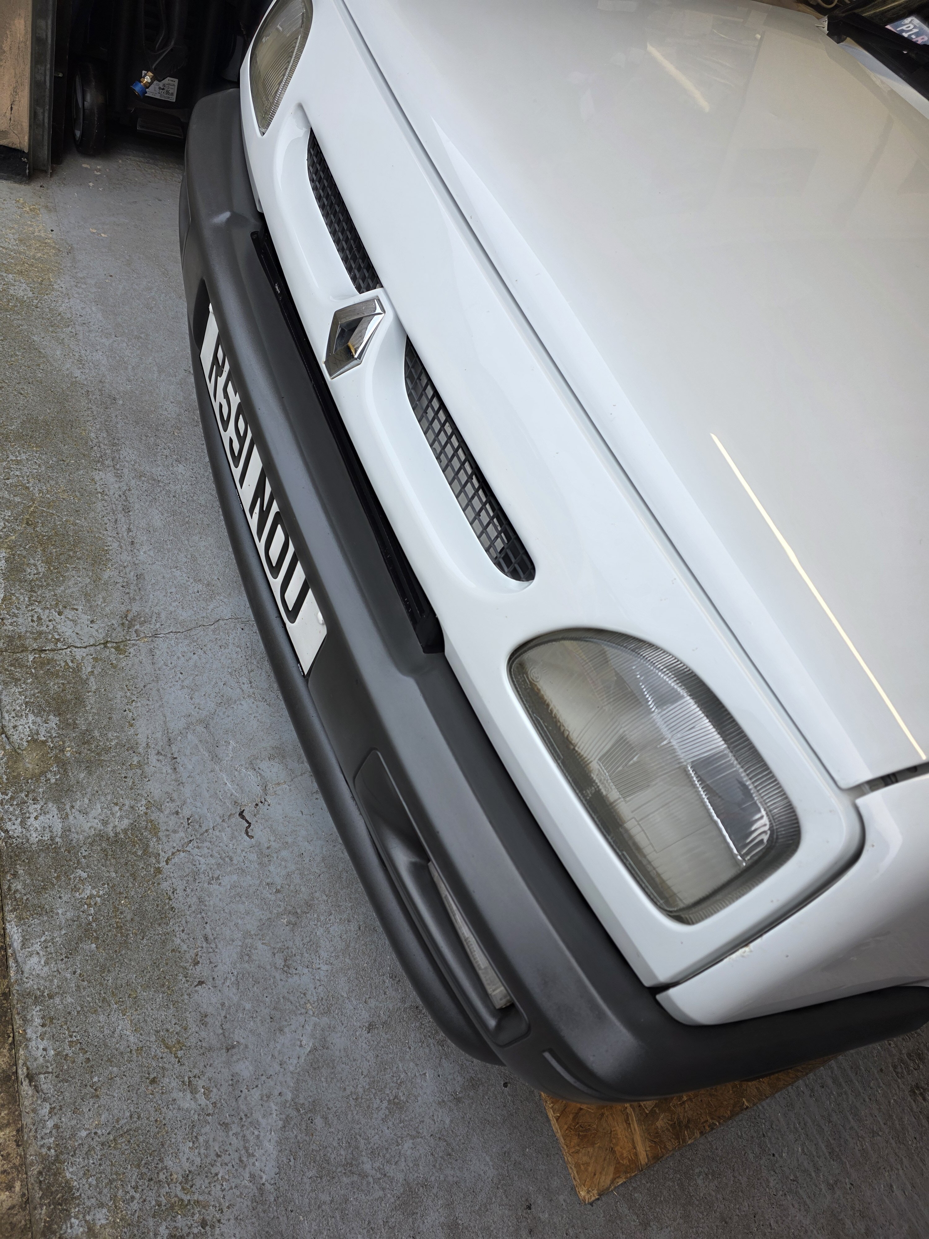

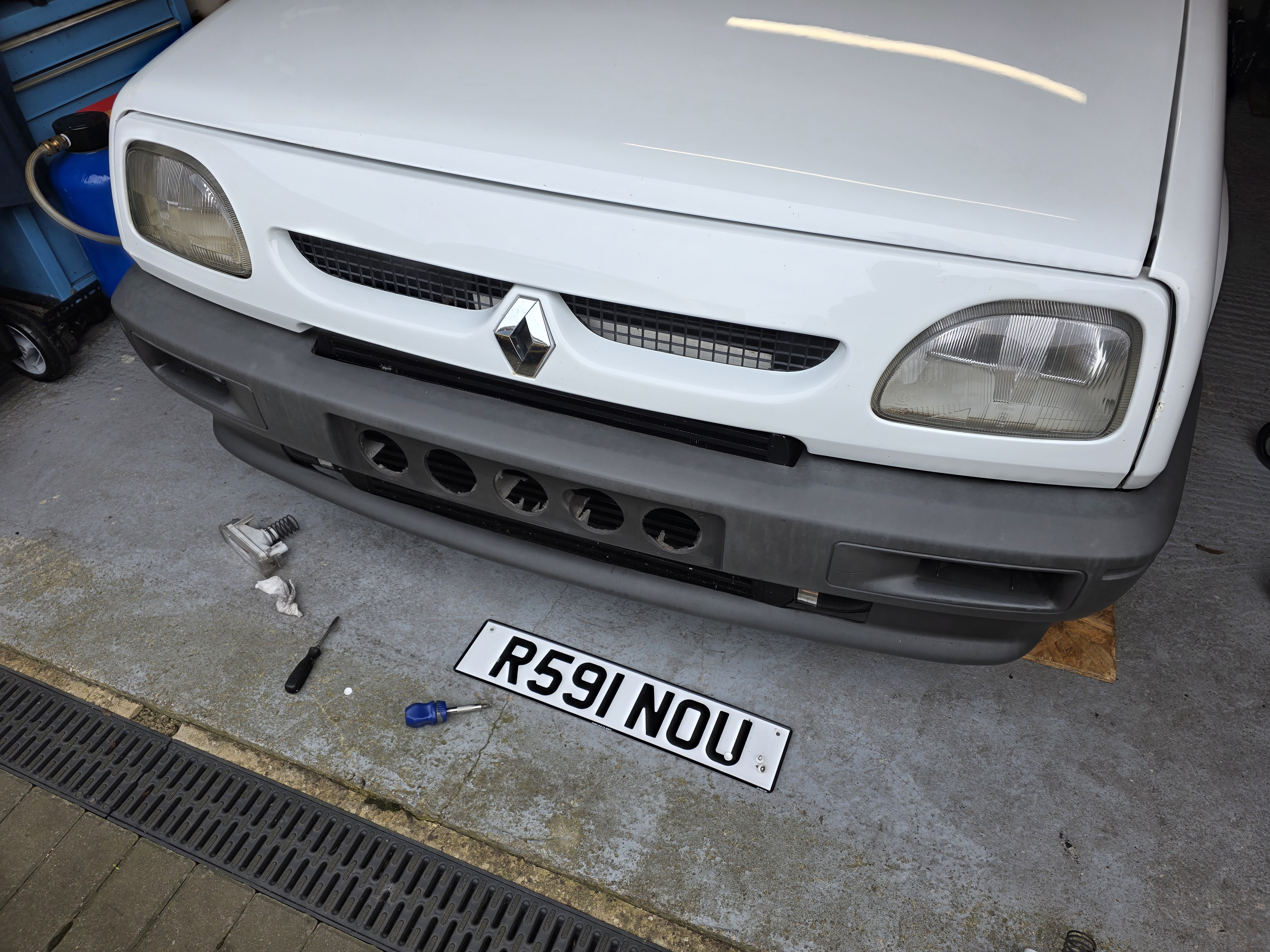

Coated the bumpers and all plastic trims on the Extra. In the past i done them with bumper gel, it never lasts more than one wash though and the trims go back to looking s**t.
Ive tried most of the good ceramic bumper coatings and some are pretty crap durability wise, however had mega success with Cerakote ceramic trim coat wipes on the kangoo, so decided to do it properly.
Before
After
Its a bit glossy for some people, but personally i dont mind it. Goes off fast too, cured in an hr, prep is dead easy just scrub the plastics if necessary.

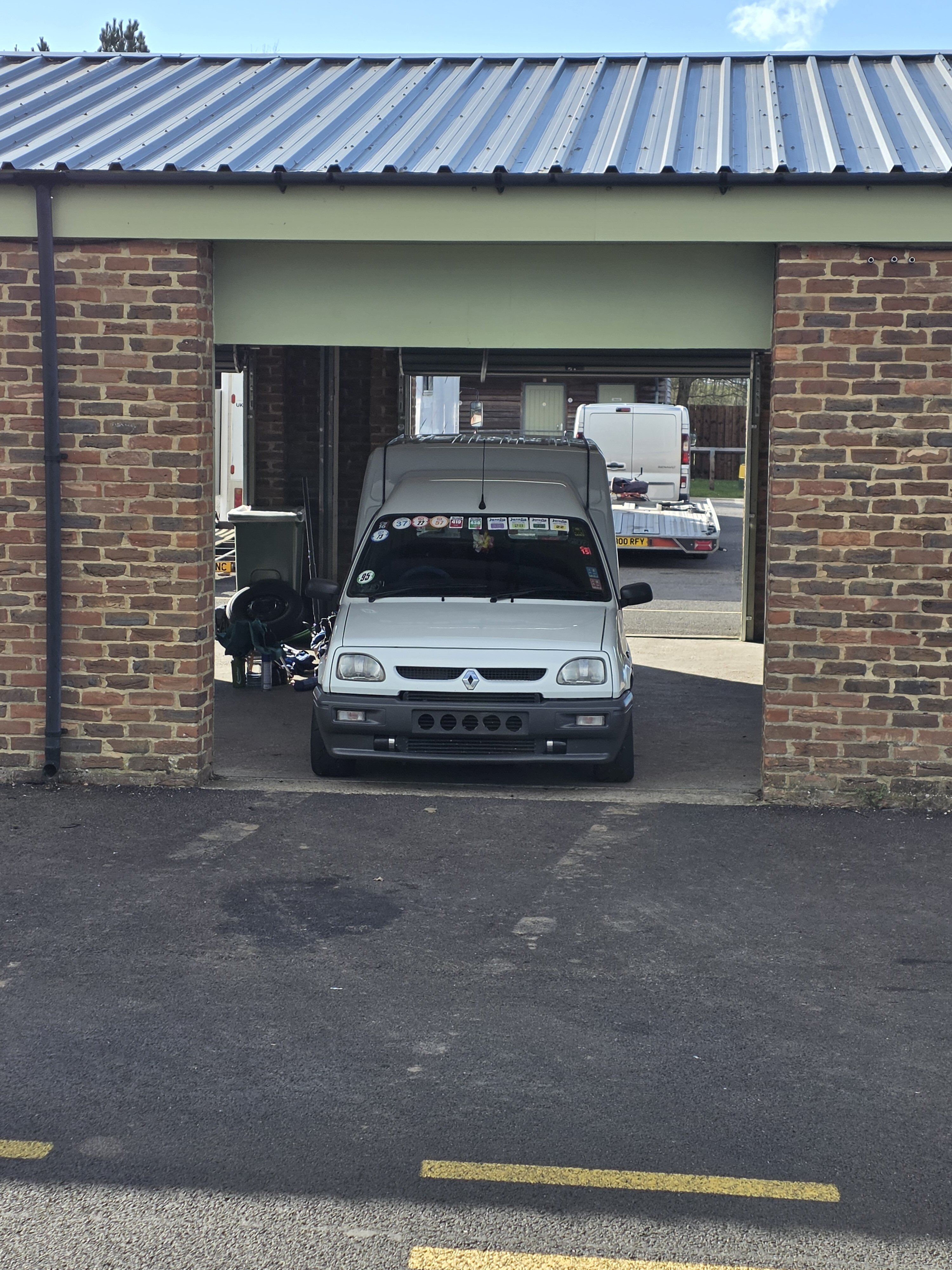

Got it out today for pre mot checks.
Plastics look mega.

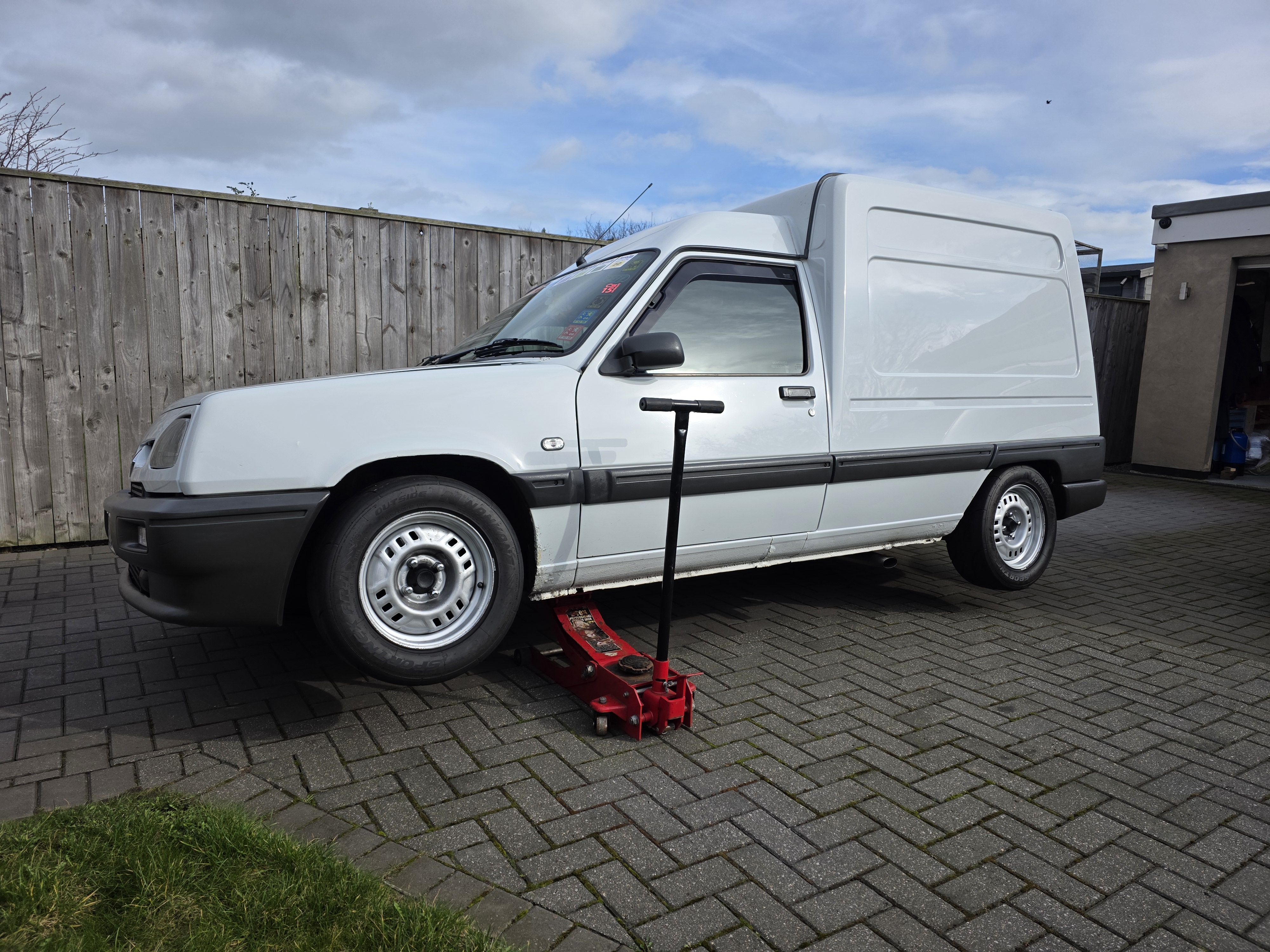

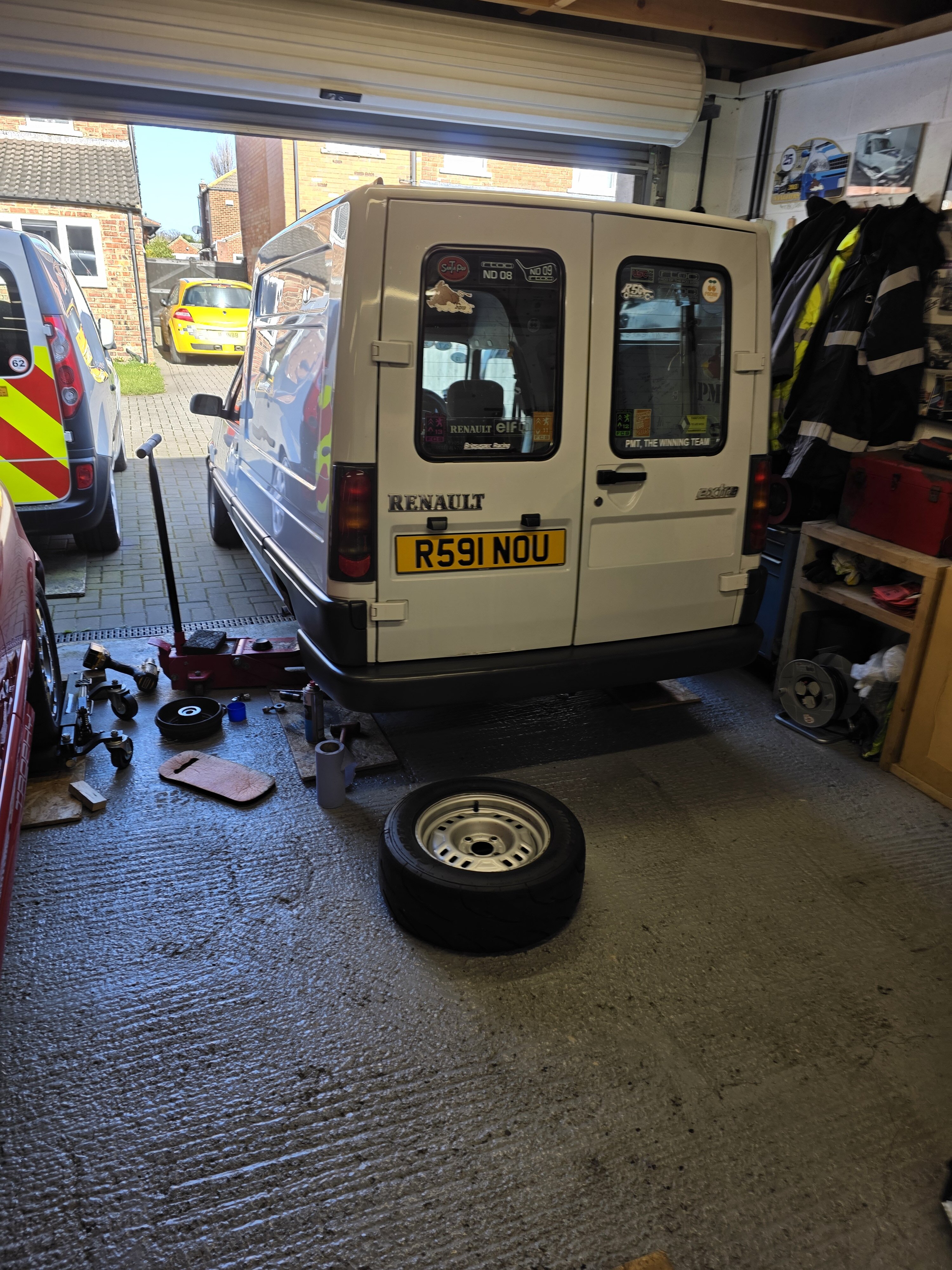

Main reason for getting it out today was for mot pre checks. Being honest, it was checked after Csf in 2024 and its done hardly no miles since so didnt expect any issues, and all looks OK. Still solid in the right places for a 29year old van.
920kg and it flys up on the jack.
Side exit exhaust.

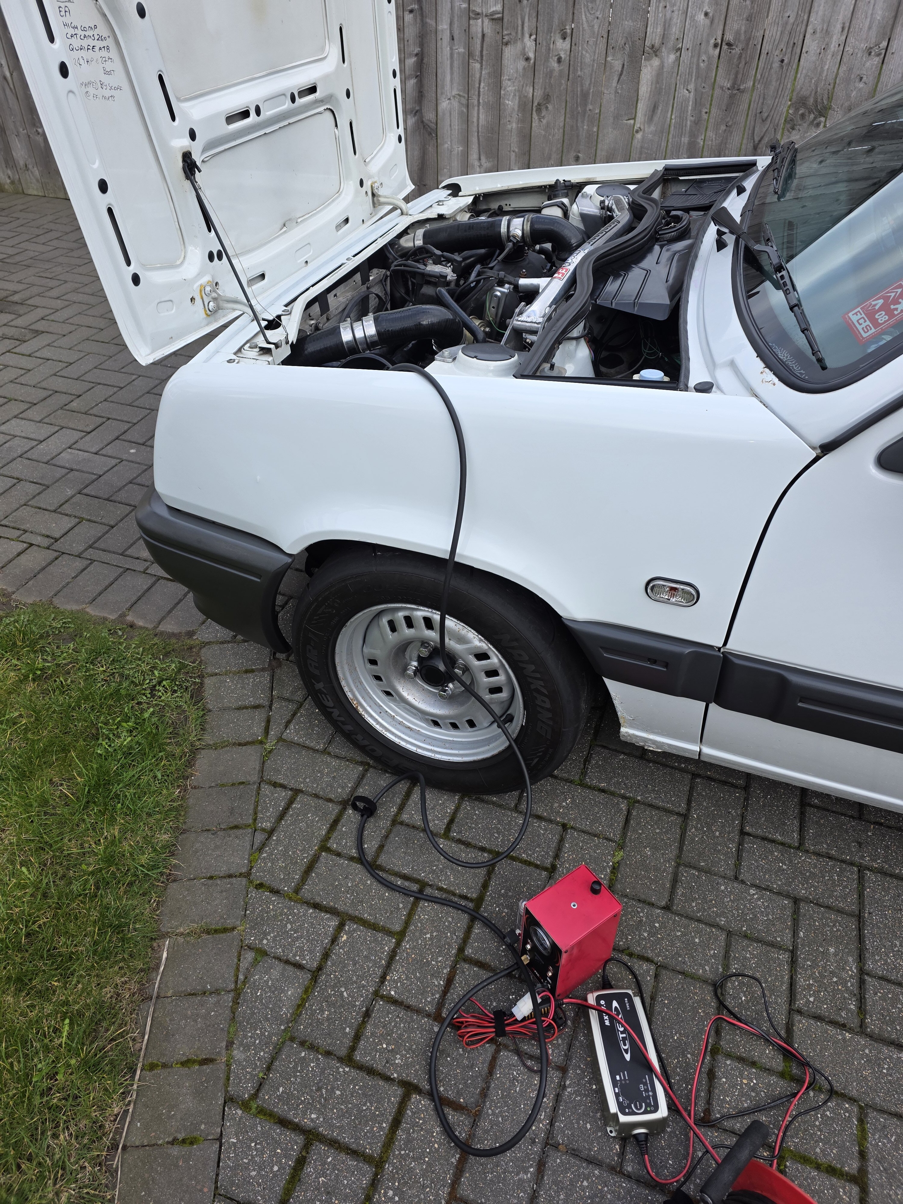

With mot pre checks done, i started doing some pre dyno checks. Its booked in Efi for a map tweak later this month. Been meaning to do it for 6 years but never get round to it.
Anyway quick smoke test on the boost cct, to confirm no more inlet leaks. All good, no leaks.
