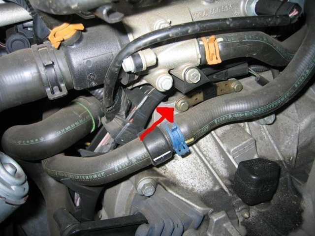

Check the sensor on top of the gearbox /fly wheel, give it a clean up or get another .. Mine did it at 5k n it was that
On the right hand side of the block ,from where the gearbox is bolted . It should just b 2 torx screws m8
From the top m8 , if it helps take ur air box out if u can't see it...I'd send u a pic but don't have 1 handy lol...
