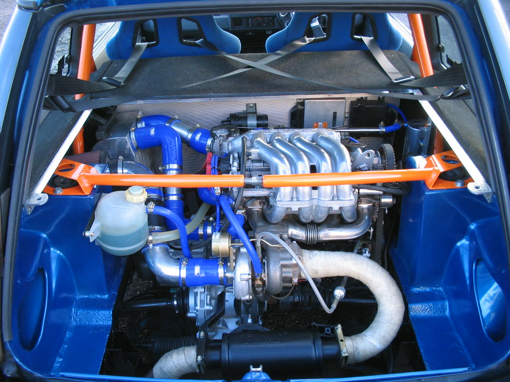

Decided I'm going to take this with me while working away from home this week. So it should be completely run in by the time I get home for next weekend.
Must say im not looking forward to it in m25 traffic tbh with the paddle clutch and no icv. It's very easy to stall!
Ha ha!
Done about 270 miles now, started to very occasionally rev it to around 5krpm just to vary the load but only for a couple of seconds every few mins of driving.
Still driving mint so far. Going to leave it parked at hotel till Thursday now other than i need to drive about 100 miles to go fetch some arrow conrods for a duratec engine which i will probably do monday night then walk rest of the week rather than cold start it just to sit it in London area traffic for a couple miles a day which won't do anything useful.
By the time I drive it home Thursday evening it will be fully run in and I can change the oil then map it for some boost and revs.
