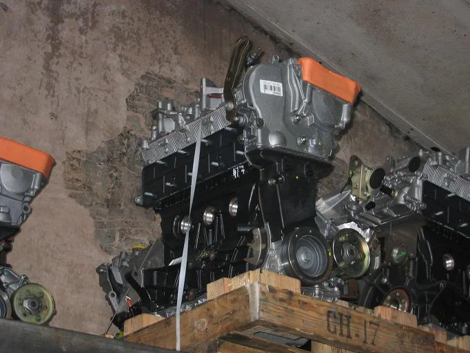

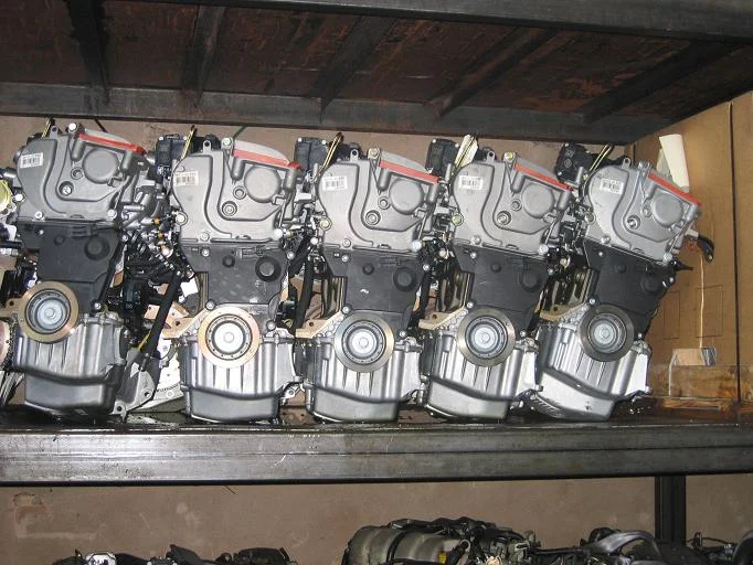

Brand New Genuine Renault CLIO 172 Engine £1250 + Vat - 40 aVAILABLE !!!!!!!! - F4R CODE
