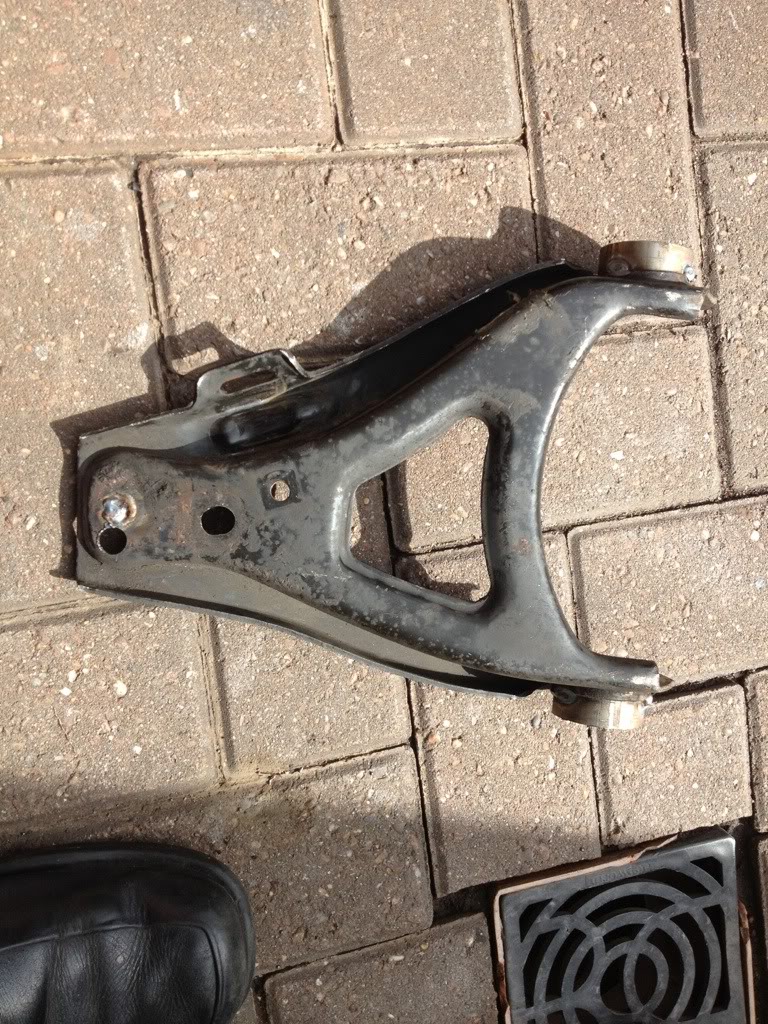

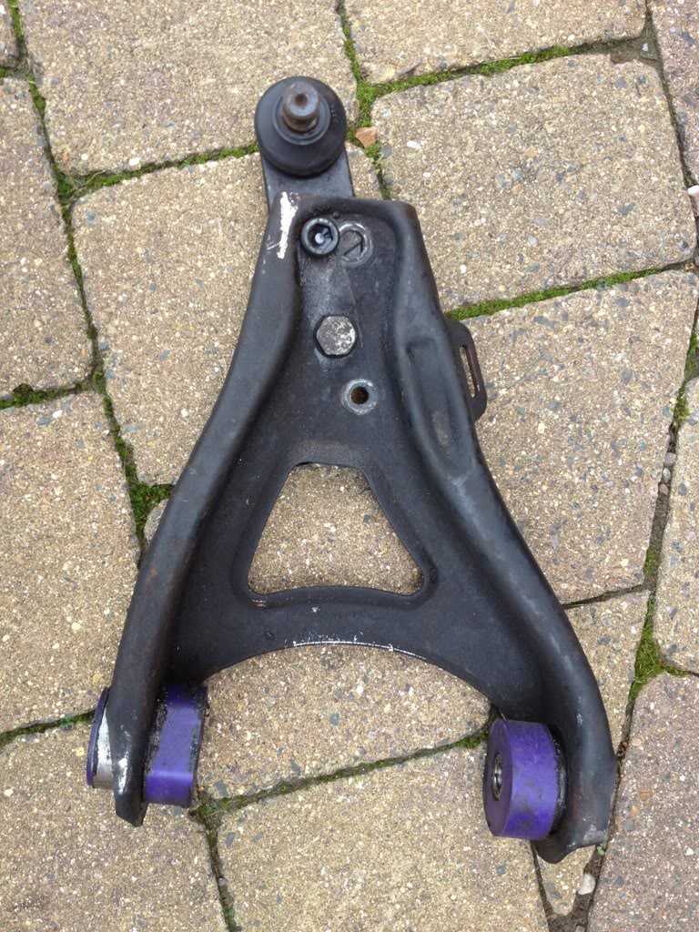

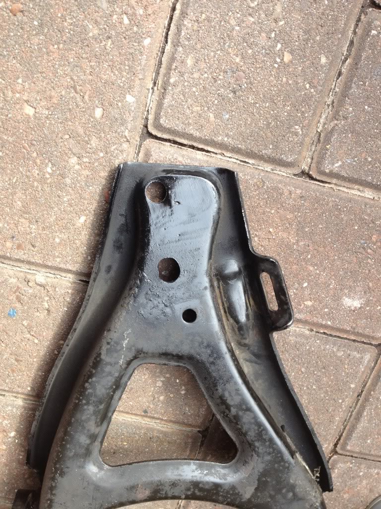

Quick copy and paste from the wishbone thread about the latest handling changes I have made.
It gives 35mm more caster done like I have done it, compared to a ph1 wishbone.
However, you could actually add another 15mm to that if you accepted slightly losing some track, by elongating the inner hole backwards instead of outwards but I didnt want the extra caster enough to compromise a few mm of track width to get it.

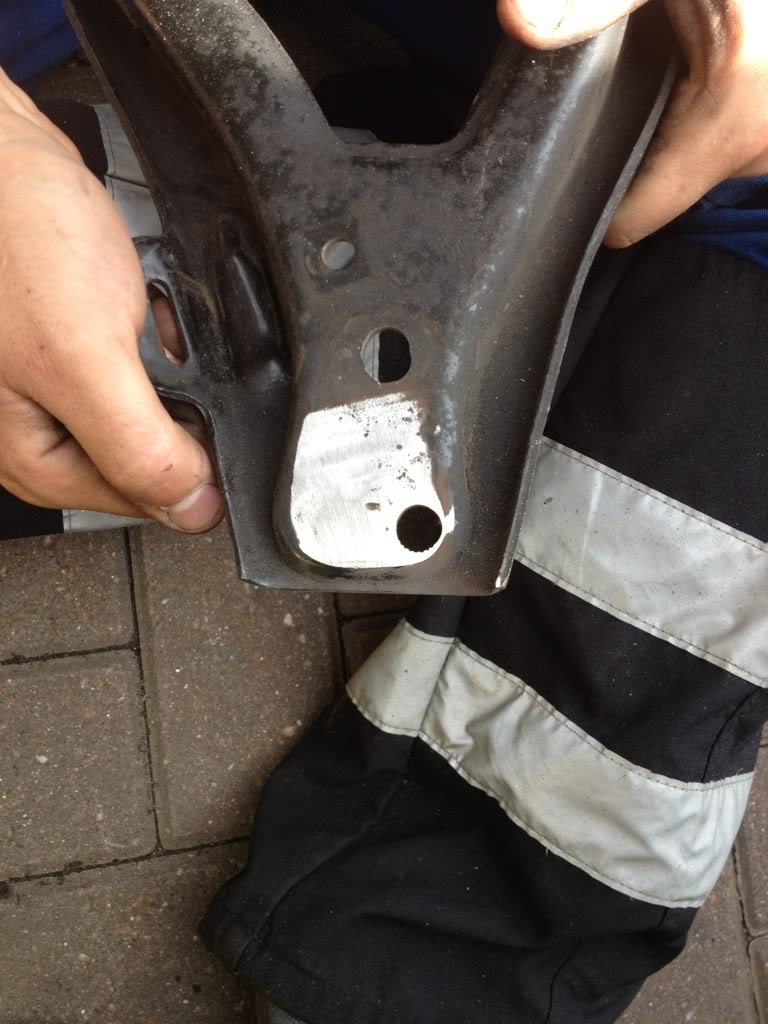

This is how I did it:
Drilled a new outer hole, and elongated the existing inner one slightly, and trial fitted the balljoint both there and in the original place so I could take some measurements.
Then I plug welded the original outer hole (TBH you really dont need to im sure, there was quite a bit of meat between the holes but I can so I did)
Then I used a power file to make sure there were no highpoints that the balljoint might touch and not sit flat
Then I gave it a quick paint just to stop it rusting
Then while I was stood around feeling quite pleased with myself with how it had turned out (Im no fabricator TBH, just do bits and pieces) Mike from MWM who is staying with us this weekend proceeded to do just as neat a job (better if anything) of the other one in half the time, damn him and his expert welding skills, lol
How the end result looks:
Handling feels a lot more sure footed now, its very stable under braking, and obviously I can now run less static camber which is good for straight line grip.
Very pleased with the results although ive got lots of rubbing to sort out.

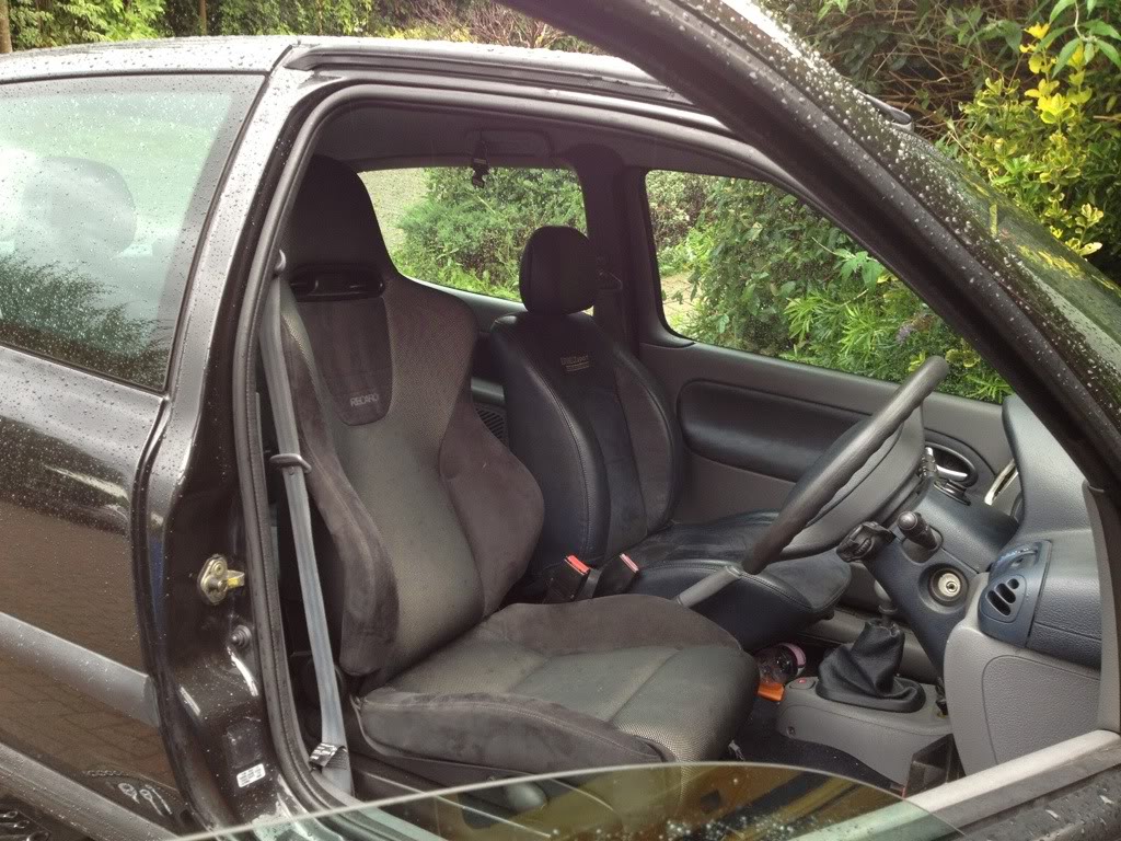

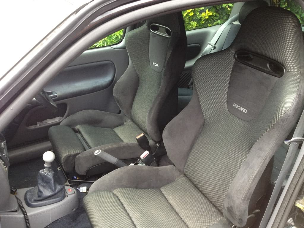

I was looking out for some trophy seats for my mrs RS2 ph2, and found what at first glance I thought was some for sale on here.
Then it was pointed out to me (cheers luke) they werent trophy ones after all as in the pics you could just about make out it wasnt leather bolsters and they didnt have the tip forward lever on them to let people in the back.
So obviously they were no good for that car, but I decided that being non leather (and hence less slippy) was a bonus in terms of for a trackday car instead, so I decided to get them for the turbo.
Was a bit of a trek to go fetch as I had to go and drive right through dartmoor national park where things are a bit "rural" but well worth it.
They really do have just so much more presence to look at compared to the original seats:
