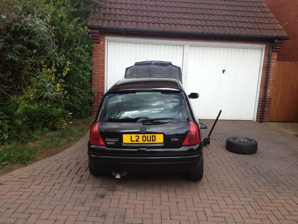

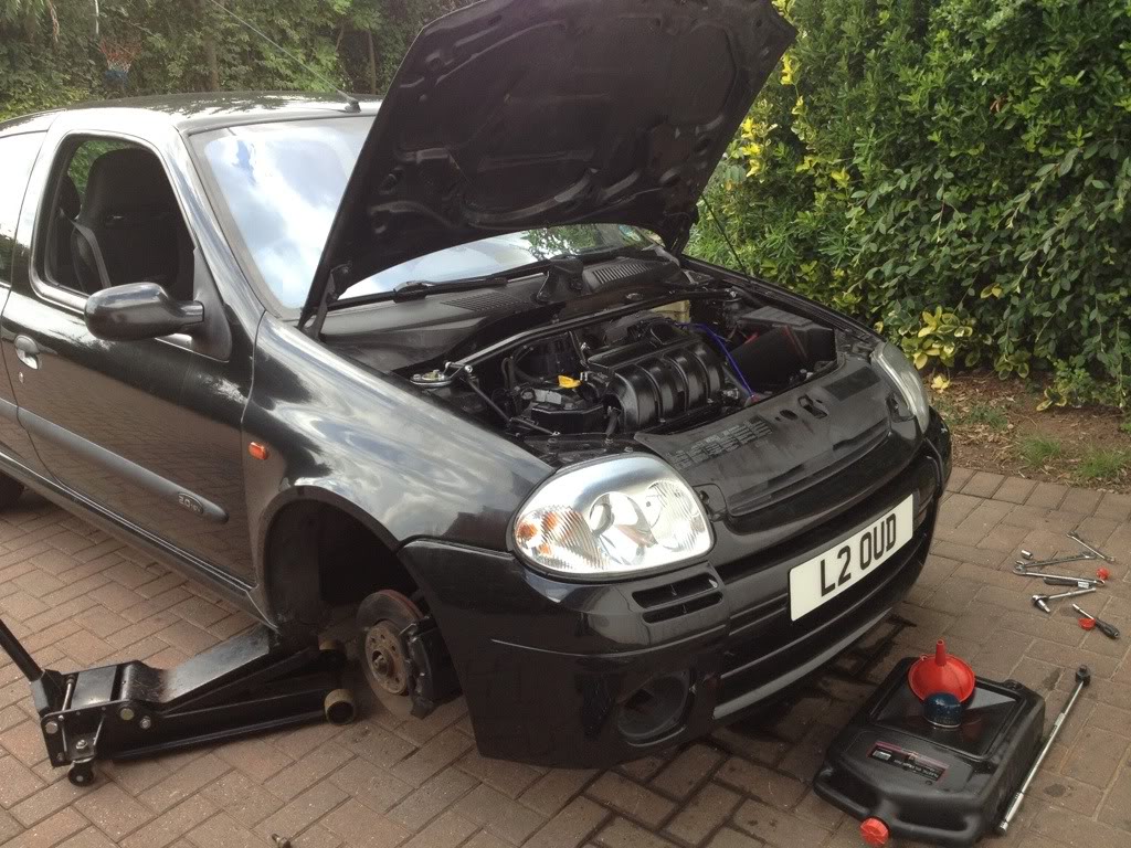

Couple of quick updates, nothing mega exciting though.
Ive swapped to a cup alternator setup now instead of the modified non cup version it was running, just so that its easier to do the belt etc in future.
Have also added some new number plates.

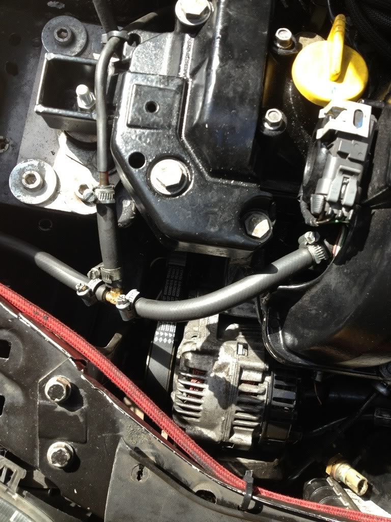

And finally im just making up a return from the oil breather back to the sump, like we use for the Group A rallycar setup on sierra and escort cosworths, as the rings are a bit on the knackered side now so its breathing quite heavy and I dont want the breather filling up on track.
Not got pics of that though, as its not somewhere you can see really plus is only some pipework and not very interesting to look at anyway, lol

Didnt get long out on track at bedford before I got black flagged as I was having problems with the breather setup even after I had modified it.
At the weekend though I made some more changes, including nicking my mrs breather so that i had two of them and routed her one back into the dipstick tube which has totally stopped the liquid oil from accumulating in the breather system now and allowed me to participate without any problems at silverstone on sunday.
