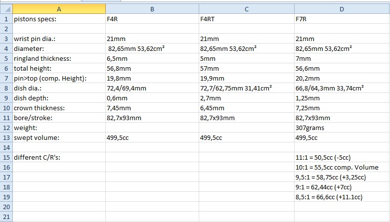

Lol, as for straight line speed i reckon it wouldn't be too hard.
I compared f7r, f4r and f4rT piston next to eachother and judging by the measurements and comparing oe cr's the chamber volumes of the 3 are pretty much the same. The reasona 197 head has more volume is the 197 engine uses domed pistons..
Annoyingly your spreadsheet seems to miss the most important figure. Piston dish volume?
