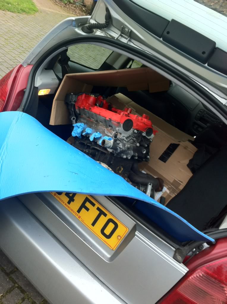

If you are going to get the cam cover powder coated, mount it on some board first and plug the holes so no blast material gets inside it, and cut down an oil cap to plug the hole with.
This is from my williams engine, but same idea:
Can be a right nightmare cleaning them out otherwise.

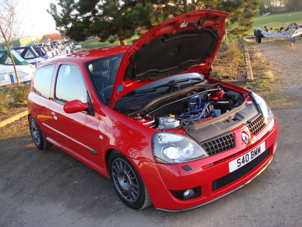

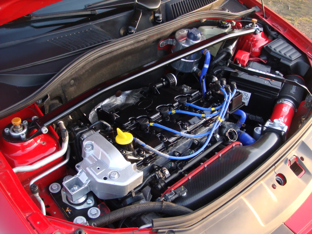

Here are a few pics, please excuse the dyno rod red cam cover. Just want to thank mick@diamond motors and rob91 for all your help. The engine feels brilliant! I cant however thrash it because of the map so looking forward to the beginning of next month!
Pics
sneaky diamond motors sticker ;)
And the engine in!
I am going to do the cam cover anodized red and all the ancillary parts high gloss black this time! Off to pick up a pipe to relocate the air filter in the front bumper aswell so no more front fogs either.
Thanks for looking.
James

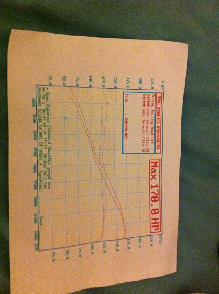

OK so the new engine is in and its mapped!! 187.9bhp with a restrictive sports cat and with a stupid air filter setup in the bumper, so according to the boys its be as near as dammit 190bhp with that sorted.
When ive fitted my new airbox ill go back for another power run!
The throttle response is incredible and the linear power has transformed how the car drives! All in all, highly recommended!
Thanks again Mike and James!
