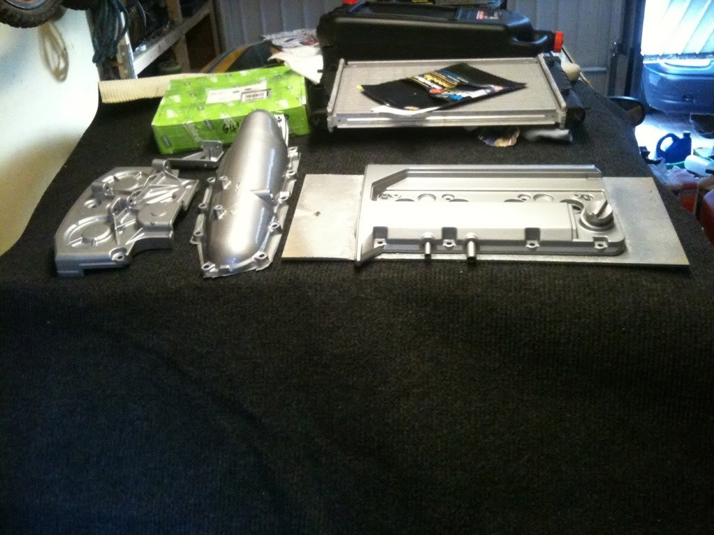

Have you had any experience with this Chip? it looks pretty good in all honesty! Im very tempted to get a few cans and do the cam cover and cage in it!

No mate, Im not really into painting stuff TBH I normally just get things powder coated cause im lazy, it was my Mrs that did ours in paint so I'll ask her but I dont think she has used that particular one either.
I personally would be skeptical that an anodised style finish would look right in paint, so only advice I can offer is buy a can and try it on something that doesnt matter.
Yeah they can be proper money/time pits if you let them!

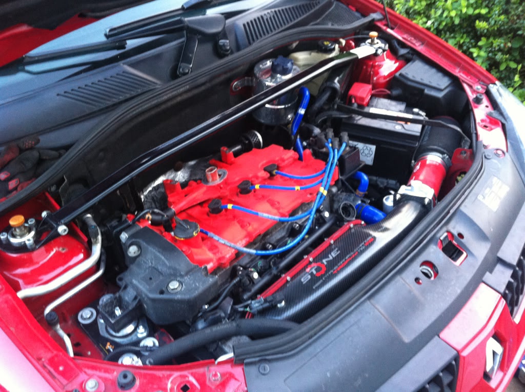

Looks awesome mate!
Awesome to see its all sorted and quickly too.
Been looking at the Anodized effect paint myself, not used it but have used other paints in VHT's range and they're awesome.
Looks great mate, will definately see you at CS Saturday, perhaps we can try and park a few RS2's cars like yours and ours together?![]()
OK so the new engine is in and its mapped!! 187.9bhp with a restrictive sports cat and with a stupid air filter setup in the bumper, so according to the boys its be as near as dammit 190bhp with that sorted.
When ive fitted my new airbox ill go back for another power run!
The throttle response is incredible and the linear power has transformed how the car drives! All in all, highly recommended!
