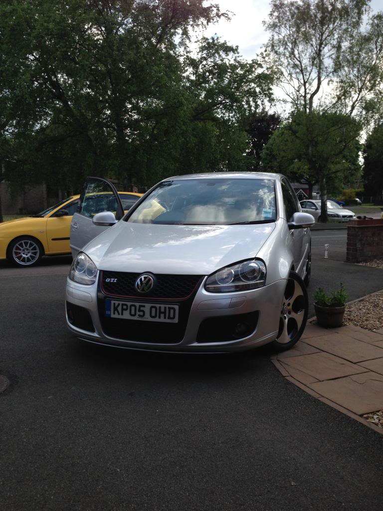

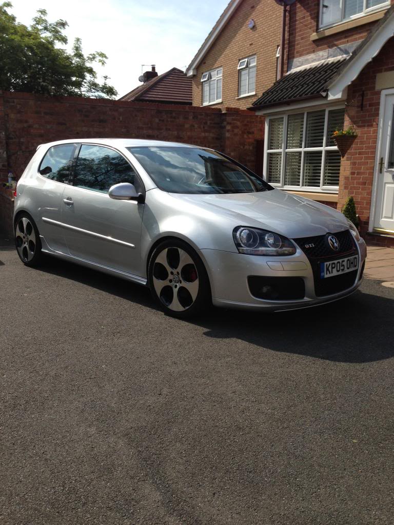

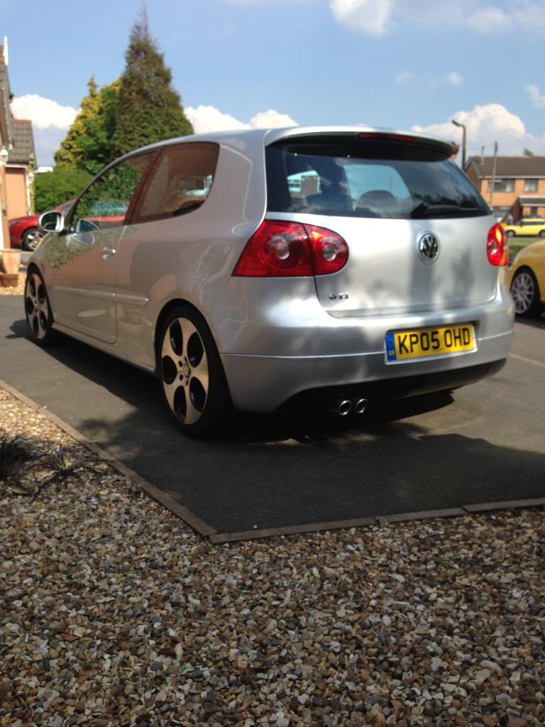

Hi all, sold the 182 about 6 weeks ago which has been replaced with this..
05' golf gti on 66k with full Main dealer / specialist history.
spec is as follows
Reflex Silver
Monza II's
MFSW
Xenons
Coming home lights
Automatic lights and wipers
ED 30 front bumper (I think?)
Black Headlining
Cooled Glovebox
Hidden Aerial
Plans are for some H&R springs, wheel refurb, front mount intercooler and a map
C&C welcome!
Cheers

Really like that mate. They look proper fresh in Silver and the right bits have been painted. :)
Are those aftermarket Monzas? Either way I love them. If you get the refurbed keep the diamond cut face and get them lacquered they look superb.

Wheels let it down big time, needs ed30 wheels!
It looks much better with xenons too.

Cheers, really happy with it!
Nope they are genuine bbs monzas :) I like them too, however judging by the comments they are a marmite wheel.
  Alfa GT Cloverleaf
definitely not reps, unless someone has stamped the inside ;) I'd love some pescaras! hard to get hold of for the right price though

The best car you could buy for the money. Absolutely love mine! Not sure about the Colour Coding/ Wheels on yours but tidy none-the-less! And the front bumper is colour coded, not ED30 (Im pretty sure anyway).
Get yourself an AutoTech intake, and do something with the exhaust. They sound awesome!

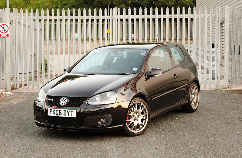

Managed to pick up some genuine bbs pescaras in mint condition for a decent price so just waiting to receive them.

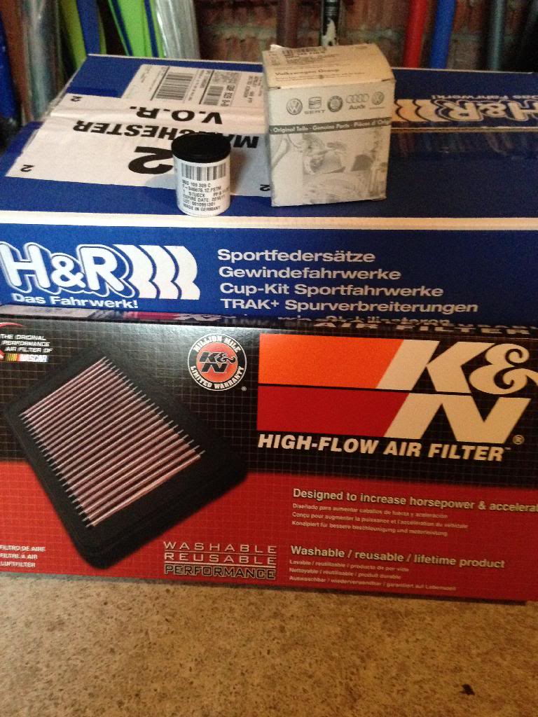

Had the GTI in at Tuning Developments over the weekend while I was over in the Emerald isle :)
Quite a bit of work done:
Front Mount Intercooler & Hard Pipework
Rev G Diverter Valve
Replaced Cam Follower
Replaced PVC Valve with the newest version
H&R Springs
Live Remap
Before the work the car made 163 BHP and 183 LBFT due to the boost leaks from the DV and the shitty intercooler pipes. Once the everything was fitted and the map was done it made 230 BHP and 300 LBFT. So quite a difference! Feels like a whole different car, There is power no matter what gear you are in and no matter where you are in the rev range. Money well spent im sure you will agree!
Next on the list is a RARB and Polybushes all round, And to of course get the Pescaras fitted :)

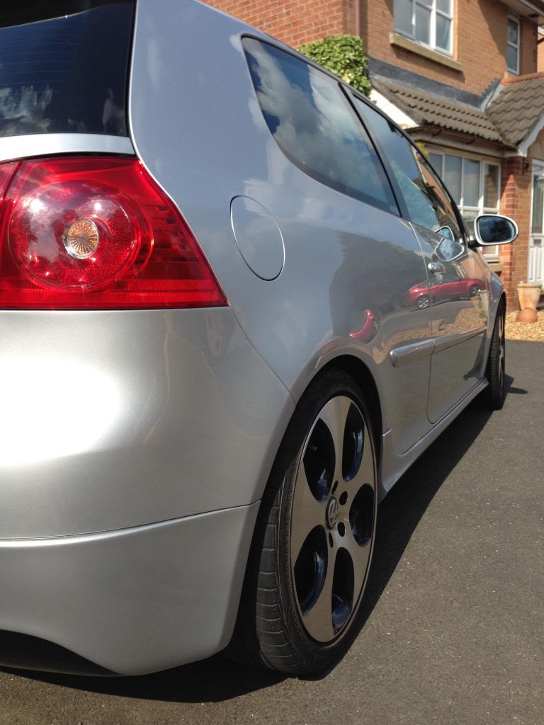

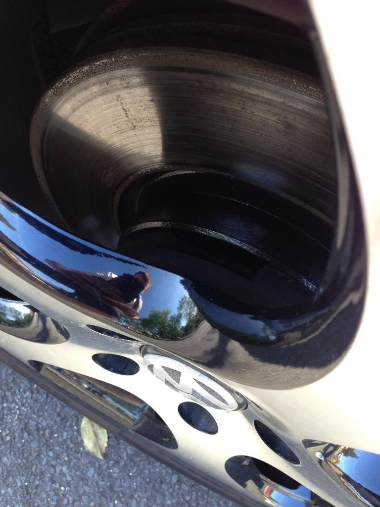

Over the weekend I managed to paint my wheel hubs as they were looking a little worse for wear! I forgot to take some before and after shots (as usual) So just got one after the wheels were back on lol

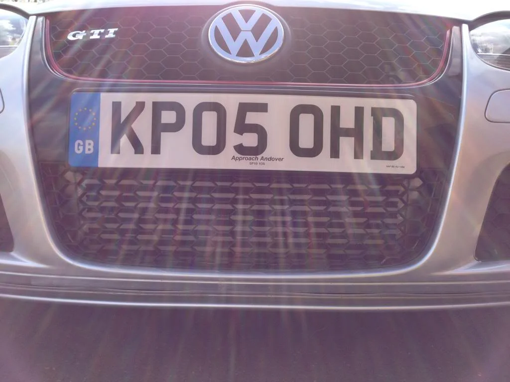

Also tried to get a snap of my new intercooler. I think it sits well, hardly noticeable but can be spotted by the trained eye!

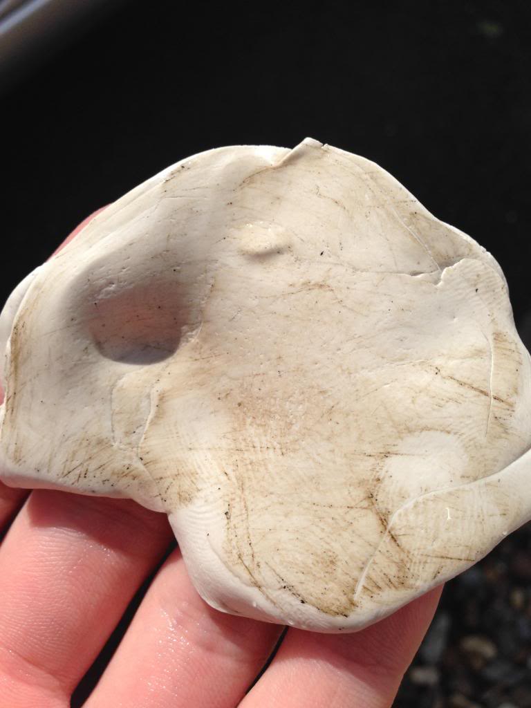

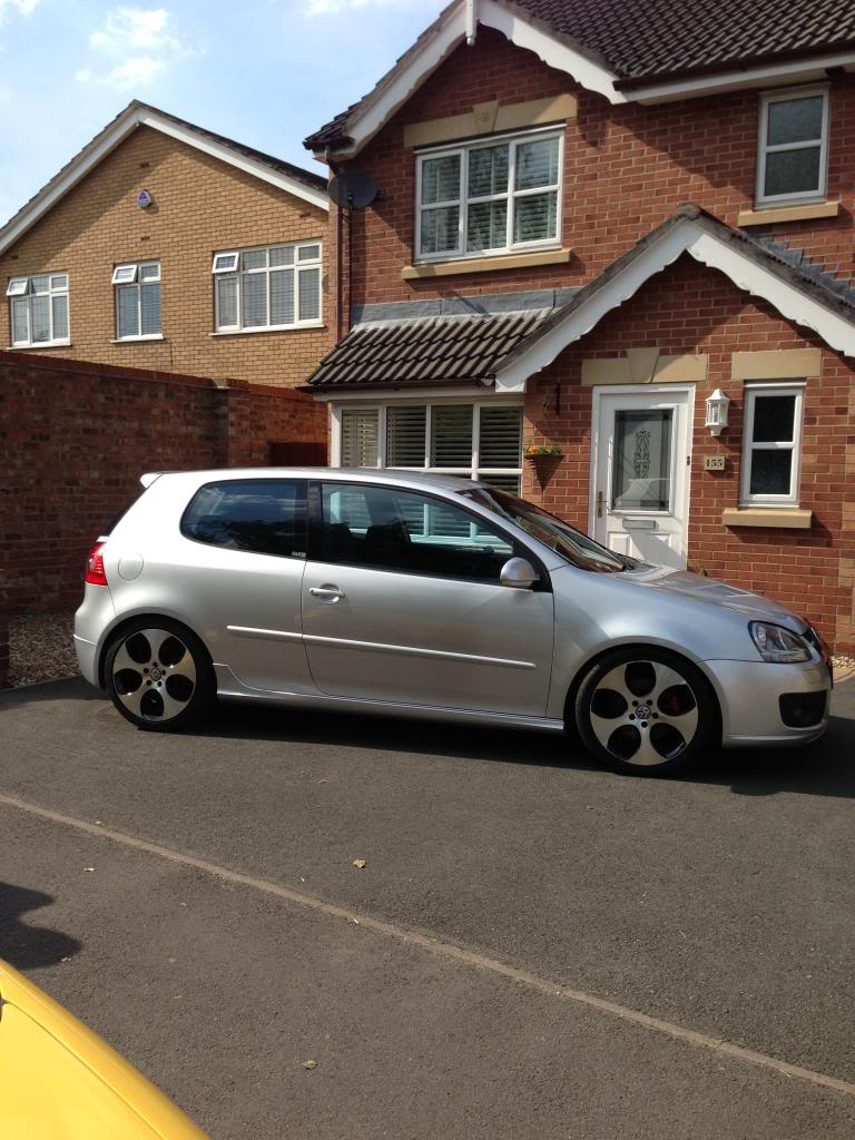

While the weather was nice yesterday I managed to give the GTI its first detail of my ownership which consisted of : Wash, Clay, Re-wash, Machine Polish with AF Tripple, Hand apply Poorboys White Diamond, Hand apply Poorboys Natty's Paste Wax. Silver is quite a hard colour to achieve some depth with but I think it came up really well!
The pics show it sitting on my new H&Rs I had fitted a few weeks back, I'm really happy with the height and the ride, personally I think the rise is better than standard.
Since I bought the car I have also fitted a Rev G DV, Replaced the PVC and cam follower, fitted a FMIC with hardpiping, replaced the cambelt & water pump and had it remapped. Before the work was done it made 163 bhp and 187 lbft and once everything was done it made 230 bhp and 300 lbft. so rather pleased with the results, the car drives 100X better and mpg has slightly increased!

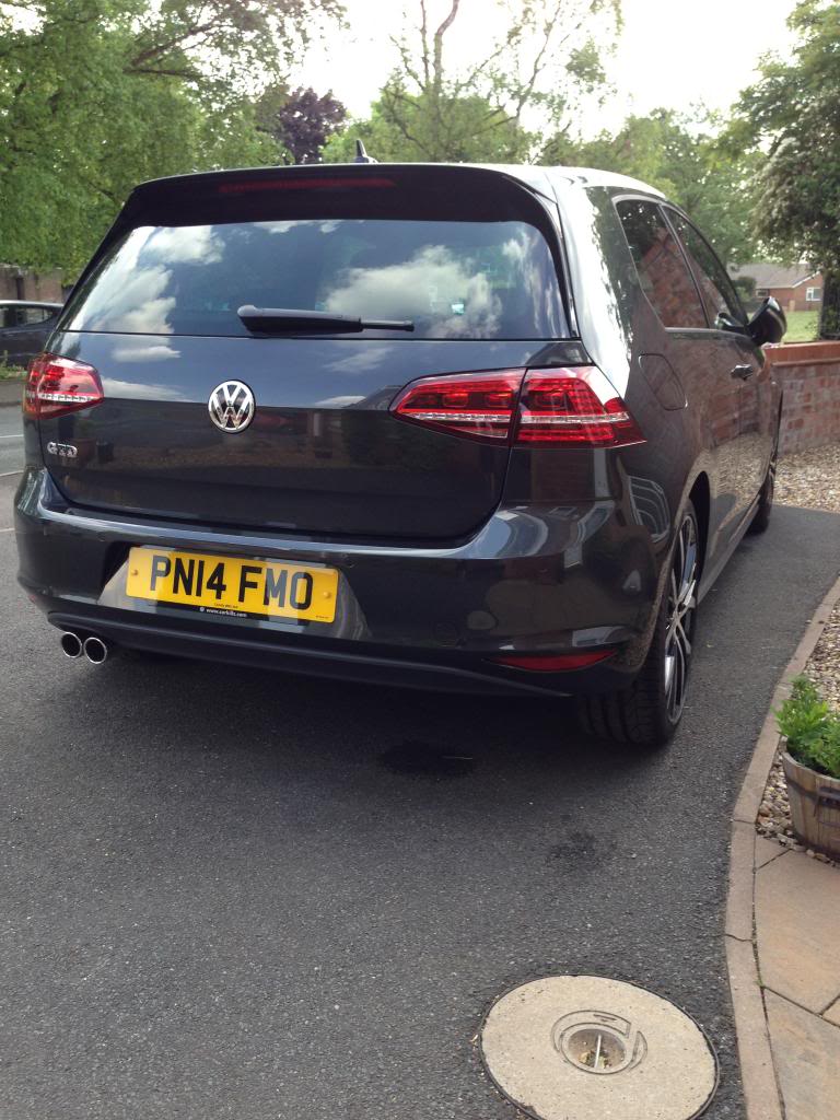

Lastly a few cheeky shots of my Dad's Mk7 GTD
