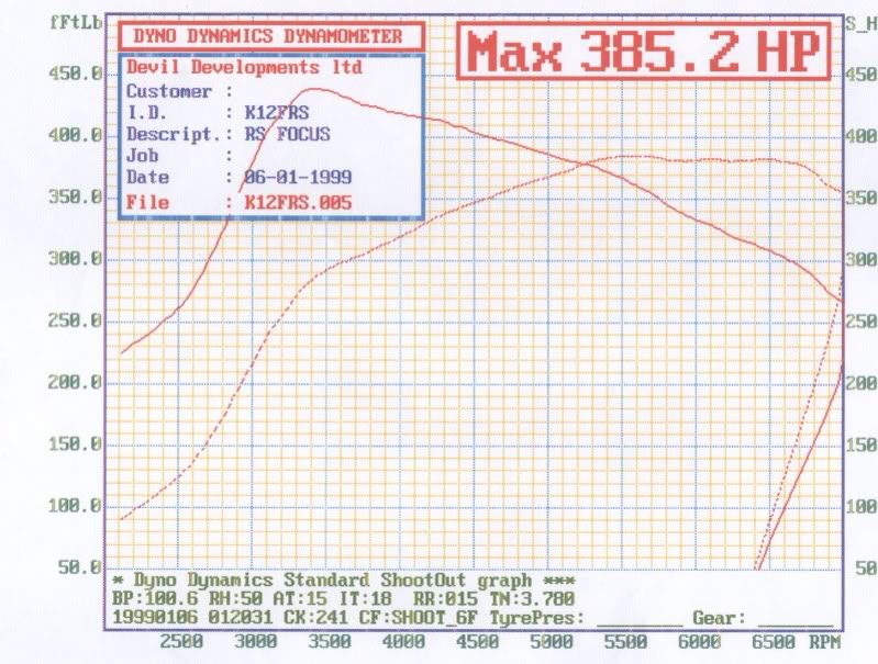

Ah gotcha.
it hit peek torque at 3350 - 3400rpm.
And looking at the other references Dave added, the lbft and BHP do actually cross over as near as damnit at 5252rpm.

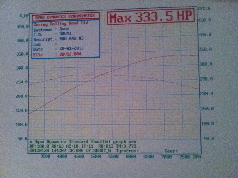

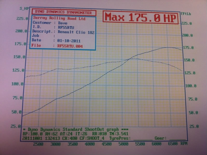

Just checked a few of my graphs as well, feel like ive learnt something tonight!!! Circa 5252rpm crossover for both:
M3's have such a beautiful curve ...
And the ShedTrophy (now Kelvs):

From reading that article, power is calculated as:
Bhp = (Torque x rpm) / 5252
Dave, your equation is pretty much spot on indeed.
440lbft or converted to 596nm.
596x3400 = 2,026,400
2,026,400 / 5252 = 385.83 BHP.
im suitably impressed, that my new lesson for the evening.

Guys, in ref to my graph, I'm sure at some point this morning Chip will add a more understandable answer and reasoning as to why the type of engine peaks like that.
but from experience, it's never been that rare to have an already torquey engine which is also turbo'd to hit its peak torque that low down the rev range, obviously as it tails of and the horses rise it still crosses over, which still seems to be at 5252rpm.

If you quote the rpm that torque was made at then it is a simple sum to find bhp at the same point, but generally peak power will be later than peak torque not at the same point as it (peak power can NEVER be at lower rpm than at peak torque)
so on dans for example the 143lbft peak is at 6370rpm at which point it only makes 173bhp, but with the torque not dropping as quickly as the revs are rising it means that it makes more power further up. Its making just under 136lbft still at 7740 in order to crack 200 for example.
Think of torque as the amount of work done in one revolution of the engine, and bhp as the amount of work done per unit of time.
So as an analogy if you were moving water uphill on a machine with cups that scoop up water the torque would be the size of the cup you were using, the rpm would be how many cups were filling per minute and the bhp would be how much water you actually had the power to move in a minute.
So torque is only useful when connected with speed too, give me a 4ft bar and I will happily generate 200lbft of torque with my bare hands but I won't be able to do so quickly enough to power a car. Lol.

It peaks like that because the turbo and engine spec aren't suitable for making torque further up the rev range. You get to the point the turbo is flowing pretty much all it can, at which point the bhp will effectively flatten off, at which point torque drops at the rate rpm increases. Wrc engines with a restrictor do this massively, the bhp just totally flat lines and the torque falls off inversely as rpm increases.
The key factor in deciding acceleration is torque at the wheels divided by the mass of the car (f=ma) and torque at the wheels is directly related to bhp of the engine as the gearbox allows you to gain mechanical advantage to mean that 100lbft at 8krpm is twice as much torque at the wheels as 100lbft at 4krpm.
A current f1 engines makes roughly 3 times as much power as torque!

Never seen curves like that before. What was that like to drive?
Pulls like hell initially then as revs rise it just feels like it does on its arse and the engine just doesn't really want to go. I hate engines like that for track use, diesel turbos are very much like that.
In a 4wd car or something big and with lots of grip like a new focus rs and it's not so bad but put an engine like that in a lightwieght trackday fwd hatch like a clio and it wheelspin at peak torque then as you back off a bit to regain traction it starts to pull a bit then just dies. Hateful!

Chips given a perfect example. With this new information people should now understand why peak torque is relatively useless to brag about on a forum with and why the RS2 having such a supposed "flat and boring" torque curve is actually epic!
  XC90, 330d, Trophy’s
TBH Chip, it pulls like an absolute train, agreed the initiall kick up the arse that you get as it comes on boost does tail away as the revs rise, but the thing certainly doesnt ever feel like it wants to give up going.
once its conquered its attempts at pulling the front tyres apart and you start to gather mommentum, its all to allarming at how quickly the end of the speedo seems to be aproaching.
if you hadnt already gathered Chip, this is the graph for the green frs.
its about 4 weeks after i bought it, and Rob @ SCC fitted the upgrade kit from Revo, a few more treats have been added since but never bothered heading back to the rollers.
Having driven lots of cars with similar graphs, I actually disagree with you there, thats almost an identical graph to a typical T34 Escos for example.
Obviously you have the fact that it a 2.5 turbo so even when its "died off" its still got more way torque than a n/a clio is ever going to etc, so its a relative term but there is still a very noticeable drop off in how hard it pulls further up the rev range than lower down, so although the car is still quick the engine is certainly less willing to go at high rpm than in the midrange.
Put in up a hill in 4th at 3Krpm and floor it and you'll notice what I mean.
