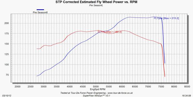

Looks good yeah, although the torque does tail off from 6K onwards it doesnt do so by a huge amount and is still at a very good 150 even at the limiter.
Looks like a decent 421 cams and bodies engine for an F4R so I assume its the one in your racer?
As I mentioned earlier in this thread to both Nick and Kelv, personally for an N/A racecar or trackay car I think ITBs and cams are the only sensible option for a clio.

Interesting as the RS2 torque curve follows that of no diesel car i have ever seen :/
The sensation at low revs is similar. It has a slight 'waft' of thrust when dragging the car up from low rpm. Much like the low end peak torque of a TDI.

Would imagine me means that relative to a standard clio it goes well at low rpm, although I do a agree with you laine that its certainly still no 535D, lol
Still waiting for you to point out on J's graph by the way where you think the RS2 doesnt work to increase torque Laine?
Or would you agree that its made gains in torque for the entire rev range compared to the standard car as shown on that graph?

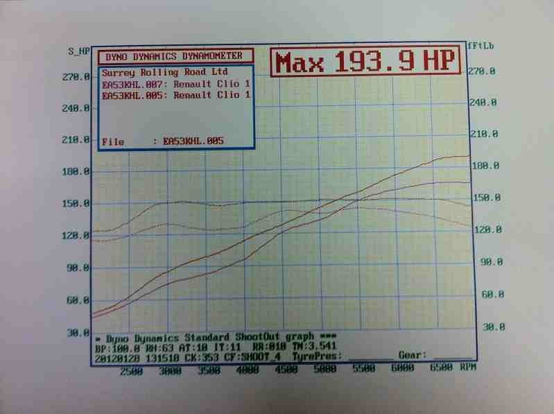

IF it made 150ft lbs for the rest of the whole rev range with just a set of cams on a standard inlet, then it would be great having the extra peak power and getting the spread of torque as well, but that doesnt happen. IF it did, I would buy some for sure and sell the RS2, or better still use the magic cams with the RS2 as welll!
Even Laines freaky cup when he cammed it was down to under 120lbft by 7800rpm I would wager, so not exactly ideal on a trackday and the fact it peaks at 168 or whatever in the first place makes it feel even more like it has died, dont get me wrong it wont be any slower than an rs2 car, but personally I find that sort of "heres loads of torque, now im taking it all away again" a more frustrating way to make the same progress than "here is a moderate amount of torque, and you can keep it as long as you want".

I have 438's in mine, 190bhp & 162lb ft peak, from 3500 to 6500 its above 150lb ft. Granted from 6500 to 7500 it drops like a stone to about 125lb ft and from 2500 to 3500 its around 135lb ft. (those figures are from memory because i can't find the graph, will see if i can get another copy of it.)
I've been dying to try an ITB car as im very interested in getting them next, just can't find anybody local willing to let me drive one! I got cams over an RS2 because my car needed to go in for a full service + cambelt!

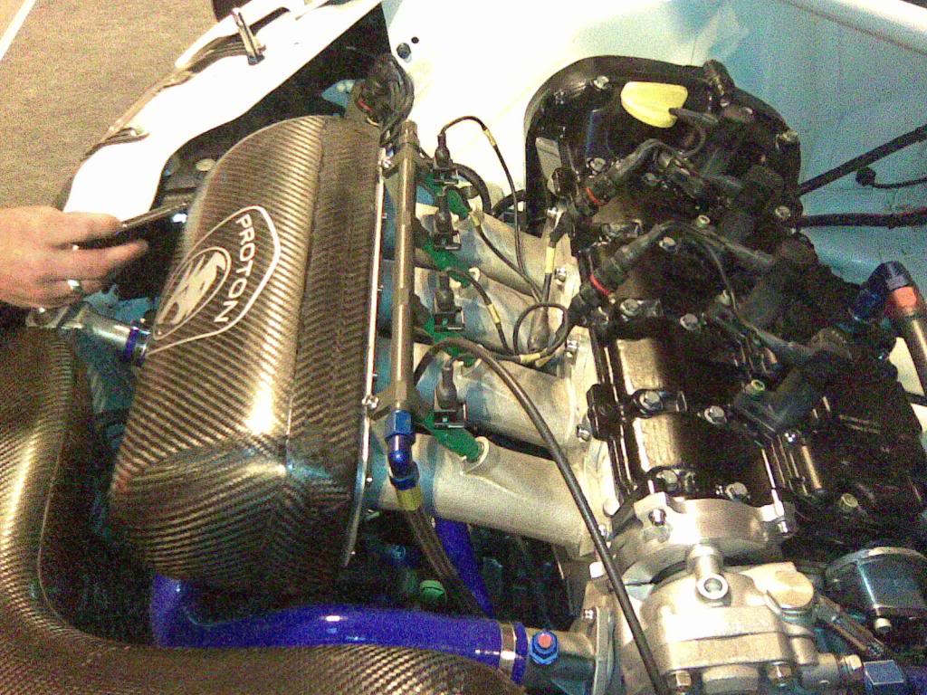

It all sounds fairly simple.. How much would you benefit by fitting longer trumpets to an RS2 manifold if you removed as much out the way as possible.. Slam panel, Rad etc??
Would the cost be worth the gains?
IMO you wouuld have to make the plenum bigger too

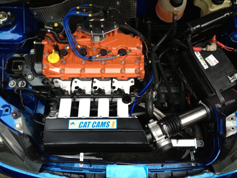

Bigger plenum and longer trumpets you say?
In parts this thread has been very interesting but I hate slipping through all the unnecessary clutter.
Our torque curve drops off at 7k with our inlet. However, not sure if this is partly due to the lack of ignition advance due to very high compression? Iirc it's only running 13-16 deg adv.

Yep. Well, home built is doing it a little injustice to be honest;) laser cut plenum, one off runners mated to jenvey mr23 manifold. 45mm internal runner dia with trumpets to suit.
  BMW 330ci sp/ 172Cup
Sorry Mike. Missed your post. We think its running around 13:1. Possibly more. Didn't know how much the head had been skimmed:-S
we are toying with E85 conversion so we can get the advance where it should be. Do you think advance will improve output by a great margin?
