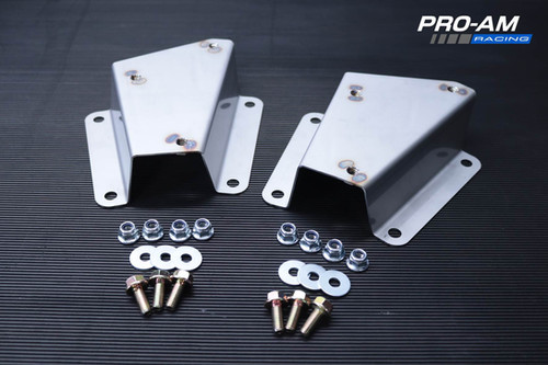

Get some of the rear exhaust hanger mounts from @Tomotek aka Pro-Am Racing.
Nice bit of stainless steel instead of rusty metal.
Thanks James - I may still do that however they came out 'ok' after a dip plus some grinding, welded up a crack and then epoxy coated them. Basically I should have just got some nice stainless ones and saved the time :rolleyes:
Flob
I refurbed the standard factory ones on my first back end rebuild. However I plan to buy the Proam ones for my new car. Proper beat solution to the original cheese ones sent out of Renault
Do you know how much they are? I saw some sheet metal ones on eBay for £110ish but don't think they were stainless
Should be mint then really.
If i ever need to touch mine, i'll be going the stainless route for the sake of £40-50 whatever they are.
