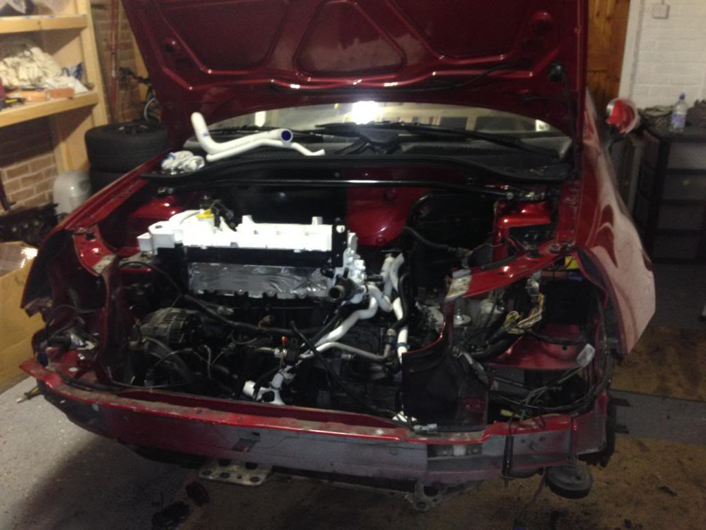

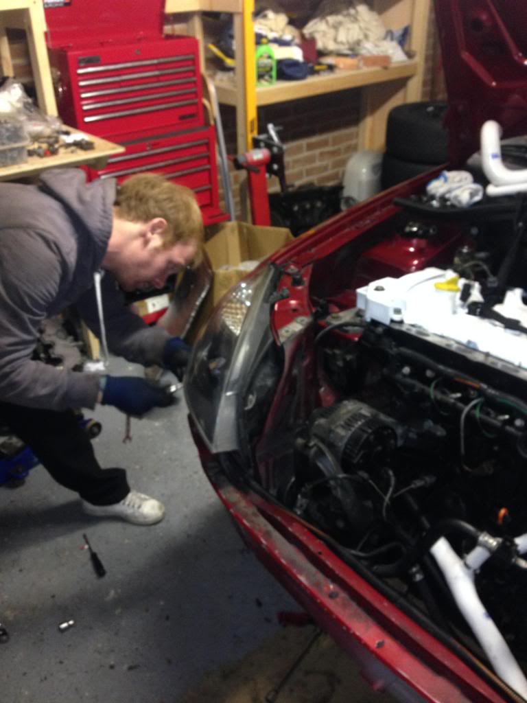

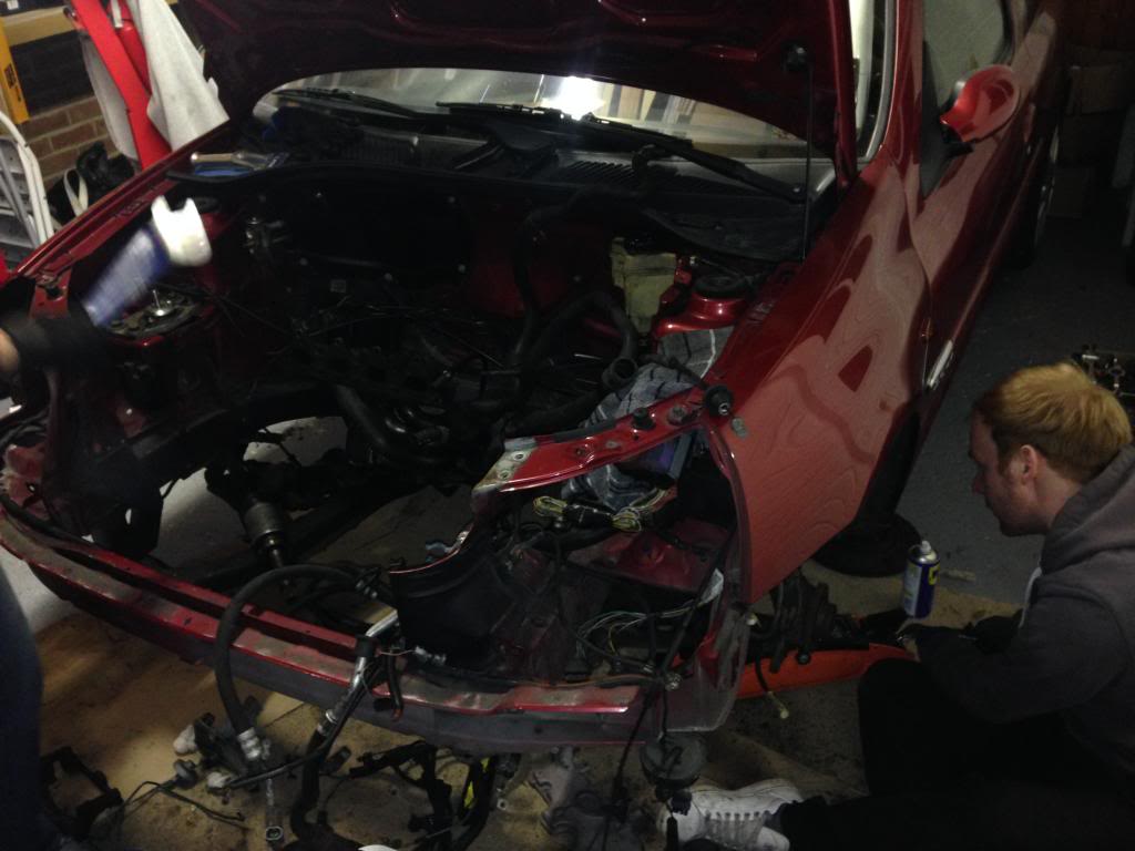

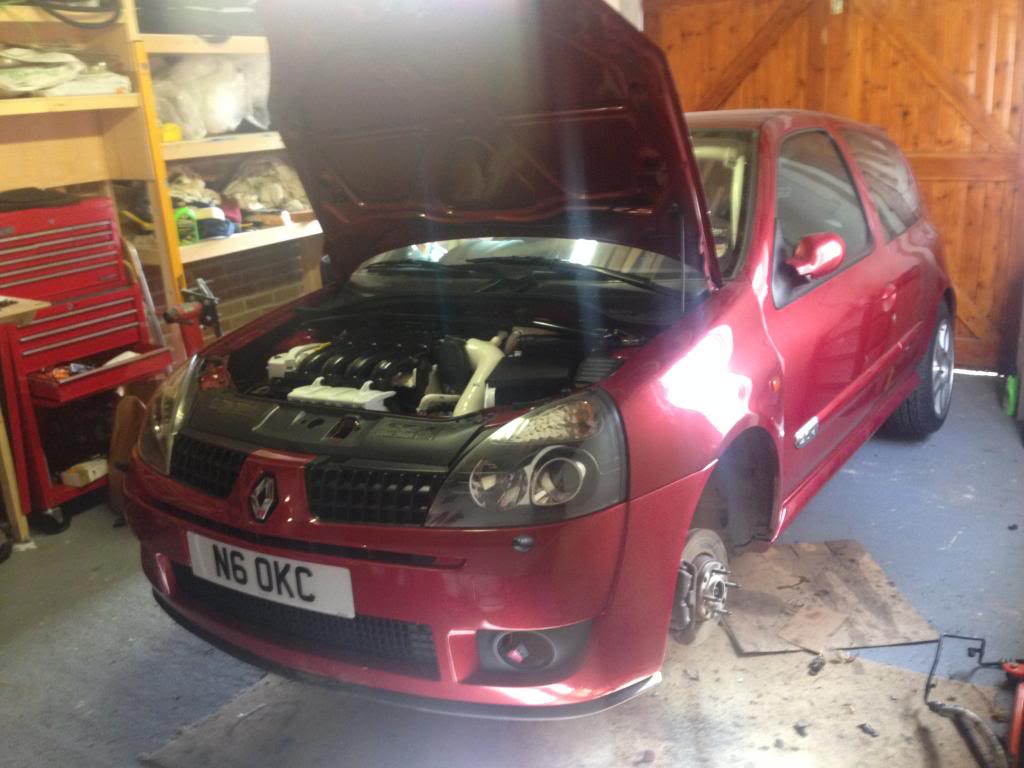

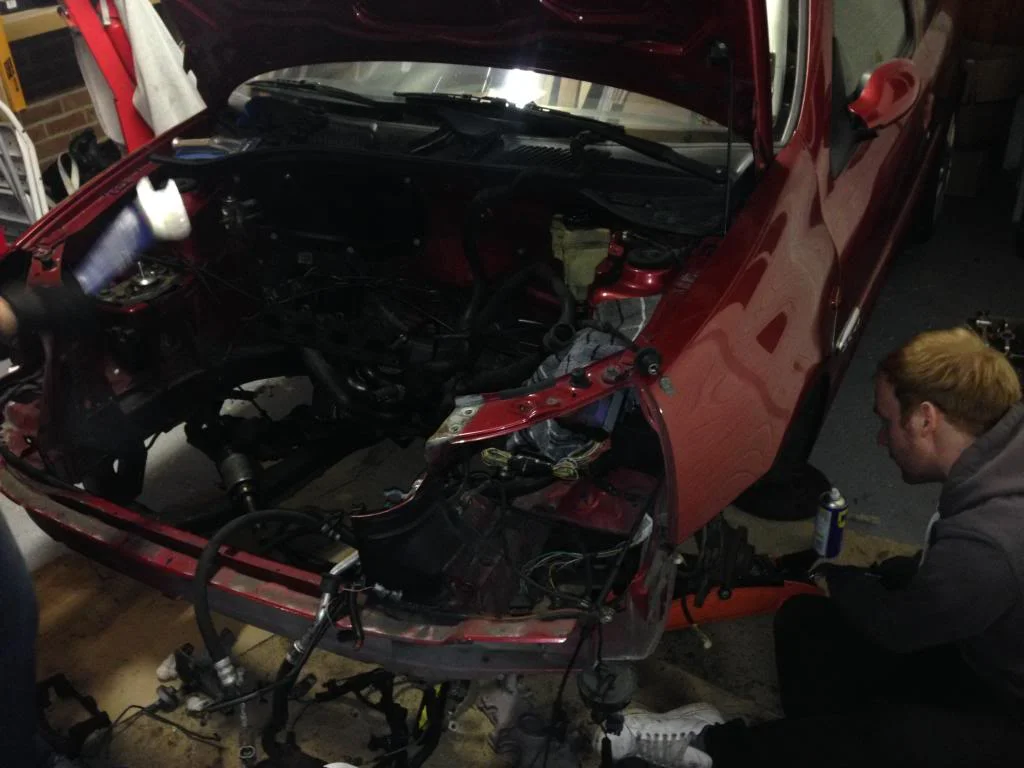

So, Friday at 17:00 the fridge looked like this, awaiting Burgess and Herbertez' arrival;

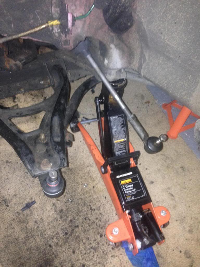

So the guys arrived and we opened the first of many beers and cracked on getting the engine in, and a huge job list. I don't have photos of everything as I was actually getting me hands dirty at times this weekend :) First up;

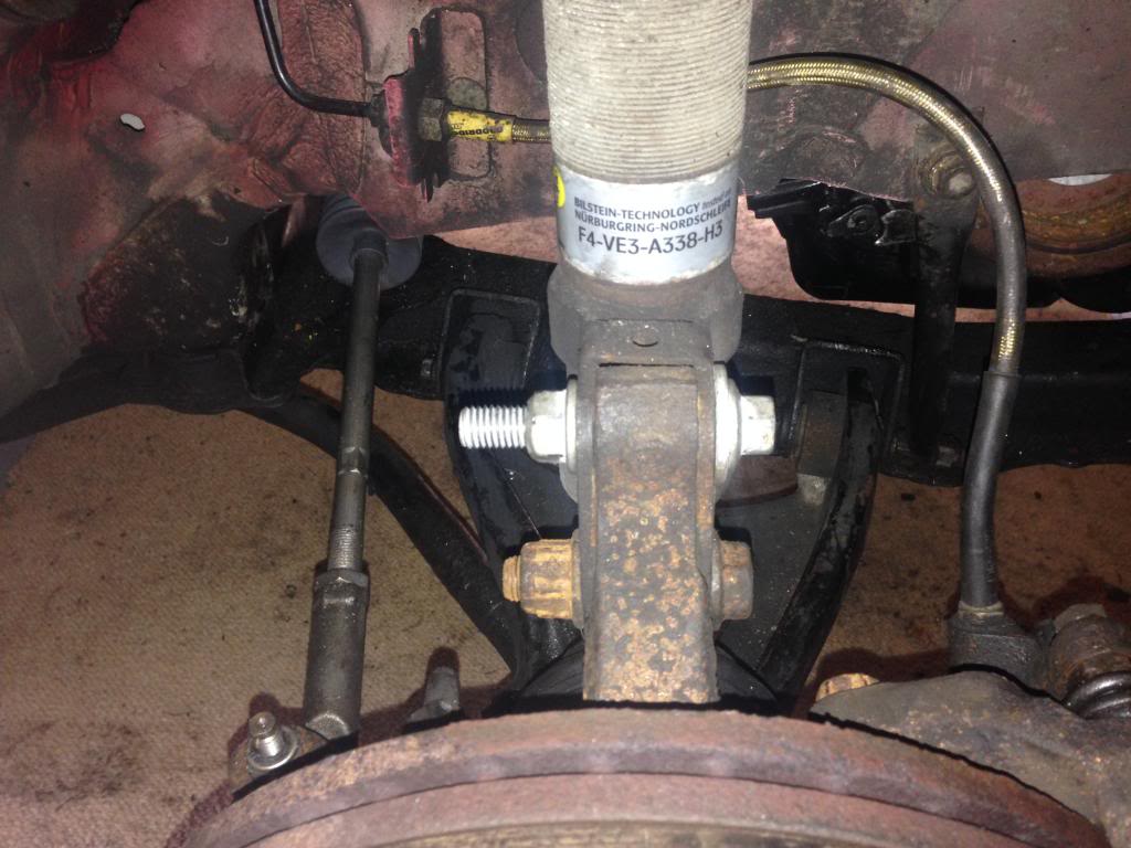

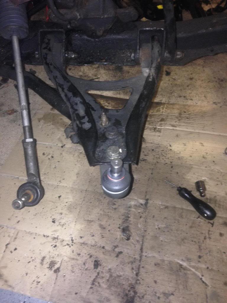

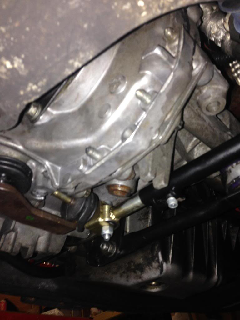

- fit Cup Wishbones
- new ball joints
- new track rods
- new track rod ends
- new steering rack bushes

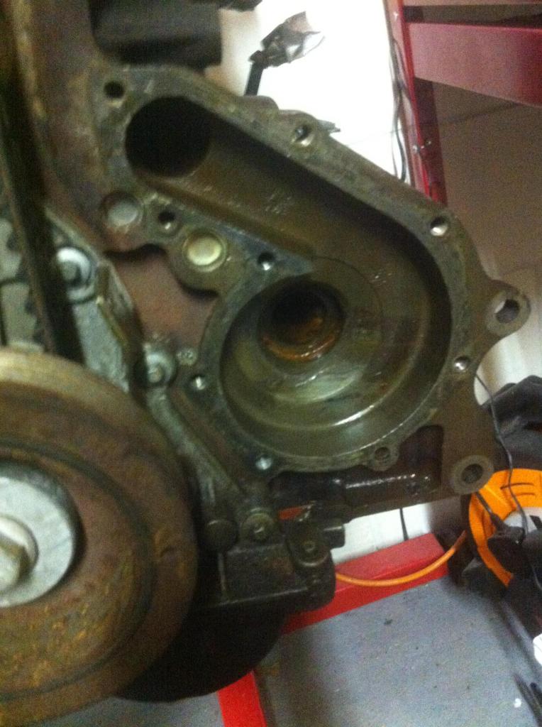

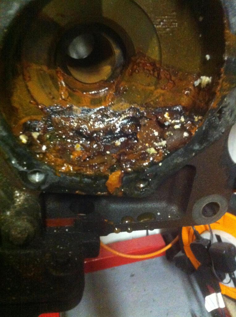

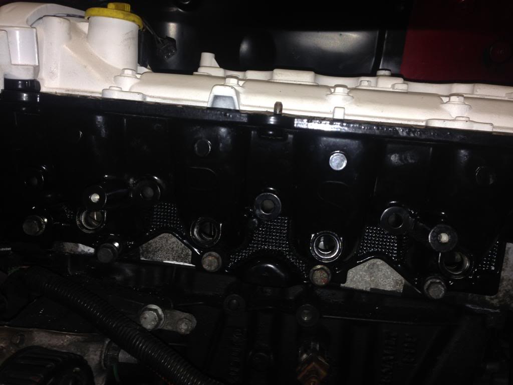

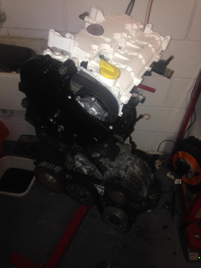

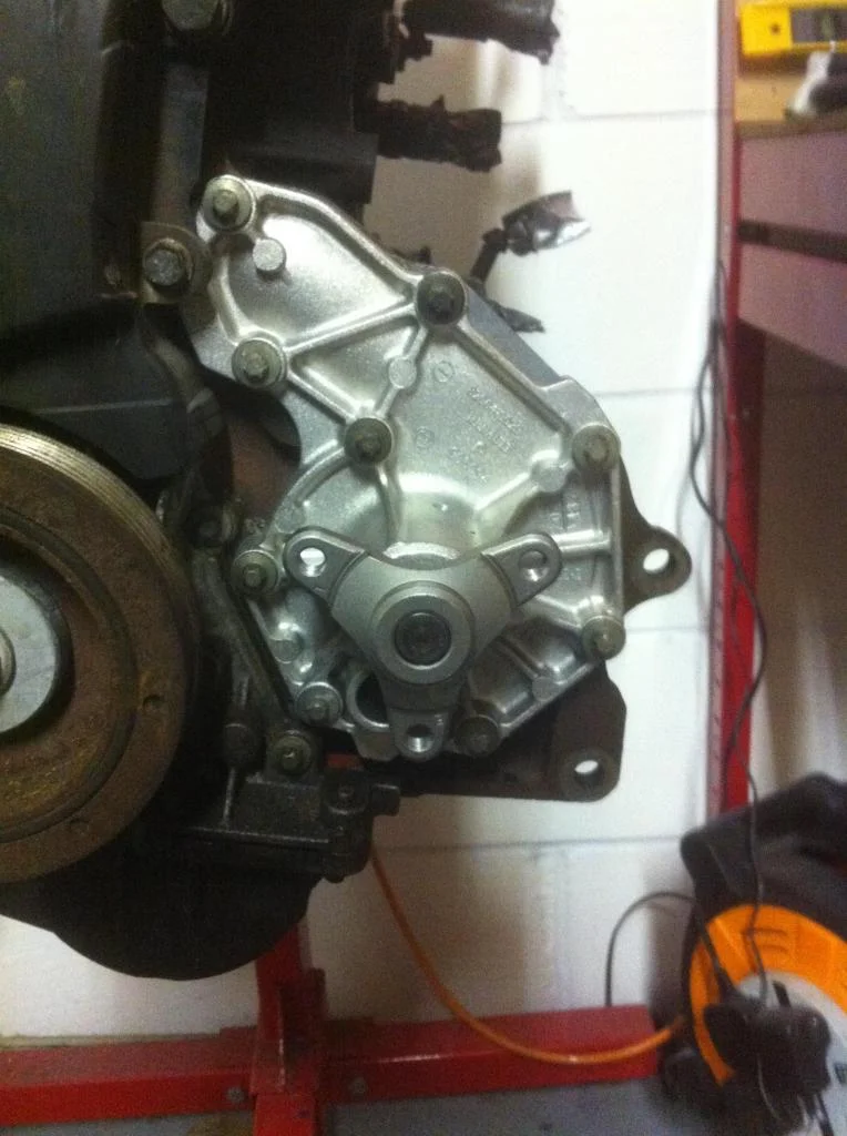

We then cracked on with building the engine back up. So this was the water pump. Lovely;
Cleaned up and new waterpump;

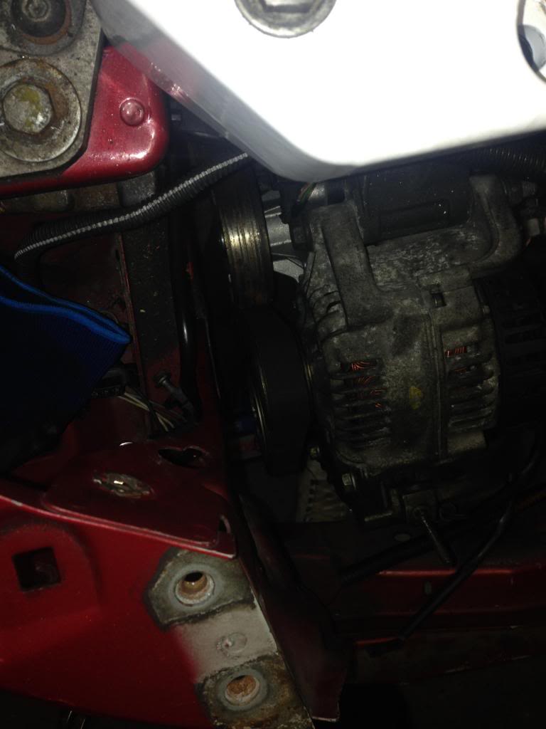

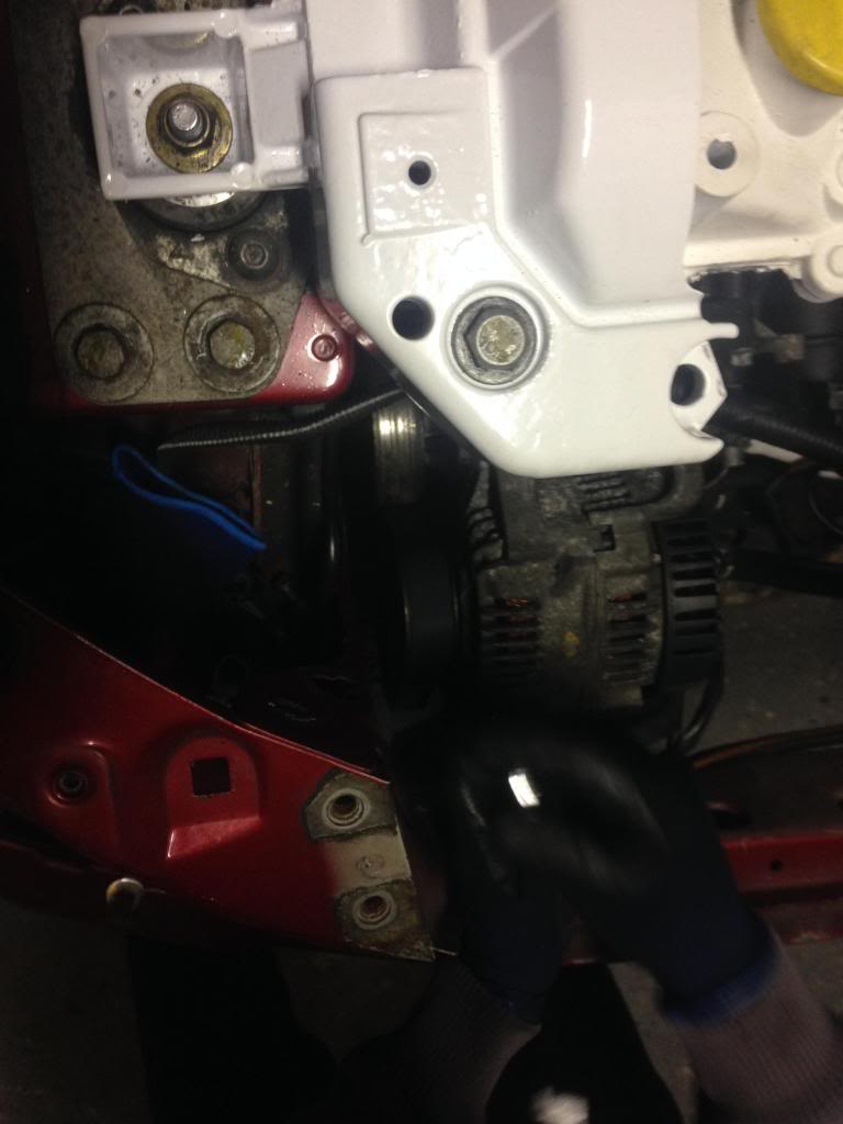

Alternator and aux belt on, spark plugs in;

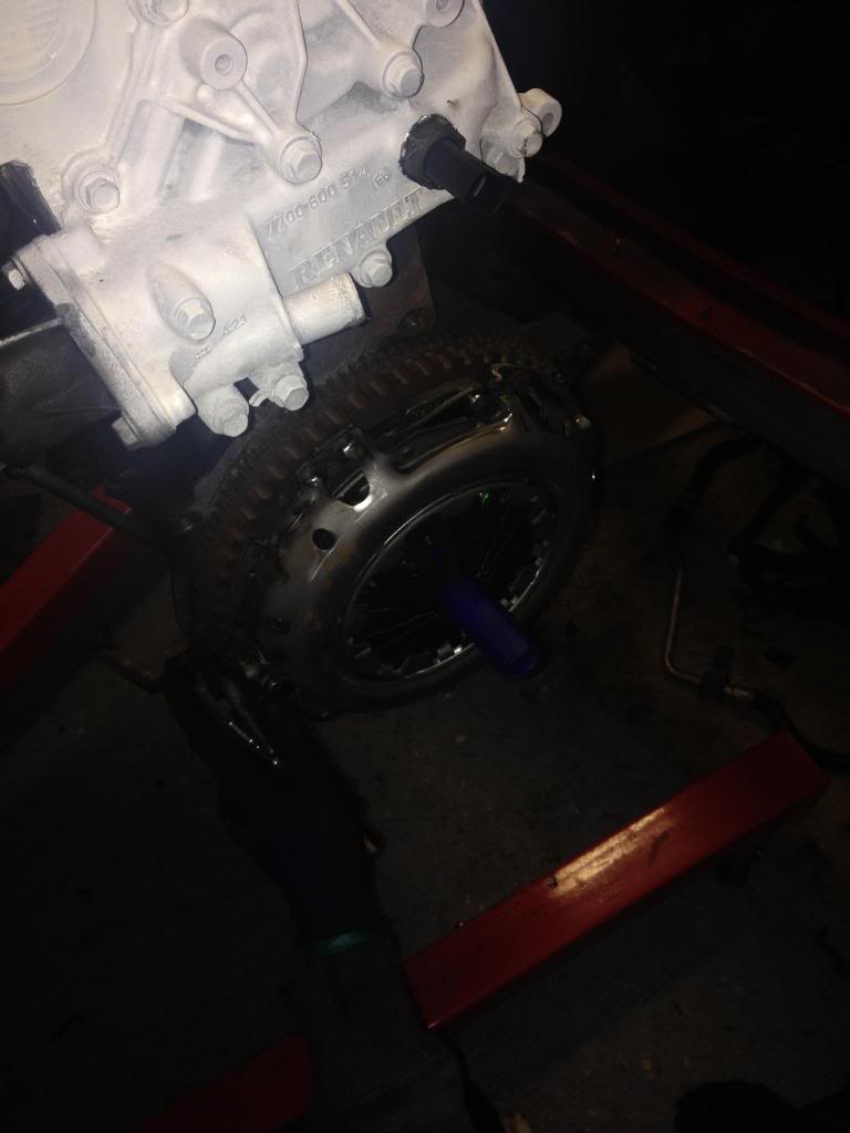

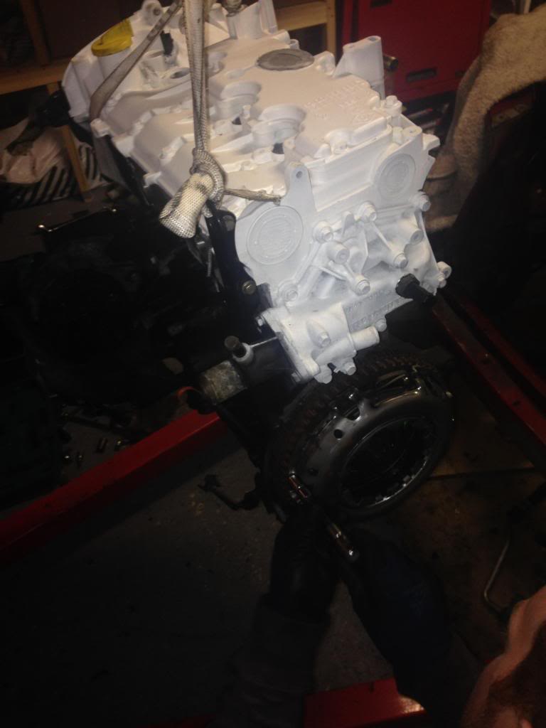

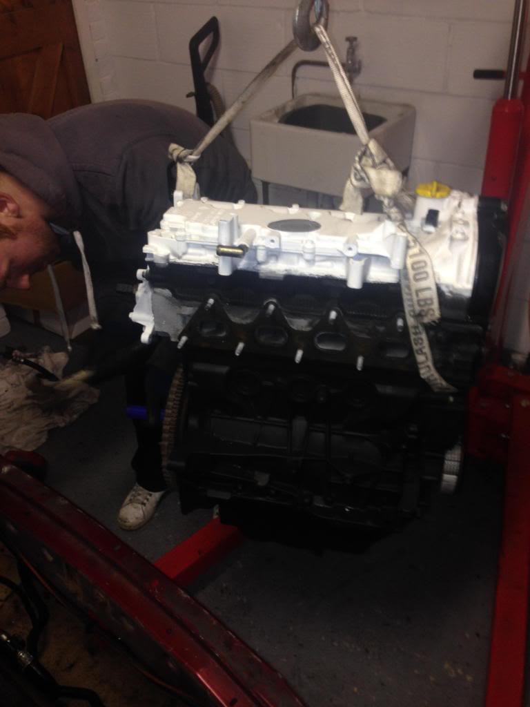

Flywheel on with new bolts, then new clutch on;

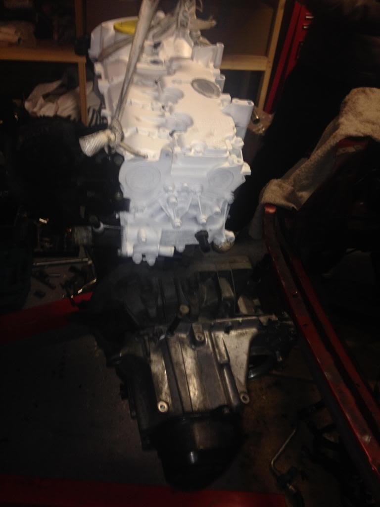

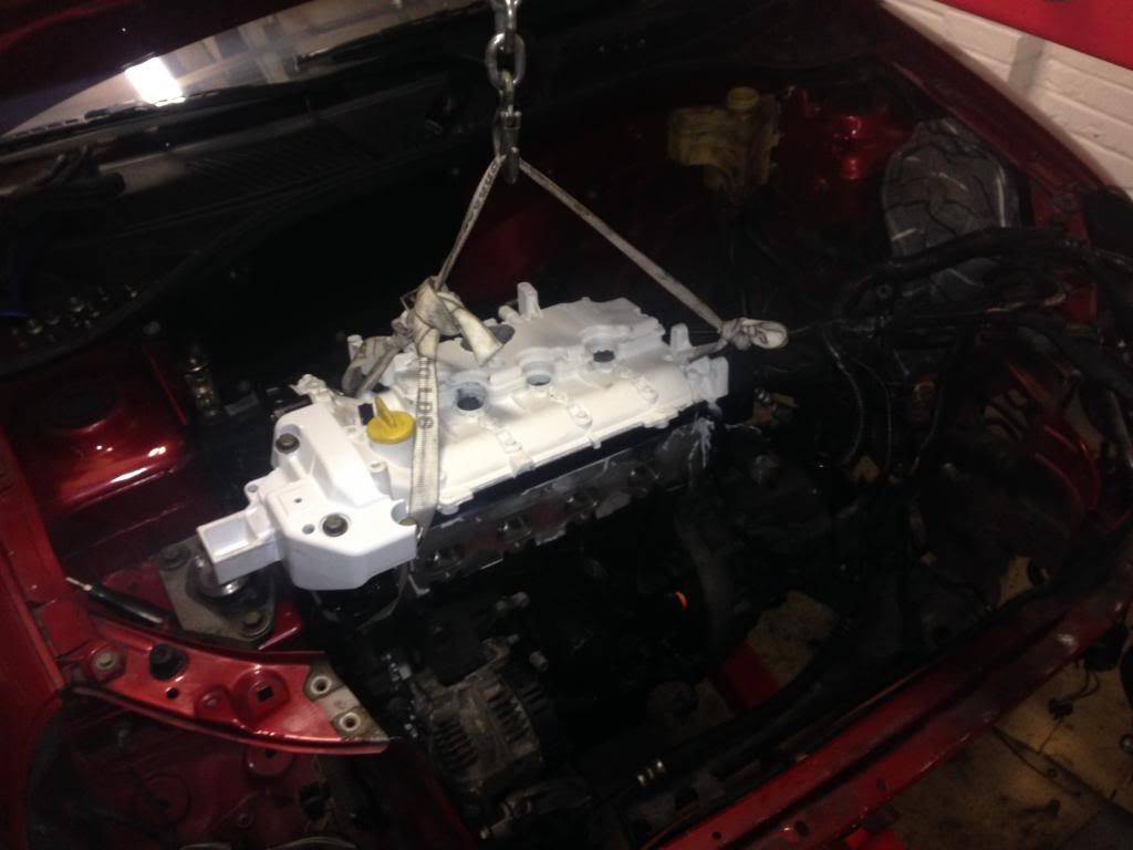

Then the gearbox went on;

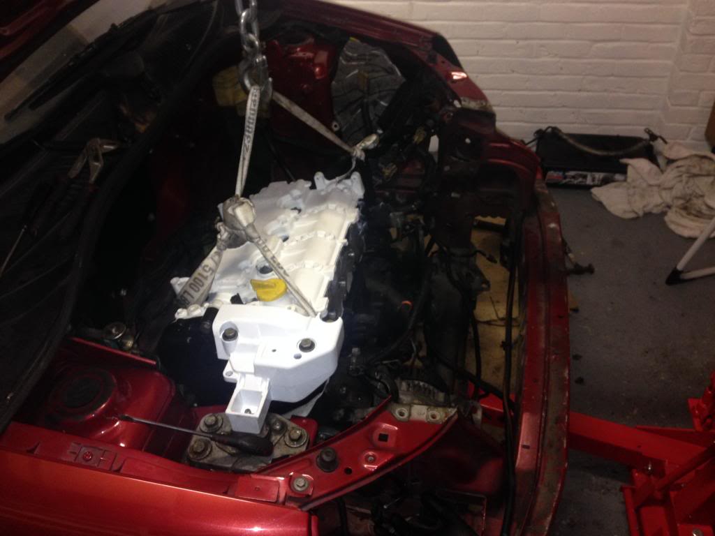

And into the shell it went;
1:40 and Burgess was happy with his beer efforts;

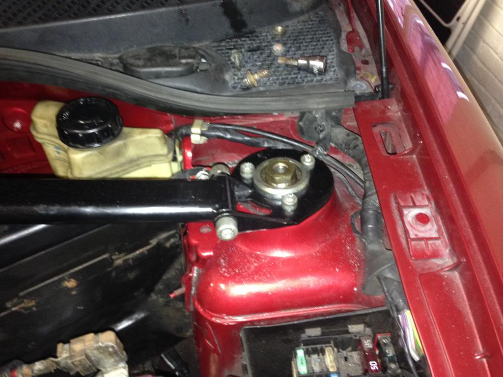

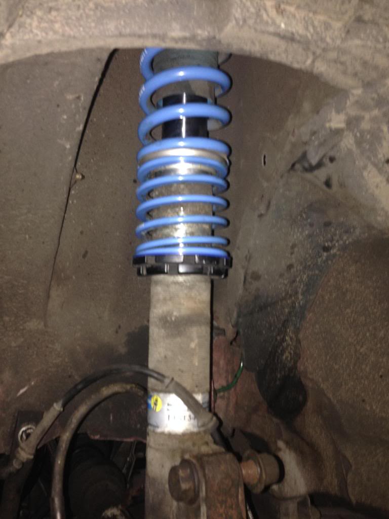

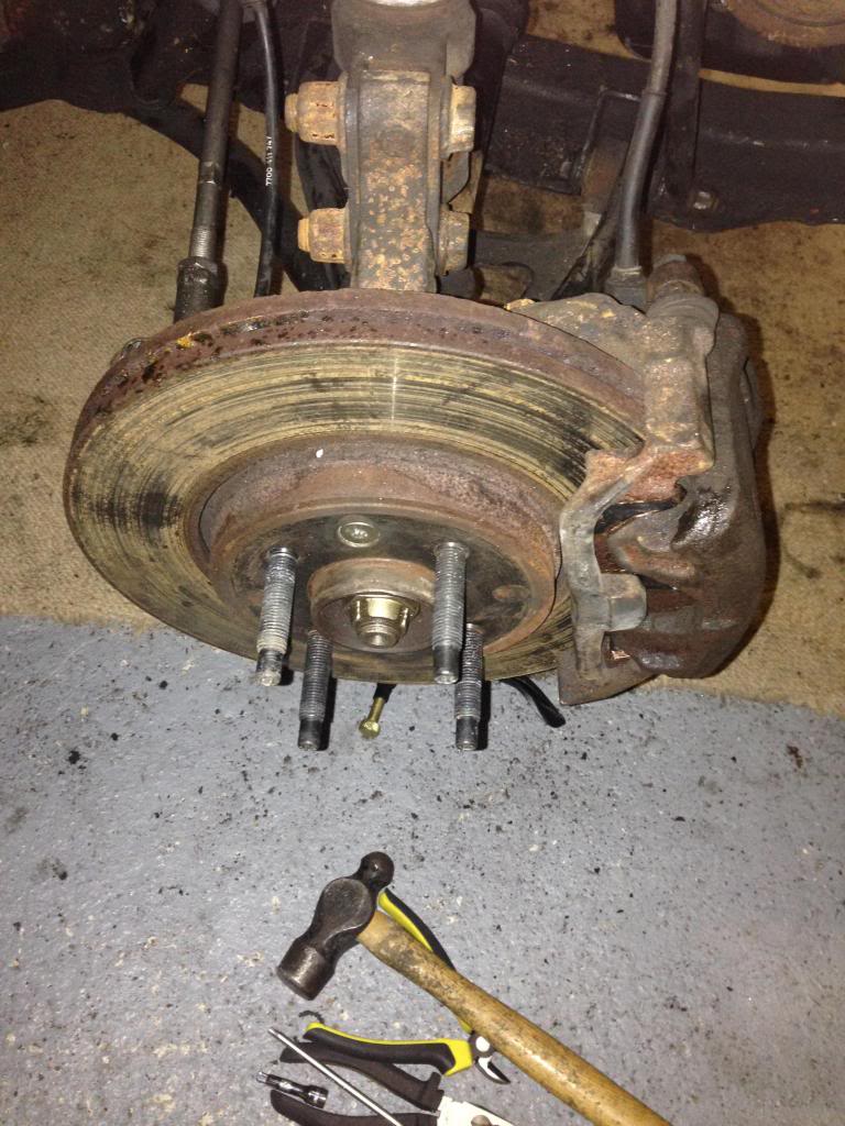

Then lots of people turned up, and Ant, Rob and me started putting the hubs back together, fitted the Ferodo DS3000s, cleaned the Bilsteins up, fitted the PMS Stud and nut kit, the PMS solid top mounts and strut brace and the PMS Shifter. Scott kindly put the OZ Racing stickers on my track wheels and Chris tidied up the Induction kit (which gives you an indication of how unhealthy the engine was and the amount of breathing it was doing.)

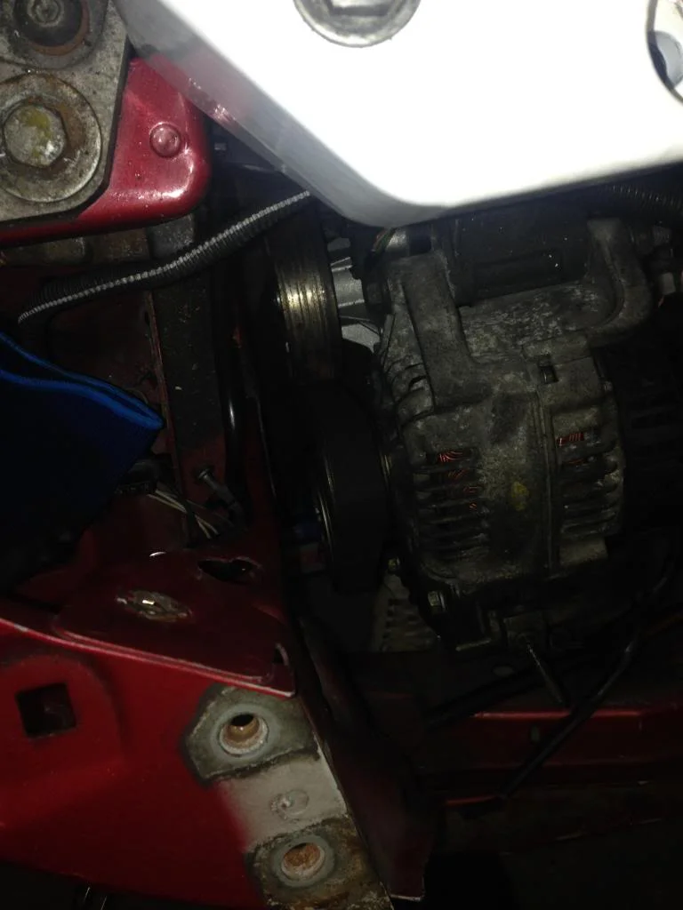

The aux belt is routed wrong. It needs to go from the top of the crank to the underneath of the water pump. Routed that way it'll cut into the cambelt cover.
Good progress though :)
  Many.
Re: 'Cub's Trackday Flamer - Cage etc'
I thought that too, wouldn't it cause the pump to spin the wrong way too?
Nah the pump still spins the right way (anything on the outside of the belt will still turn the same way) it's not uncommon for it to be routed like that, but as said it cuts into the lower belt cover, frays, into cambelt and boom!
What's that saying?
pay peanuts - get monkeys?
I guess it's also true:
pay beer - get pissheads
Not the best plan when it comes down to belts. Lol.
Do you want me to pop round tonight or next monday and sort it for you?

Good spot chaps, in fairness it was the last thing done before it went back in, so 1am ish.
Thanks for the offer chip, Mike is heading around this week so we'll swap it back around :)
  182/RS2/ Turbo/Mk1
Cool stuff, its a very easy mistake to make, I know cause did it myself once when I first started working on these engines with a cup setup!

Schoolboy!
As said mate, will amend when we finish off....
I even remember commenting at the time that it was mighty close to the cover. Thought process is non-existent at 1:30am.

It is mostly my fault as because I was keen to learn so Mike was trying to do it upside down because I was in the way! FLOL :)

We kicked off proceedings adjusting / rectifying some things. Started with Aux belt, then noticed the driveshaft on the drivers side wasn't through the mount on the underside of the engine so took the hub off and refitted the driveshaft. Then tightened both the Hubs back up and fitted Eibach Camber bolts both sides;

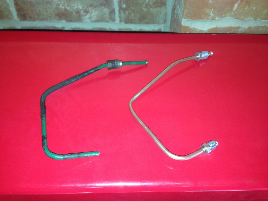

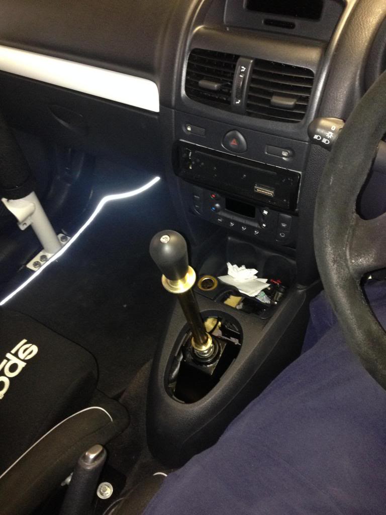

We then finished off a few outstanding bits and bobs. Set the PMS shifter up to its final position, and refitted the Cat. Also put the new brake line in on the rear, which will need painting to protect it.

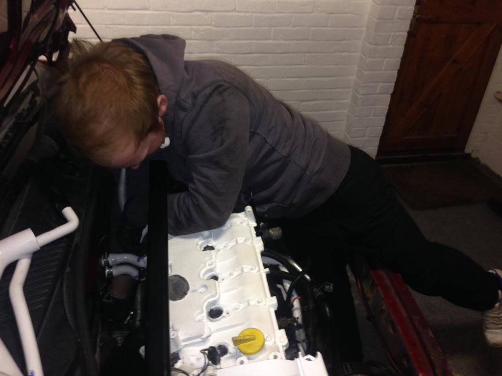

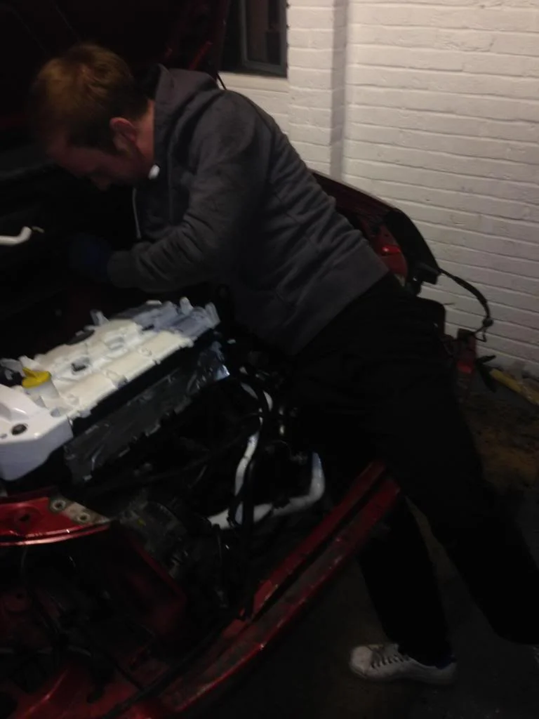

Mike then spend some time wrapping himself lovingly around my engine bay via the excuse of 'fitting the lambda'. His love for the car holds no bounds.

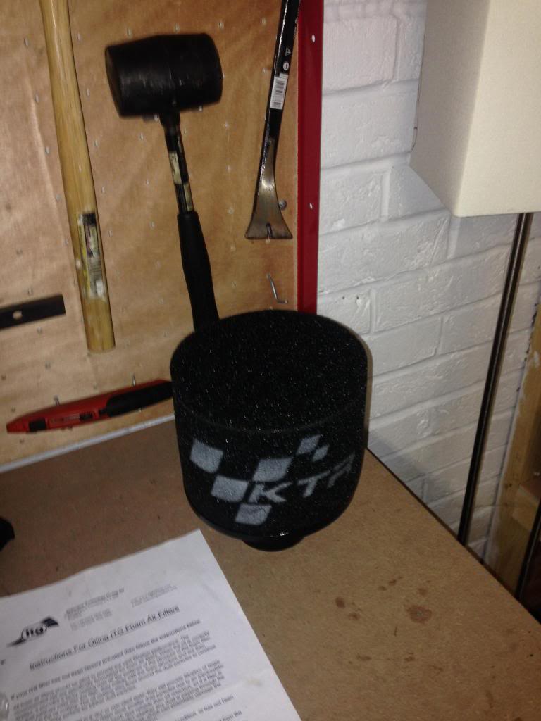

I oiled up the filter with the ITG kit.

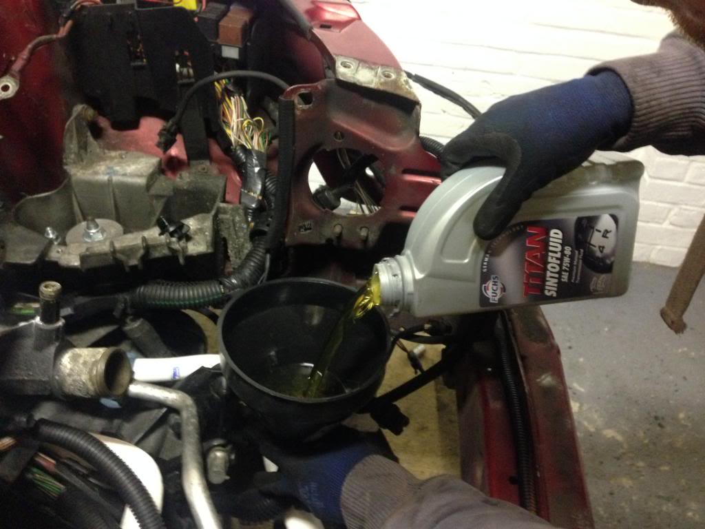

Refilled the gearbox with oil combined with the LSD additive i'd got.

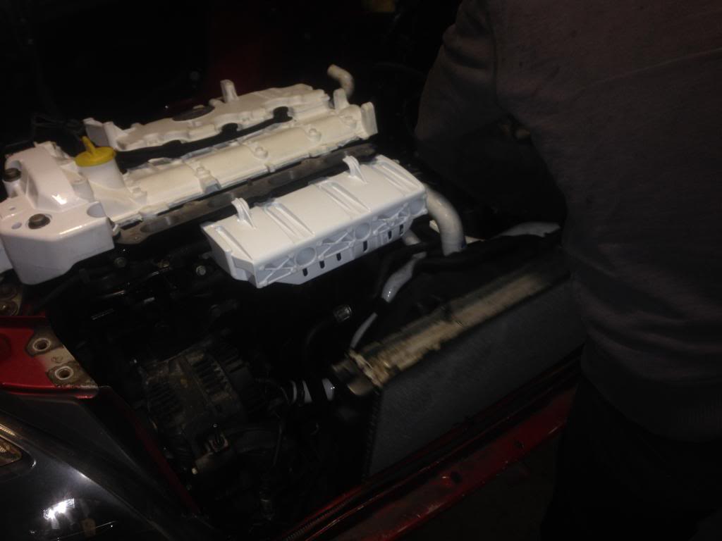

Put the Xenons back in;

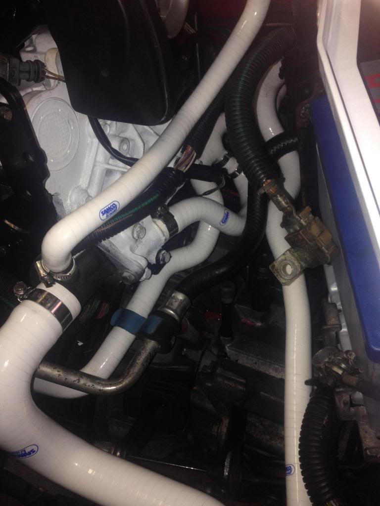

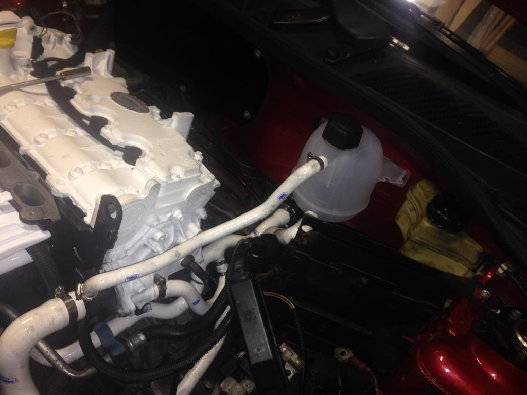

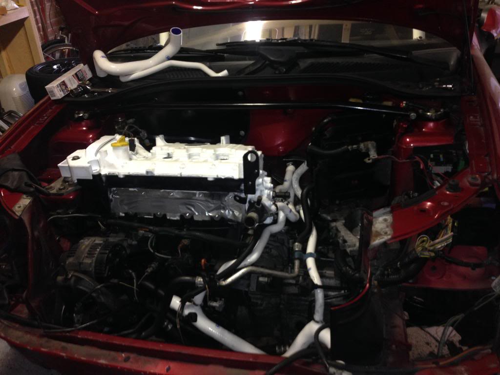

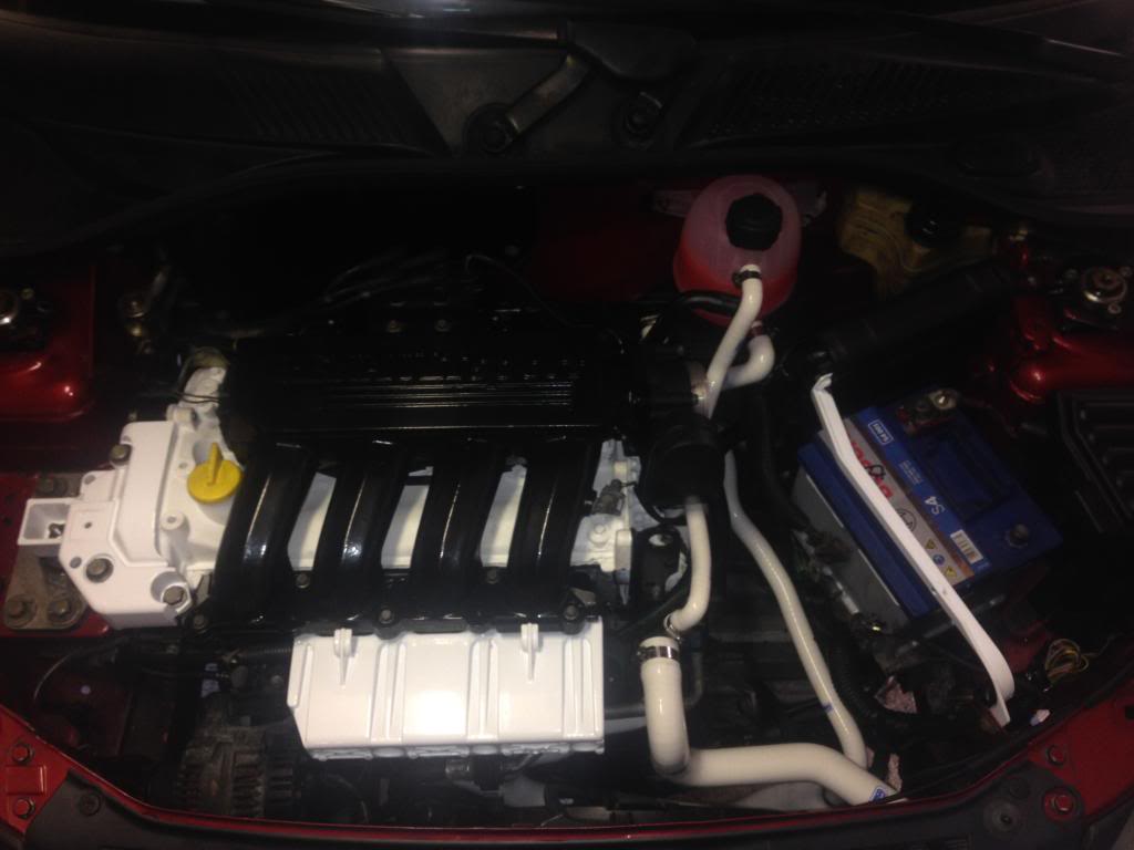

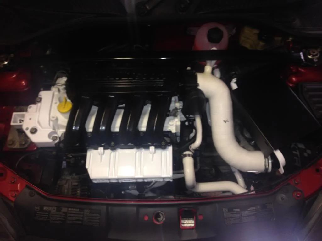

Put the last hoses in, connected some sensors, put in the radiator, the new expansion tank and then filled it up. Building the engine back up, fuel rail and injectors, RS stamped lower inlet with gasket, fuel rail guard and the ECU as well as plugging more sensors back in.

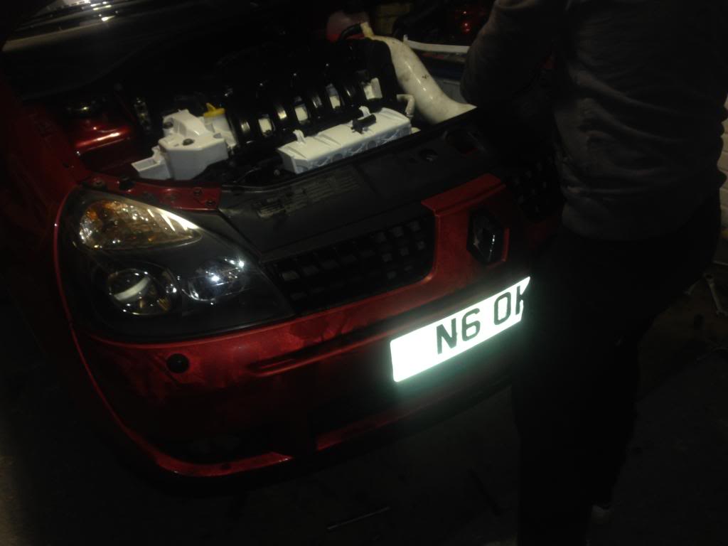

Bumper went back on. Nice to have a front end again.

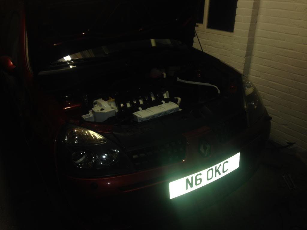

Leads, upper inlet, coil pack, throttle body, battery;
We then tried to fire it up and were greeted with a goosed starter motor. So that needs swapping. Bit disappointing as Mike and I wanted to see it run, but will have to wait until Tuesday. I have a video of it, but can't upload for some reason. Basically the starter solenoid has gone, sounds like a machine gun. We swapped the battery out for Mikes DCi one, helped us narrow it down. Thanks NorthloopCup Chip-mk1 and Dan@SJM for the late night / early morning diagnosis assistance :)

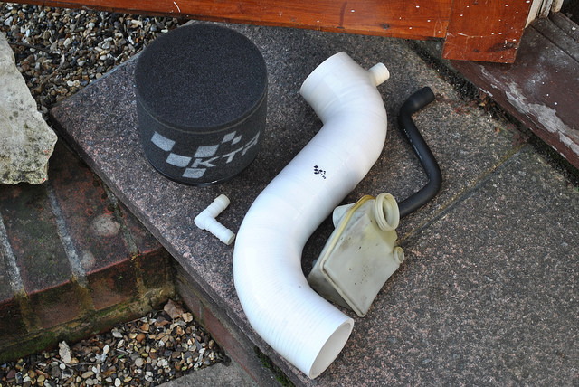

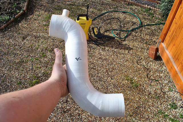

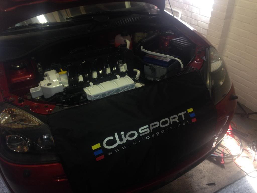

Mike then headed off and I got up this morning to clean the hoses up a bit and do an engine 'mock up' with the induction kit, battery cover and PMS strut brace in place. The cliosport body protector came out aswell. Lol. What a tart;
So very nearly there;
