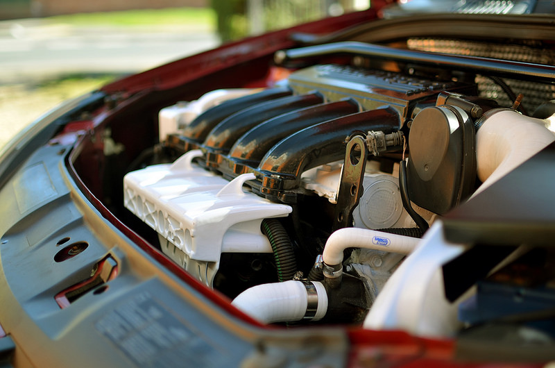

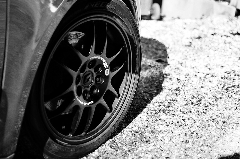

Cheers guys. I'm trying to find someone who can paint the inlet lettering white without goofing it up. Which counts me out. :)
Stiff sponge and lightly dab it on the lettering. Thank me later.

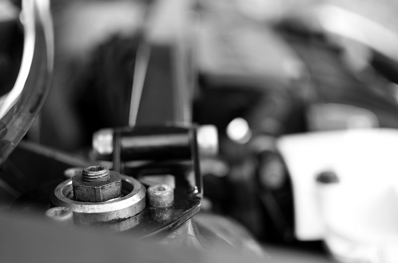

Check top mounts are tight now its been driven. The big nut in the middle (On mine its 24mm, but may be diff on yours due to billys).
Otherwise just do a nut and bolt check on everything that side.

Cheers dude, they were incredibly loose so I've tightened them up. I'll get the garage to check them on Monday. :)
Re: 'Cub's Trackday Flamer - Cage etc'
They want to be 30nm but its difficult to torque them and stop the shaft spinning, I always use thread lock on them though as they seem to like coming undone so I would suggest this too :)

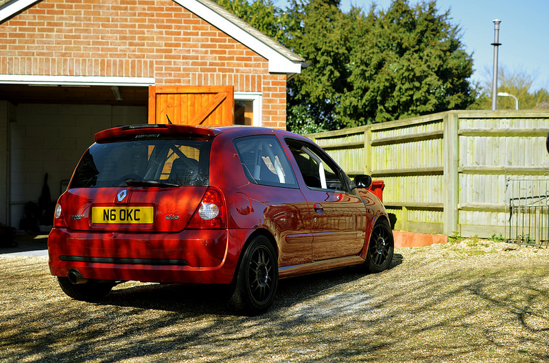

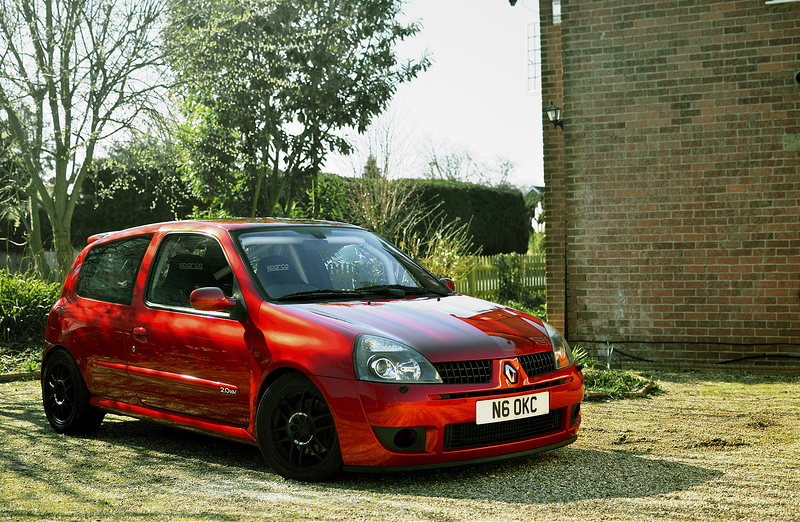

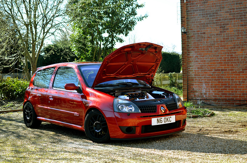

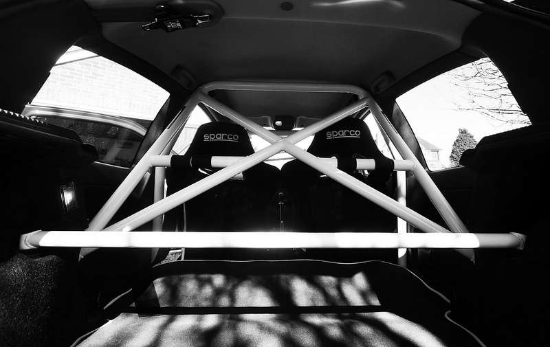

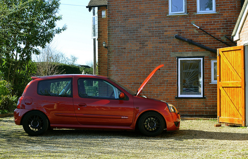

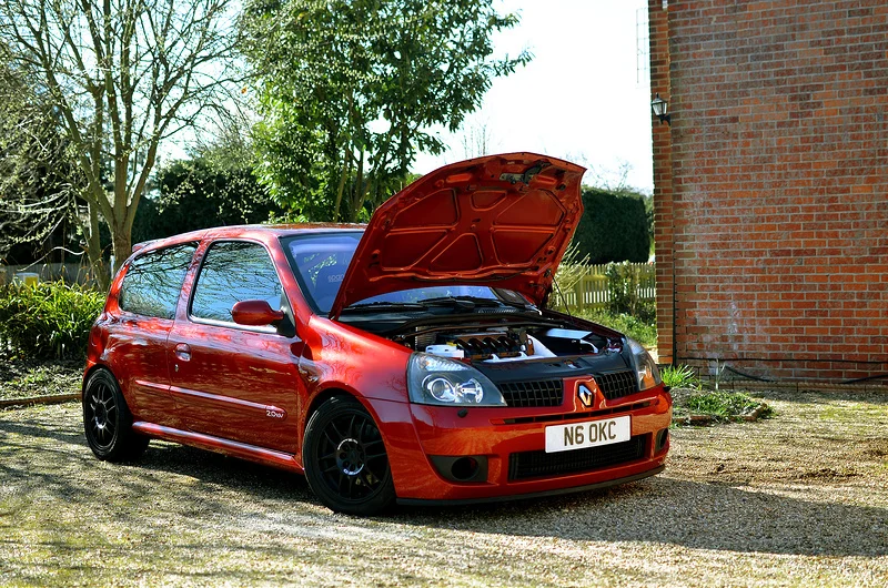

Well then, it's fair to say that it's looking fairly mean currently!
I love this car.

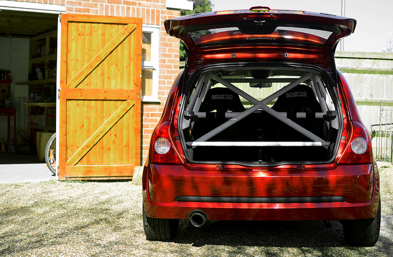

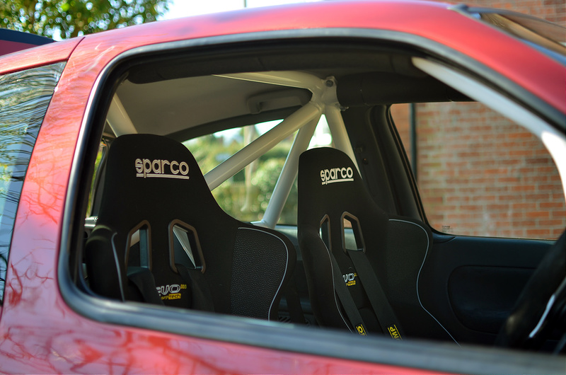

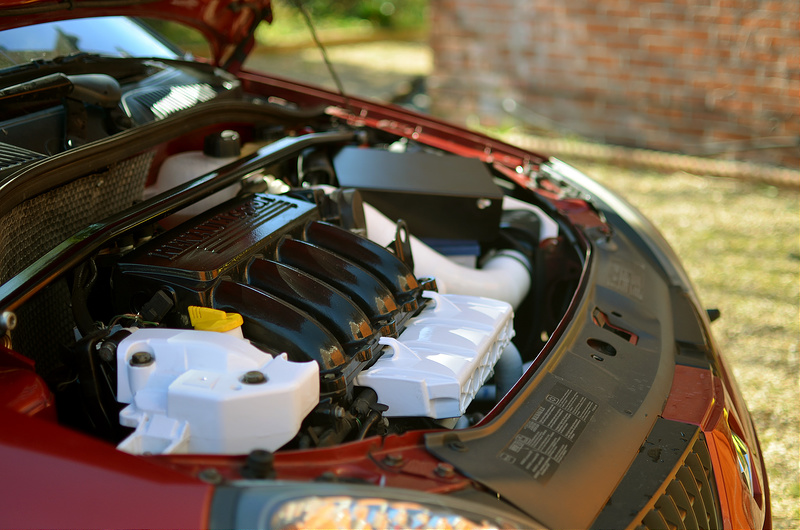

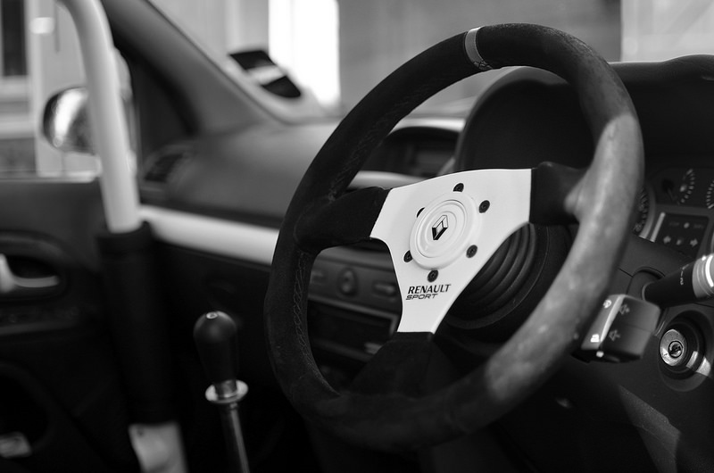

Looks awesome, nice pictures Luke! :)
Can't wait to get my hands on it again!

Epic pictures bud, thanks for taking them. Was good to catch up :)
Thanks for the comments guys. MOT tomorrow, fingers crossed!

That looks incredible, Oli. Absolutely love it, you'll have to make sure you get over to the unit when I go down again in summer.

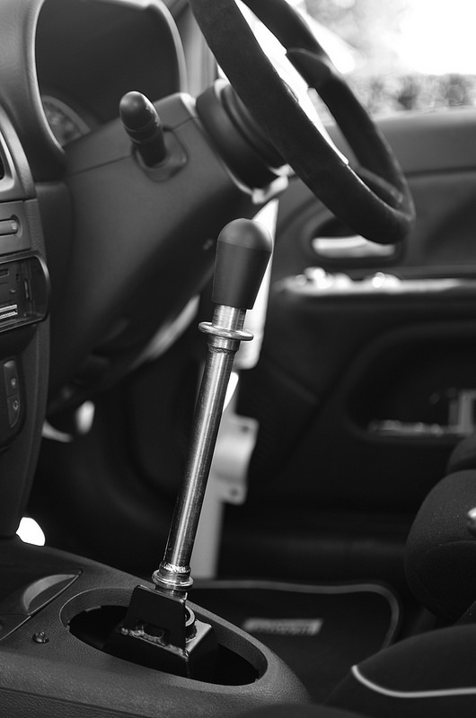

On a side note can you not fit the standard gaiter back over the PMS shifter? Would just finish it off.
